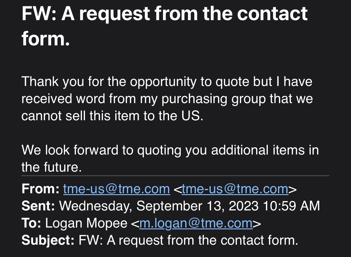

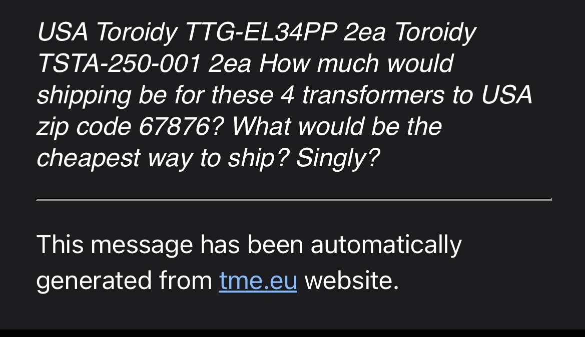

Just emailed TME about shipping for 2 OPT and 2 PT. They responded that they couldn’t sell these items to the US.
So this project just went in the toilet for me. Glad I was purchasing the transformers first.

Have you tried to order directly online from the TME website? Order one transformer at a time for the under 5 Kg package that ships at $9.99 from Poland to the USA. (The EL34 output and power transformers are above the limit in pairs). That is how I have done business and always had very good luck. I bought a pair of Toroidy ECL86 PP output transformers (a pair of these weighs in at under 5 kg packed) about three months ago with no issues for $9.99 shipped
I haven't tried to order yet. I'm thinking that I can get the OPT's on their site, but I do get a message that they won't ship the PT whenever I actually go to my cart. It's the PT that I really need. There are other options for the OPT's.Have you tried to order directly online from the TME website? Order one transformer at a time for the under 5 Kg package that ships at $9.99 from Poland to the USA. That is how I have done business and always had very good luck. I bought a pair of Toroidy ECL86 PP output transformers (a pair of these weigh sin at under 5 kg packed) about three months ago with no issues for $9.99 shipped

I remember reading a message recently that TME established a presence in USA (Georgia I think). Perhaps that is why you can’t buy from Poland TME now. Don’t give up on Toroidy yet. I expect that you should be able to buy Toroidy in USA
The Edcor transformer should work, however, a bit expensive (and overkill) for two if you need monoblocks.
They did evidently. Had to google it.I remember reading a message recently that TME established a presence in USA (Georgia I think).
https://www.tme.com/us/en-us/about-us/tme-group/38715/tme-us-llc/
I've sent an email to the US subsidiary. We shall see. In the meantime I'd like to find an alternative power transformer(s).
