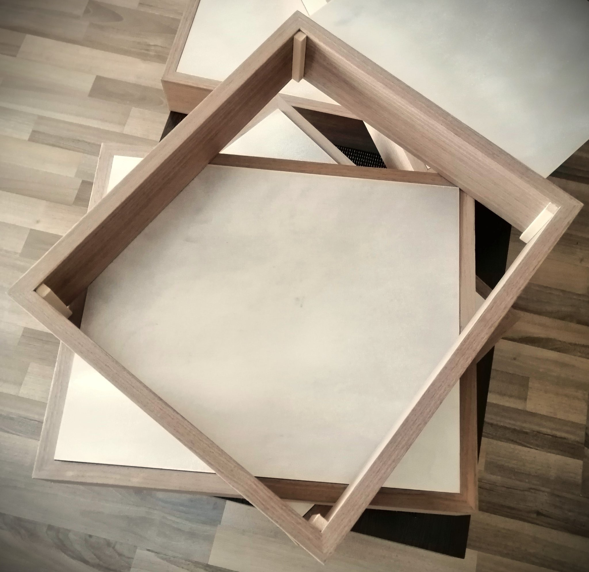

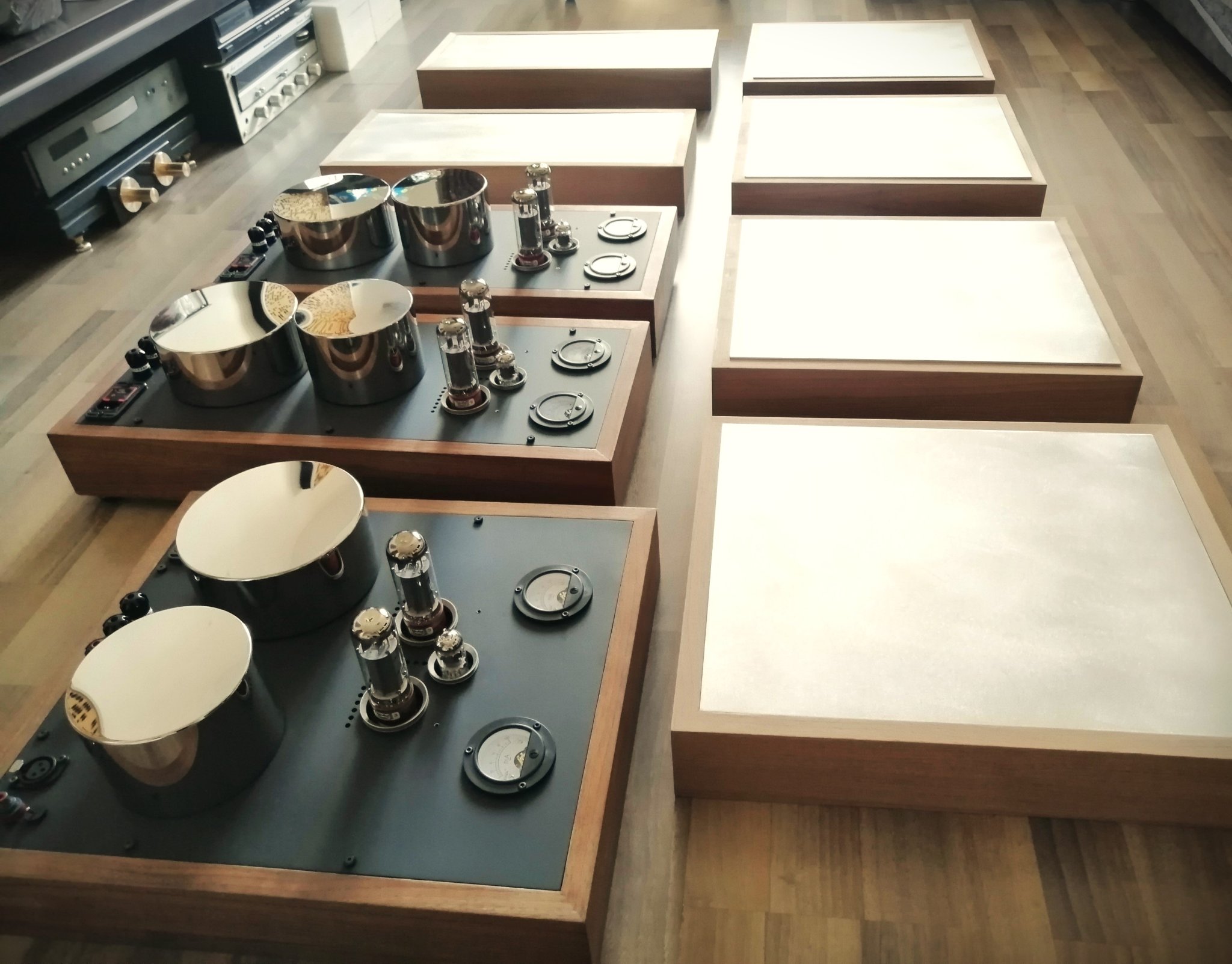

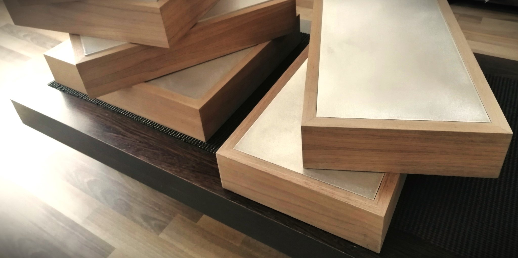

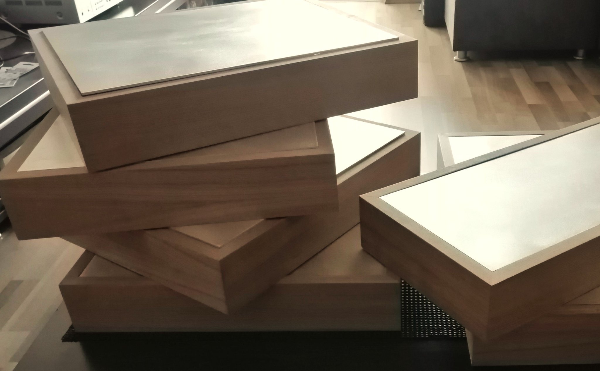

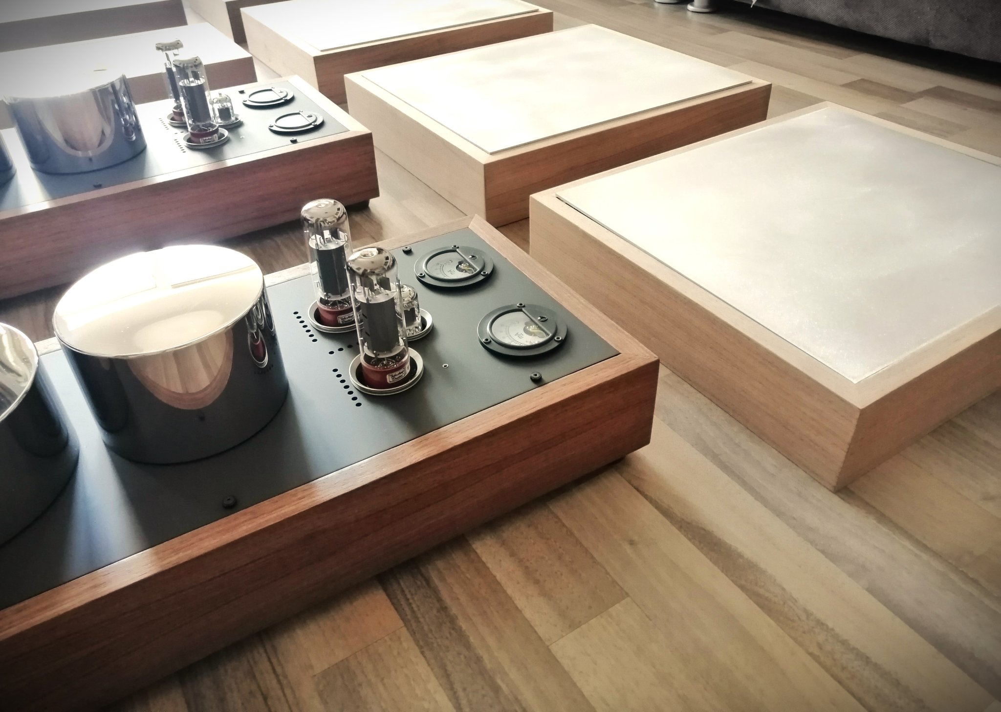

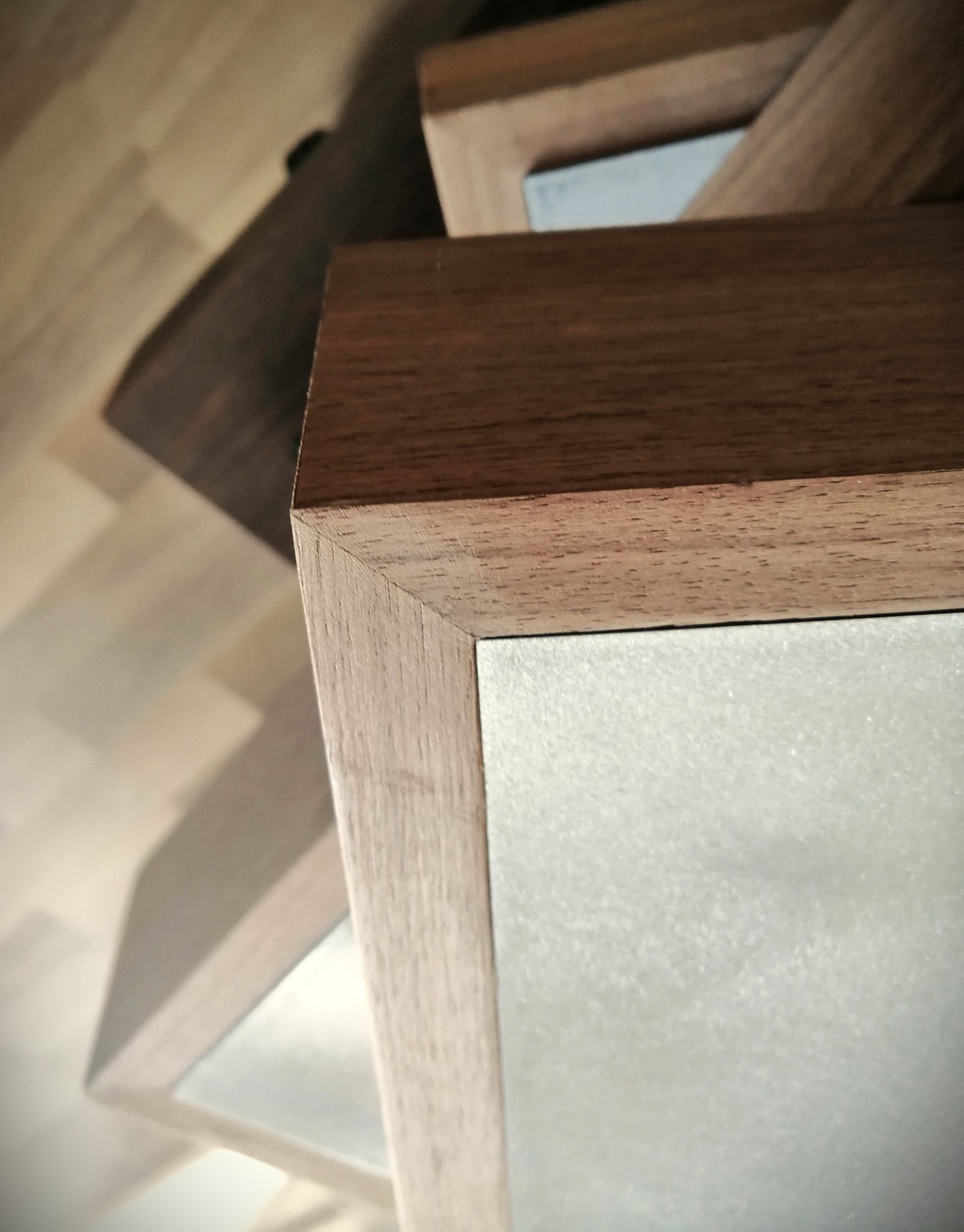

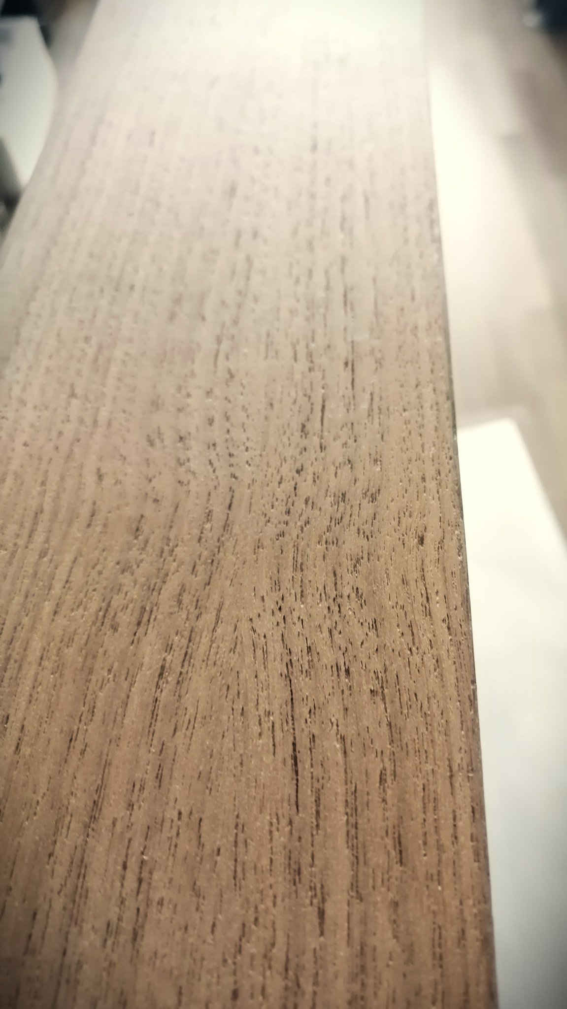

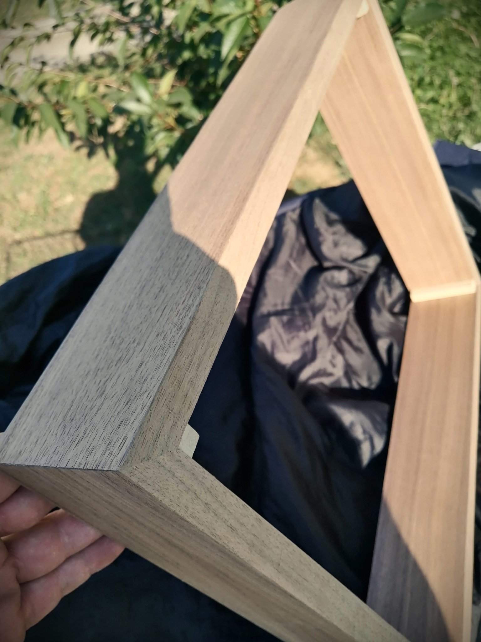

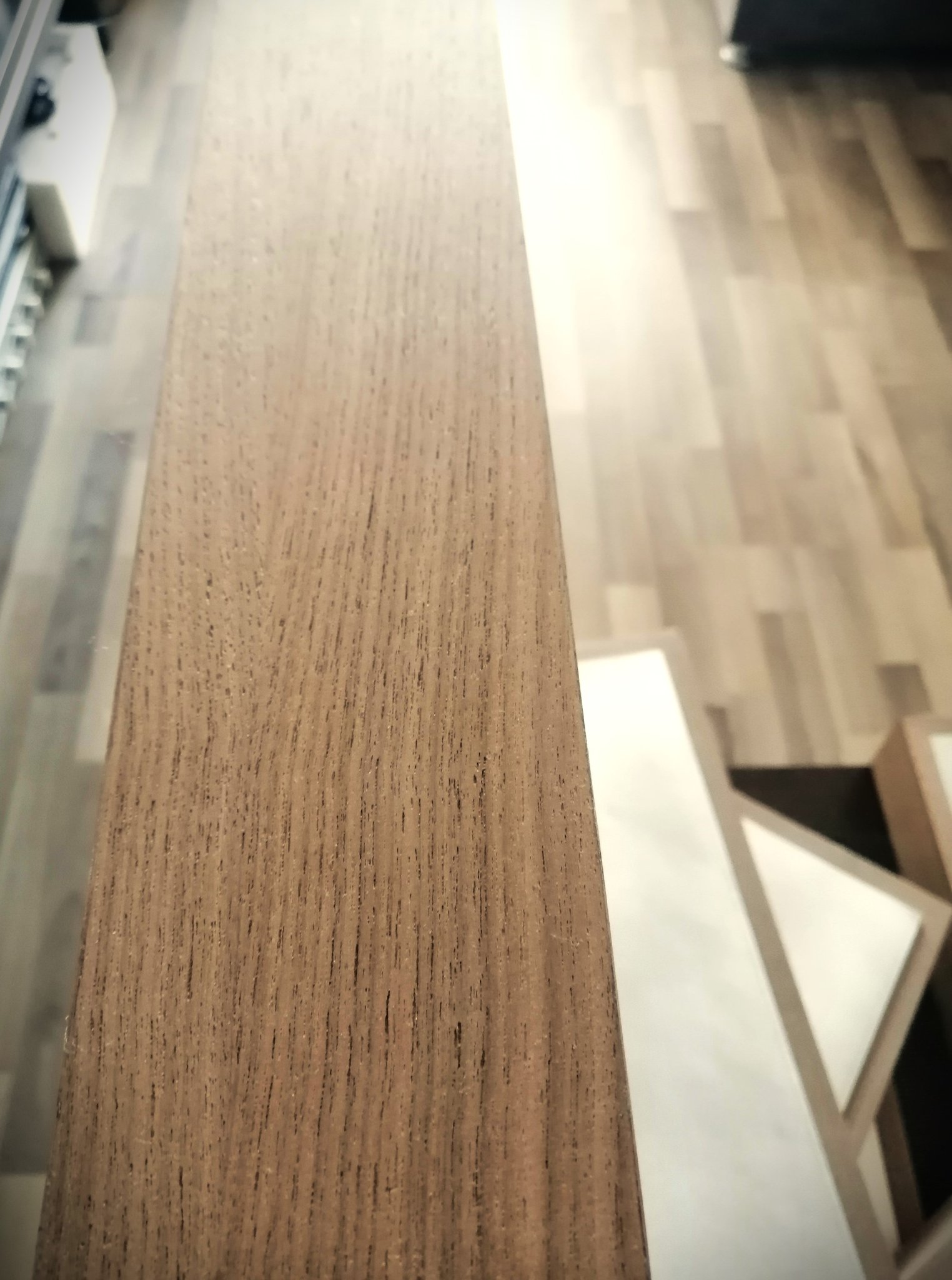

I have a few "spare parts" for Baby Huey or something similar tube amps for those who really want quality and superb looking amp.
These are "Raw" high quality american walnut wood frame and 3mm thickness aluminium top plate.
I use it on EL34 Baby Huey here:
https://www.diyaudio.com/community/threads/el34-baby-huey-amplifier.326920/post-7380662
I will post also at "Swap meet" area for sale.....but I was thinking first to the Baby Huey users....

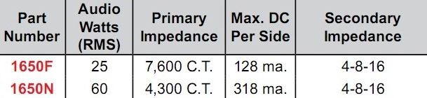

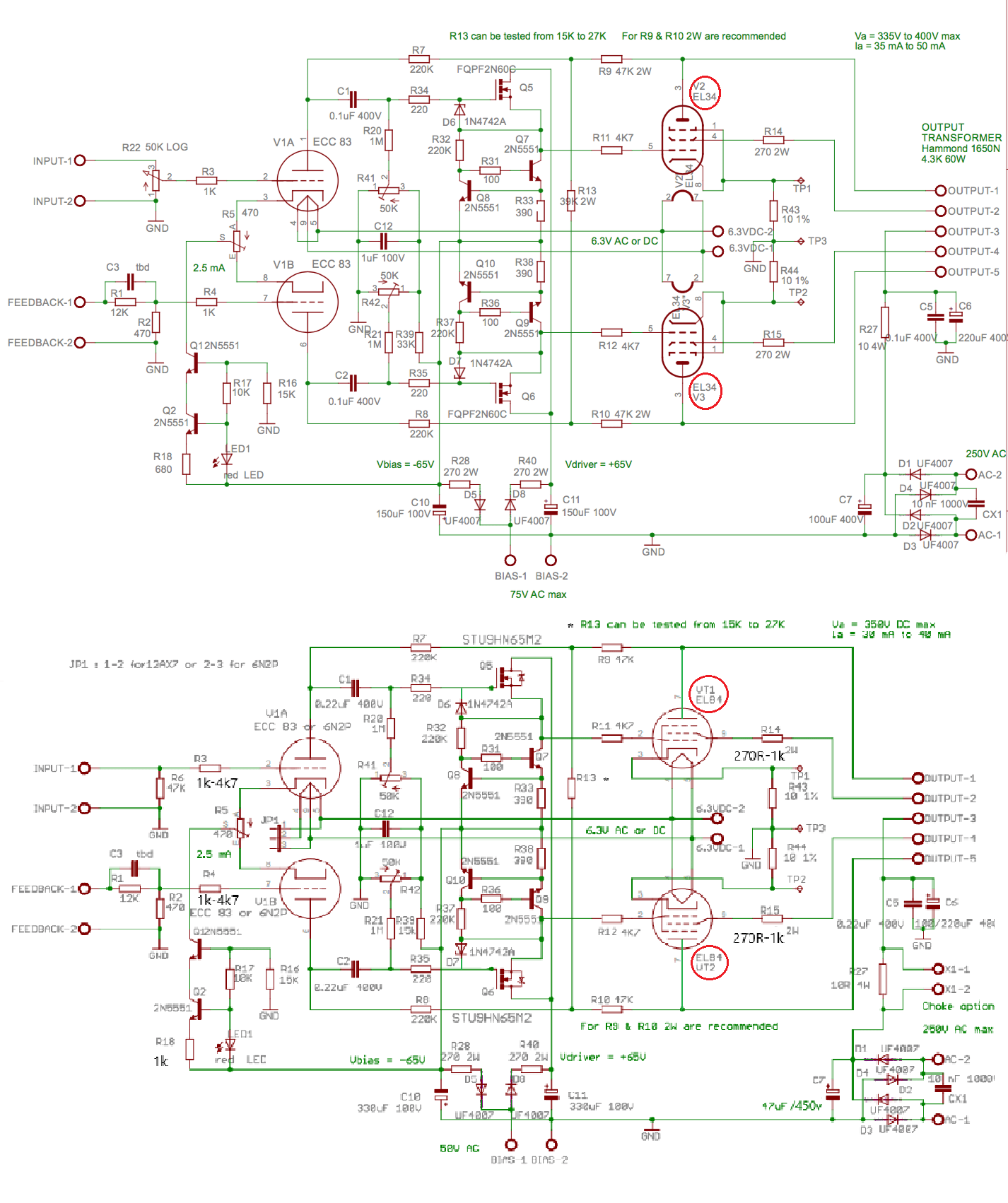

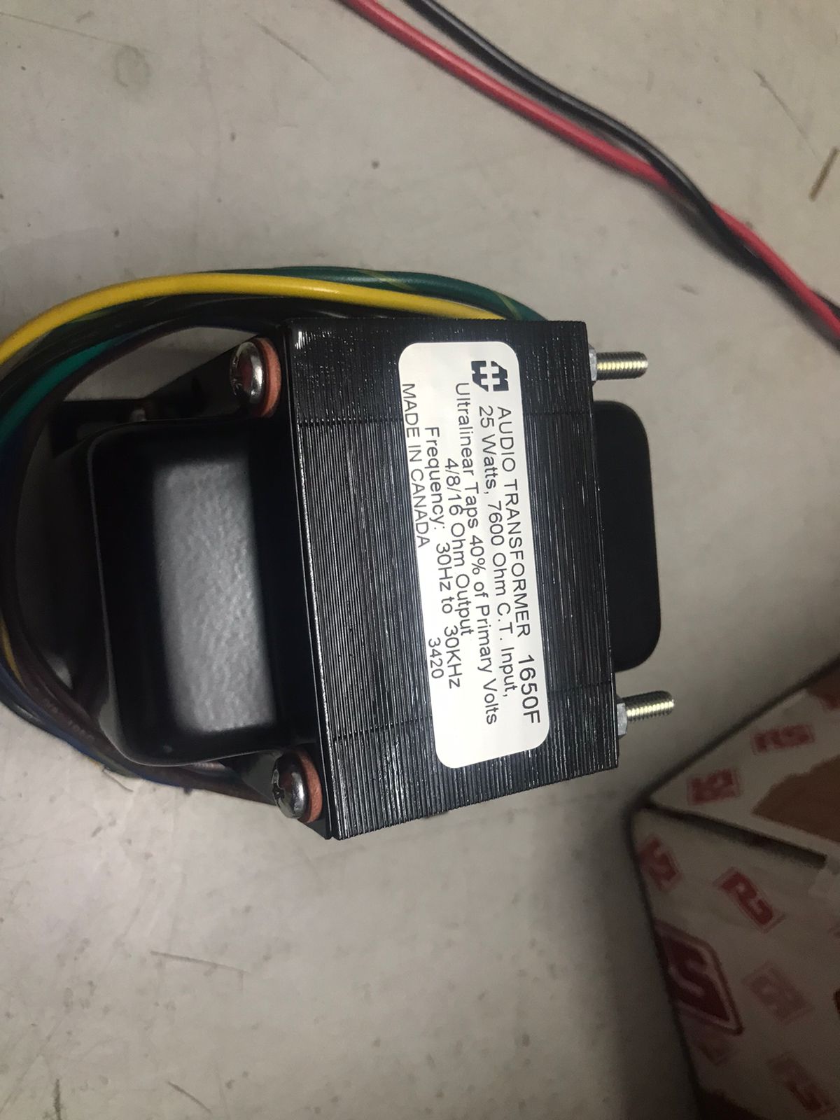

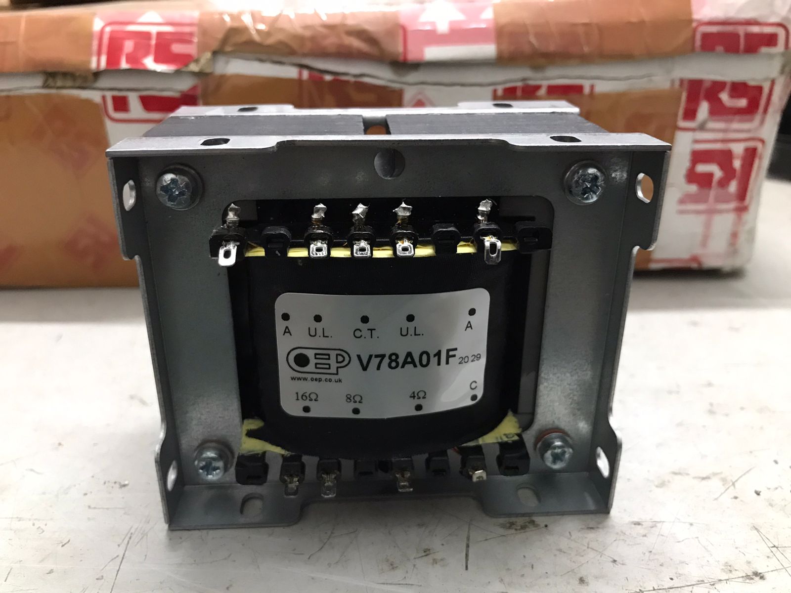

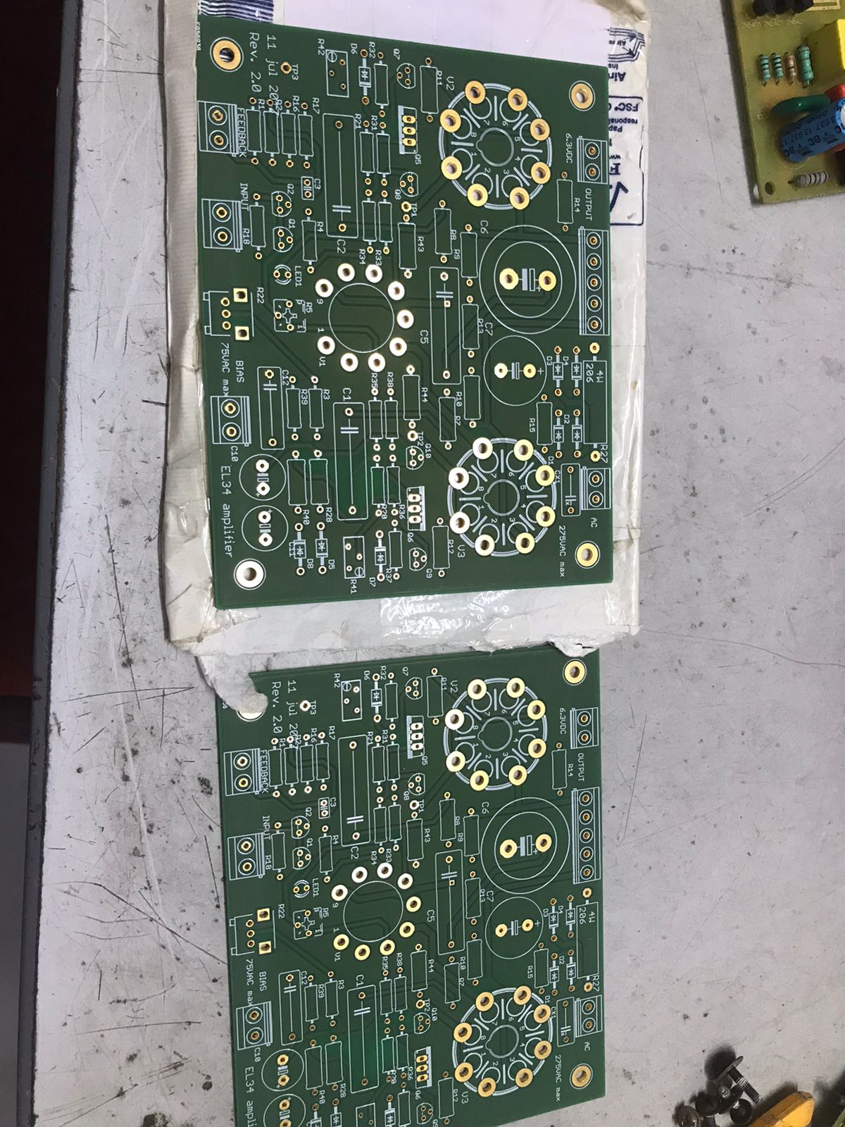

Dear All,
I have a pair of pcbs for this fantastic amp. Planning to build 2 monoblocks.
need help for the assembly of the amp.
The power transformers i have with secondaries :
1. 0-300Vac : 0.8A
2. 0-6.3Vac : 6A
3. 0-40Vac : 0.5A
Can this transformer be used for EL34 Baby Huey ?
Secondly, i have 2 sets of output transformers :
1. Hammond 1650F
2. EOP V78A01F
Both are rated at 25W, can any of these be used in this amp ?
I have attached some pictures and docs for reference. I would like to use the parts(transformers) in hand to complete the build.
Any help is highly appreciated.

https://www.diyaudio.com/community/threads/baby-huey-gb-pcb-el34-build-thread.320273/
The Hammond has the wrong primary impedance, with the EOP the tap deviates from the Hammond by 24.5%.
With the power transformer, the voltage must be doubled in the 40V winding.
https://www.diyaudio.com/community/threads/hammond-1650p-vs-1650n-for-el34-pp.209934/
Hammond 1650F: If you connect an 8 ohm speaker to the 16 ohm tap you will get a different primary impedance !
@Aniket,
Your transformers are almost right but not perfect.
1. The first problem with the power transformer is the 300 vac primary, but that you can work with to reduce to where you need it to be, for example by using a smaller film cap (around 6-8 uF is my guess for psuedo choke-input operation) in place of specified electrolytic for C7 with a good choke (2.5H or more). The second issue may be bigger; the 6 amp @ 6.3 Vac capacity of the heater coil. EL34 draws 1.5 amp each, so there is no capacity left to heat the ecc83 tubes. However, a ecc83 draws .3 amps, so a pair will overload your 6 amp heater winding by 10%. Depending on the robustness of your PT it may or may not handle it without overhearing. As @snapper mentioned, you may need to use a voltage doubler on the bias winding, but that is not a big deal either. Due to these issues, have you considered building a 6L6GB Baby Huey amplifier? If you search you will find several posts about 6L6-type implementations. A 6L6GB draws only 0.9 amps.
2. The Hammond 1650F with primary of 7600 and 25 watts max is more suited to 6L6 types than EL34. EL34 PP works better with 4.3 - 5 k primary and 35 watts out max.
3. I don’t know the EOP V78A01F, but it appears to have a primary of 5.6k. That is about half-way between the ideals for 6L6GB and EL34, but could be make to work with either. The 24.5% UL tap is perfect for EL84 (but it likes a 8k primary), and 6L6 I understand prefers 50% and EL34 33-43%. I’m not sure what the design rationale was behind this EOP, but it looks like a very nice transformer.
So, you have losts of good stuff but nothing works quite perfectly with Baby Huey. I would compromise and build a 6L6GB Baby Huey, using you PT with B+ adjusted for about 350 Vdc and possibly a doubler on the bias winding, with your Hammond 1650F OTs in UL mode. This will all have to be worked out using load lines at the chosen operating point and mode, but I guess you can expect about 22-25 watts output per amplifier.
Good luck.
Good luck.

@snapper, thanks for the correction - I missed the monoblock part. Then those PTs would work fine for heating a EL34 Baby Huey monoblock each, if the other issues are addressed.
@jcalvarez, I’m puzzled by the OEP transformers‘s design choices. The V78A01F is mentioned for use with EL34 at 5.6 k primary, but with 24.5% Ul ratio. It would work with EL34, but not ideally - lowish power at 25 watts, rather high primary and unusually low UL ratio for EL34. Yet, their V29A06F (intended for EL84 and 6V6) has 10k primary (good), but 43% UL ratio (high for EL84).
But as @6A3sUMMER pointed out, speaker loads are not a constant, so these OEP transformers might perform well under dynamic music loads at these “unusual design choices”.

I've found those percentages very depending on working conditions and only true if UL is the only local feedback applied to output tubes.The 24.5% UL tap is perfect for EL84 (but it likes a 8k primary), and 6L6 I understand prefers 50% and EL34 33-43%. I’m not sure what the design rationale was behind this EOP, but it looks like a very nice transformer.
With multiple local feedback paths like the BH, standard UL rules are not strictly true.
EG IMO higher B+, less steep loadlines, lower UL, higher a-g1 feedback and higher driver gain is preferrable to get good DF, high power, euphonicity and good sensitivity.
25W is too low for an EL34 PP amp. From a pair of those those you get approximately 35 to 50 Wrms.Secondly, i have 2 sets of output transformers :
1. Hammond 1650F
2. EOP V78A01F

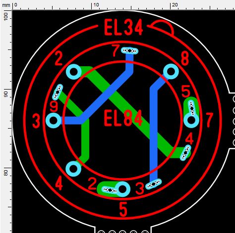

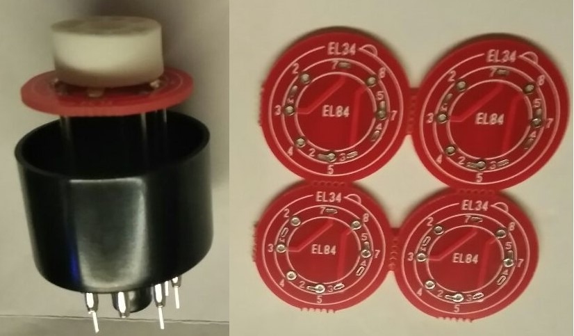

With a 5.6k Raa, to stay within 25 Wrms you need not to exceed 300V B+ (and get around 12 Wrms in "class A").

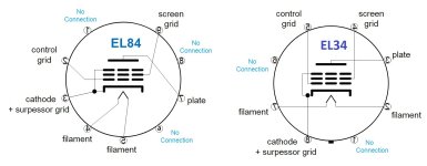

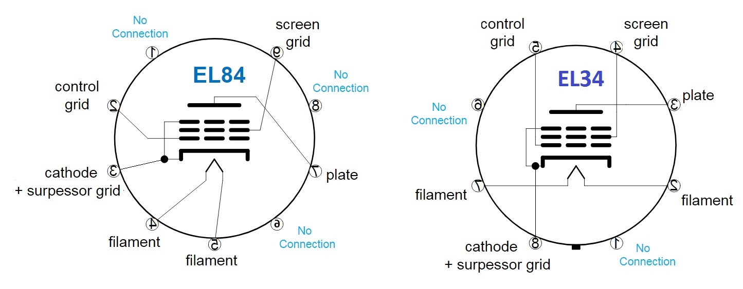

That's the EL84-6V6GT territory: you should get around 20 Wrms from a PP of EL84 with that output transformer and a B+ of 340V.

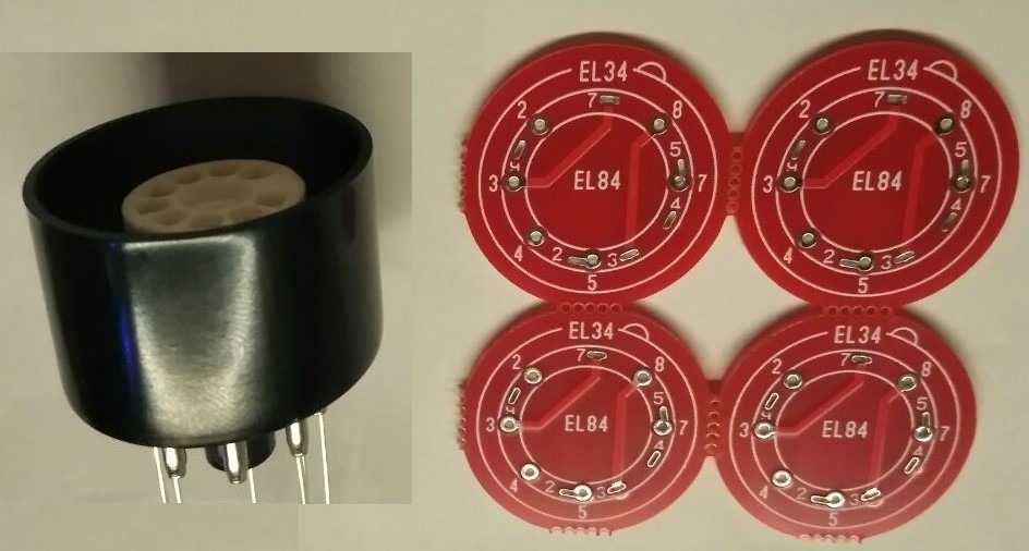

Because the OPT's in this case fit better with the EL84/6P14P it is also possible to use them with the BH-EL34 PCB.
The socket adapters required for this are difficult to find and also very expensive.
I designed my own DIY adapter PCBs for this some time ago.
If you are interested on this PCB´s please PM 😉
