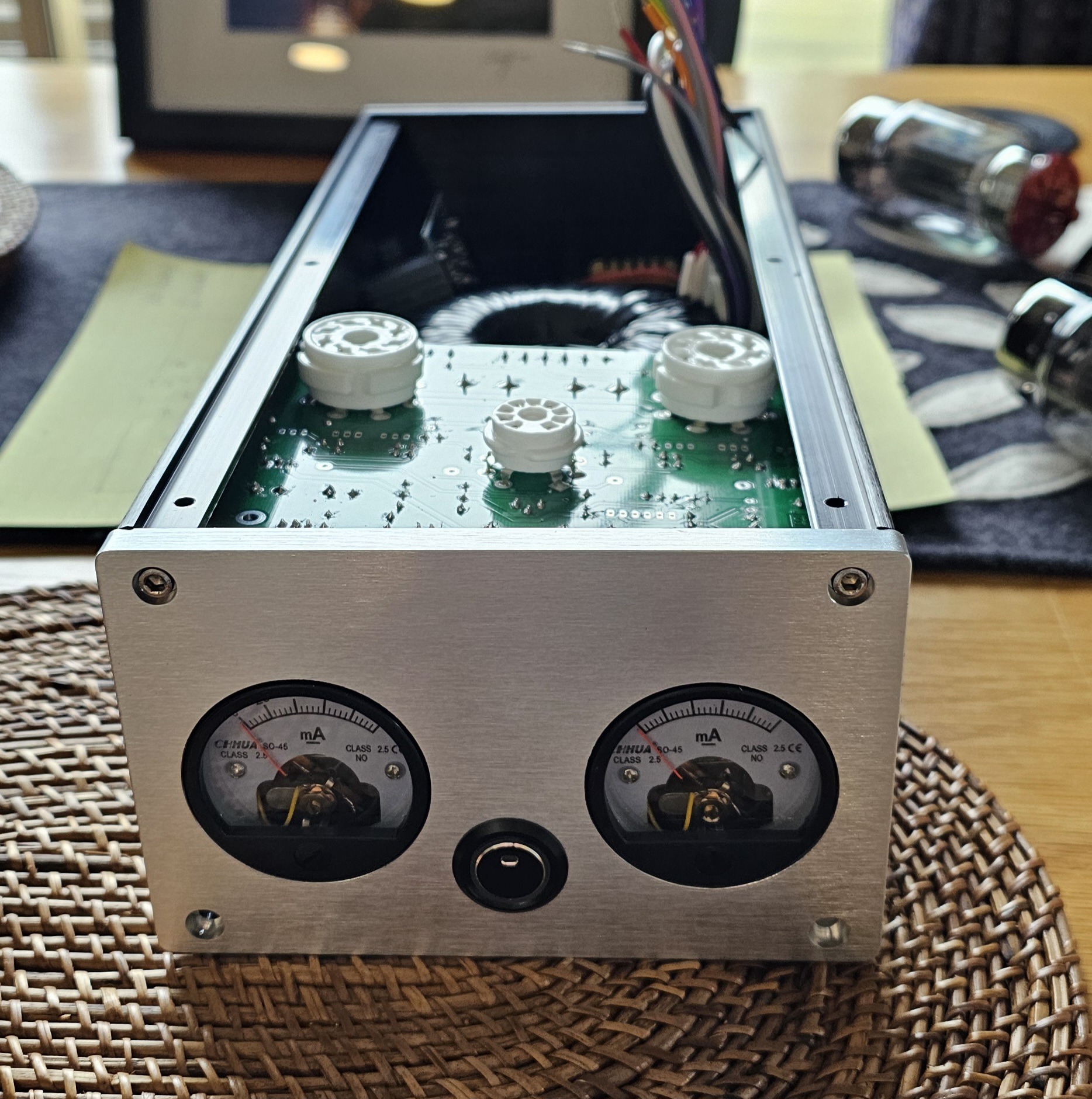

Can you please tell me where you source your meters from. I have been looking for those type of meters for awhile now.
Freecrowder, my meters came from Aliexpress and also need modification.
