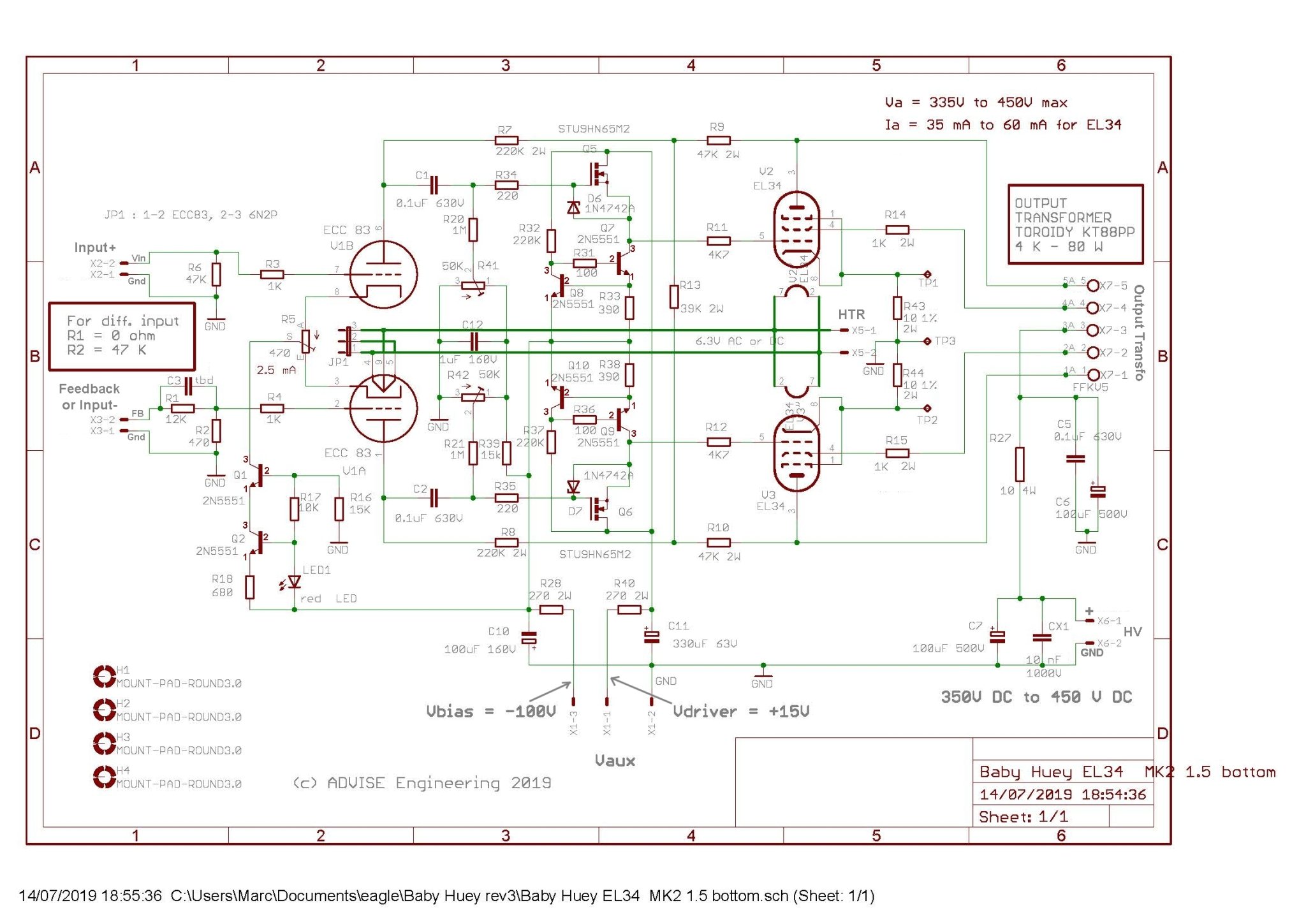

Domg,
Can you point me to an accurate and exact schematic of your amplifier, Please?
One of us might be able to see where you can ground some grids of various stages (without damaging anything), in order to see:
either how early, or how late, in the amplifier signal chain that the hum is occurring.
That is one troubleshooting technique, and it might be a good start to find the cause of the hum.

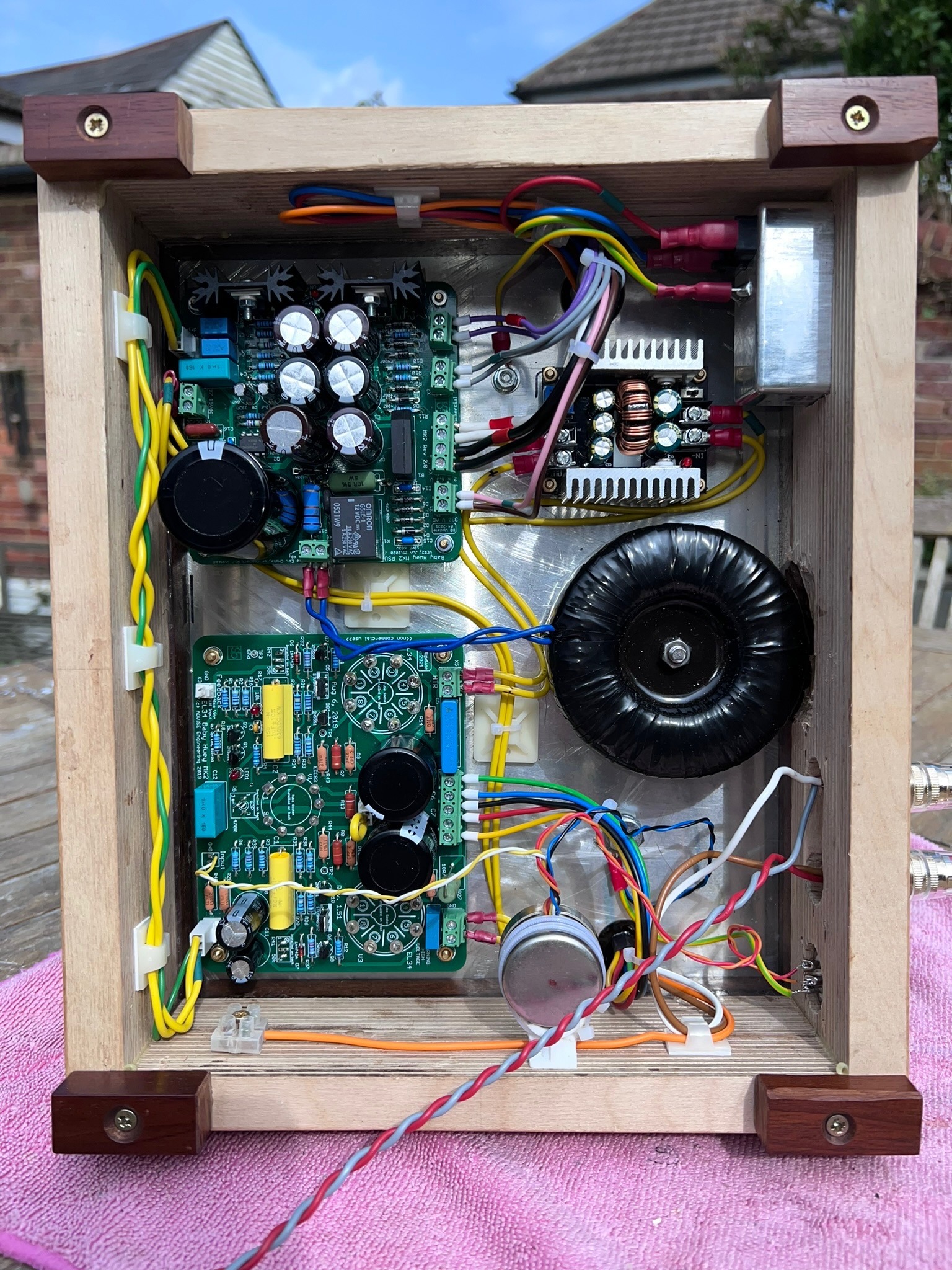

Hi @6A3sUMMER,
Thanks for looking. I’m building monoblock EL34s using MkII Baby Huey boards - schematics attached for amp and power supply boards.

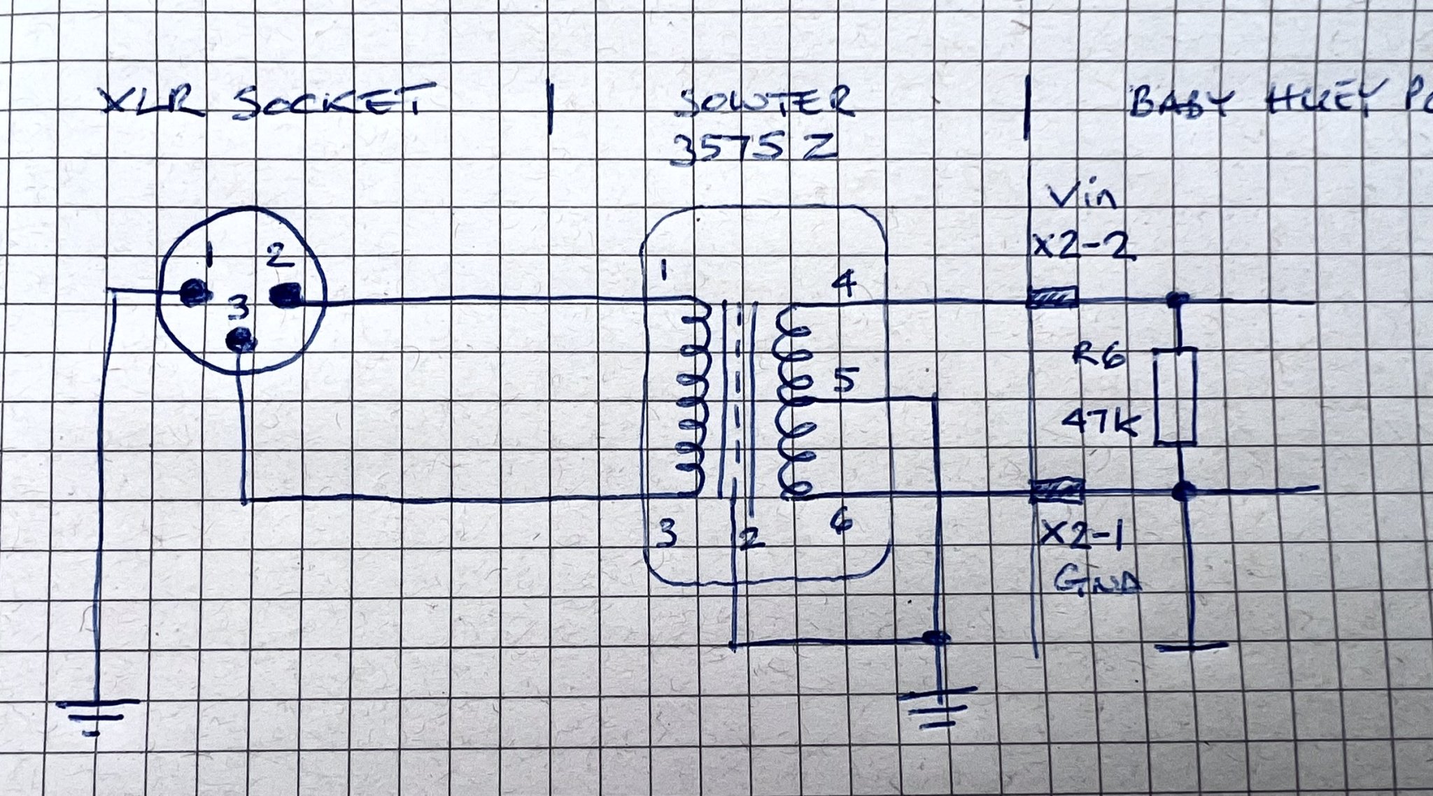

Hi @6A3sUMMER
All sounds good with the Sowter 3575 disconnected and a jury rig single-ended input (both with and without negative feedback), so looks like the input transformer connection is the problem.
Sketch of the balanced input wiring attached. I’d still prefer to be able to use balanced input if possible, from a balanced Mytek DAC/preamp.
Dom
Dom
Domg,
Might be the order of connections, or might not . . .
What does Sowter's data sheet describe as the application of the 3575Z?
Input differential / balanced, across pins 1 and 3?
Un-balanced with pin 3 grounded, and pin 1 single ended 'hot' signal?
Able to be applied both of the above ways?
You are using the secondary in a differential / balanced way (center tap grounded).
But you did not draw the 3575 to the amplifier's input circuitry connections for . . .
With global negative feedback.
Without global negative feedback.
How far is the 3575 from the power transformer, and from the B+ choke?.
What is the angular orientation of the 3575 coils, versus the power transformer coils, and the choke coils?
Are you using a Magnetic Steel Chassis?
Are your DAC and Preamp rated to have the DCR of the 3575 primary across their output pins 2 and 3?

Hi @6A3sUMMER
1. From the Sowter datasheet for 3575 (link here)
2. For ‘with global negative feedback’ the 0 and 8Ohm OPT taps were connected the X3-1 and X3-2 inputs shown on the schematic.

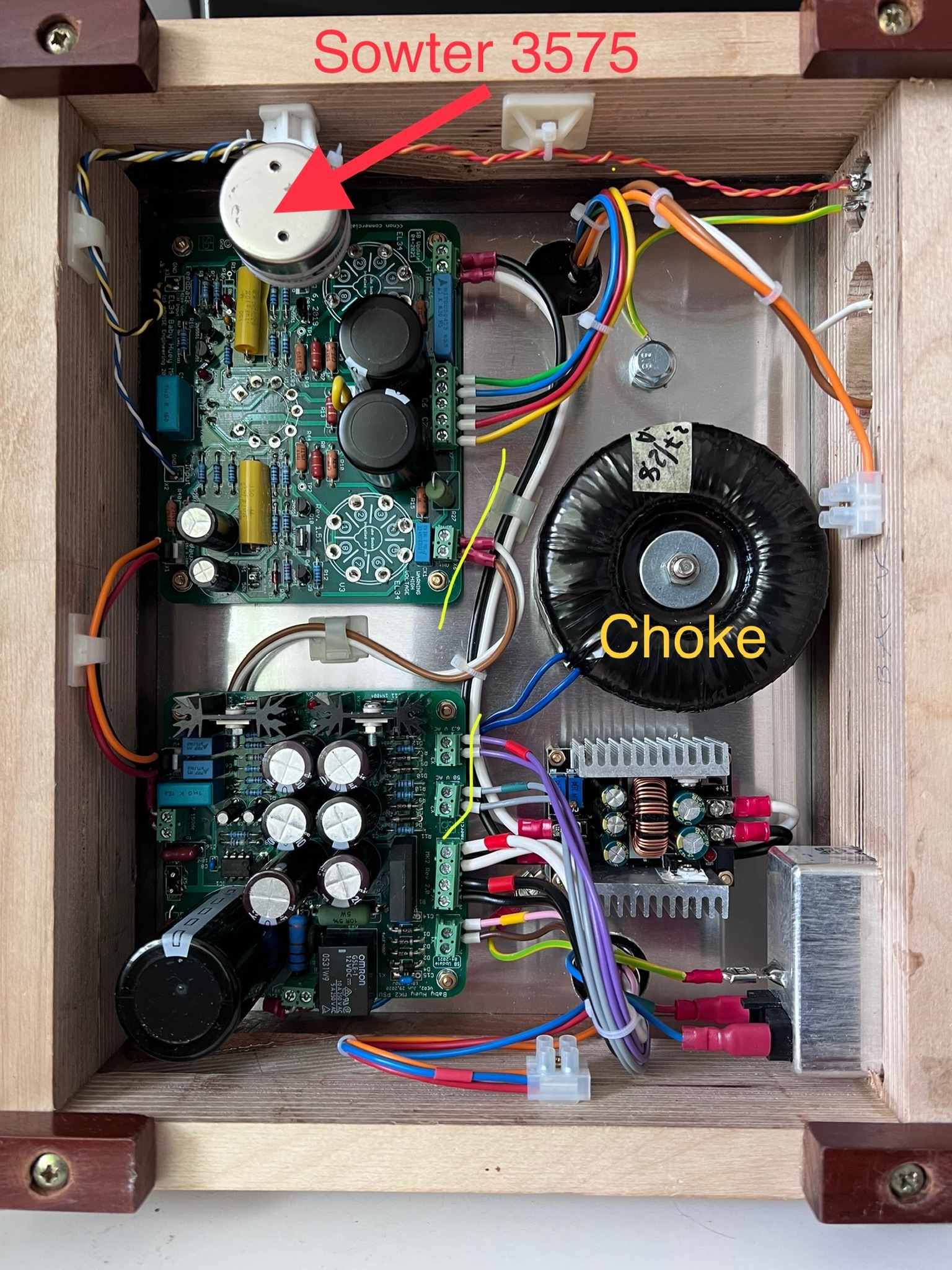

3. See attached photo for location and orientation of the 3575 input transformer (more photos in post #1,459).
Dom

Is there a B+ choke.
Where is it?
I can not find it in the photographs.
If present, where is the choke in relation to the Sowter 3575?

Mods made as per @6A3sUMMER attachment and Baby Hueys now both singing beautifully. This completes my PlyFi adventures. Many thanks to those who generously shared advice.
