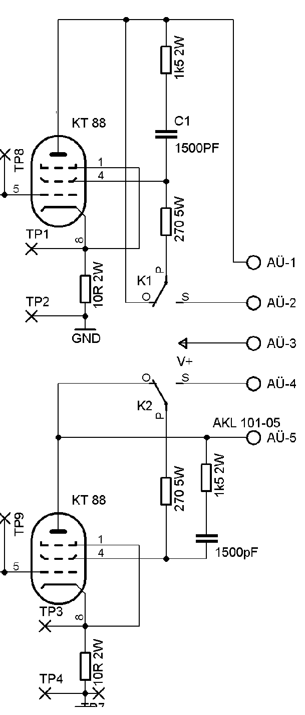

If you run the EL84 in triode mode, there's no advantage in using the BH feedback.
Shunt a-g1 feedback triodizes the curves at the expenses of driver's current capability.
Running the tubes in pentode or UL, permit to have the g1=0 curve on the very left of the V-I plot, so to have more power than triode mode.
Joining the two you can have more power than triode, but still triode-like curves, just moved on the left of the V-I plot.
This way you find your own compromize between power, gain, distortion and Zout.
Hi all! I am trying to switch from pentode mode to triode mode with relays. See photos. I will write my experiences to you. Thanks to all B-H builders.
Tanks @zintolo

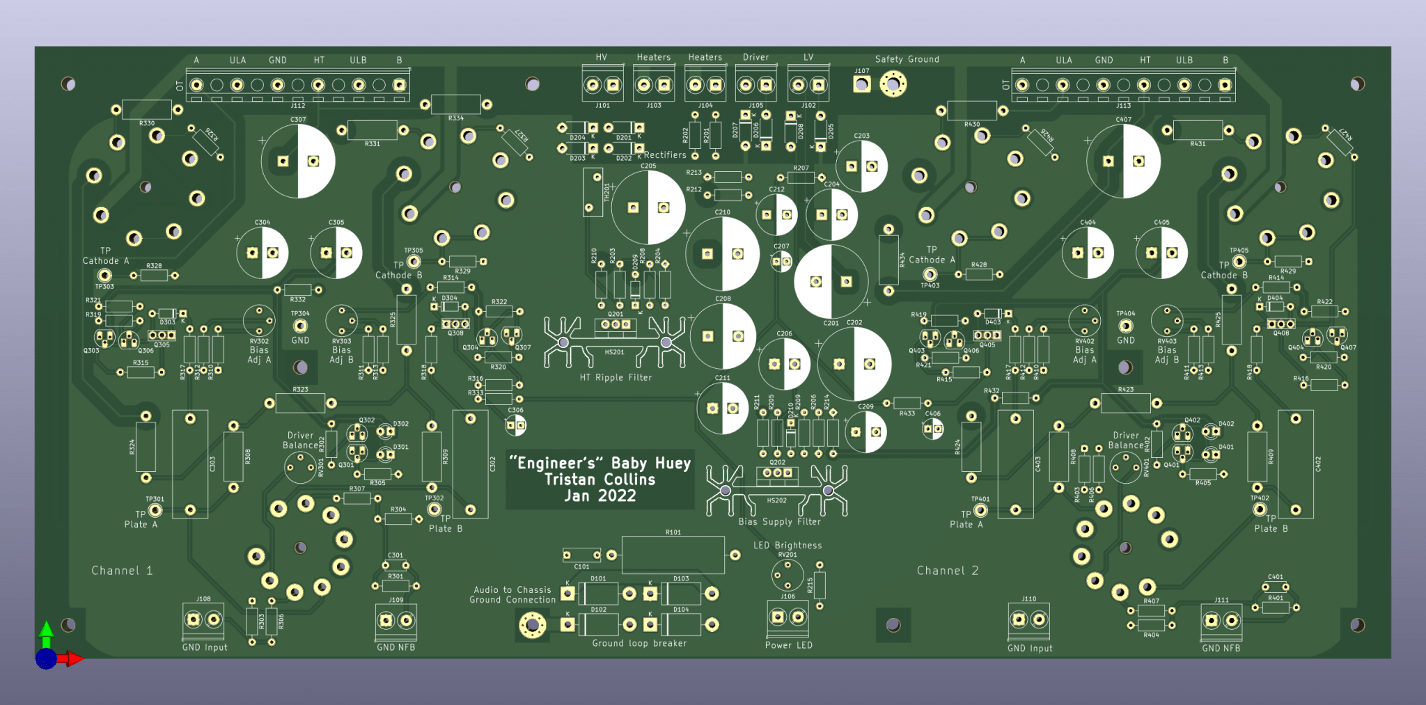

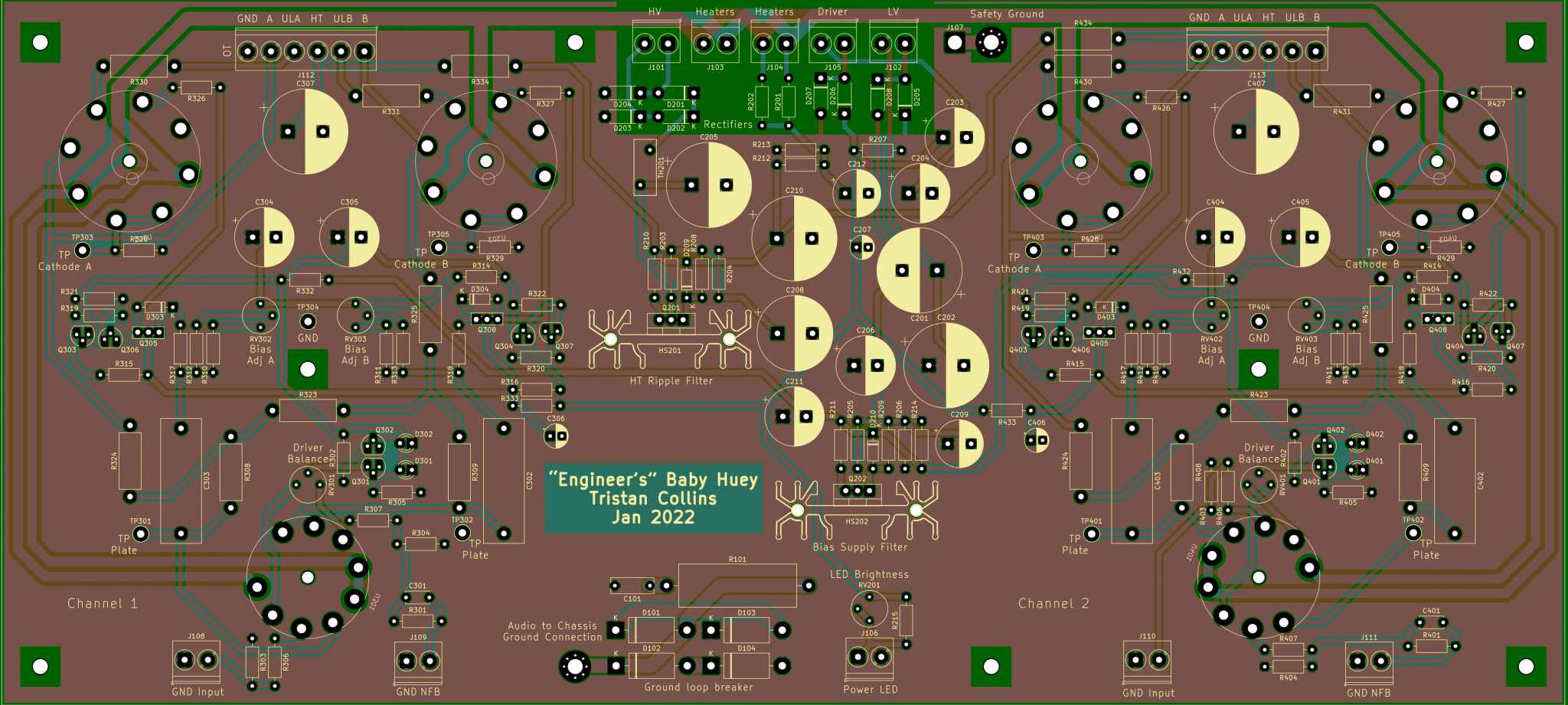

It's taken a while, but I've finally got somewhere with my "engineer's" BabyHuey. A single PCB for a stereo set-up with everything on it - much like Pete Millett's DCPP. Still some design rules to check (clearances around heaters and high voltage traces) and the mechanics (hole positions etc).
Would be keen to have another set of eyes check the layout. Attached is a recent render.
I'll post a final version and a link to Gerbers / KiCad source once it's finalised.

May I give you two suggestions based on some time playing with that circuit?
Give the possibility to use a beefier bjt for the upper transistor of powerdrive's CCSs; install a trimmer to set the current of the phase splitter's CCS; give the possibility to install 500V power supply caps; split the voltages for phase splitter's negative rail, powerdrive negative rail (together with bias), powerdrive positive rail.

This is very much draft and not complete - I'll make a release when it's ready to be manufactured / adapted (@tomlang ). Spotting issues every time I open it up!
Feel free to fork / adapt. I'm all for opensource / sharing etc and I'm keen (if this PCB works well) to have it stored somewhere like OSH Park, PCBway or Aisler where people can order their own board if they're interested: bypassing the group-buy hassle. I'd hope others would do likewise - including the KiCad source. I'll be getting either 3 or 5 boards made (depending on manufacturer min order qty) and one of those will wing its way to Australia for @gingertube .
@zintolo thanks for the suggestions. Can I clarify a couple of things, referring to the numbering in the PDF linked above:
  • Beefier BJT, is that Q306 / Q308 / Q406 / Q408? What would you suggest?
  • Trim pot for driver CCS - that would replace R302 / R402? I had thought of that early on. A 1k would give enough range?
  • What do you mean by splitting the voltage rails? I have each channel and feed isolated via a dropping resistor and cap. But haven't any isolation between the feed to the splitter and source follower CCS. "V_neg" in the schematic.
Voltages - I've placed footprints for 450V and 160V caps for the B+ and V_neg feeds, respectively. Pushing to 500V and 200V might be OK, but then I'm worried about correct trace clearances. As it stands I have ~2.5mm clearance on the B+ traces which would need to increase to 3mm - a real pain. Then I'd worry about hitting a limit on the connectors / pads to get the HV on to the board. Although @Tubelab_com might suggest going for it as-is given his work with the DCPP board.
I'm using various online calculators to calculate trace width and clearances. I can get away with 1oz copper it seems - the heater traces come out at 1.6mm assuming 3.3A per 'half' of the board, then dropping down to 0.5mm for the 0.3A runs. So I've rounded up a bit. Likewise for the HV traces - assuming ~0.2A at 400V gives tiny traces and 2.6mm clearance.
I'd really appreciate some voltage readings from a stock EL34 build - that way I could optimise some clearances and maybe trace widths. Will keep this thread / github updated.
Tristan
As for the CCS, I suggest this old but still useful document: https://www.vintage-radio.net/forum/attachment.php?attachmentid=118321&d=1452609619
Only Q306 and Q307 are needed to be rated at higher voltage and wattage, Q301 is not needed if that CCS is supplied with -15V or so, that is what is needed to work properly.
Trimpot is instead (or in series with) R302, and 1kOhm is enough.
I mean give the possibility to have E.G. -120V for the driver, +50V for the driver and -20V for the phase inverter's CCS.
I'm just getting ready to place an order for 5 PCBs. I've made a few changes suggested, but tried to keep things simple where possible. My biggest concerns are around grounding and clearances of HV traces.
The top layer is a copper pour attached to signal ground, but there are a couple of 'islands' where I can see an issue - particularly around the source followers. But as they don't use much current I think it'll be OK.
As perfect is the enemy of good I'm intending on hitting 'submit' unless anyone sees any issues.
Latest layout is here: https://www.tristancollins.me/diyaudio/ibom.html
