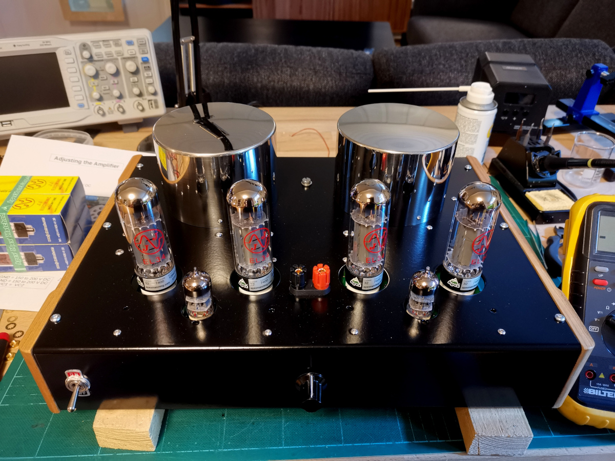

I got the chassis back from the paint shop on Friday. It was inexpensive and quick. The finish is a bit rougher than expected, but that's probably because this particular paint shop mainly deals with industrial stuff and machinery. Their main concern is corrosion protection and not so much about looks. I didn't think about that when I gave them the job. Still, it looks quite good.
Today I reinstalled all the parts, and took time to make the wiring tidy. Retested everything again, and it still seems to work (no smoke ...). Will hopefully listen to some music tomorrow.
That looks great, what are the measurements of the case?
Thanks! The dimensions are 40 x 30 x 7 cm.

Yes, they are fast! I was told they do black every other day. Apparently their most popular colour.
Amplifier now tested with appropriate music: Shared album - Trond Båshus - Google Photos
Listened to music all day (which is one of the advantages of working from home), and I'm very pleased with my new amplifier. Listened to jazz mostly (Bill Evans, John Handy, Coltrane) and rounded of with The Doors. It handled everything well to my ears.

At the end of the workday I noticed a intermittent hissing sound from the right channel, and I narrowed it down to one of the 6n2p tubes. Replaced it, and everything good. I wonder if quality control on the Soviet tubes was a bit sketchy?
