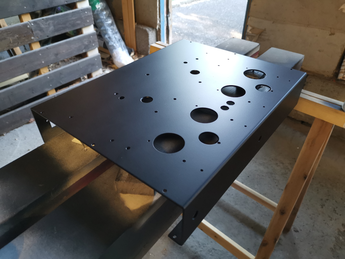

Looks great! Satin finish?
Is the wheel paint a hard wearing type? Ended up using engine paint on mine, for the heat resistance and also fairly hard wearing. I painted a couple of transformers with Hammerite after a friend gave me a few pointers, light coat and wait a few minutes and repeat until nice solid coat. (I ended up doing 3) He said don't let it dry between coats. I was impressed with the results but nervous of doing a whole chassis as well!

Yes, satin finish. It says "impact and wear-resistant" on the can. Thought it might be a good idea. I hope it's a bit heat resistant too. Wouldn't like it peel off...

I accidentally scratched the paint down to the metal with my fingernail this morning, and thought that this won't do. So now the chassis is at the local paint shop. They will sand blast and repaint it properly. Should probably have left it to the professionals in the first place.

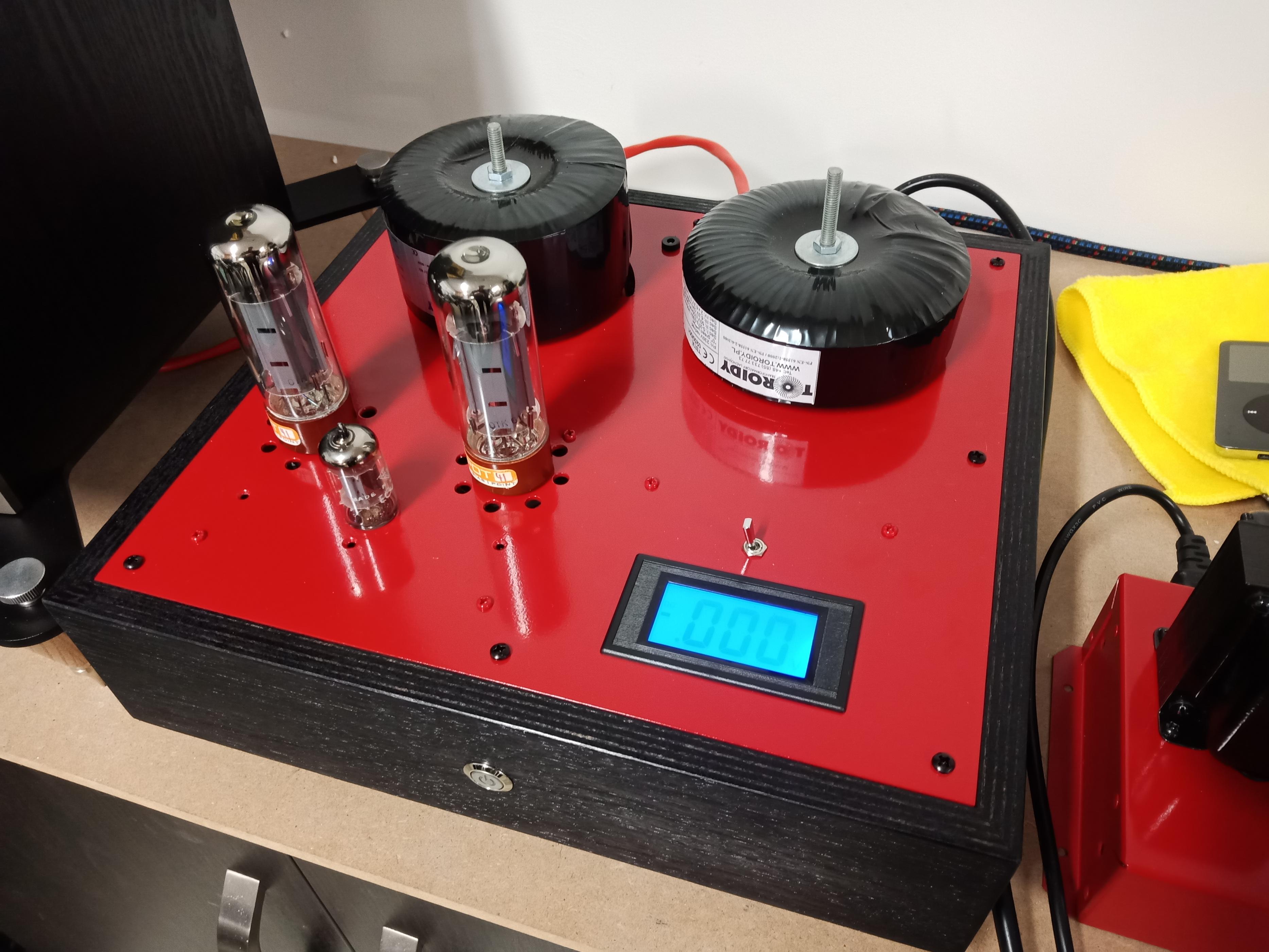

It was stated as 12W amp in the starting thread, is this still the case or was it modified?

Man that's a shame! What primer did you use? and how long did you leave it to harden off?

Output at this stage would depend on many factors though mainly, output tubes and B+ voltage.

I used a primer for aluminium, but was probably too impatient, and perhaps it didn't have time to harden.
But, as you say, it will be worth it, all things considered.

octal based Baby Hueys are generally inbetween 20 Wrms of 6V6GT (340V, 8k Raa, AB2) and 70 Wrms of KT88 (450V, 4k Raa, AB1).

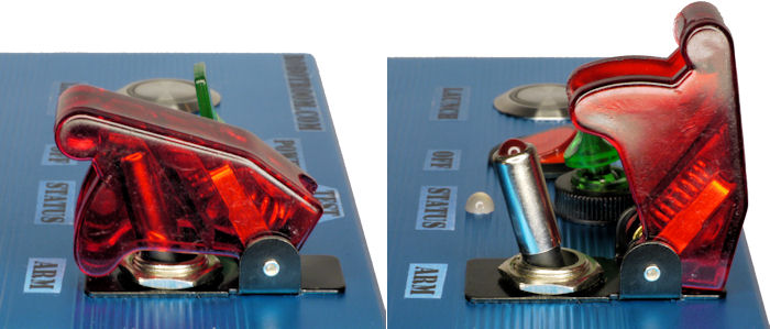

Question guys, has anyone fitted a switch between the input on the PSU PCB and the two HT outputs on the Toroidy Power transformer so that you can switch between the low and high B+?

I'd use an internal switch, not external, to avoid to accidentally set it high without changing the bias setting: you could notice a redplate too late for the tubes, plus you are "obliged" to do it when the amp is off.

I have a 3 position switch on my BH EL34 so I can adjust the B+ to 450, 425 or 400v. I set all bias currents to 0 before changing B+. I find the 400v setting with about 65-70ma works nicely for KT88s . The biggest caveat is to make sure your power supply and coupling caps can take the highest voltage setting. Running 450v means you need at least 500v caps in the PS.
