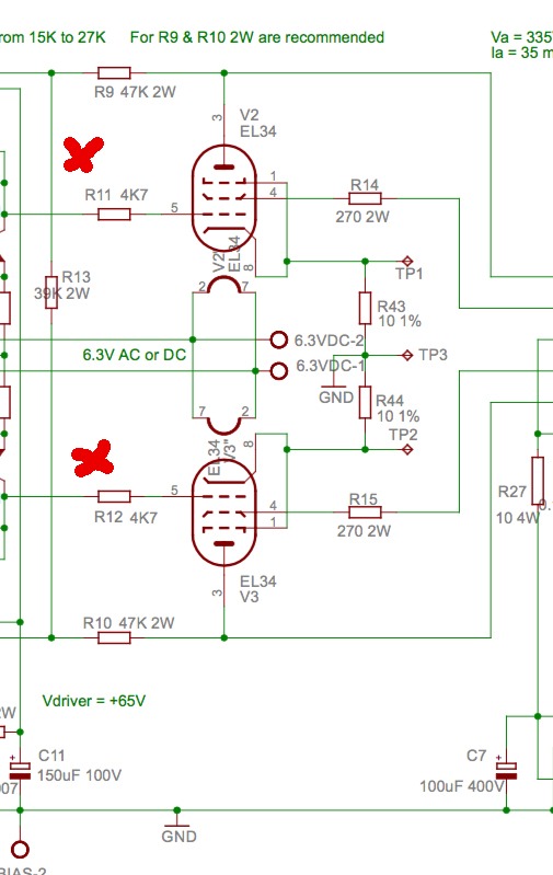

I've posed the same question time ago, with no reply.
Indeed to me they must be within 470 Ohm and 1 kOhm.
I'm using 1 kOhm on both g1 and g2 with EL34, 450V B+ and 23%UL.

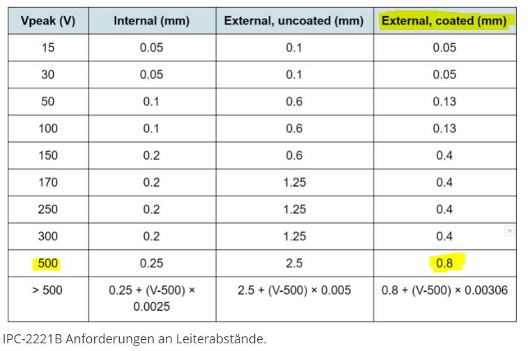

Meine größten Bedenken gelten der Erdung und der Entfernung von HV-Spuren.
Ich finde den Abstand zwischen den HV-Leitern übertrieben, schau dir die Originalplatinen an, die wurden zig Mal verbaut und keiner hat irgendwelche Probleme damit gemeldet!
Thanks - my understanding is that ‘coated’ in these charts doesn’t refer to solder mask but rather epoxy or other material intended for higher voltage use. Might be wrong.
I’ve no idea what material is being used by the cheap fab houses so better safe than sorry. Also, there’s creepage to consider. Slots etc. But I’ve ignored that…
I’ve probably been over conservative - but looking at the group buy boards I’d be nervous about some of the clearances. I’m sure it’s fine (no one reporting issues, as mentioned) but for the sake of safety I’ll err.
