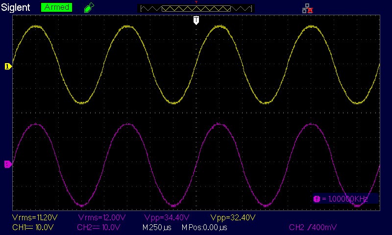

OK. I've adjusted R2 to 21K by adding a resistor in parallel which resulted in a negative voltage of about -70V under load. I also measured all the outputs from the power supply board under load:
+Vdriv 15.4V
-Vbias -70V
+HV 358V
I then adjusted the R16 to 33K (according to a table earlier in this thread). I measured the current through R16 to 1.8 mA. The tubes (KT77) are biased to 45mA.
But this didn't do much for the power output. This is just before it start clipping with a 8R dummy load:
+Vdriv 15.4V
-Vbias -70V
+HV 358V
Any ideas what else I can check? If I've made a mistake on the boards, I've apparently made it on both boards.
Tou should get twice that, approximately.
With 40% UL, plates should go down to 100V in AB1. Double check the shunt feedback resistor’s value. It could limit the power of the amp.
