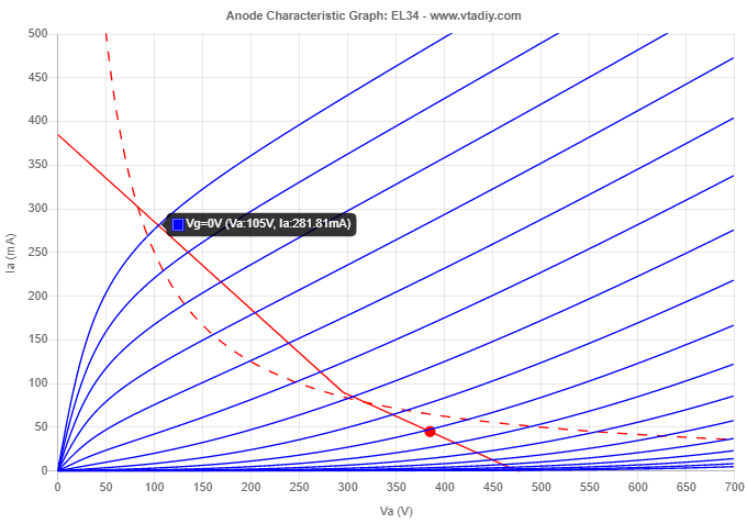

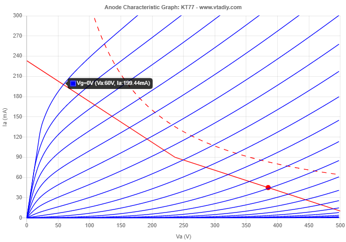

What is “that” in twice that? Could you elaborate/explain “With 40% UL plates should go down to 100V in AB1” please.Tou should get twice that, approximately.
With 40% UL, plates should go down to 100V in AB1. Double check the shunt feedback resistor’s value. It could limit the power of the amp.
This is very low and keeps the loadline of the phase splitter quite flat.The shunt feedback resistor is at 17K.
Do you have a scope to check the ac voltages at phase splitter anodes, after the powerdrive and on the output transformer?
Sure! Here it is the loadline with B+ = 385V, Ia = 45 ma and Raa 4 kOhm.What is “that” in twice that? Could you elaborate/explain “With 40% UL plates should go down to 100V in AB1” please.
I've highlighted the value with g1 = 0 V, that is with plate at 105V.
Swinging from 385 to 105V (and mirrored on the other side as well) in a push pull with 4 k Raa will give [2 x (385-105) / sqrt(2)]^2 / 4000 = 40 Wrms circa.
I've not considered the triodizing effect of the local shunt feedback on the tubes, but it was just to say that the power should be significantly higher.

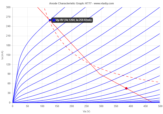

I've just noticed he uses KT77. This changes things a bit: swinging down to 126 V gives around 33 Wrms in AB1.
Same power but better response should be given by a 6.6 kOhm Raa:
Please note that the Pa here is set at 32 W for the KT77, but as far as I know, current production is 25 W like EL34.
All plots are not considering the triodizing effect of the local feedback, just the UL effect.

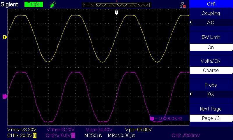

I think I possibly found something. It looks like the signal is clipped before it reaches the output tubes. The yellow channel is measured just after R11/R12 and the purple is measured at the output over the 8R dummy resistors. What should I check next?
Btw. I tried to change the shunt feedback resistor to 39K (I just removed a parallel resistor). I didn't make any difference to the clipping. I lowed the value because of advice earlier in this thread (although I can't say I heard any difference.)

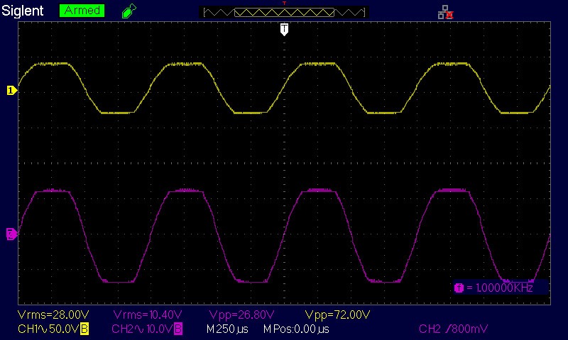

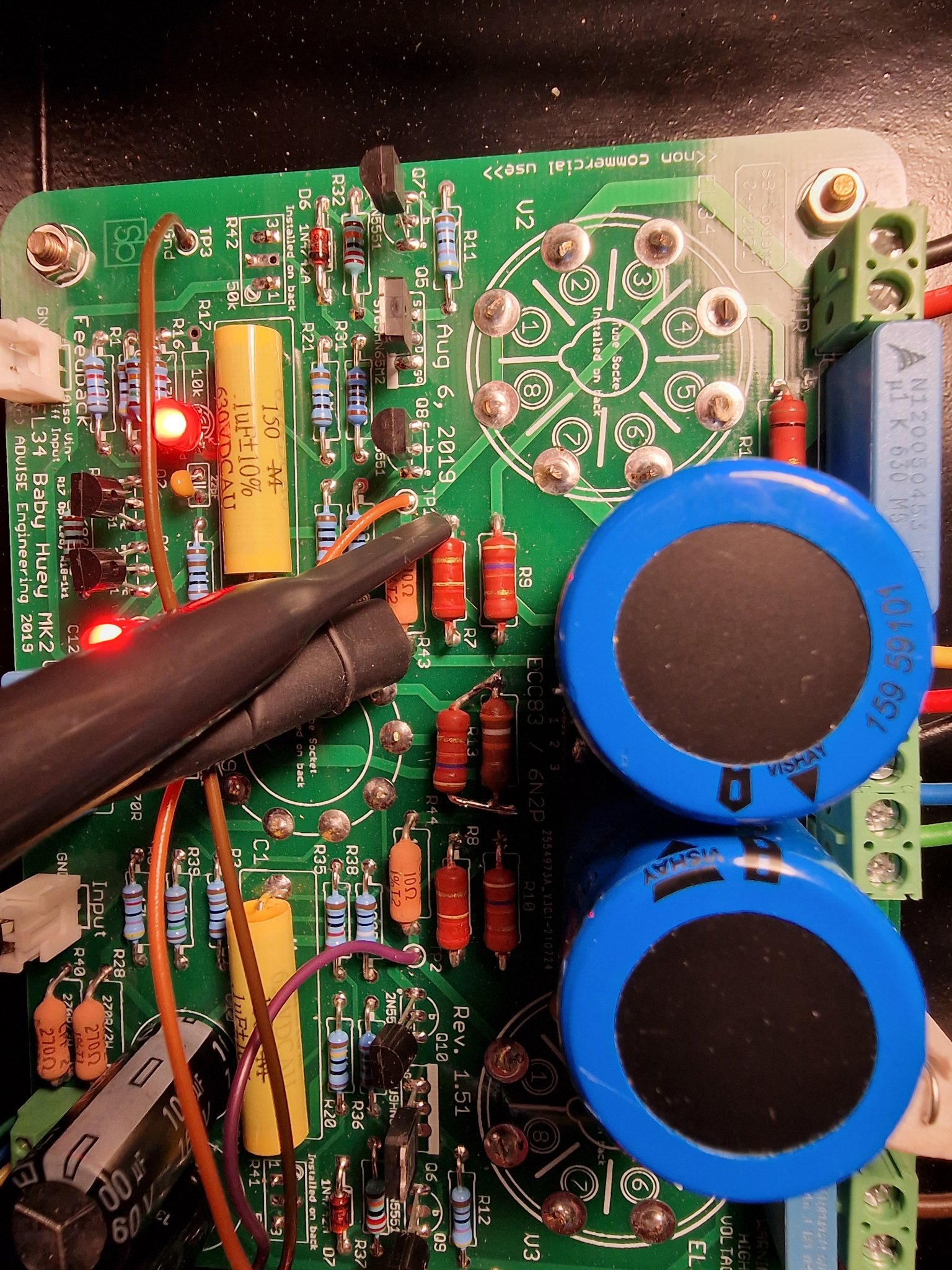

Please scope the voltage on R7 and R8 to see if it is due to the phase splitter or the powerdrive.
Thanks! I'm not exactly sure what you ask me to do, but I connected to probe to one side of R7 as in the photo at the bottom and I got this. I'm reasonably good at building stuff, but my knowledge about electronics is limited (but ask me about darkroom work and film photography...).
If this is the wrong way to do it, please let me know. I am of course very grateful for all the help I'm getting here.

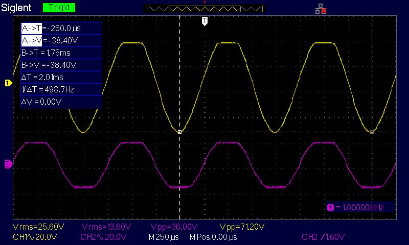

What is the highest voltage of the yellow line here? It seems asymmetric, so I would like to understand why.
The issue could be on the phase splitter or due to the powerdrive (the mosfets after the phase splitter).

It swings from -38 to +31V clipped?
This would mean that the bias voltage is almost 0 V, but BH is fixed bias.

Bias voltage was about -25 V when I measured. Anyway, the negative voltage supply is at least in a better state now. I don't understand what the issue with the power output might be, so I've decided to leave it for another day and put the amplifier back into service. The amplifier sounds great, so there is that.
