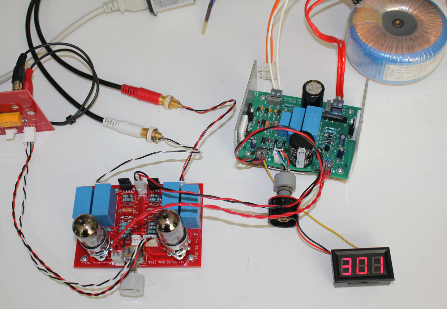

Hi potepuh,
Heater current depend of the tube used, with ECC82 / 12AU7 you need 600 mA and with Russian tube like 6N1P 800 mA is safer... If you are using a 1 A 6.3 V power supply, you are OK 🙂
For the high voltage I recommend 300 V max !
Marc
