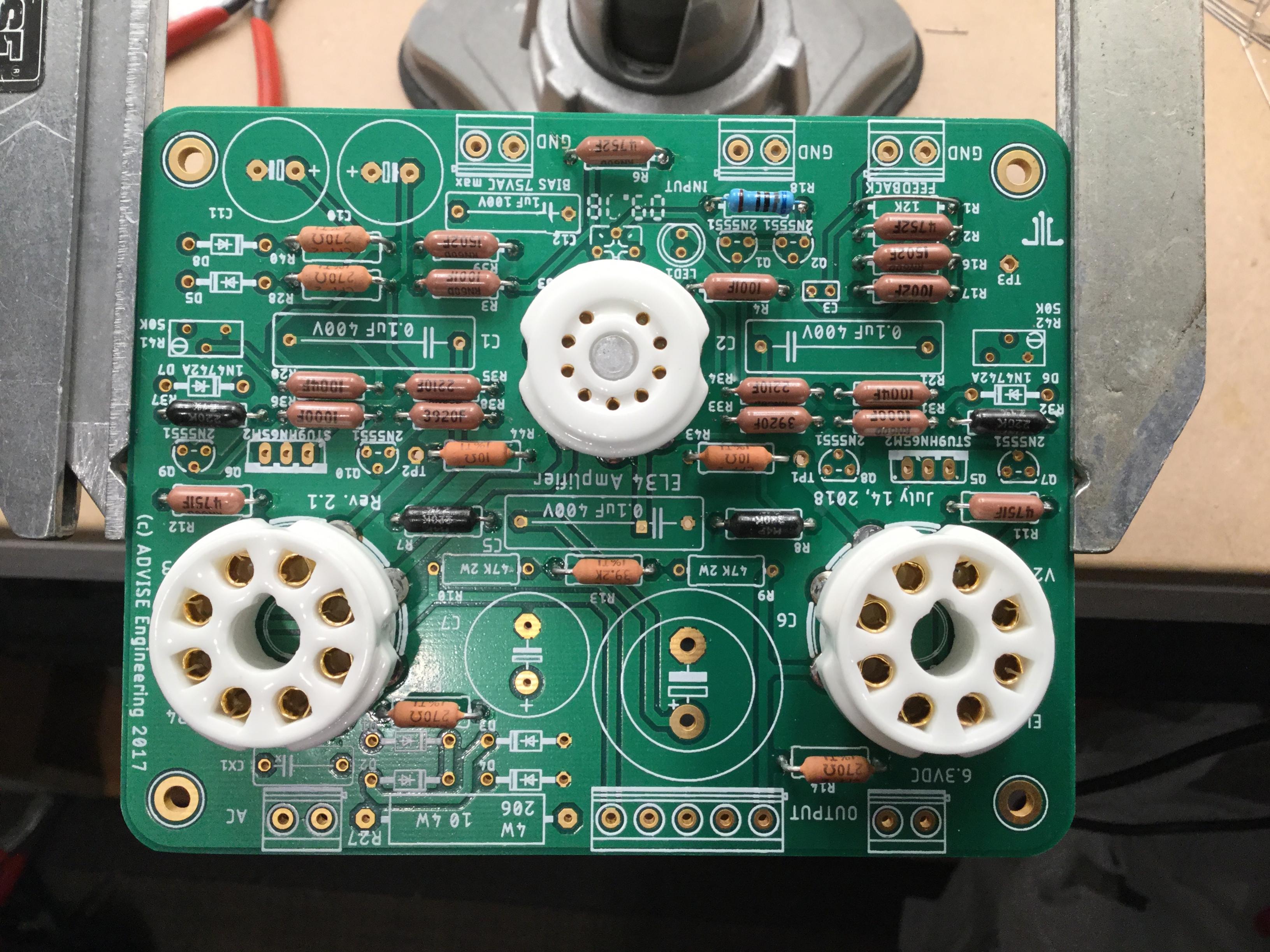

I have gotten a start on the BH 34 build. I have put in most of the resistors and the sockets. These boards are very nice to work with.
Here is a photo of the progress.
hello Bfpca,
that's a nice looking build. and also the jig seems very useful. Is it custom made or commercially available?
regards
Prasi

Thank You Prasi. The jig is an ancient Panavise. The one I am using is purpose built to hold circuit boards for assembly.
The company still exists - PanaVise Products, Inc.

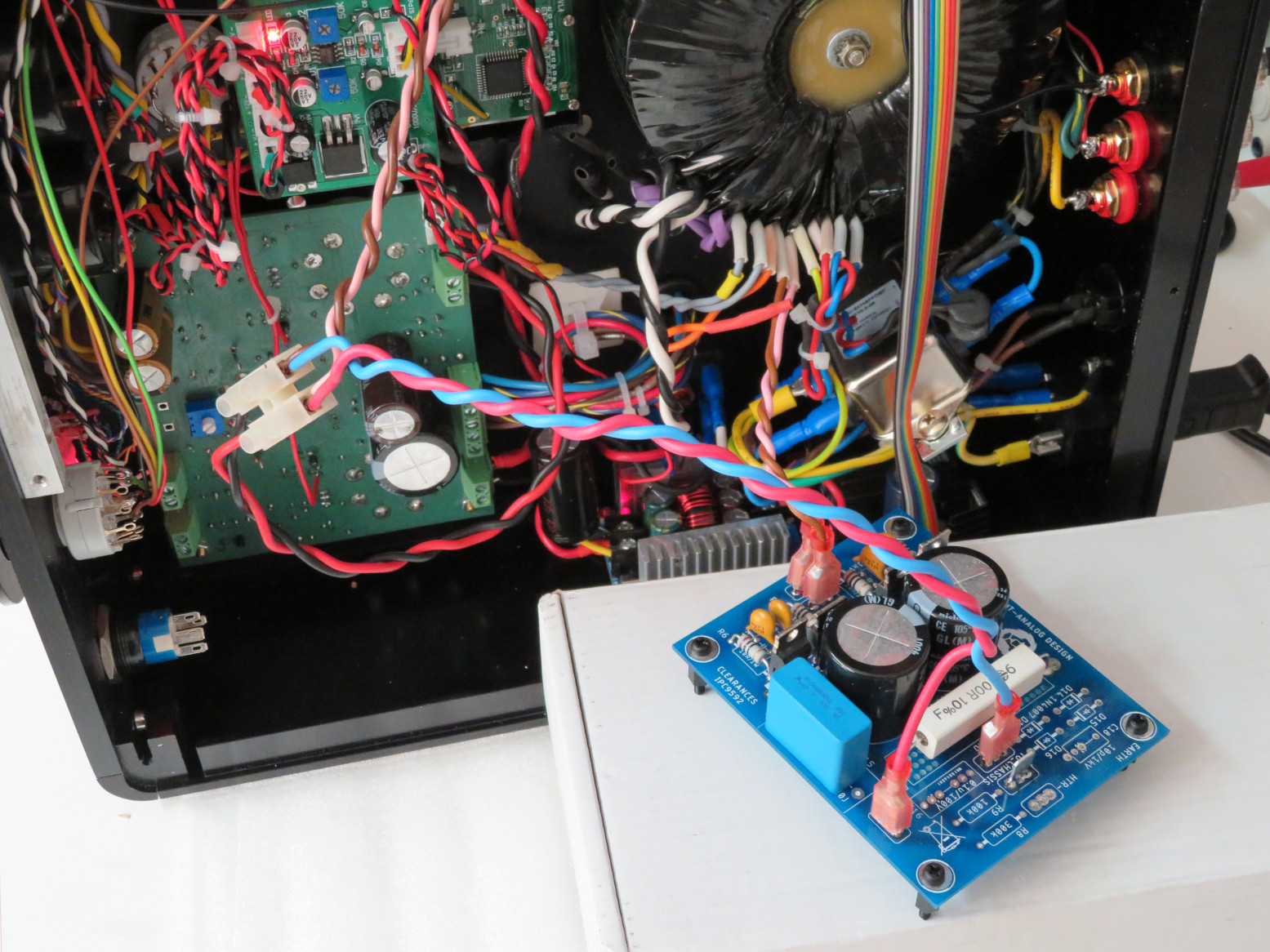

can someone confirm that there is no polarity differentiation for the 6.3 V dc input for the board?
I presume this is the heater circuit and there is no caps on board linked to this
Hi kp93300,
As meanie said, the heater connection are not tied to GND 🙂 There is no capacitor either since these lines can be powered in DC or in AC.
You must not change the LED color because the forward voltage drop of the LED define the current in the input stage ( LED Resistor Calculator ), with a red LED it is 1.8 V, if you are using a blue LED by example it will be 3.4 V 😡
As several builders like analogadikt and kolakidd have requested if it was possible to connect a power transformer with middle connection or if it is possible to add an external rectifier and a bigger filtering, I have made the test (see picture) to find if there was some improvement, and the answer is YES, it reduce even more the hum if there was some 🙂
I have used a PS-3 HV board kindly sent to me by cambe, but a simple rectifier bridge and a R-C filter can do the job.
Rgds,
Marc

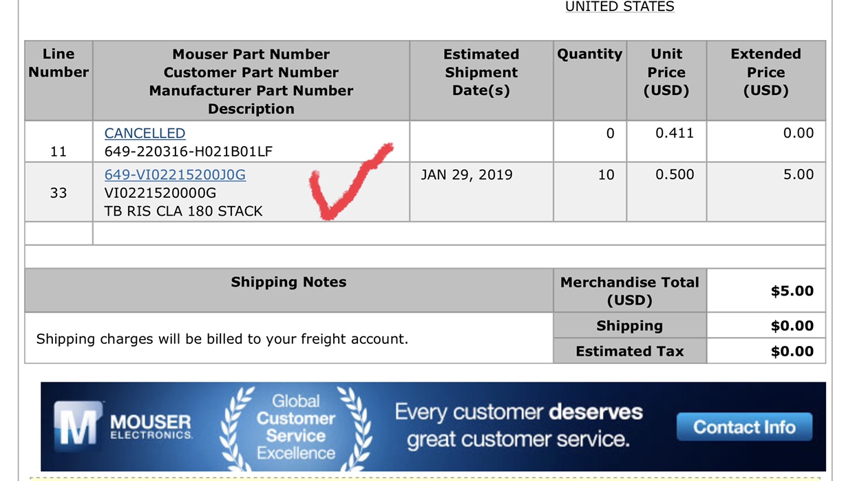

Hello Hope this is the right post for this If you ordered the mouser GB parts list and have the 10 green two pin fixed terminal blocks And you are waiting on the back order for them, as they will not be in Stock until early August . You can substitute for this part number that’s in the picture , the top line shows the original part number the bottom line with the red checkmark is the new part number that they have in stock now , it’s just a few more pennies per item but they can at least ship it out today I hope this helps out , if this is the wrong place to post this , sorry Then if the moderator could please move it to the proper post I would appreciate that
Marc,
Thank you for the support and clarification.
i have a 92 db markaudio 12P fullrange speaker.
Do you expect to hear hum within 20cm to 30 cm from the speakers ?
I want a decision with regard to offboard rectifier and filtering .
regards
kp93300
regards
kp93300

@Fabian85, I m using 6.6kohms impedance for my EL34/6CA7 Shuguang matched quads. It drives my Mistral 3/5A wonderfully.
@kp93300, you may want to use a choke/inductor in place of R27, it may smoothen your suppy rail voltage ripples. As for hum, i have tried both AC and DC heating, the DC does improves very slight over the direct AC heating, but that's in my case, it may varies case to case on hum troubleshooting.
Having external bridge rectifier and bigger reservoir caps is a plus point...But as of the current design is already a very good for a valve amp point of view.
Fix them up quick and start enjoying music !
