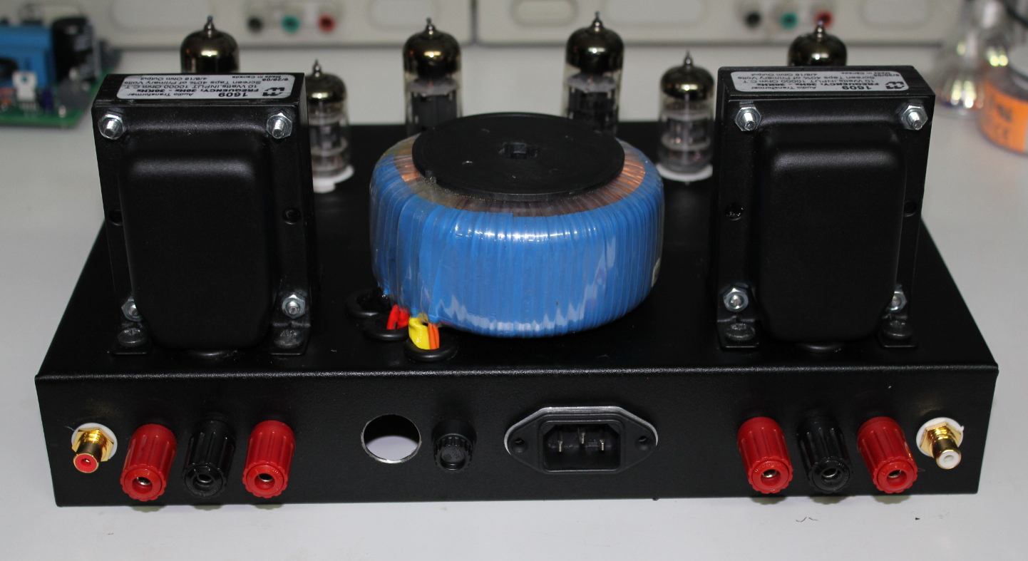

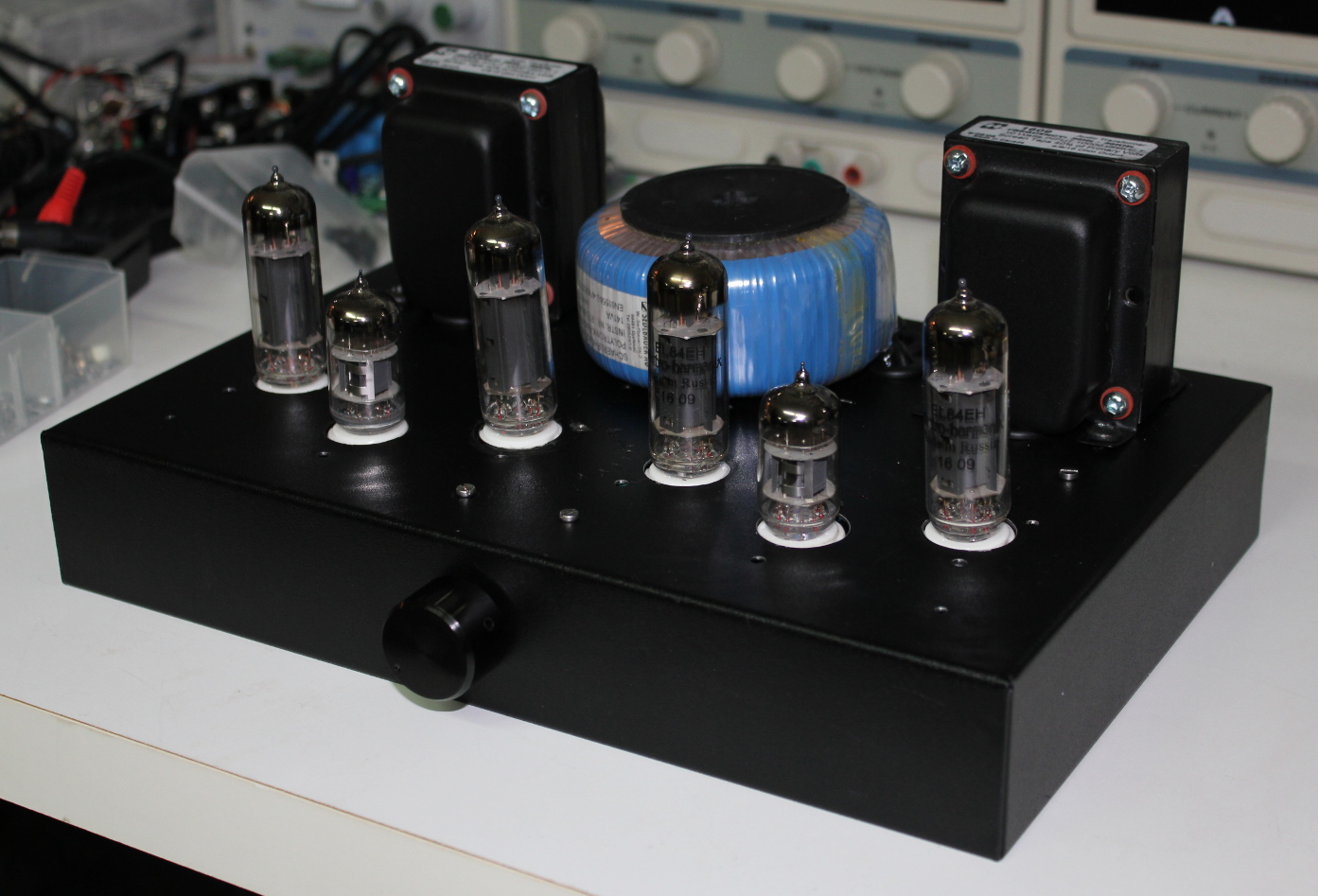

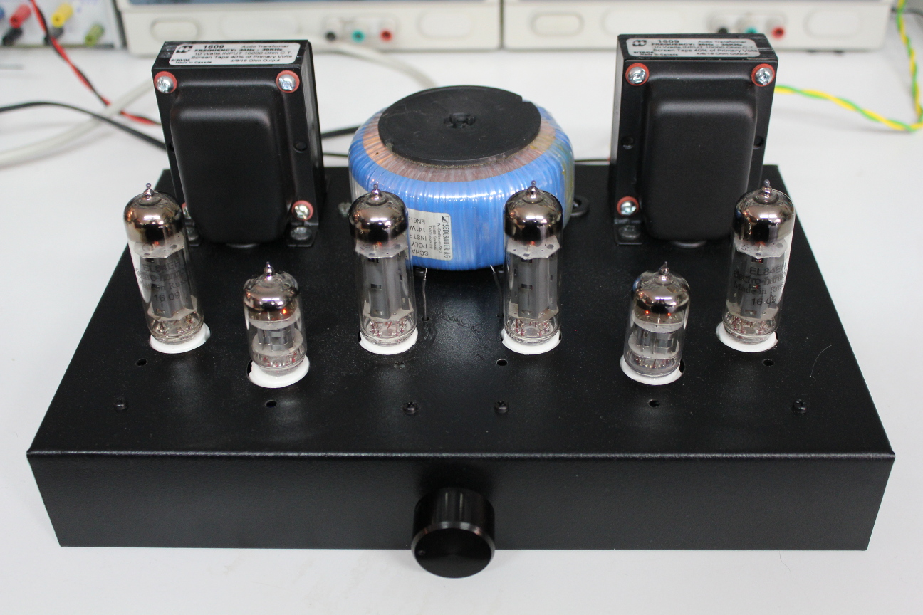

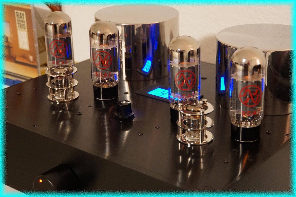

Sweet build Pvphil!!
The chassis with the Supreme Toroidy’s looks awesome.
I hope mine can look as good🙂

Hey Francois,
I’m using one per mono, and they are supplying enough current, i can’t remember how I worked out the current requirements, I’ll have to go through my notes, I grabbed a whole lot of info which may have the bias current, but In that configuration they were sufficient.

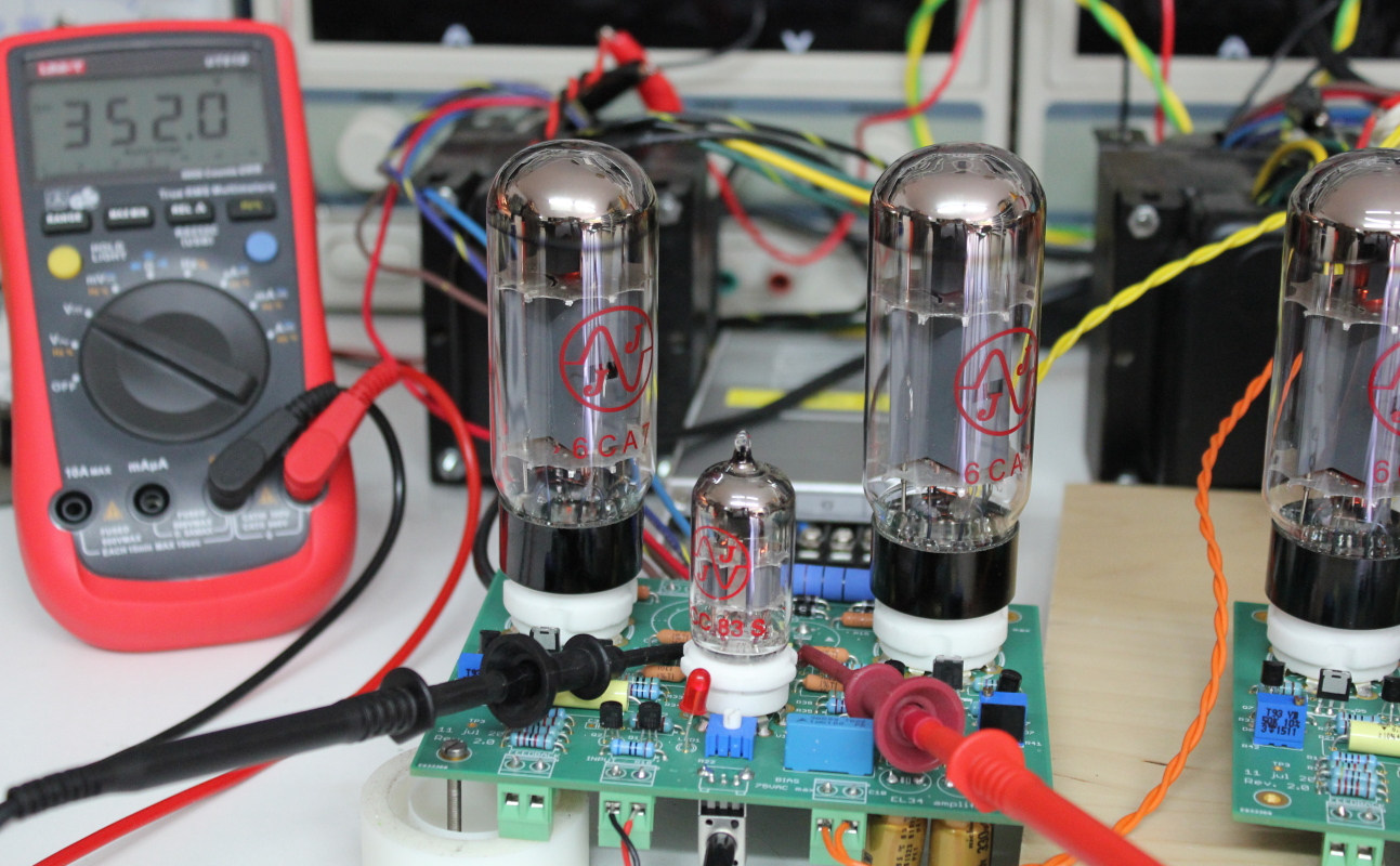

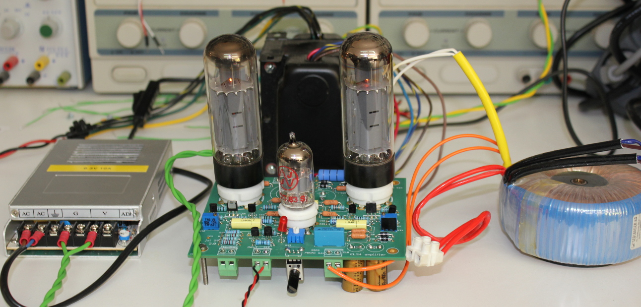

Sorry if I didn't answer before but I have been quite busy these days 😱

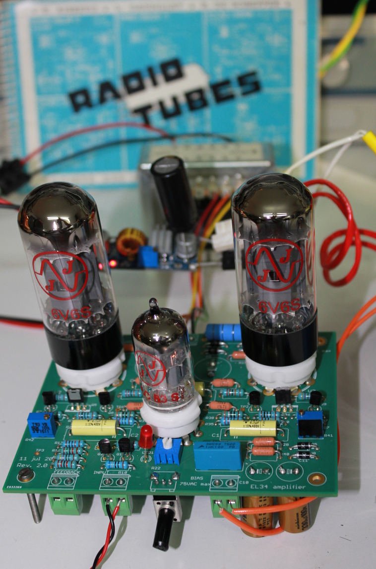

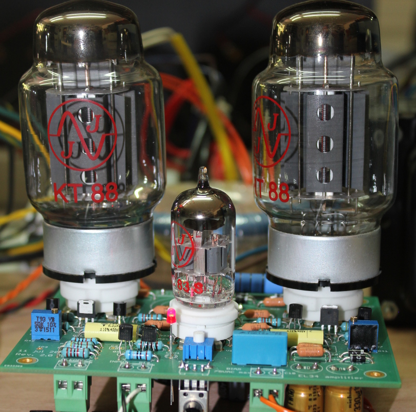

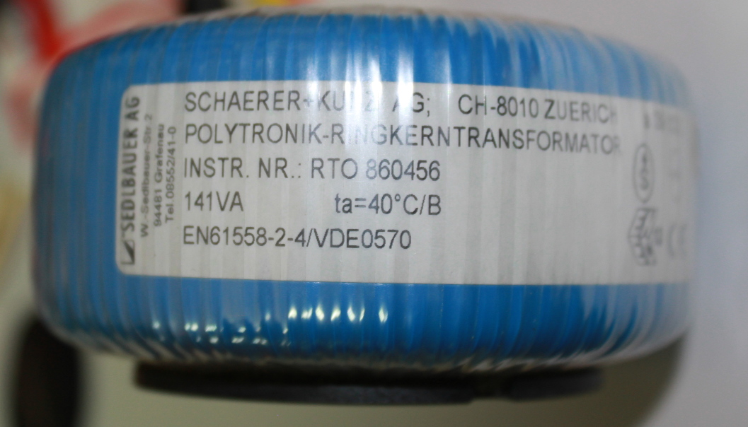

Regarding the max voltage for the EL84 Baby Huey, I think you should not exceed 350 V, this is what I had on my old prototype which used a 250 V AC custom transformer ( see photos ) ! After that you have to be careful with the bias and use a value that will not generate a power dissipation higher than the maximum power dissipation indicated in the specification of the tube ( https://www.jj-electronic.com/images/stories/product/power_tubes/pdf/el84.pdf and http://www.tubeampdoctor.com/images/File/TAD-Datasheet_EL84-STR Version1.3-08.07.11.pdf ) which is about 12 W
With 300 V, max 40 mA (12 W), but with 350 V I will not use more than 35 mA (12.25 W)... You can also use 6P14P the Russian equivalent or Sovtek EL84M which is specified up to 500 V
The 7581A is an equivalent of the 6L6 and can be used with the EL34 Baby Huey PCB since it is an octal tube 😀
For information I have tested the EL34 version with 6V6, EL34, 6CA7 (my actual version) and KT88 (see photos)...

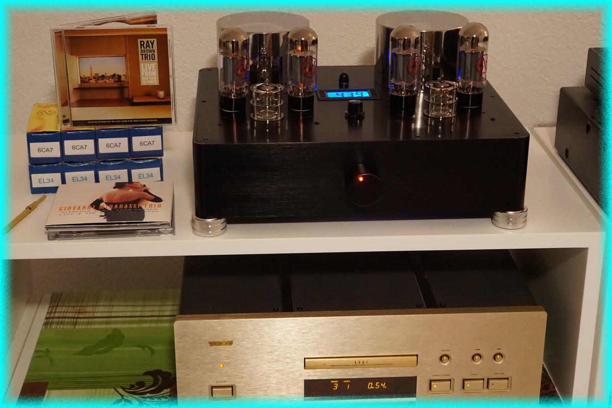

if you like the ray brown trio,try all the cd's of Gene HarrisHello,
The baby, equipped here in 6CA7, is really a wonderful music machine.![]()
It was a great project to do.
Thank you![]()
