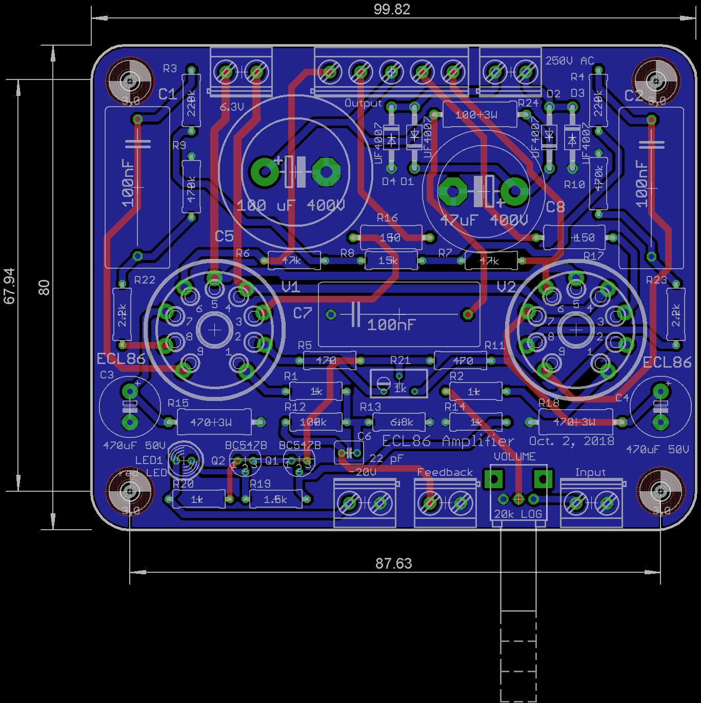

I’ve also started drawing a PCB for the ECL86 version with MOSFET followers etc. I’ll be making some changes to make it a bit more modular - taking PS circuitry and moving it to a separate board. Will probably copy a lot of the PS from the DCPP - so ripple filter / zener follower for the HT - and add in some recommendations from Merlin’s power supply chapter.

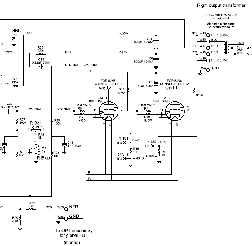

- Where are people grounding their OT secondary? The obvious place would be the Feedback screw connector to GND. But I don’t see that in photos posted.
- Secondly, if no GNFB is being used is it OK to leave R2 & R4 populated?

I don't think it is a good idea to make a PCB with MOSFET for the ECL86 because this tube is (unfortunately) no more produced and when NOS are available they are very expensive... If you really want to make an ECL86 or a PCL86 amplifier you can use the PCB that I have already given on the forum 😀
I have never used the NFB on the Baby Huey amplifiers and they are very stable without it, even when I tested the EL34 BH in pentode mode it was not necessary, that's why you didn't see it on the photos 🙂

Thanks Marc,
I take your point on the ECL86, but I'm happy to take a risk here. Comparing the cost for 4 JJ EL84s and 2 ECC83s with 4 ECL86s on a well known auction site gives marginal difference, if any. And PCL86s are even cheaper, but would make the heaters interesting. Choice choices.

For your OT secondaries, where have you grounded them? Just to the chassis or back to the PCB? I guess the return should be to the main filter cap of the channel.
I've got myself confused - on the DCPP if GNFB isn't used, the schematic shows two connections from the OT secondary both linked to GND:

But you're probably right. It would be easier with EL84s and ECC83s. This is a build which is likely to take me all of 2019 so no doubt it'll be down to what I can come across easily - iron vs valves etc.

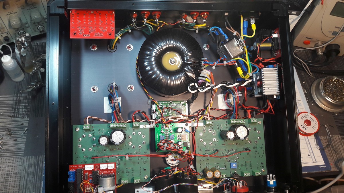

Hello,:wave:
Here it is, after that of Marc I finally finished my Baby amp. 🙂
I did not have the courage to redo implementation of LEDs, 4-input selectors and VUs, but I am happy with the final result.:scratch2:
Settings in progress, the sound is already excellent.
Happy holidays to you all. :xmastree:

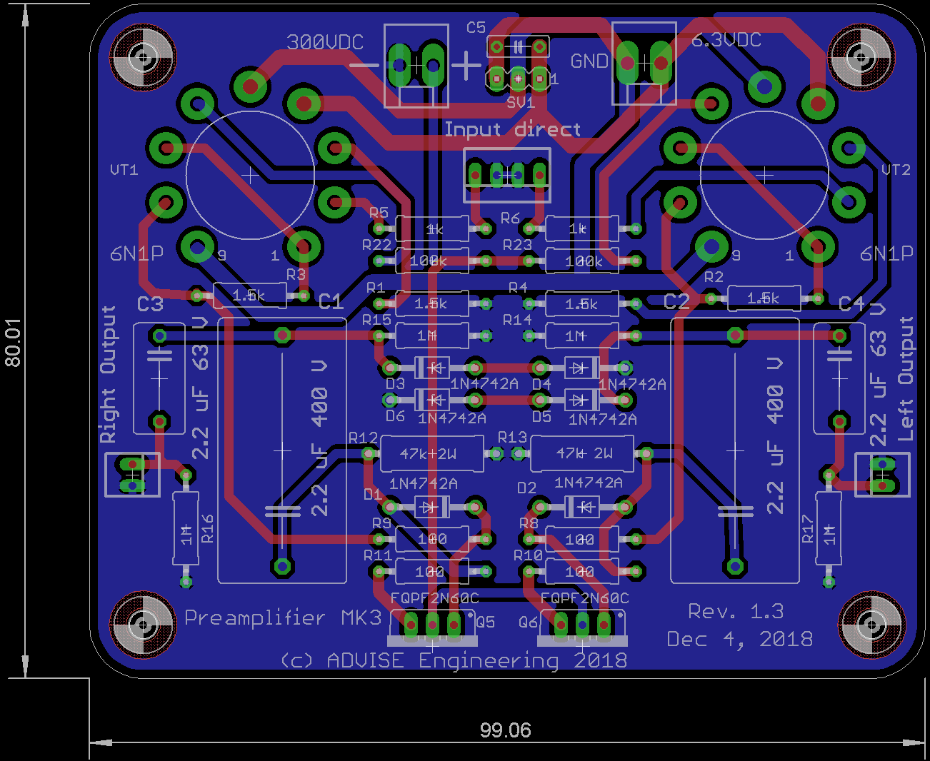

SRPP preamplifier MK3
Hi Eric,
I didn't publish the Gerber files because I didn't received a lot of inquiries and I have sent them directly to those who contacted me by PM 🙂
To make it simpler I put the Gerber files with this message, however while I was working on version MK2 of this preamp, I found that I didn't biased the heater voltage to about +50 to +75 V to limit the voltage between heater and cathode 😡 Normally this voltage in limited to 100 V on most tubes ! I should say that I didn't had any problem with this voltage on my prototype, with 295 V power supply I had just 90 V on the top cathode, but it will be safer to take it in account 🙂
I would like also to remind you that I didn't build and test the version MK3, but it is just a more compact version with less than 10 cm to make it available at lower price (5 $ for 10 pieces) from PCBWay, however you have to check it and there is always the risk of layout error 🙁
Good luck and publish pictures please...
Happy new year to you and all others Audio friends :cheers:
Marc

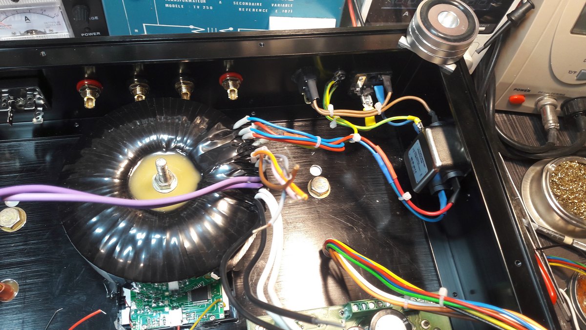

Hi Philippe,
Very nice EL34 Baby Huey with the TOROIDY Transformer, much more beautiful than mine with the Hammond that I had in stock and that I have used 🙁
I am now impatient to build the QUAD KT120 Mono Blocks with the TOROIDY CFB transformer that I have already bought 🙂
I put again the picture that you take of mine for easy comparison on the same page...
Happy New Year 2019 with new exciting projects 😀
Marc

Hi Marc or Prasi
Not biasing the heater will be problematic after a while (from what I read) and will damage your tubes. Would it be a pain to add the 2 required resistors and connect thei junction to one side of the heaters ?
Resistors could be as exemple 220k, 2W and 75k, 1W going to gnd.
Please confirm if you can so I can give it a go w pcbway. If you can’t I will hardwire it.
Maybe SV1 could be removed and that empty space replaced by the 2 resistors
Eric
