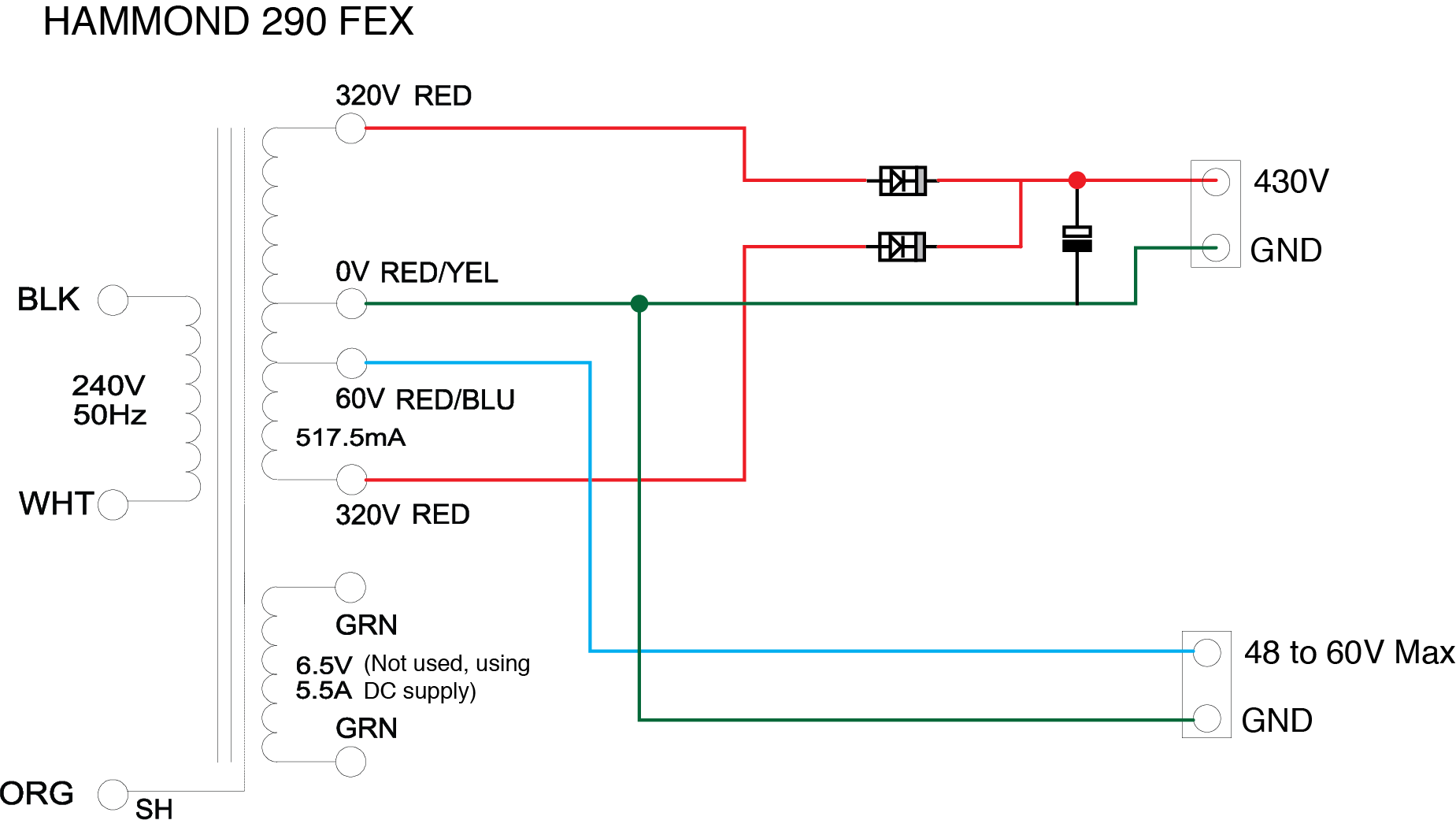

Would this transformer be acceptable for the 6N1P Preamp MK2?
http://www.antekinc.com/content/AS-05T240.pdf

Bonjour Vunce,
Yes, this will be more than needed and you can use a regulated power supply like on the picture... The tube shield are not required, I have just tested them but that does not change anythings, there is no noise anyway 🙂

Hi Sunil,
Except if you want to make mono blocs, it is useless to separate power supply for each channel and if you do that you should also separate 50 V AC power supply because one of the line is connected to ground !
As you say it's a waste of time and money 😀
Marc

Did you keep the on board diodes for safety ?
Don't forget to connect the 50 VAC GND on the GND side of the BIAS connector...

Hi, yes, I kept the diodes, I figured you had a good point, I generally work late at night so it's good to have a safeguard 😉 and yes, 50VAC is connected as you said.

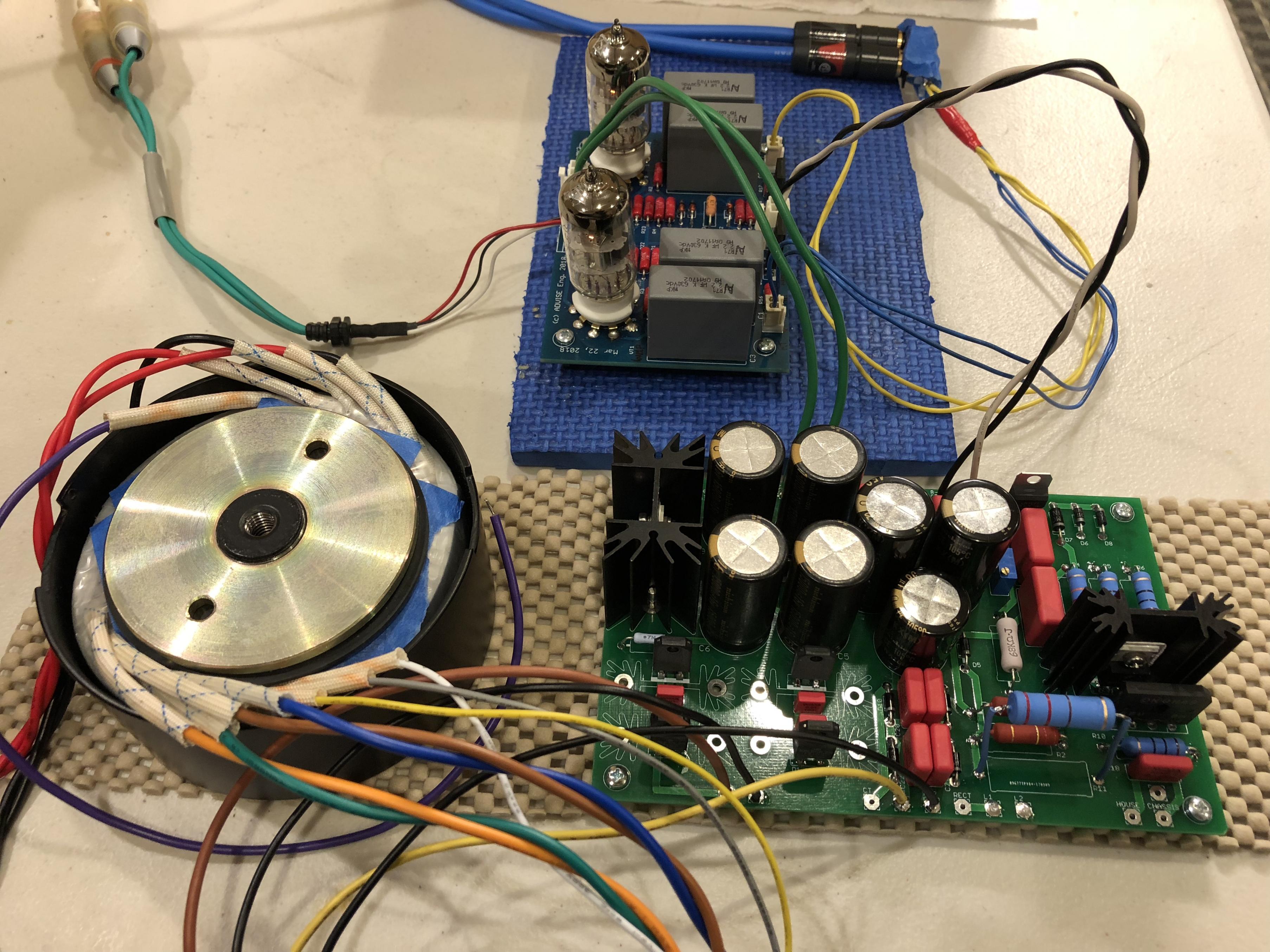

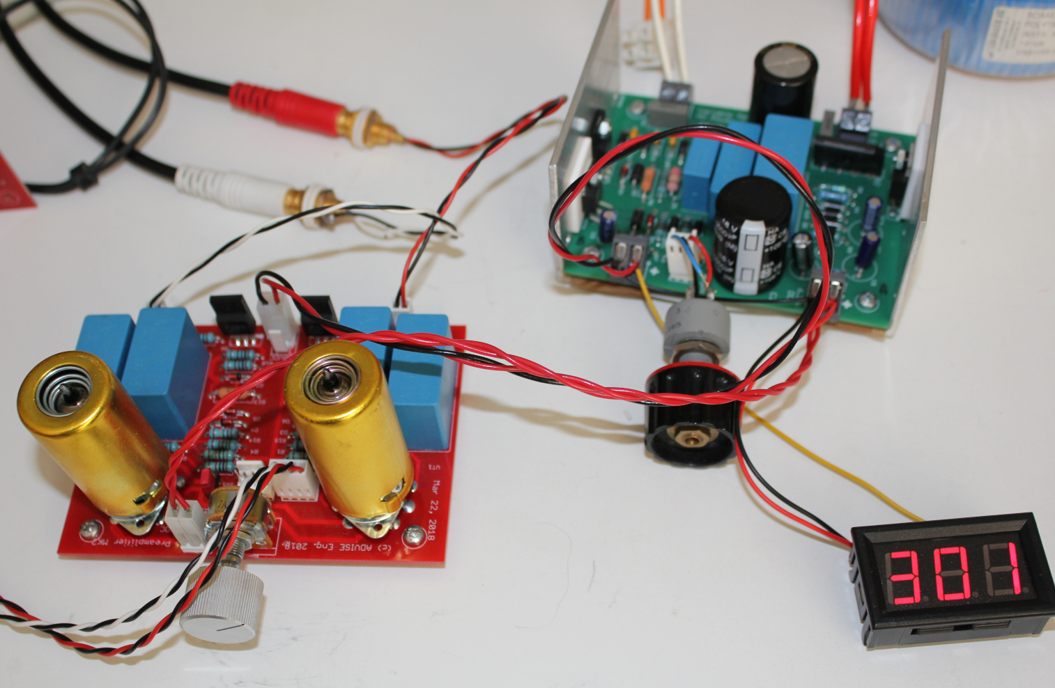

Hello Marc,
I’ve successfully fired up the 6N1P preamp you shared. I’m listening now as I compose this message. A steaming iPhone as a source and an Icepower class D amp complete the testing combo. The sound is sweet, no harshness and very quiet background.
Here’s a little information about the preamp project:
Antek AS-05T240 trafo is utilizing the 240vac HV tap and the 6.3vac secondaries are paralleled for max filament current. The PSU board includes both the HV and LV supplies. What’s really cool about this board is it uses an ultra low dropout regulator for the filament heater supply which enables you to use your 6.3vac trafo secondary and still get a regulated 6.3vdc. Not possible with a “regular” voltage regulator. The 240vac tap yields approximately 315vdc and with a turn of the trim pot it’s spot on 300vdc. The schematic called for an IRF740 MosFet but, I used an On Semi FQFP2N60C that was listed on the Bom, I hope that will not be an issue?
My main purpose for this preamp project was to give my Big MoFo a different “flavor”. The MoFo is paired with an AKSA Lender Preamp and sounds amazing. I just wanted to try a tube pre with it. So, the next step will be to try that combination
Thank you Marc for sharing this preamp design!
Vunce
Vunce

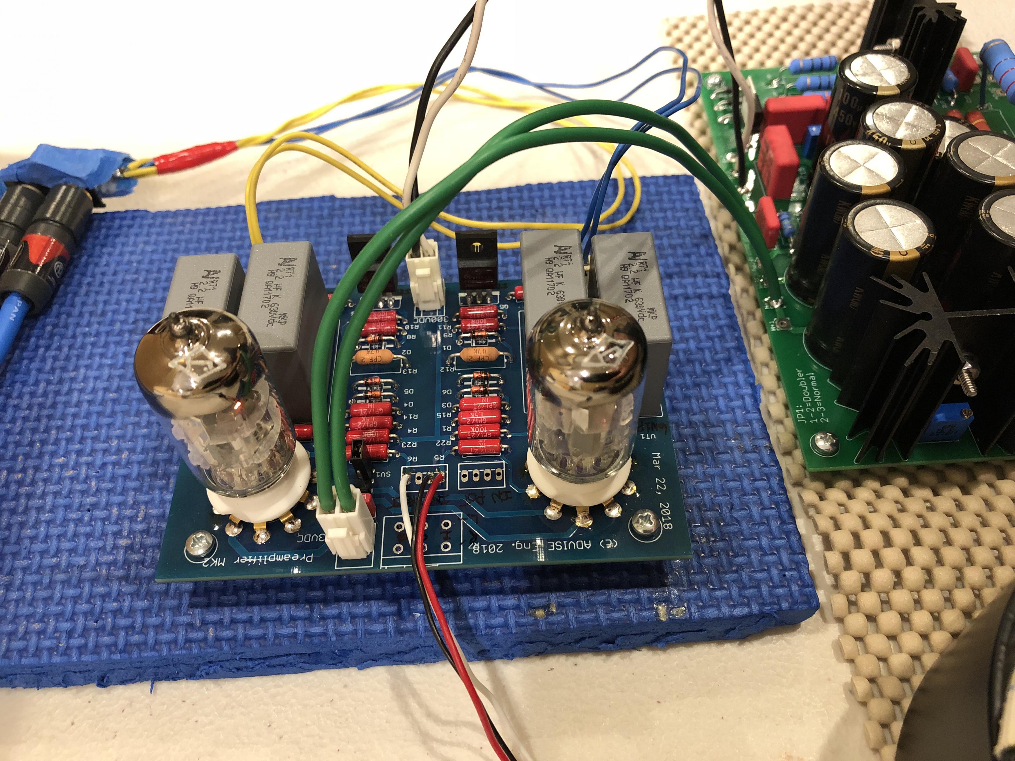

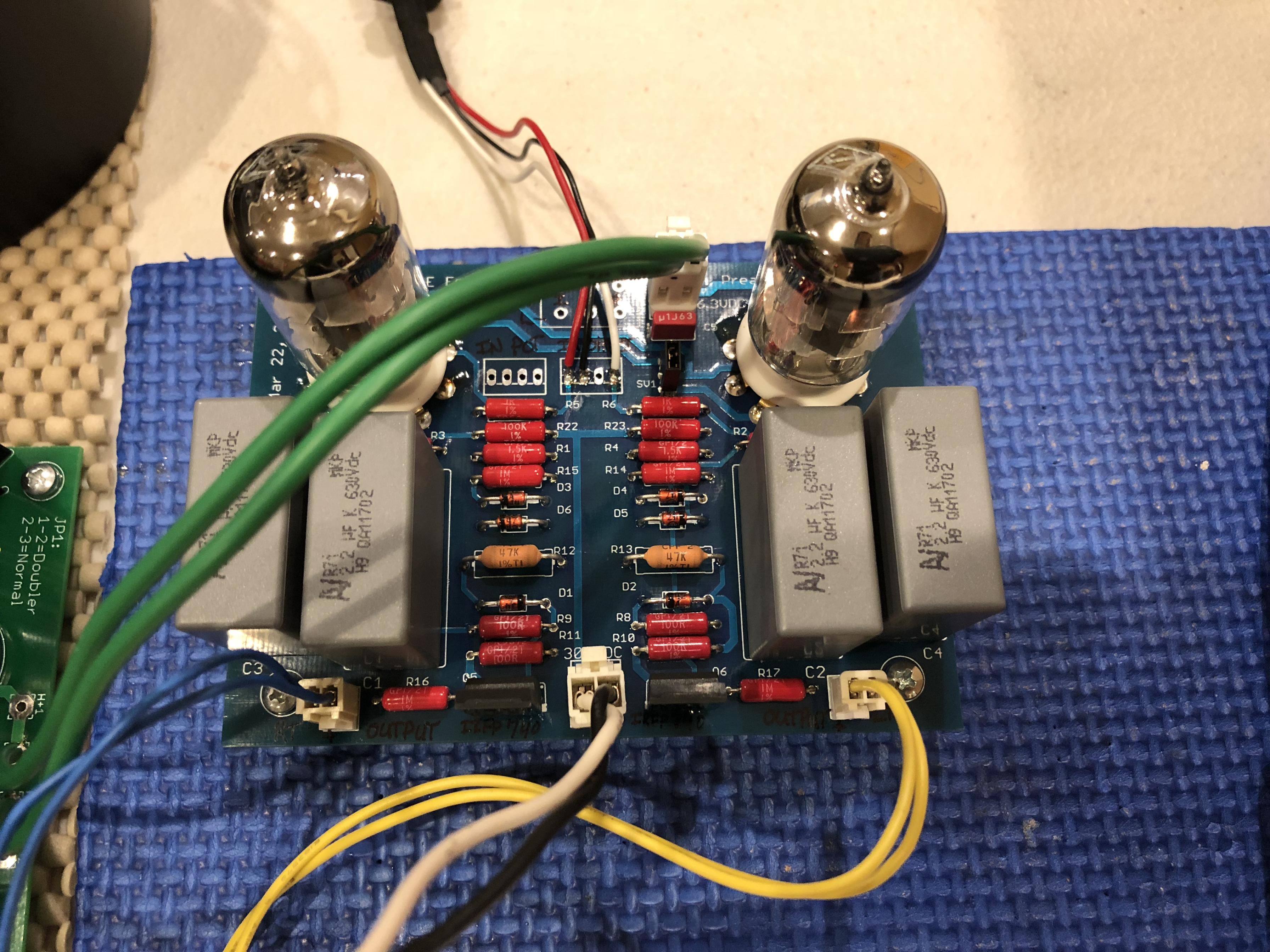

Hi again Vunce,
I forget to ask you, what are the red resistors you are using on your board, are they PR9372 Audio Resistor manufactured in Mediapolis ( https://hfc-fs.s3-eu-west-1.amazonaws.com/s3fs-public/pr9372_datasheet_0.pdf ) or an other type ?
Marc

Hi Marc,
Thanks for the kind words🙂
Yes, they are PRP 9372 series, 1/2watt resistors and fit the pad space perfectly.
I’m using a pair of low quality 6N1 tubes at the moment, I’m waiting on a set of matched 6n1p-ev tubes. By moving the SV1 jumper this will allow the use of 12au7 tubes correct? I have several of those to choose from.
Vunce

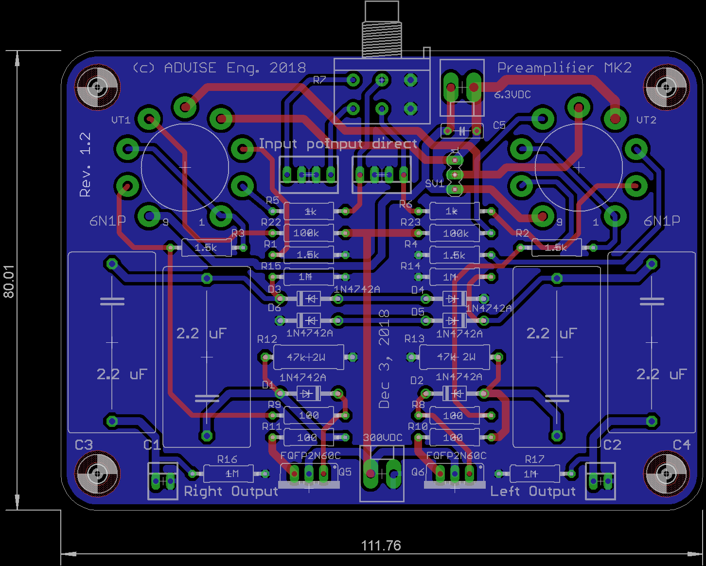

Bonjour,
Here is a slightly modified version where I corrected the MOSFET reference and added round corners 😀
You can also find the value of the components on the silk screen 🙂 They were not on the PCB because my previous board manufacturer removed them !
While I was looking at the PCB, and since now I produce them by PCBWay I was thinking to shrink the board to reduce the size to 100 x 80 mm to have a better price of 5 $ for 10 PCB
If I have time I will look at it, by example the second output capacitor can be 25 V only since it is protected by the zener diode...
Marc
