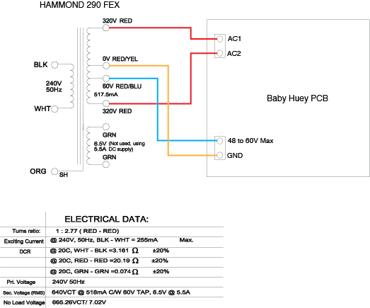

I've finished populating the boards... but I'm having "connection anxiety" with the 290FEX, I don't really feel like toasting anything. I've done a basic drawing of how I see it connecting, but I just wanted to get confirmation.
If I have it wrong, I will redraw and re-post correctly.

WARNING DANGER!
You MUST NOT connect your transformer this way
The on board rectifier is a bridge, if you connect the Baby Huey like that you will have 600 V AC on tha AC input !!! It is far too much.
If you are using a transformer with 2 x 300 V output you must use two external diodes to feed the BH with about 420 V DC (with 500 V capacitors) !
Don't connect your EL34 Baby Huey like on your schematic, you will destroy it 😡

Thank you, seriously! Completely understood. Nothing is connected yet, and yes the board is populated with 500v Caps.
I'm basically trying to figure out the optimal way to use the 290FEX. I may just have to revert to another transformer. What I think you're saying is bypass the PCB bridge and use a Full Wave CT bridge.
You don't need to remove the on board diodes, they will protect your module in case of wrong connection 🙂
You can refer to the following document to connect your Baby Huey : Design Guide For Rectifier Use - Hammond Mfg. In your case you can use the "Full Wave Resistive Load" schema !
It is better to add an external capacitor for a good filtering...
Or you can use a transformer like the Toroidy TSTA250-001 that include all the voltages for the EL34 Baby Huey : TSTA 250/001 TOROIDY - Transformer: toroidal audio | TME - Electronic components
