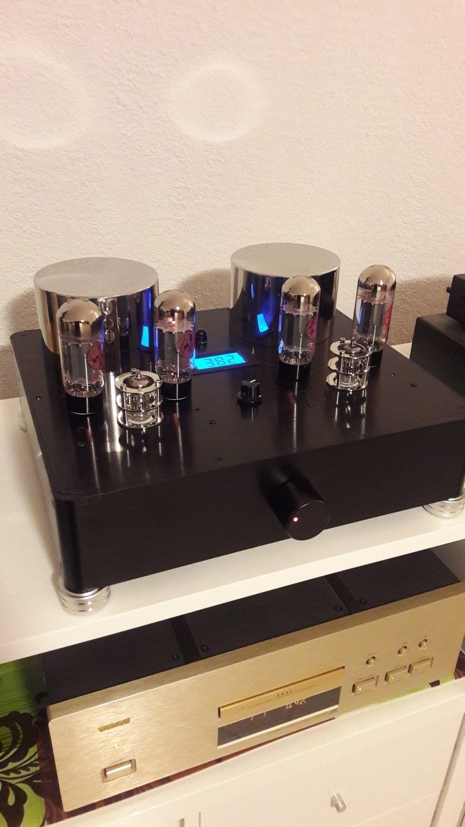

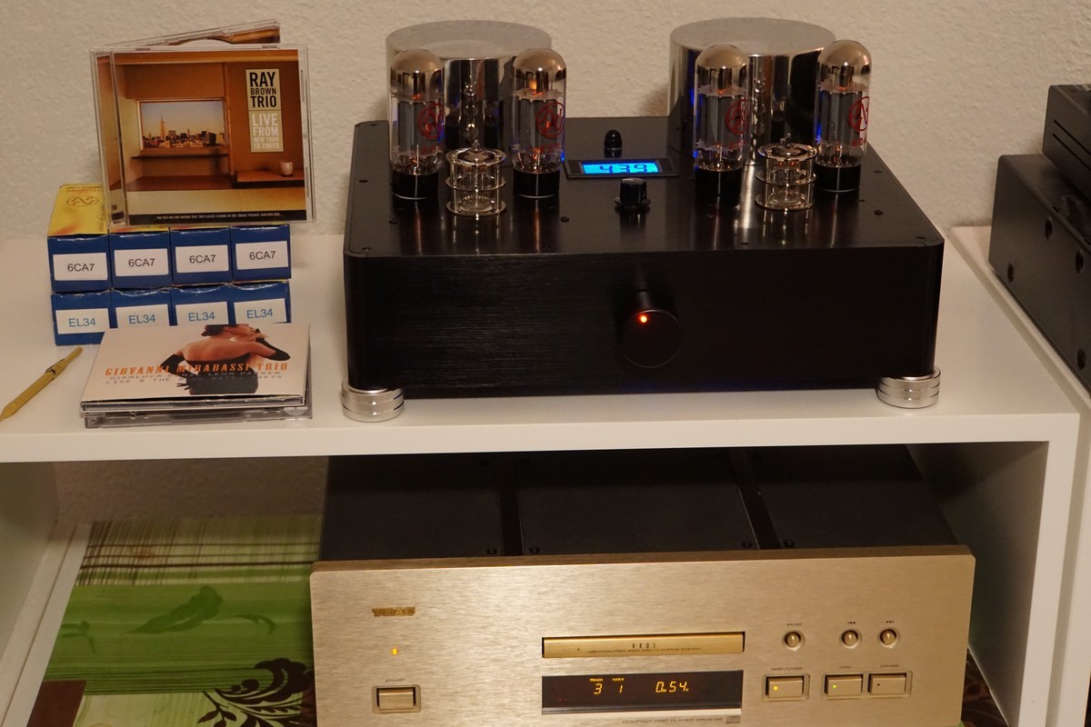

meanie,
thank you for the info.
i am thinking of housing the BH in a metal case.
Is it better to place all the trimmers on the bottom of the pcb ?
incidentally, I just completed the Marantz 7 clone also. wonderful sound partnered with MOFO !!

Hi meanie, Fabian85 and kp93300,
Thanks you meanie for answering others builders questions 🙂
For TOROIDY output transformer, it is possible to use both 6.6 k and 4 k version, in fact TOROIDY recommend the 6.6 k for the EL34 and the 4 k for the KT88 which is strange because the two tubes are very similar 😕
On my EL34 Baby Huey I have used a Hammond 1650N transformer that I had since a lot of time... It is specified at 4.3 k ! For TOROIDY, I would prefer the 4 k version because we are using a quite low voltage, between 350 and 450 V DC.
For his EL 34 Baby Huey, pvphil is very happy with the 4 k transformer (see post 238), he has added a very small external circuit for the high voltage (see picture) and has absolutely no hum, ask him 😀

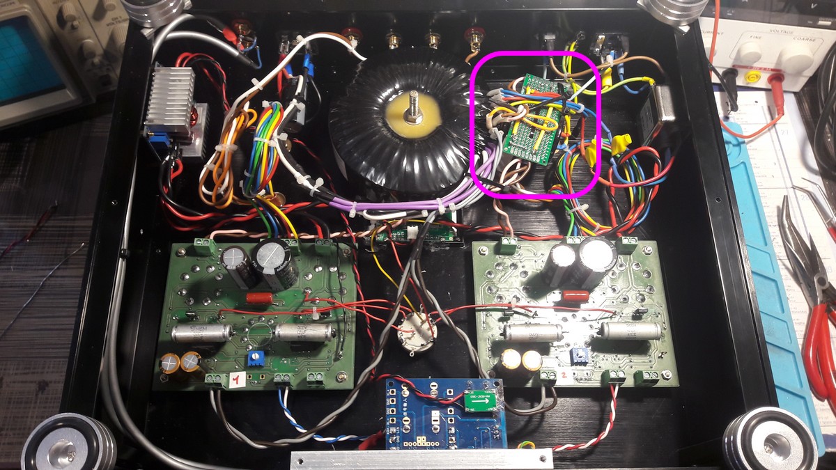

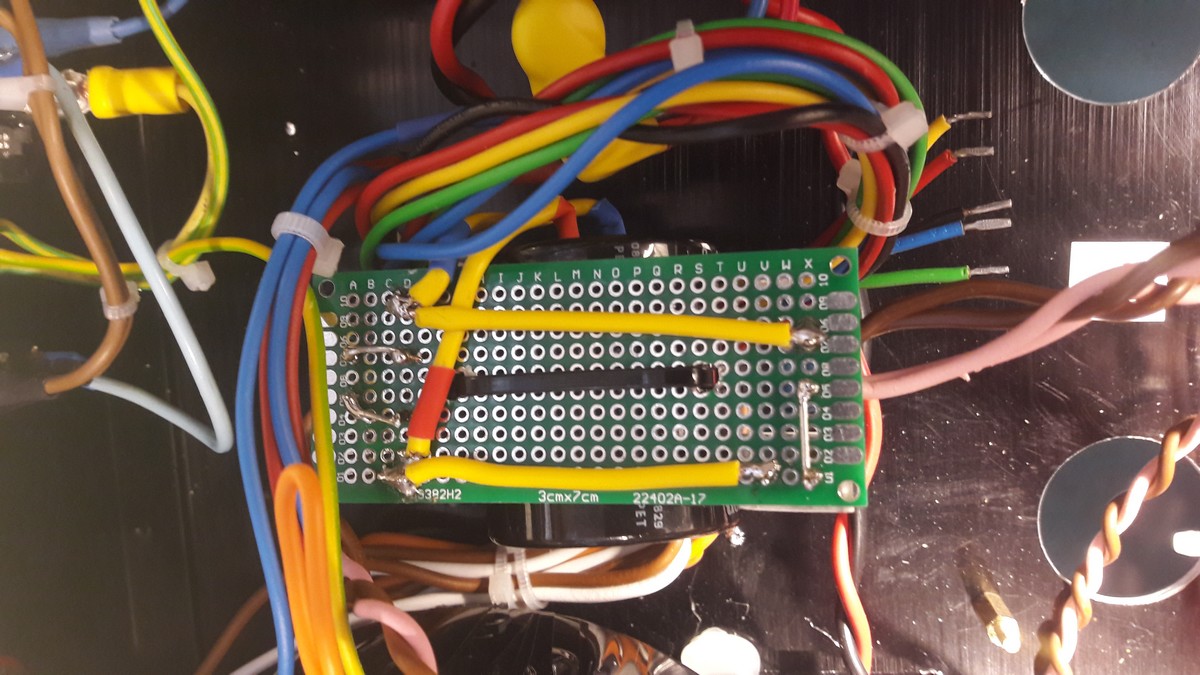

meanie, it seems on your picture that you are using only one 6.3 V heater connection to the DC/DC converter ? I recommend you to use the two 6.3 V 7 A outputs in serial to have 12.6 V AC on your bridge rectifier therefor your DC/DC converter will work in better condition, more efficiently and your bridge will dissipate less because the current will be divided nearly by 2 !
Nice build by the way
Best regards,
Marc

The 2pair of 6.3vac was connected in series before going into the bridge rectifier.
The pic can hardly shows the connected center tap.

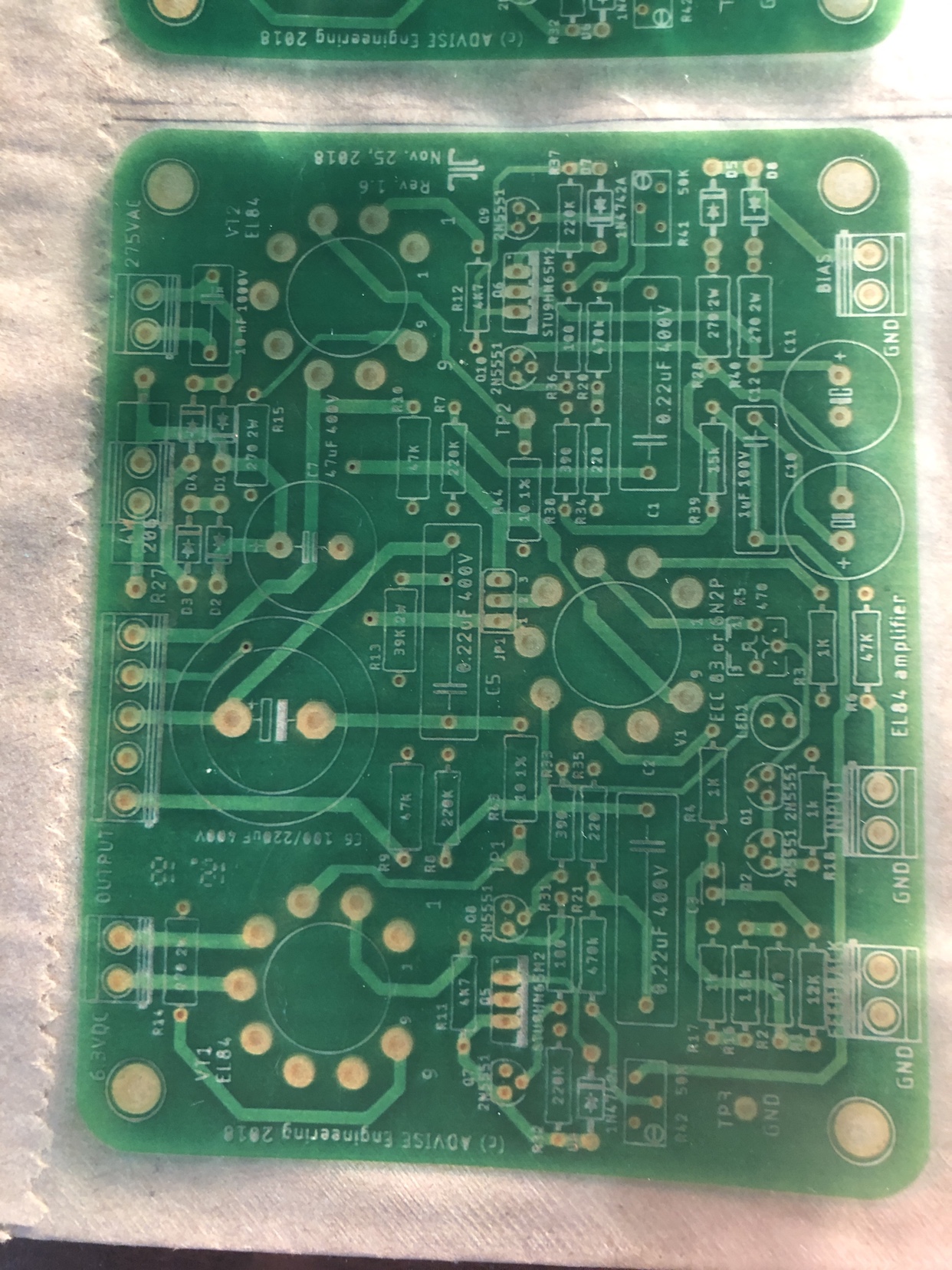

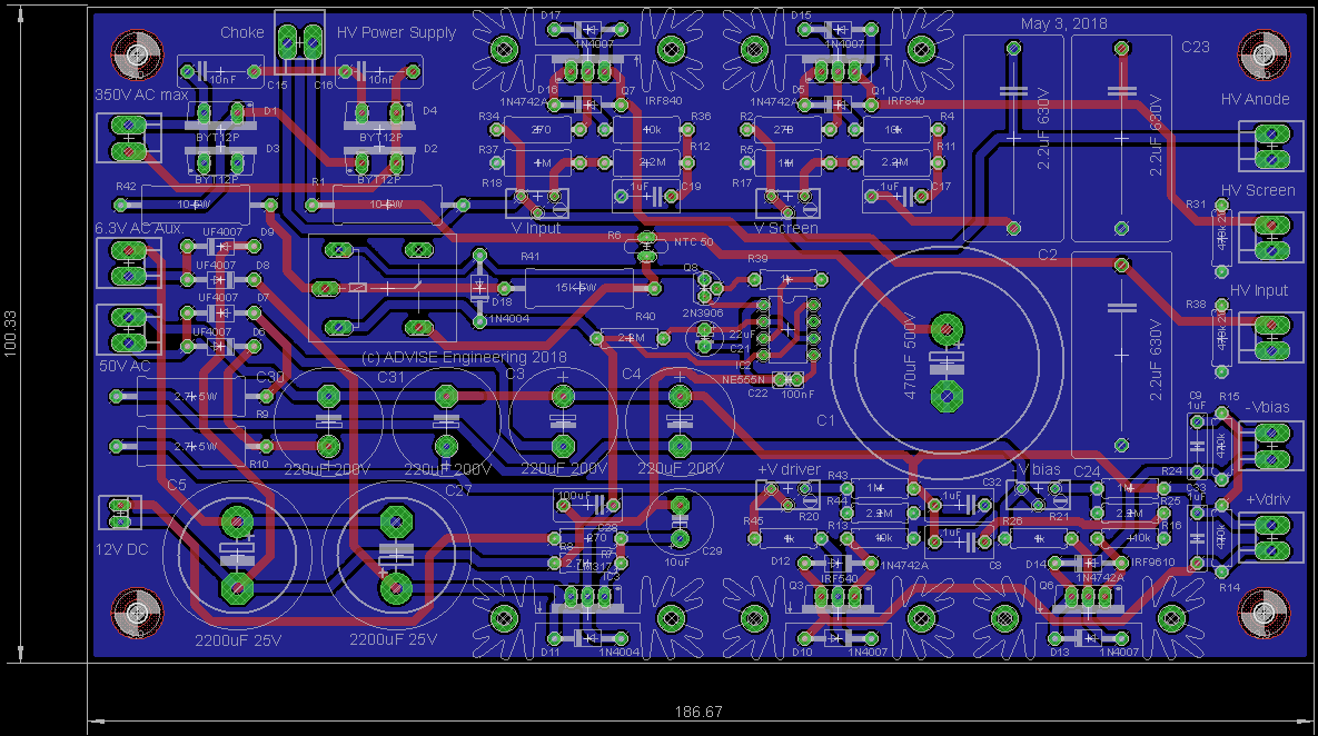

Good Morning . Seeking clarification
with regard to R5, the 500 R trimmer.
Is this a single turn trimmer?
Is this the same item as listed in the BOM ?
3386P-1-501LF | Bourns 3386P Series Through Hole Trimmer Resistor with Pin Terminations, 500Ω +-10% 1/2W +-100ppm/degC Top Adjust | RS Components

YES kp93300 it is single turn trimmer, the reference is in the BOM : 3386P-DF6-501LF Bourns | Mouser France You can put it on the bottom of the PCB (this is what I have done because I have a tube protection on the top)... However for the bias trimmers , I suggest to put them on the top with a small hole to access them 😎

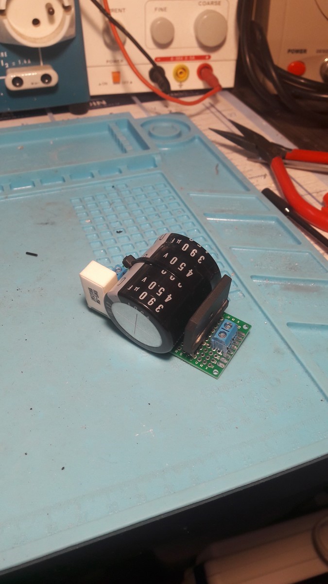

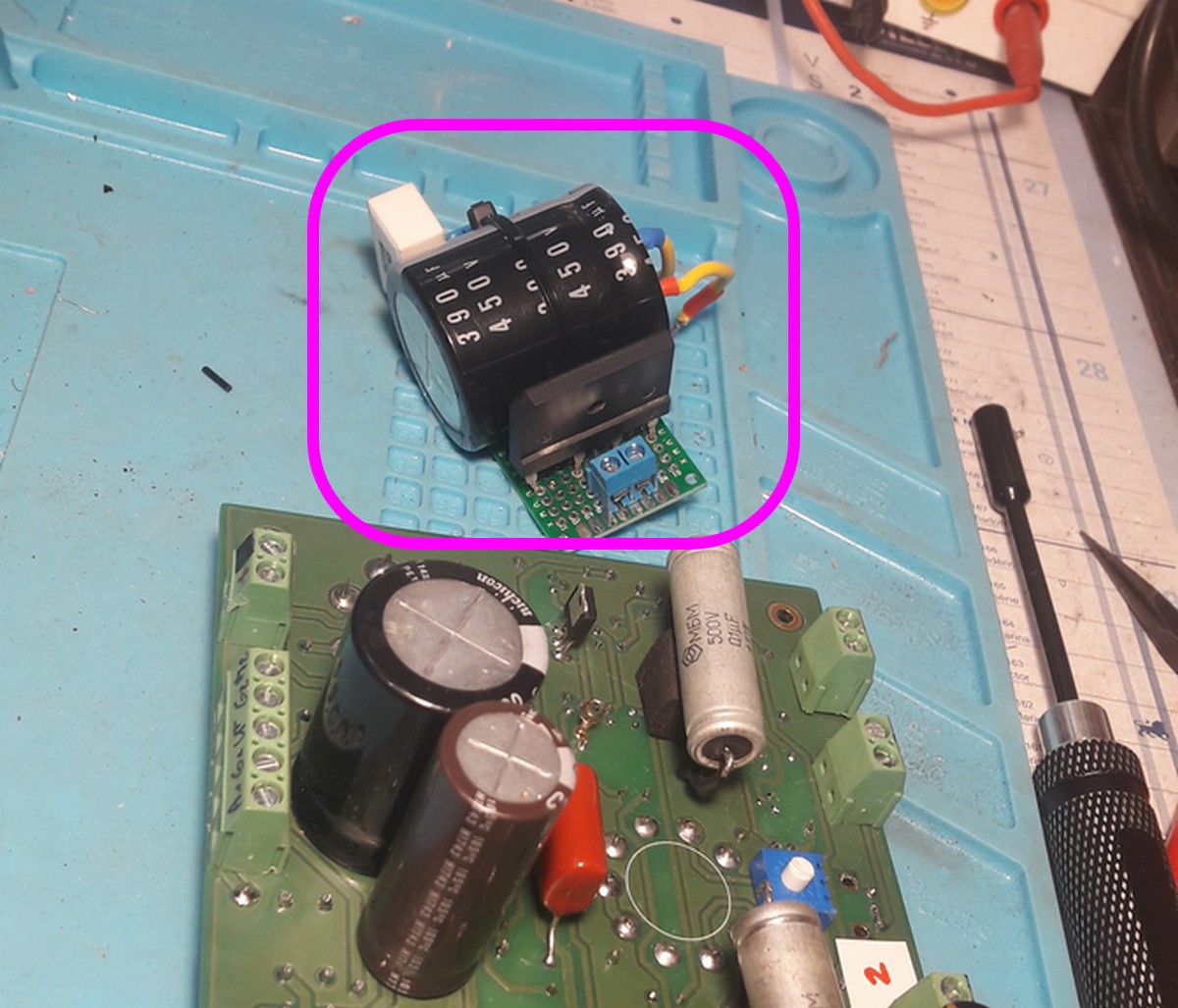

Effectively, I had noticed a very very very slight Hum.🙄
The addition of a small RC filter circuit on the HT composed at least (1 rectifier bridge,1 capa 390uF/450V and a R 10 ohms/ 5W) allowed to completely disappear this little hum. 😎
I simply installed this little assembly at the nearest transformer. Now the amp is absolutely and totally silent. It works wonderfully, like here with Oscar Peterson "On Russia" on the Thorens TD 126 mkIII. It's really a great amp, I'm very happy to have realized.

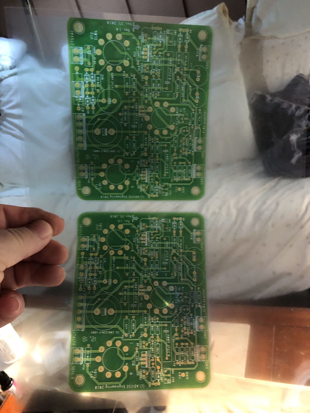

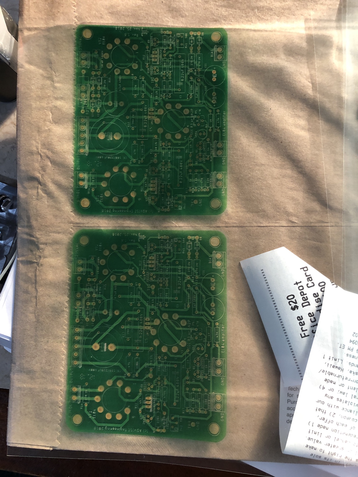

I thought I would show you guys what I’ve done about getting the right spots placed for a top plate
I had two boards copied onto overhead transparency paper basically clear plastic paper
This way I can tape it onto the top plate and do all my cuts. Each sheet in color was under $2.00 at Office Depot
They look better then the pics show them
They can do them in black and white as well
My printer can print these but I was out of the clear paper
I hope this helps you guys with your layout of the case for the amps
