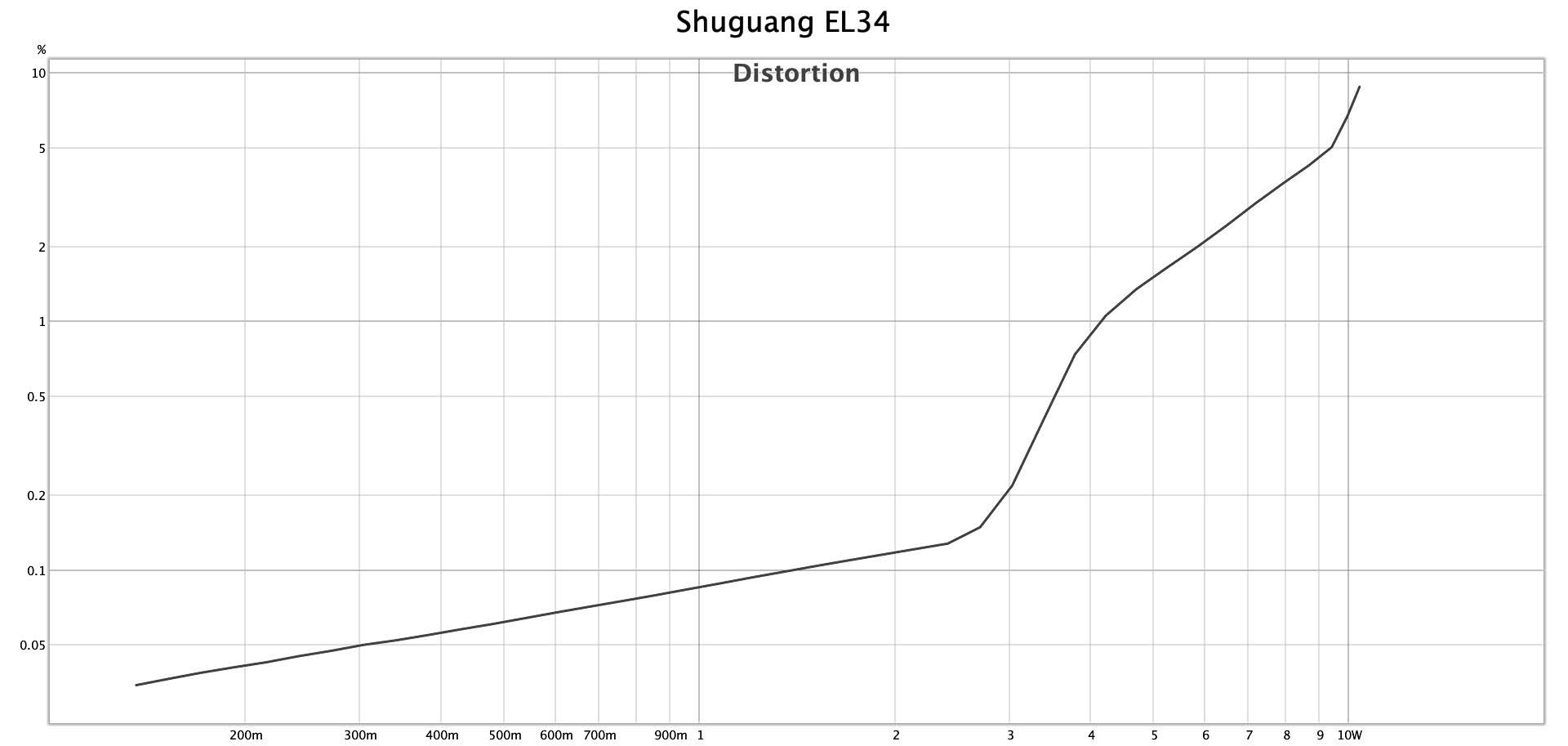

So today I’m testing all my pin compatible tubes in the amp to see how they compare. I’ll not be changing the bias current though. This test will be power vs THD%. It will show differences in when the tubes enter A2 and how they behave in A2.
First up is a Shuguang EL34. You can see the point where the stage enters class A2 because of the bump in distortion.
