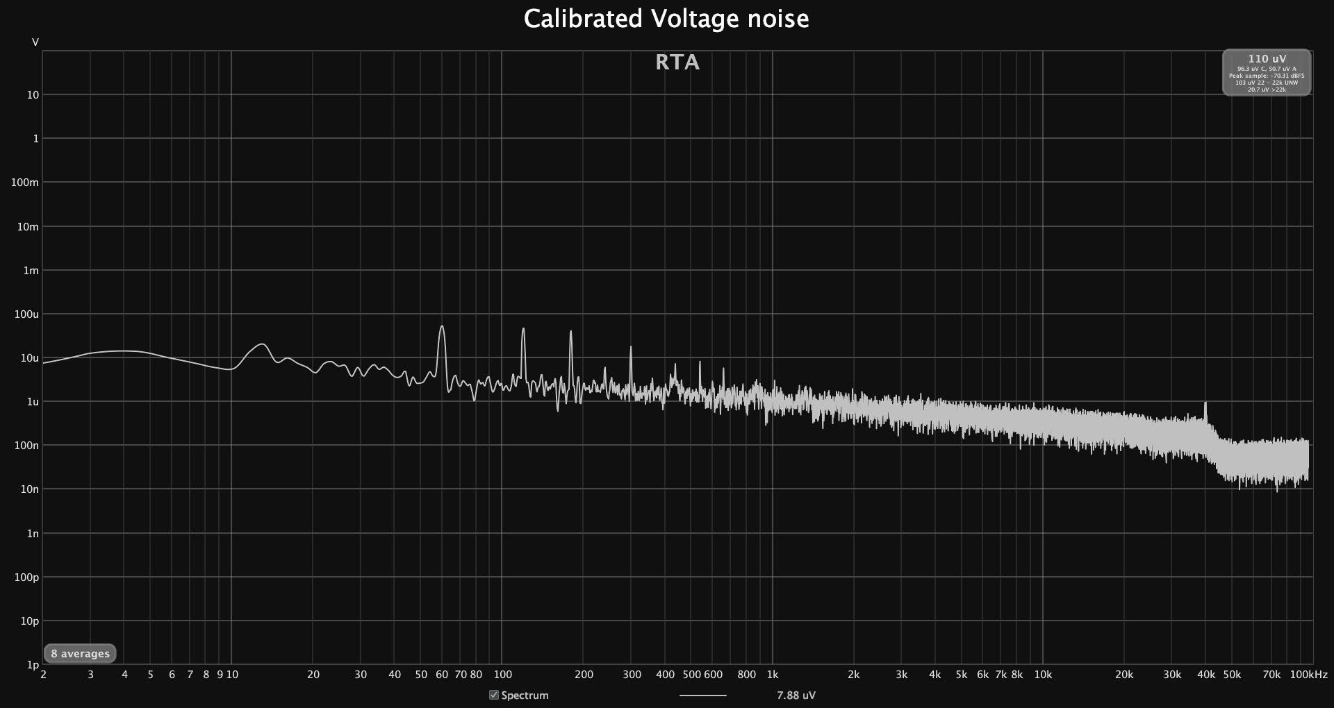

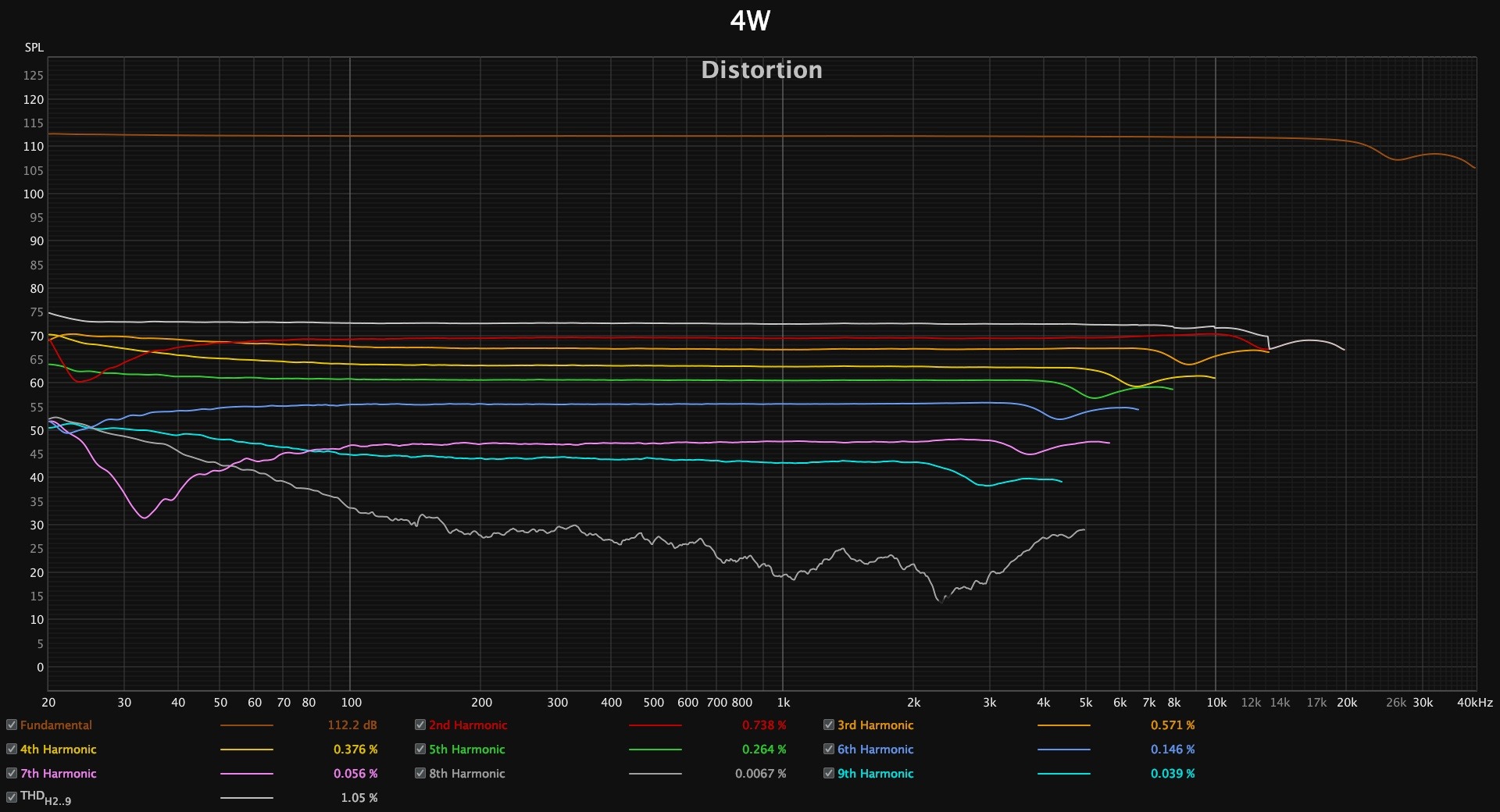

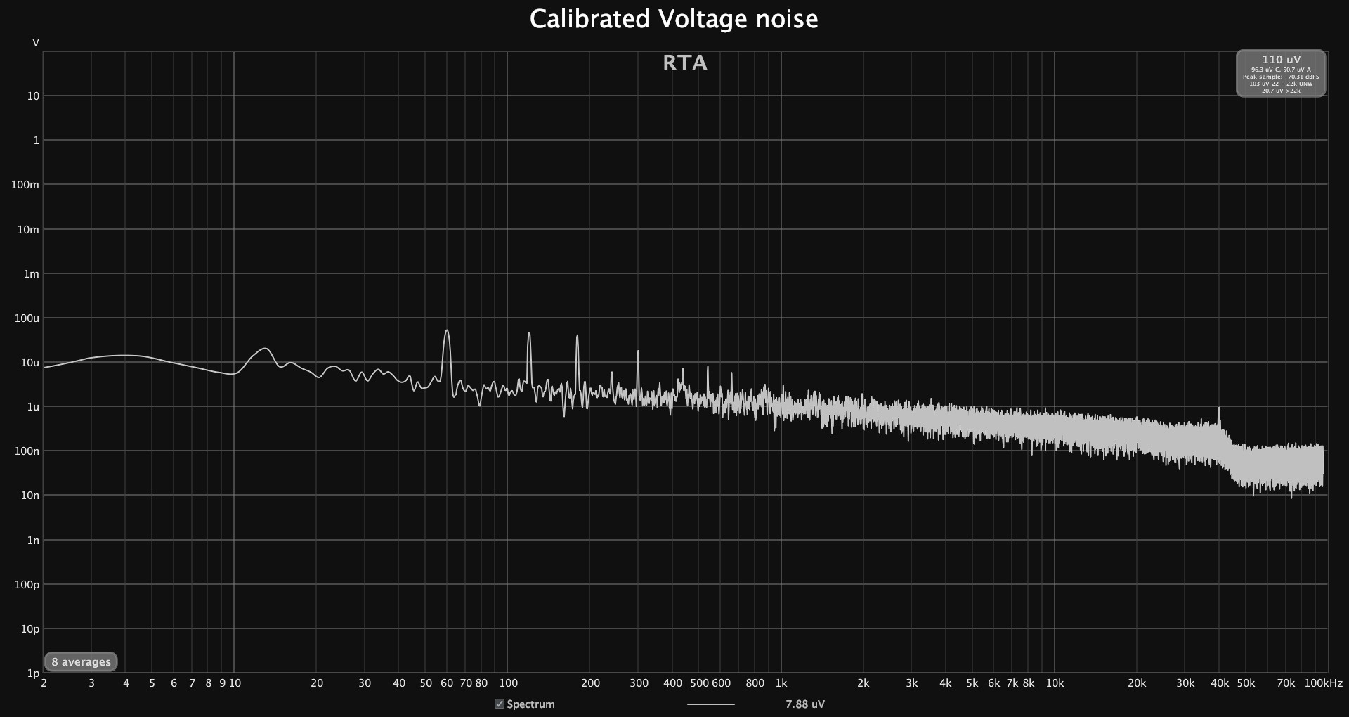

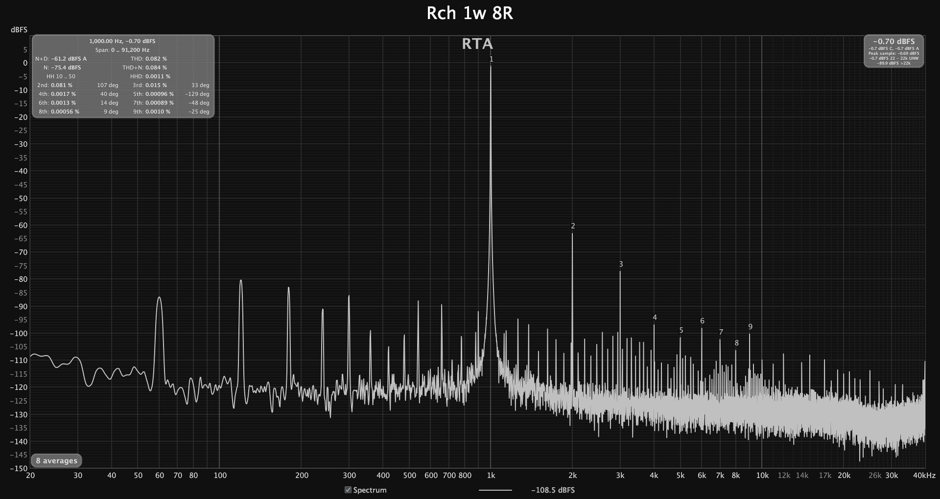

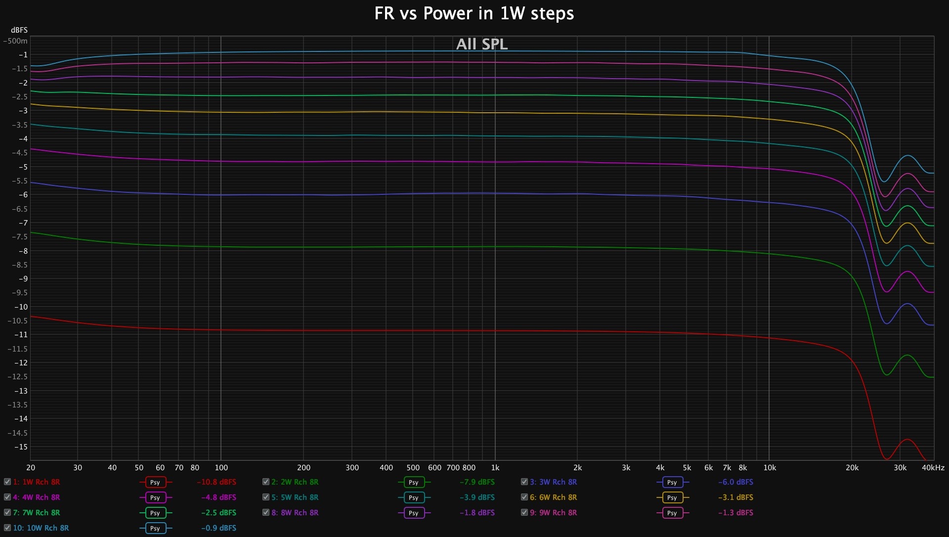

Preliminary test results. Here is calibrated voltage noise into 8R. The amp input is shorted. All hum components below 100uV. Pretty good for SE cascode with AC heaters. PSRR is very poor.

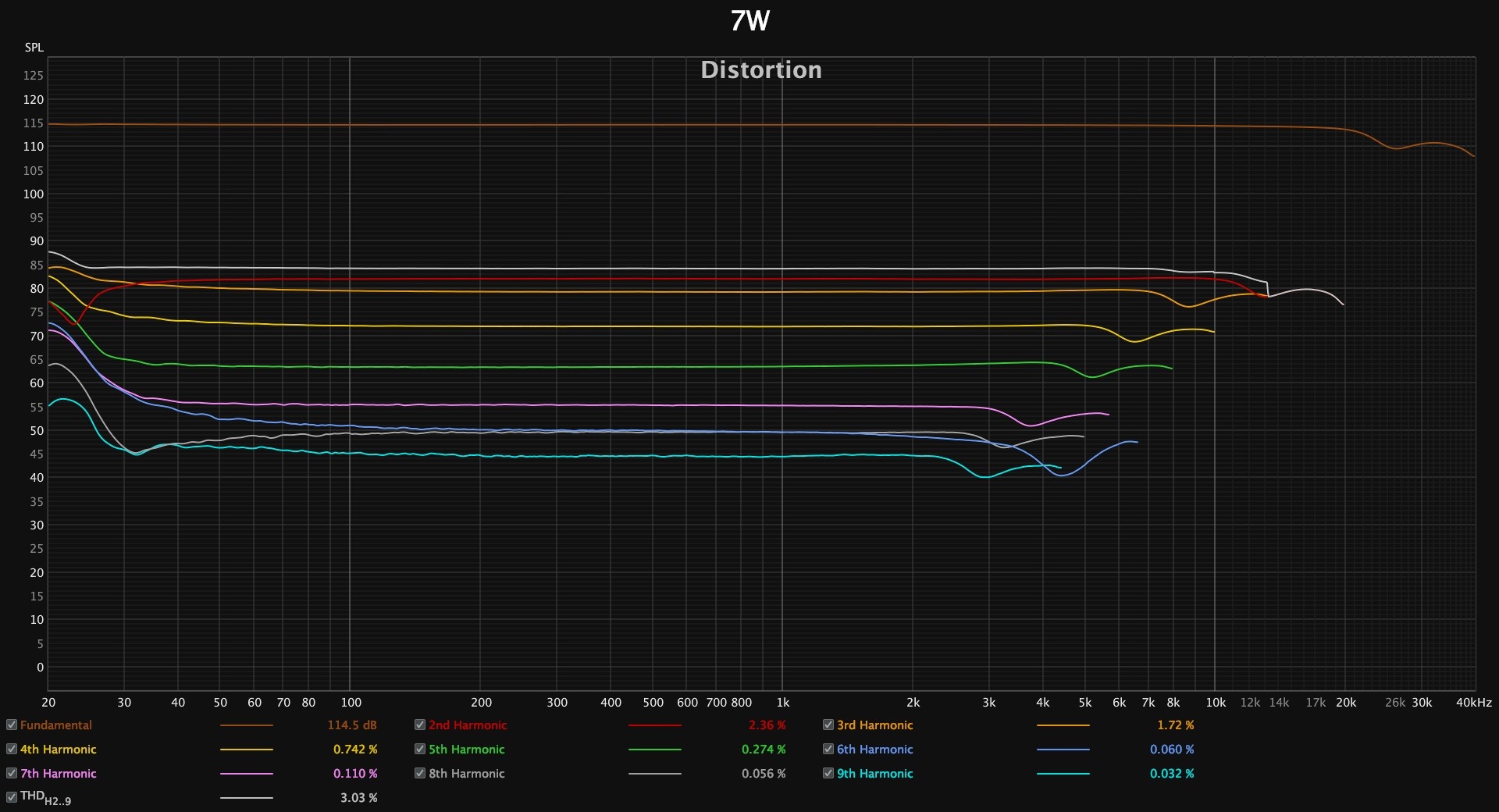

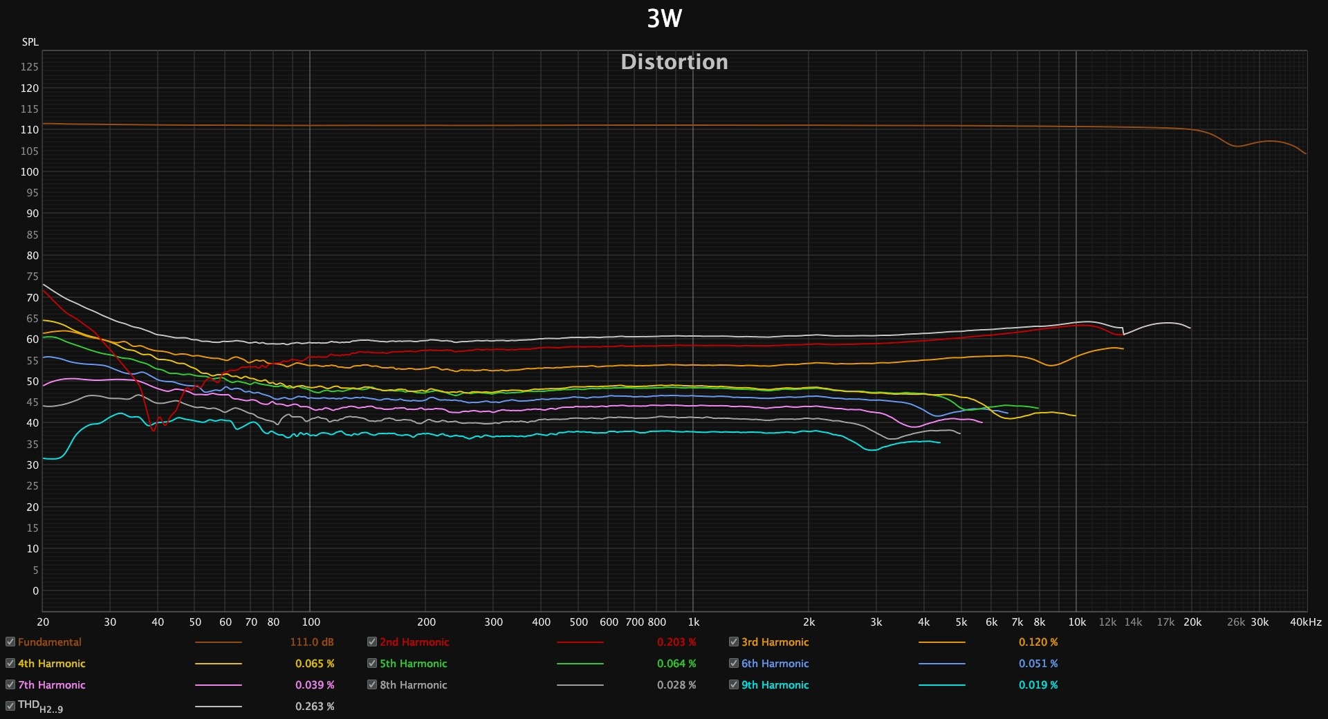

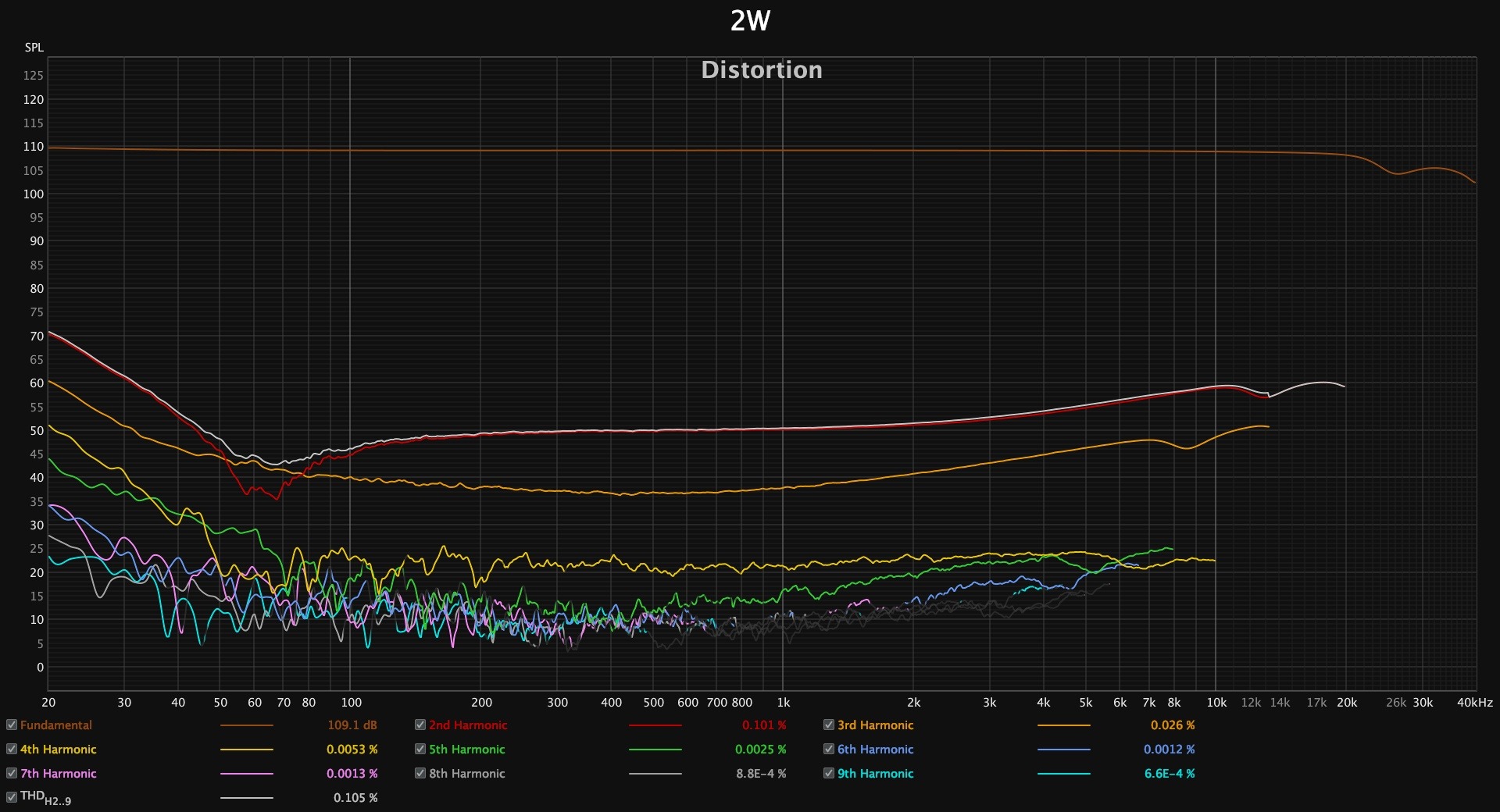

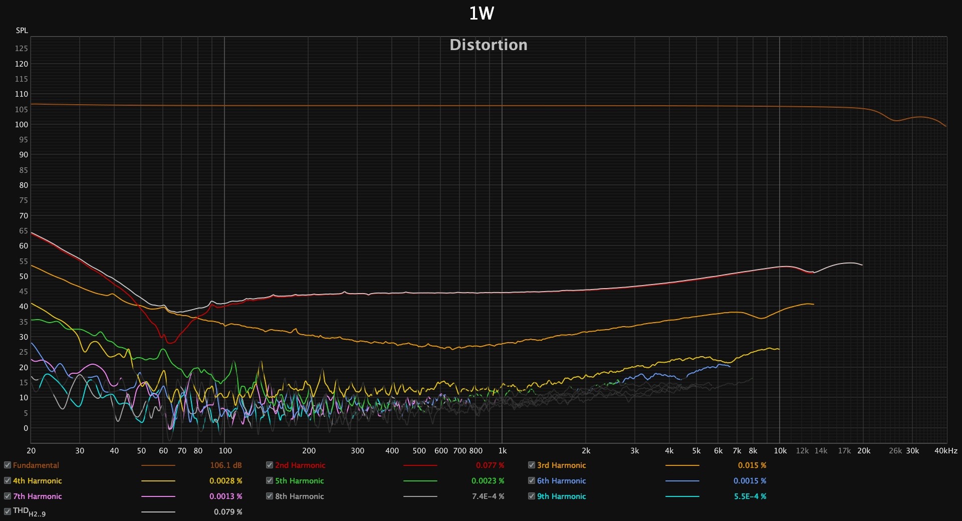

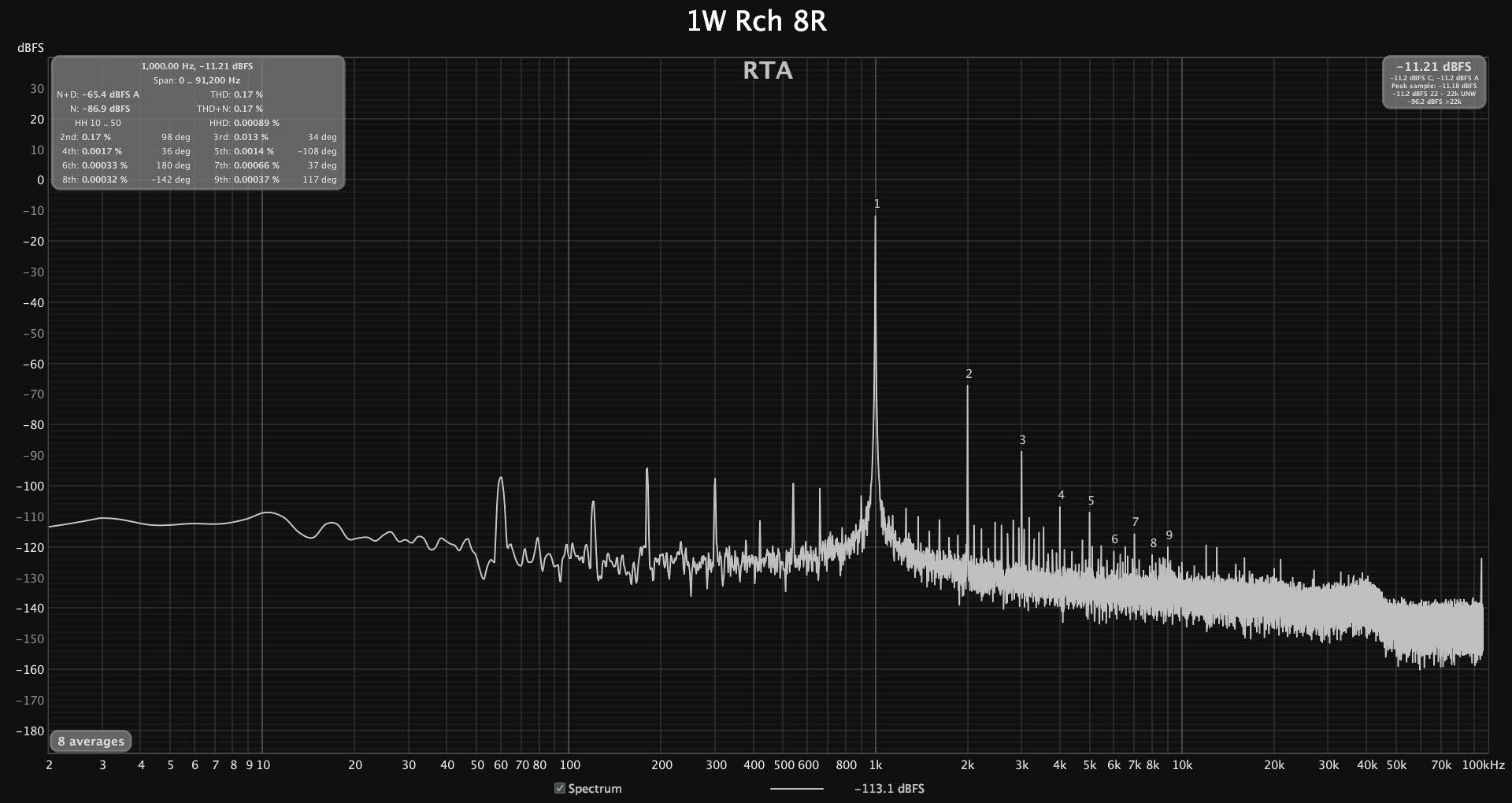

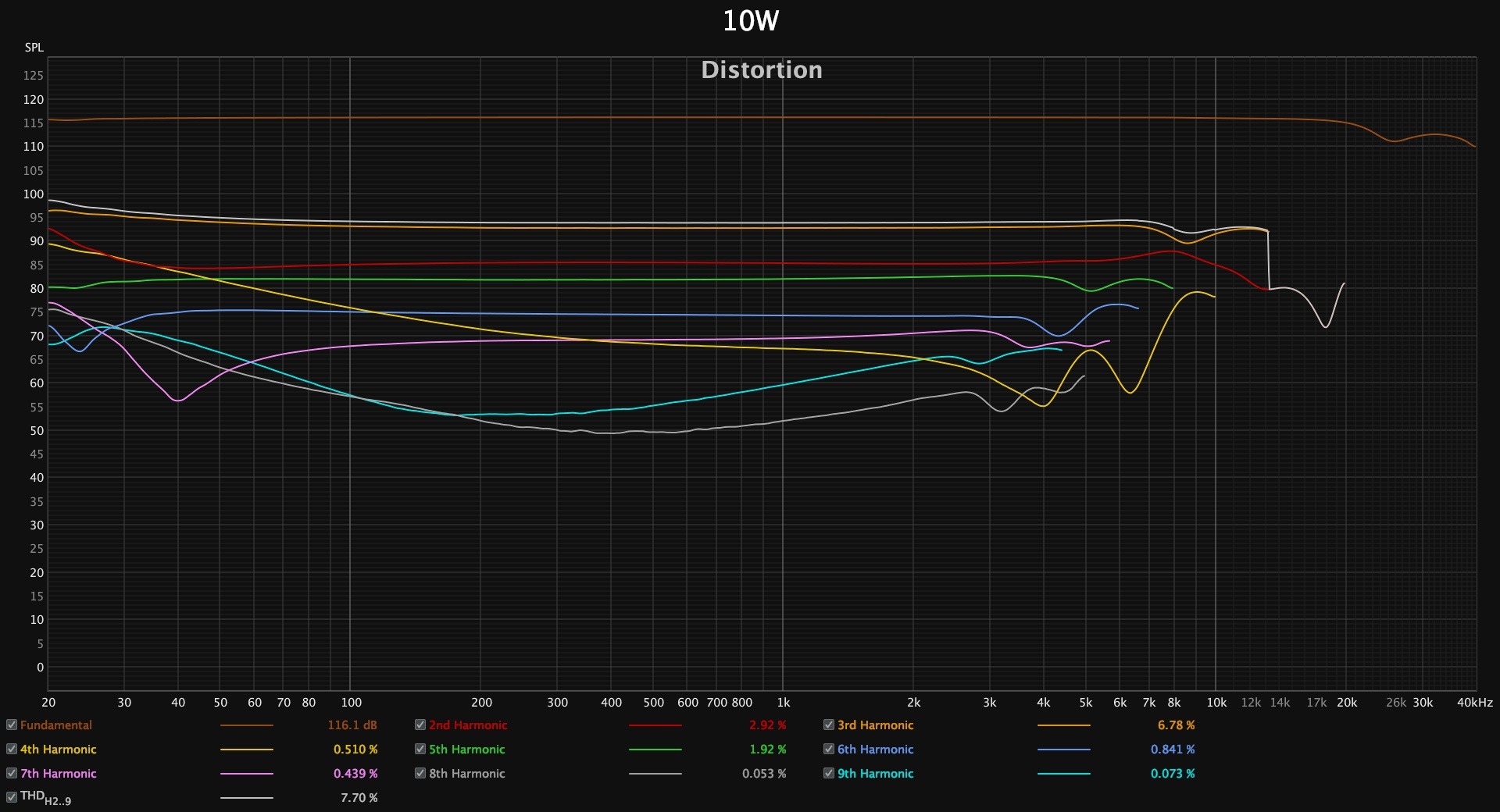

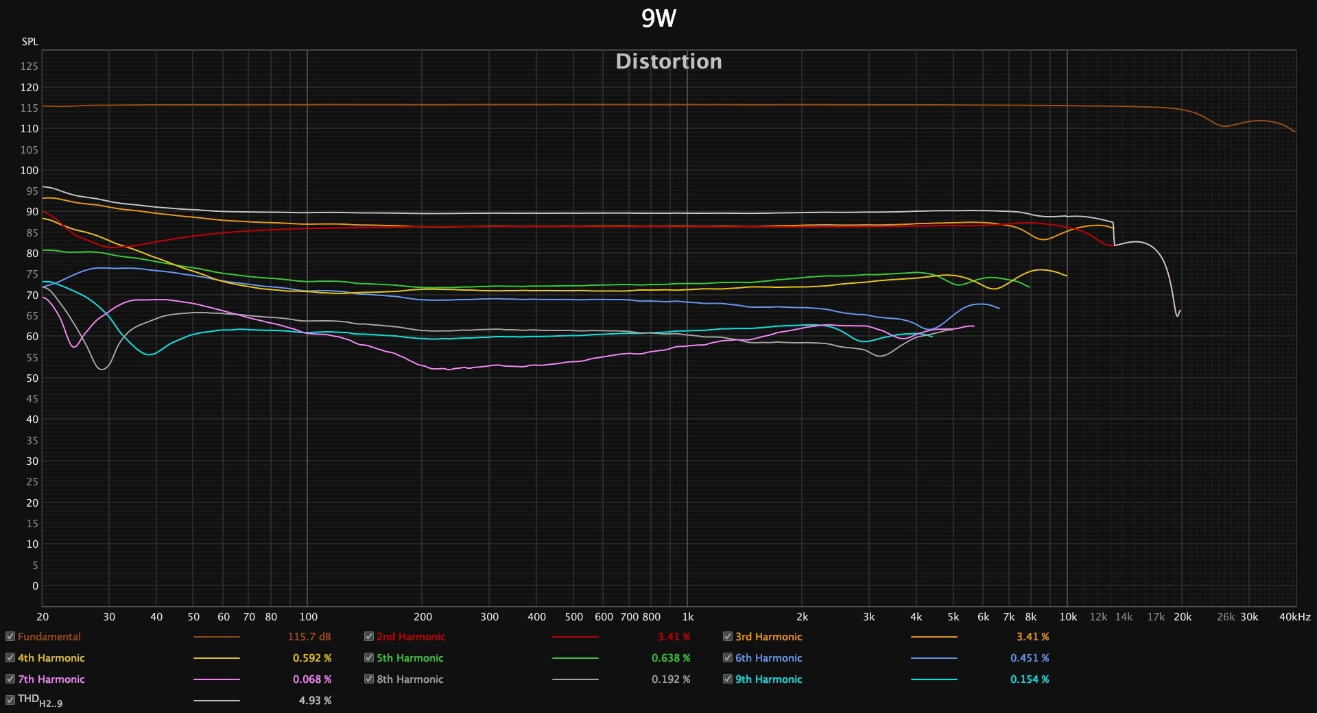

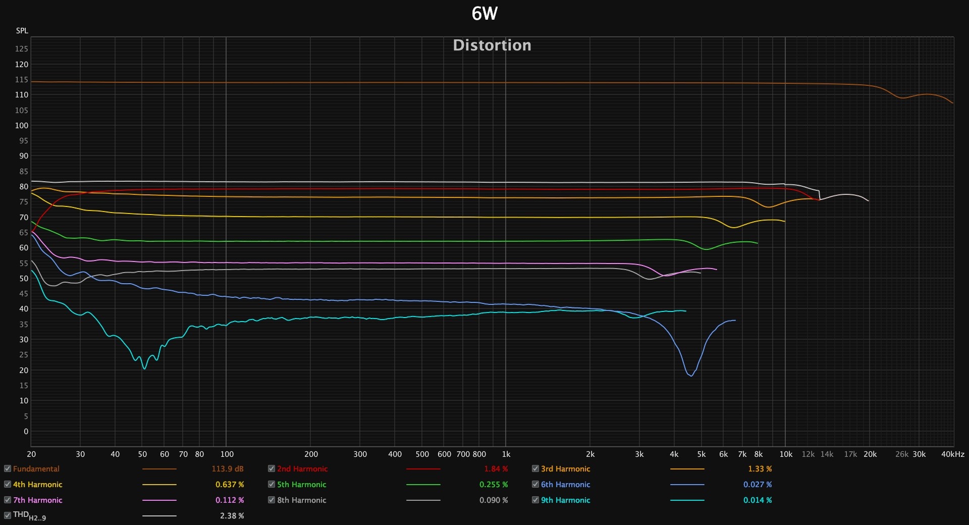

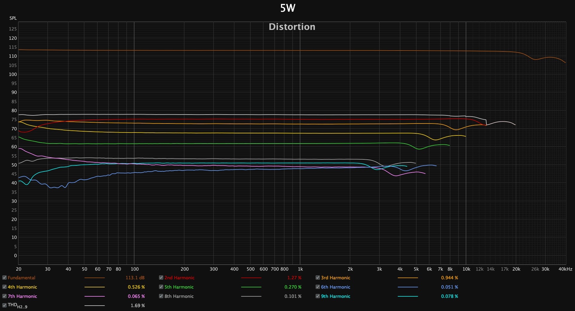

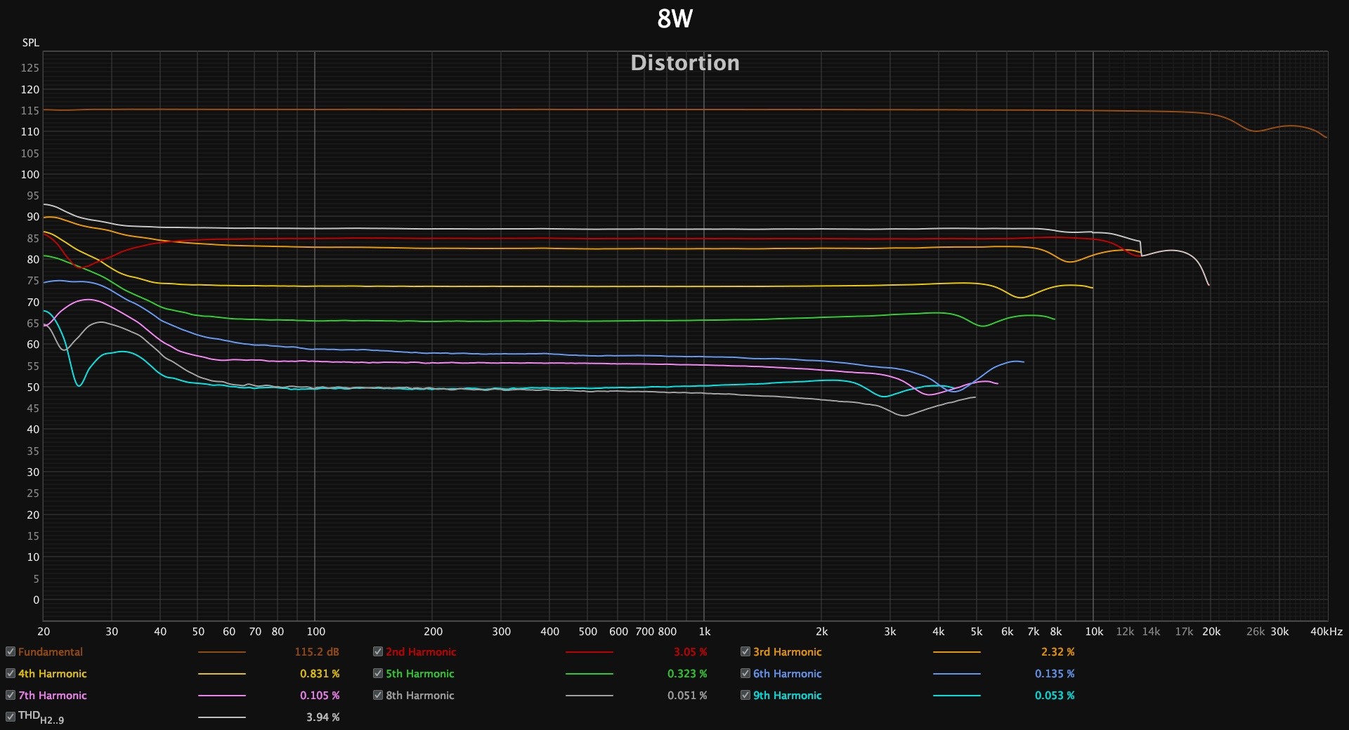

Measurements finished up.

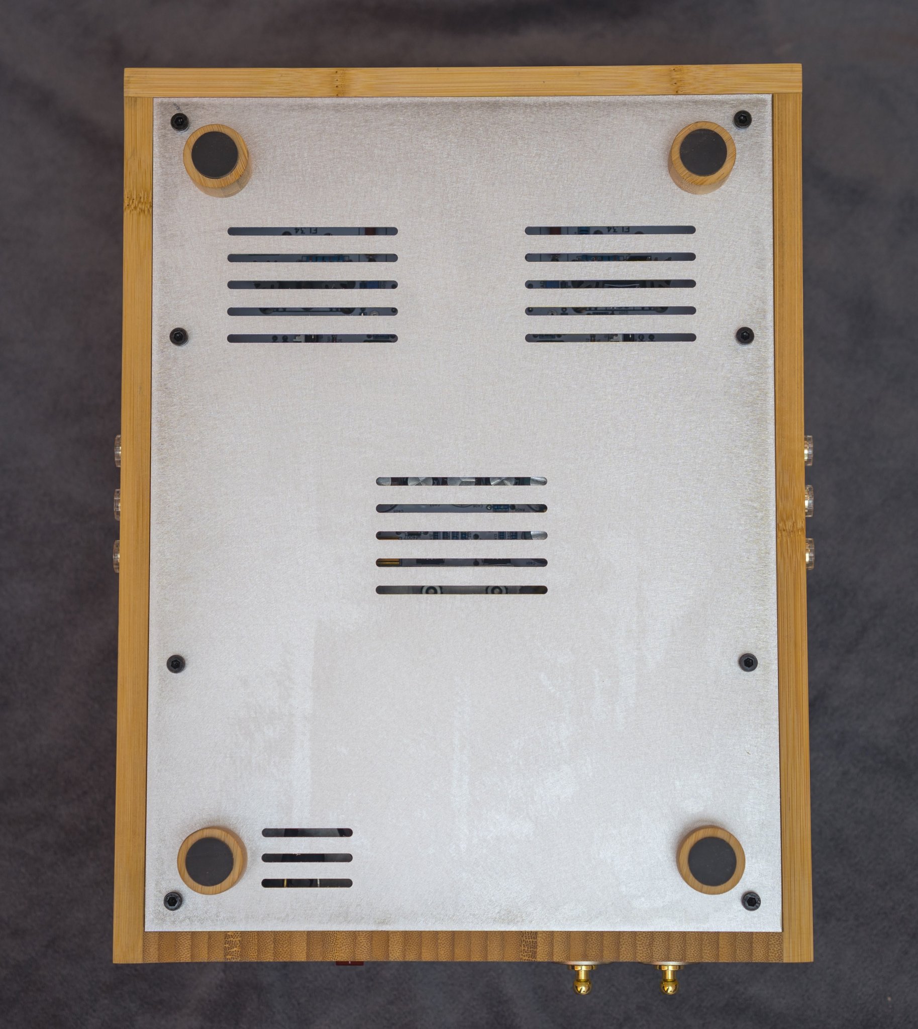

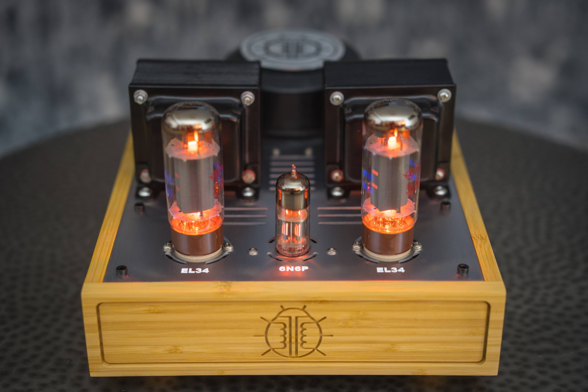

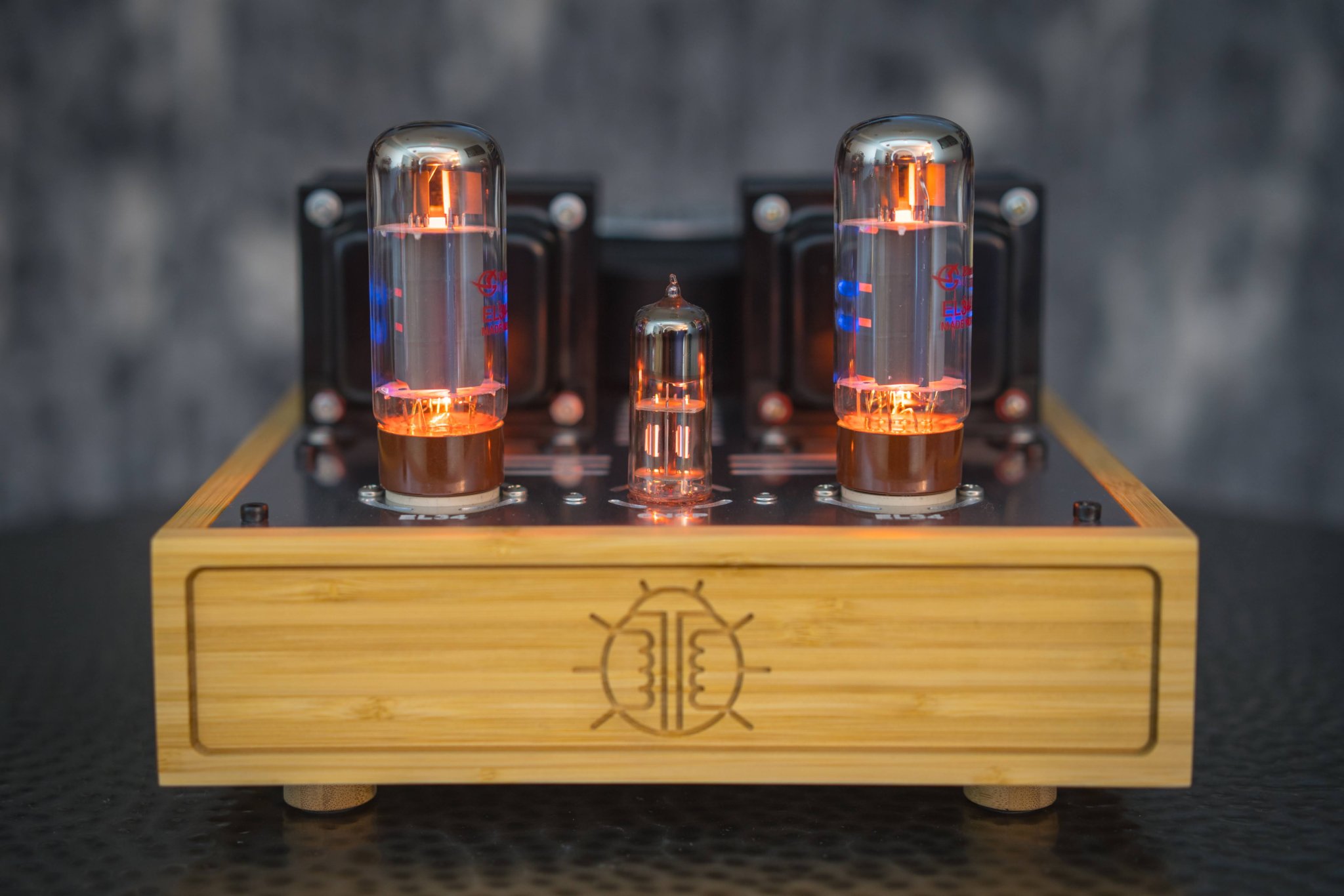

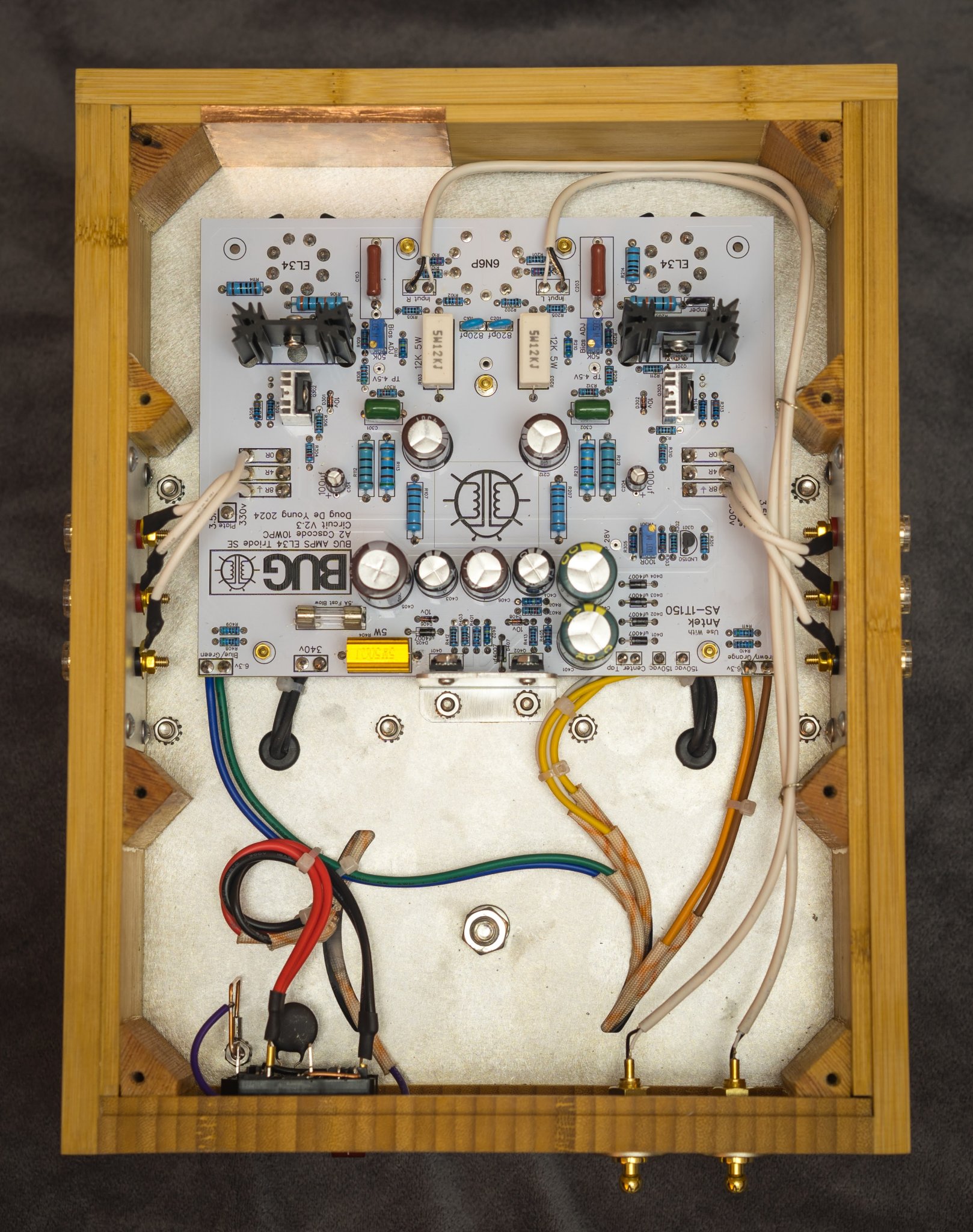

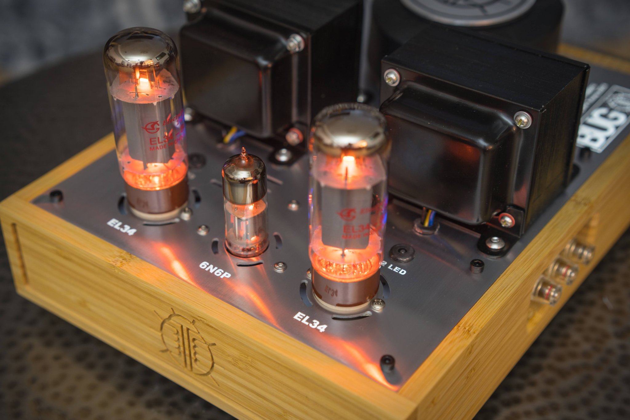

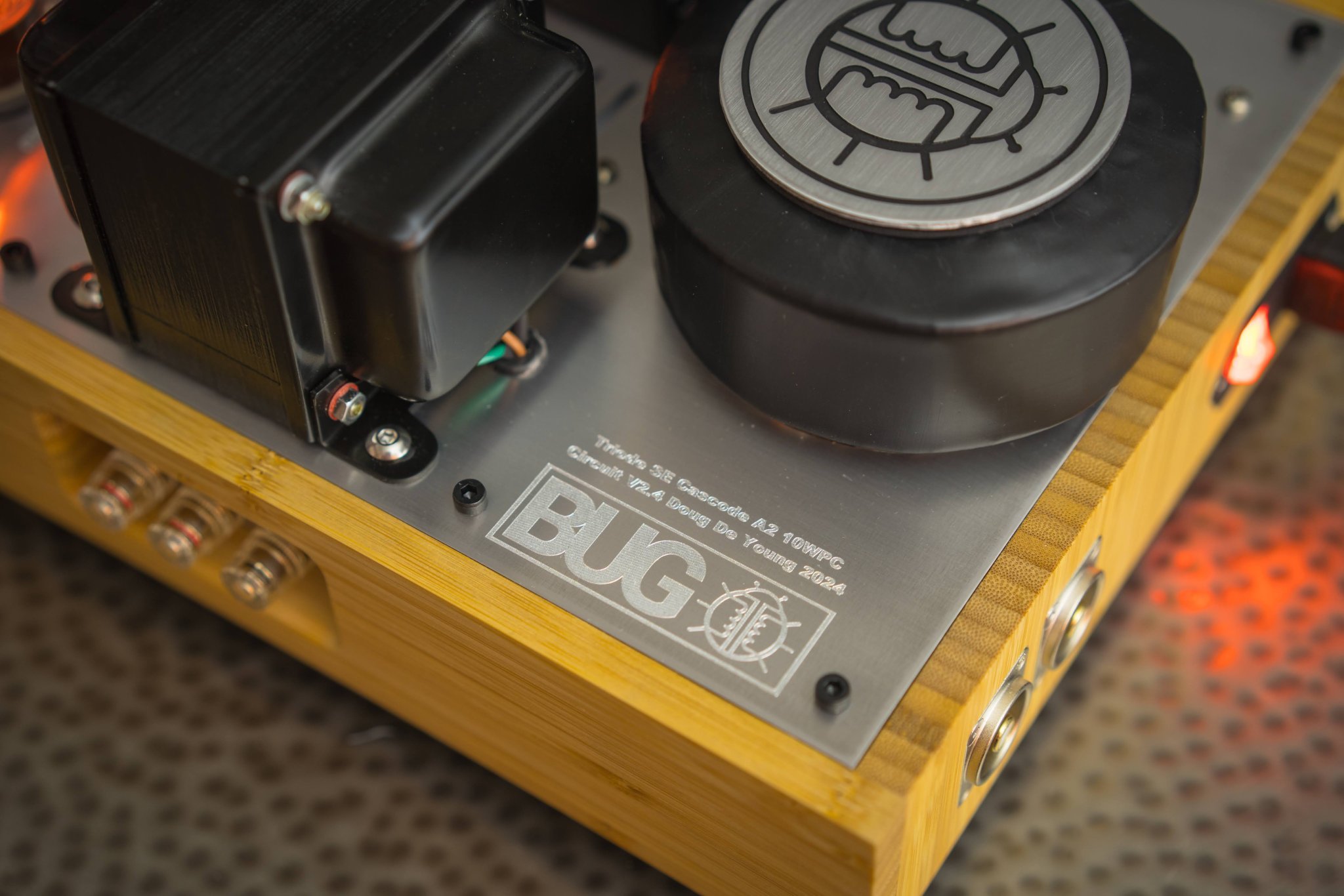

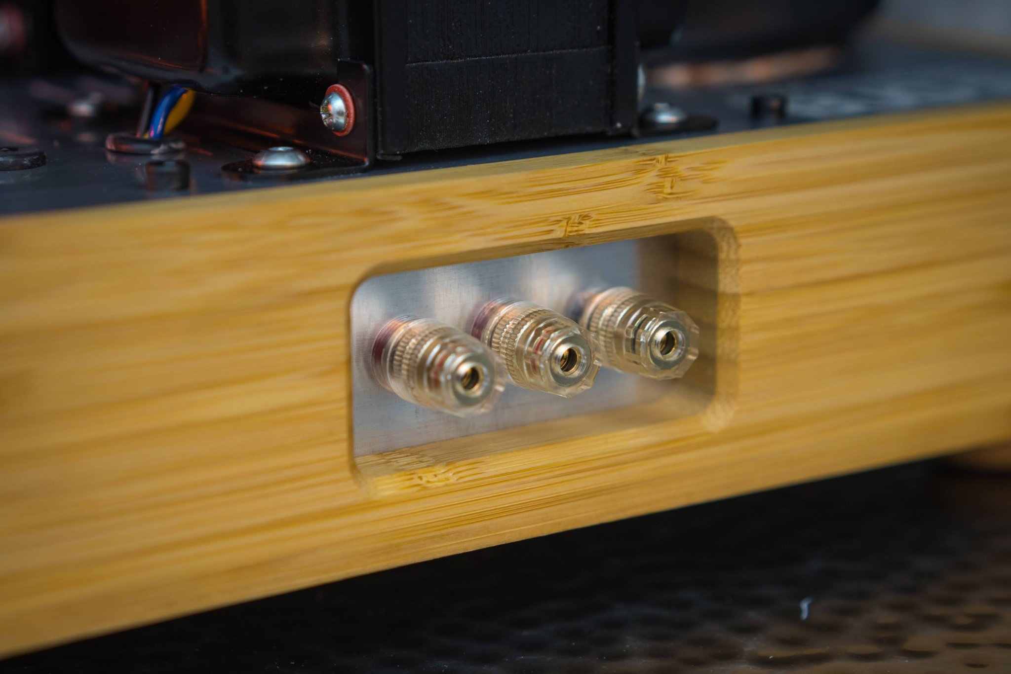

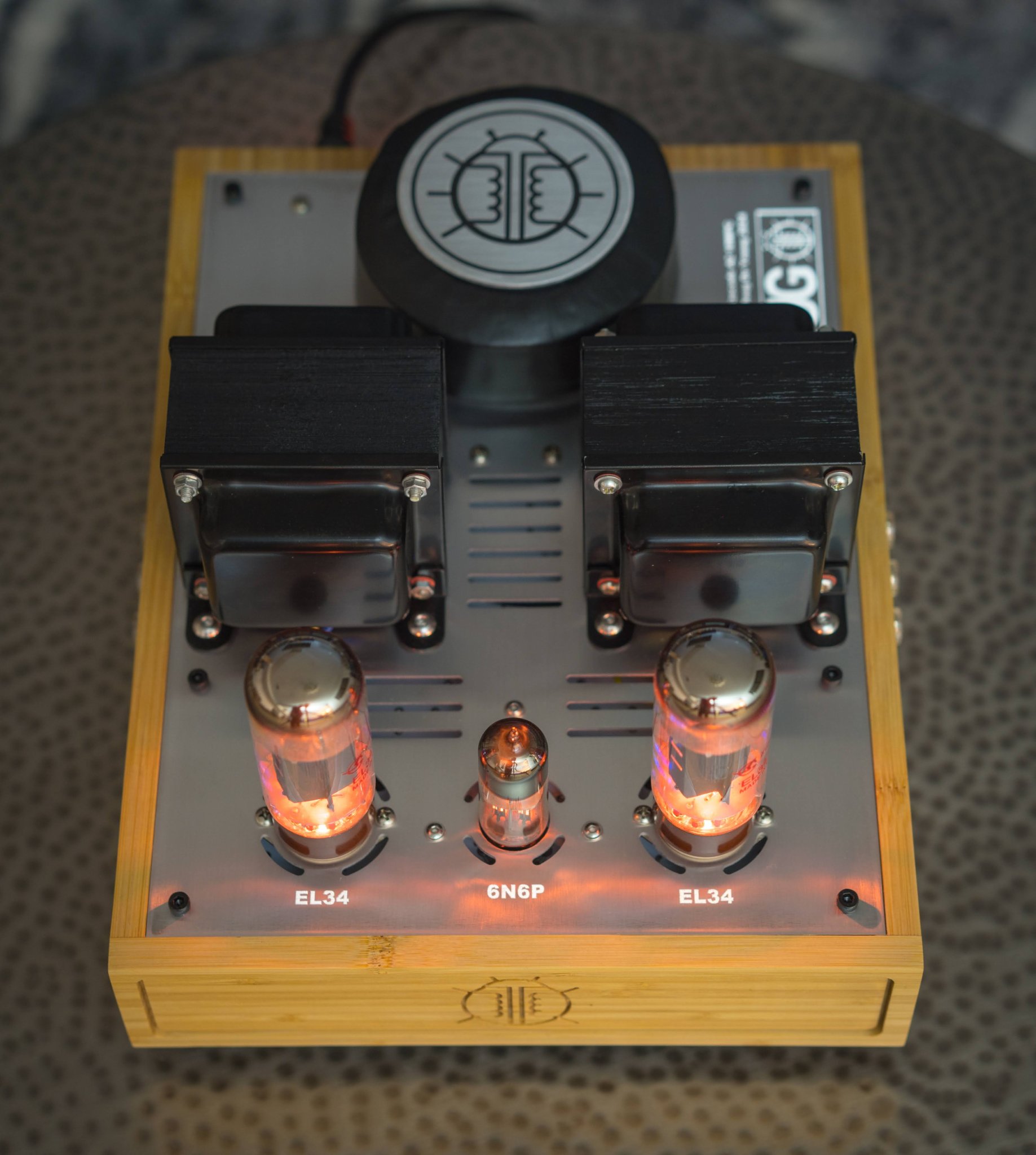

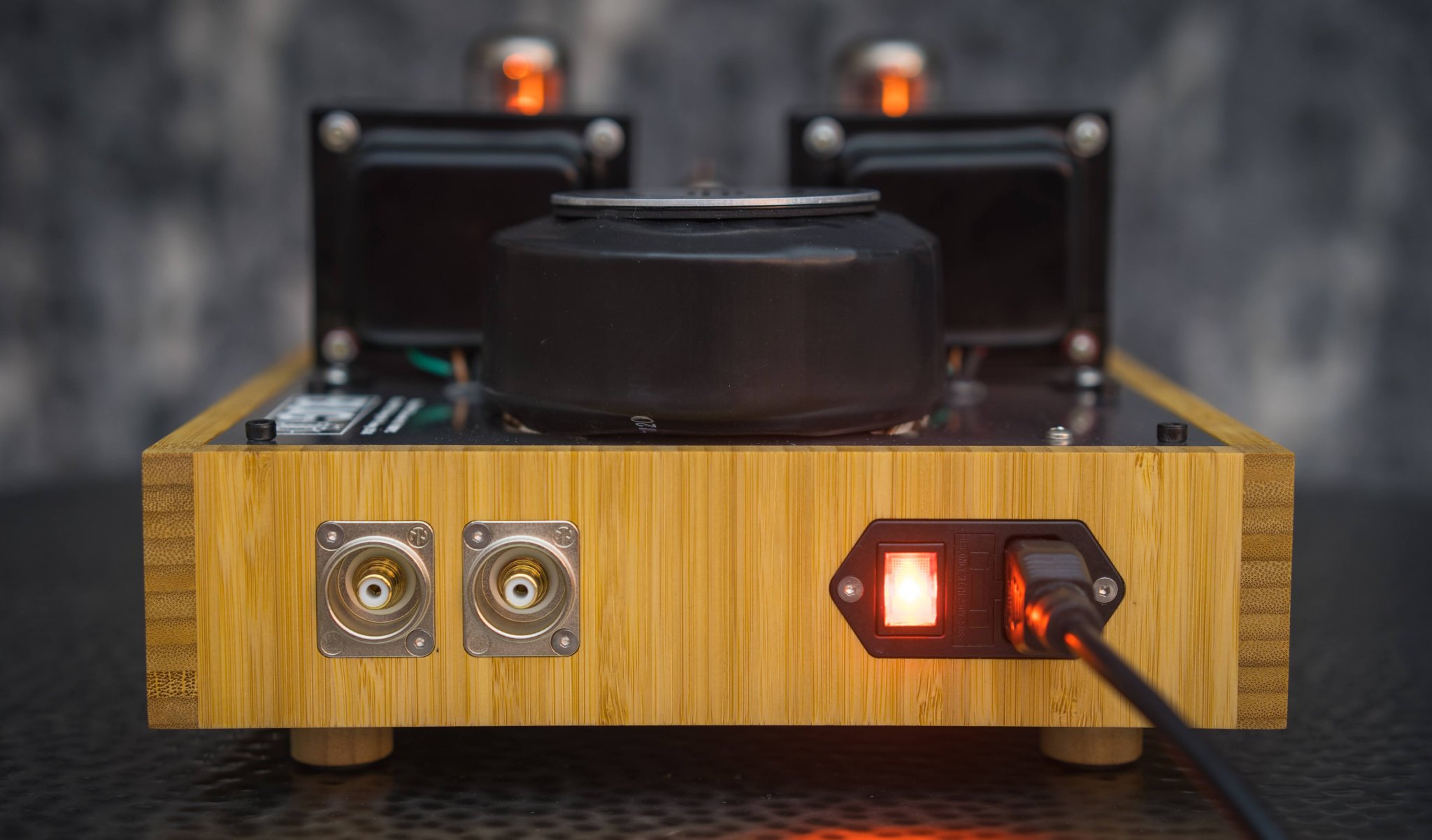

Also some nice photos of the finished build

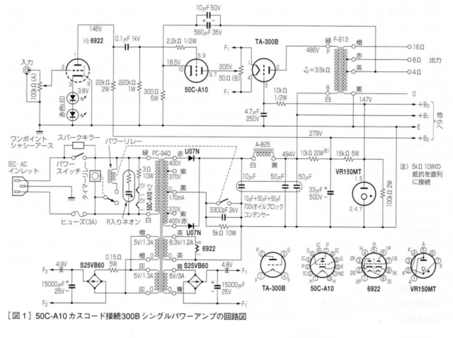

All tube version of se cascode output from the "goldmine" thread on this forum:

Still deciding what to do about offering up the PCBs and such. You’re of course welcome to use the circuit to develop your own PCBs in the meantime if you want.can you share the gerbers?

I’d probably go with a pentode on the bottom if I was designing. But don’t have a ton of experience with cascode output stages. I’ve only designed one! 😂
