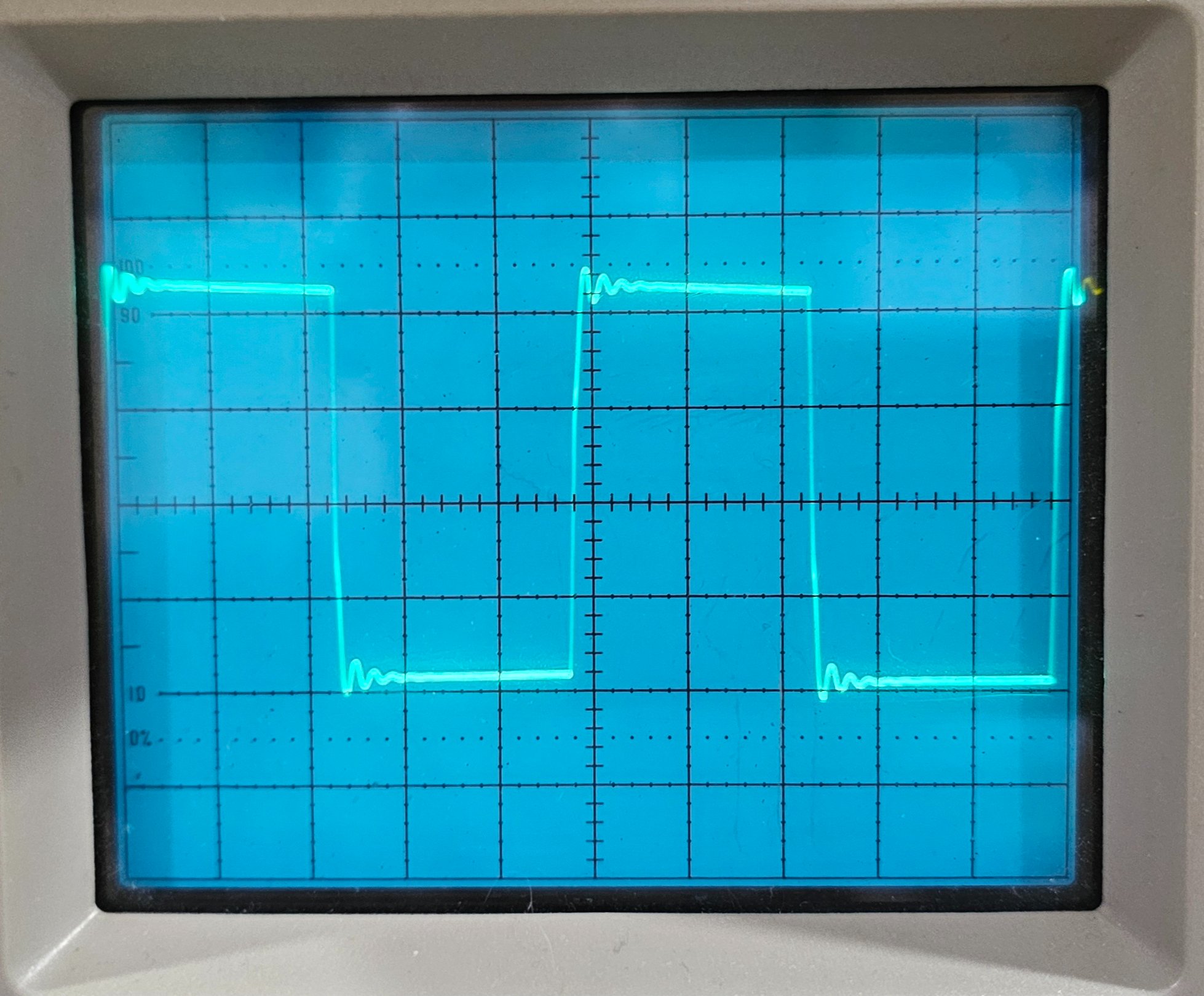

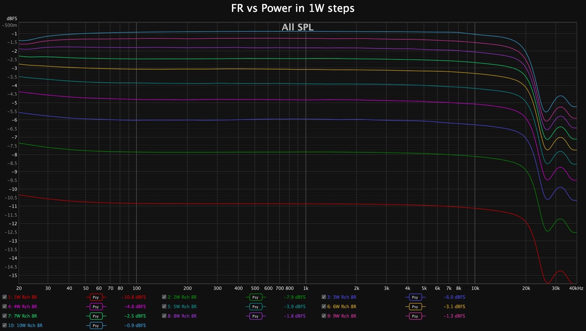

With CFB connected, measure 9.0w rms. -3dB points at 1 watt are 6Hz and 22.1kHz.

That’s pretty minimal really. I think mine looked similar. All the FR and distortion in the audio range was fine though. None of us are actually inputting the leading edge of a square wave during music listening. That’s very high frequency content.
Not to downplay the usefulness of a square wave for testing. I use one all the time for a first pass look at the total frequency response of a circuit. However when it comes to music reproduction I trust frequency/distortion sweeps to tell the real story. So to speak.
If the ringing is minor and doesn’t show up in the frequency response sweeps in the audio band I don’t worry about it. The likely culprit is the budget AliExpress output transformers so it’s not as simple as tweaking the feedback network. If it was just a bit of overshoot at the leading edge well placed cap would take care of it but it’s a bit more than that. From my own experience making compensation networks for transformers I think this square is probably just fine. Others will have different opinions I’m sure.

Could I ask primary DC resistance, frequency response, mA & how many output taps: 4,8,16 etc.It’s a pair. The shipping can be quite high though. Still it’s pretty good value.
DCR is around 115R I think. 0-4-8 secondary. I’m running 88ma. You can see my detailed FR vs Power graph in an earlier post but here it is again. This is only the FR in this particular circuit though and more performance may be available in a different circuit.
