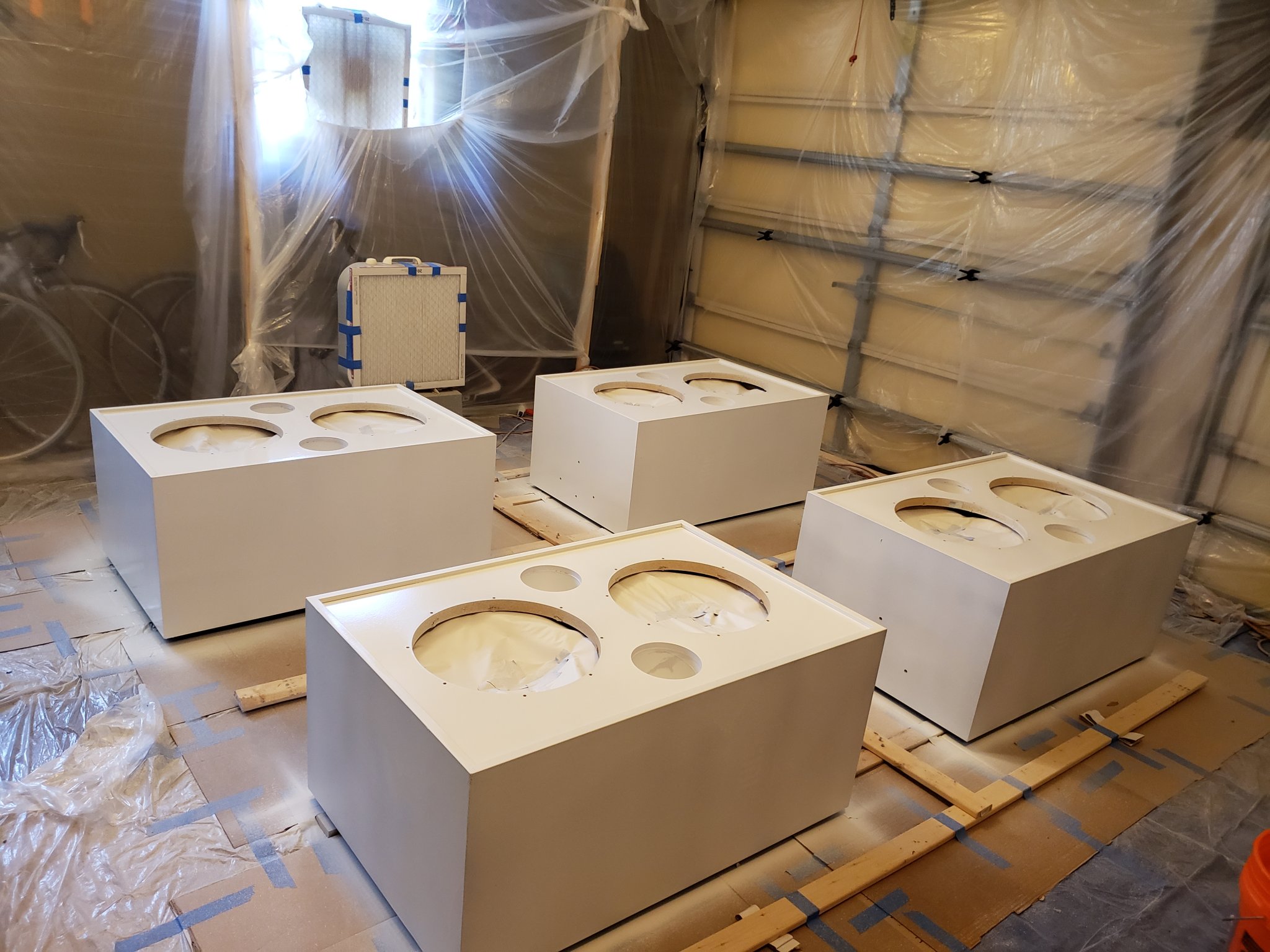

Eight JBL Dual 15" In One Room
Finally getting primer on the first four JBL's.

Uh, pics of the finished enclosures???

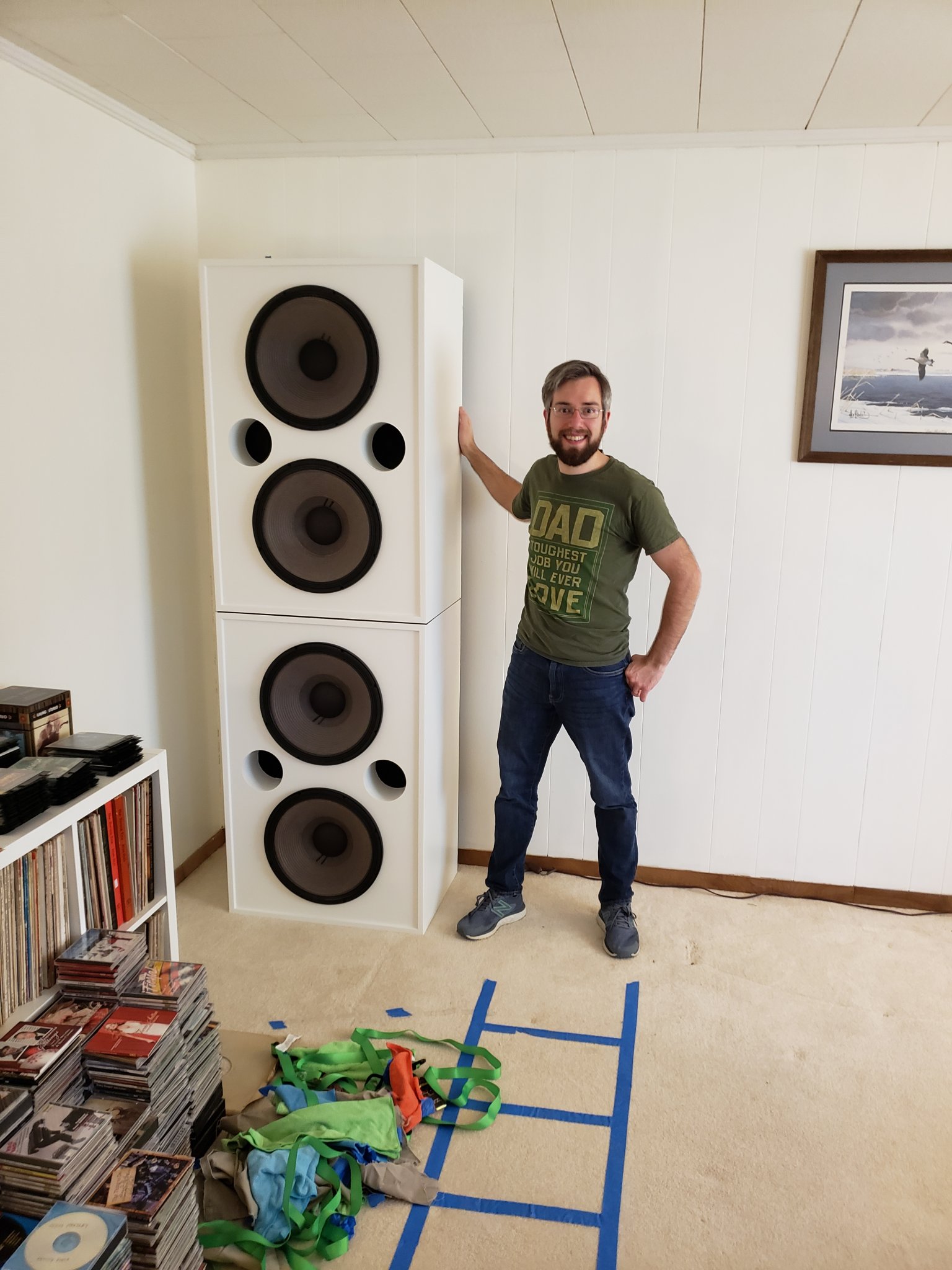

When you wrote this, I didn't have any finished cabinets done. I had 4 unfinished cabinets at the time behind my couch.
I still have 5 subwoofers in this room and once done will have 16 of these 15" JBL woofers in addition.
