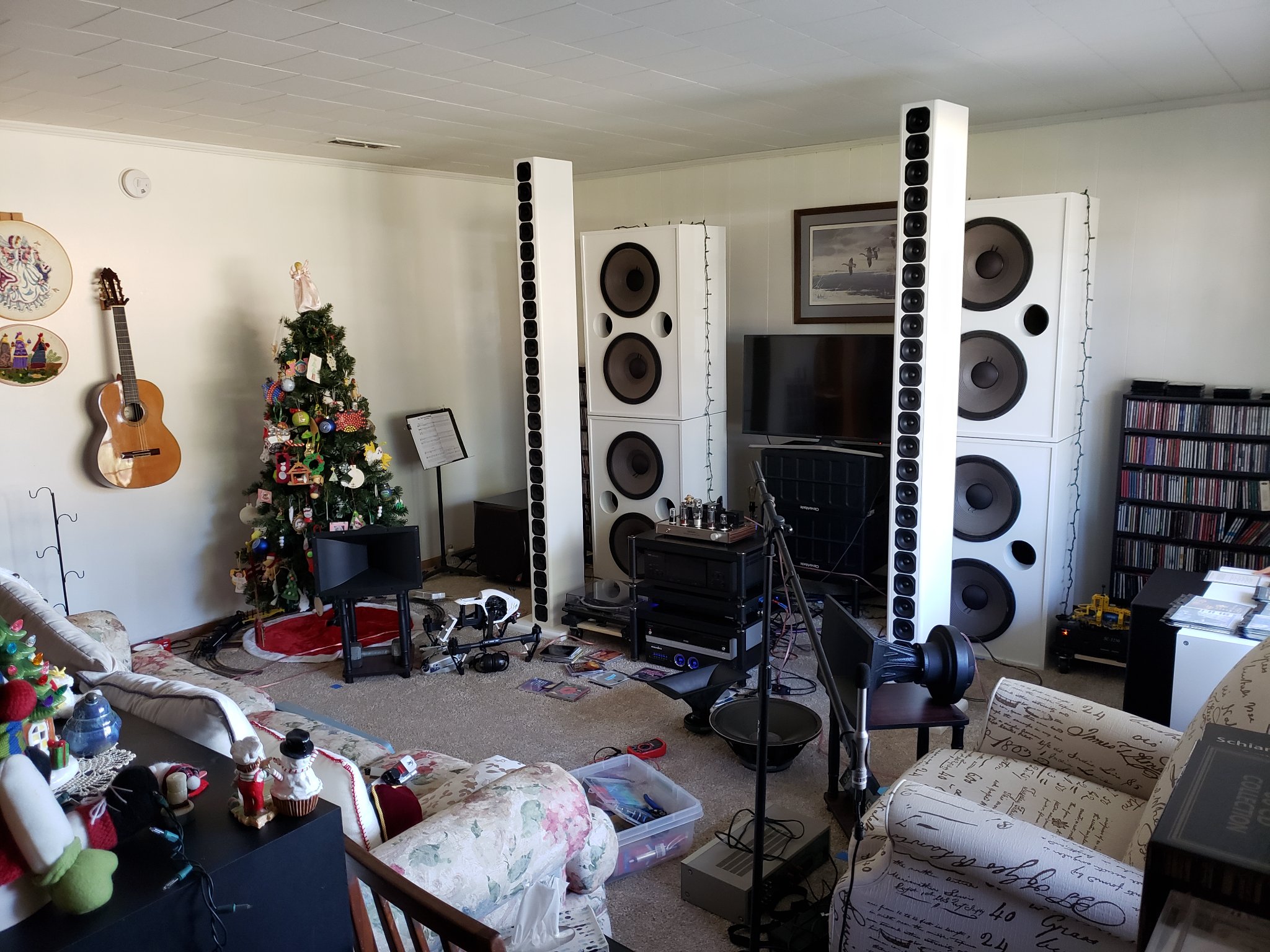

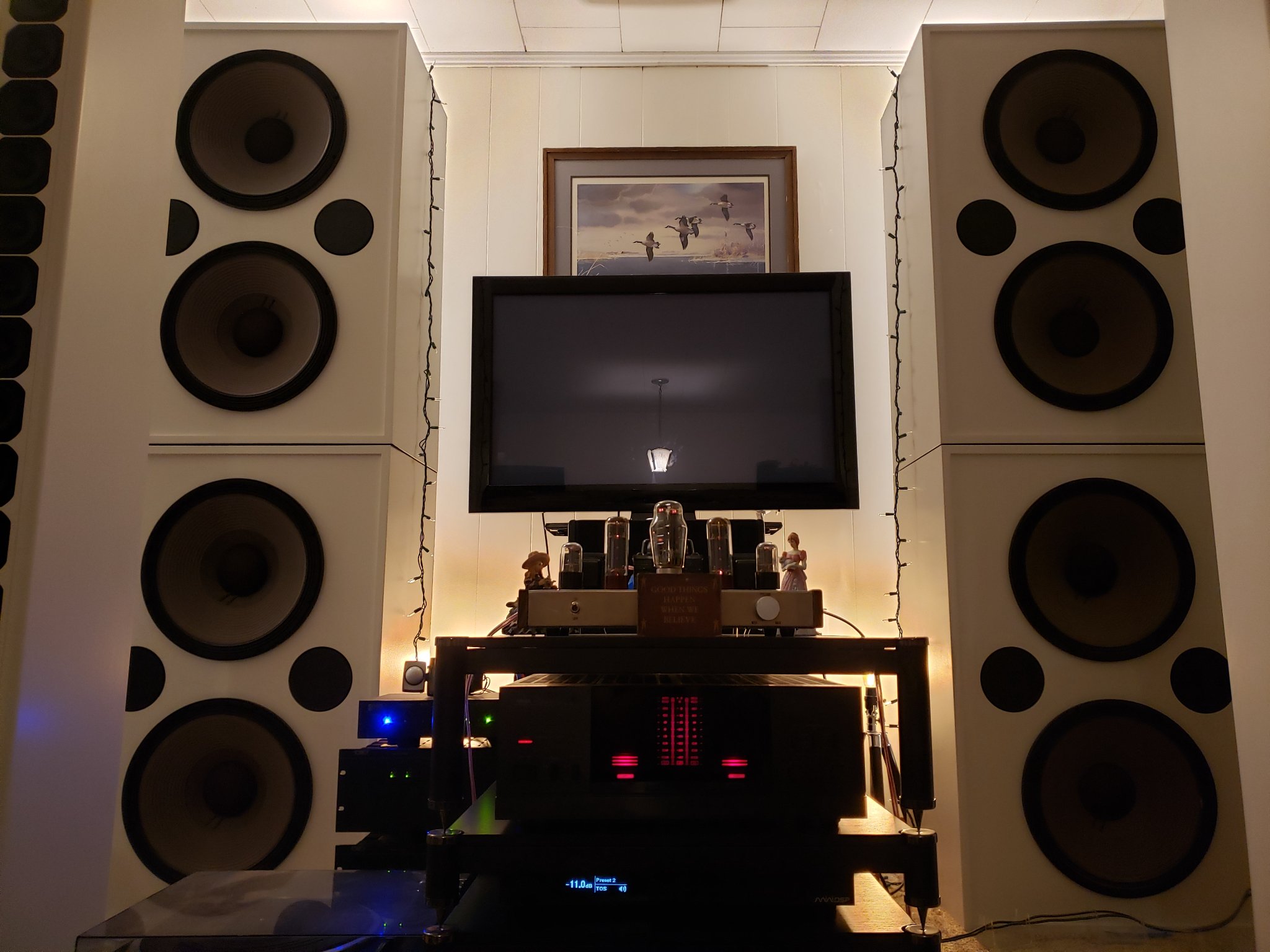

Here's a quick update. I now have two JBL 2446 compression drivers handling the highs. The line arrays are handling the mids. The bass line arrays are handling the low mids and upper bass. The line of 15 inchers behind the couch are handling 55hz down. There is also an HSU and an Infinity sub as well.
I still have some unfinished projects: Plugging the ports on the 15's.
Making stands for the compression drivers.
Adding my other 15" sub.
Adding another amplifier or two to get more out of all the 15's.

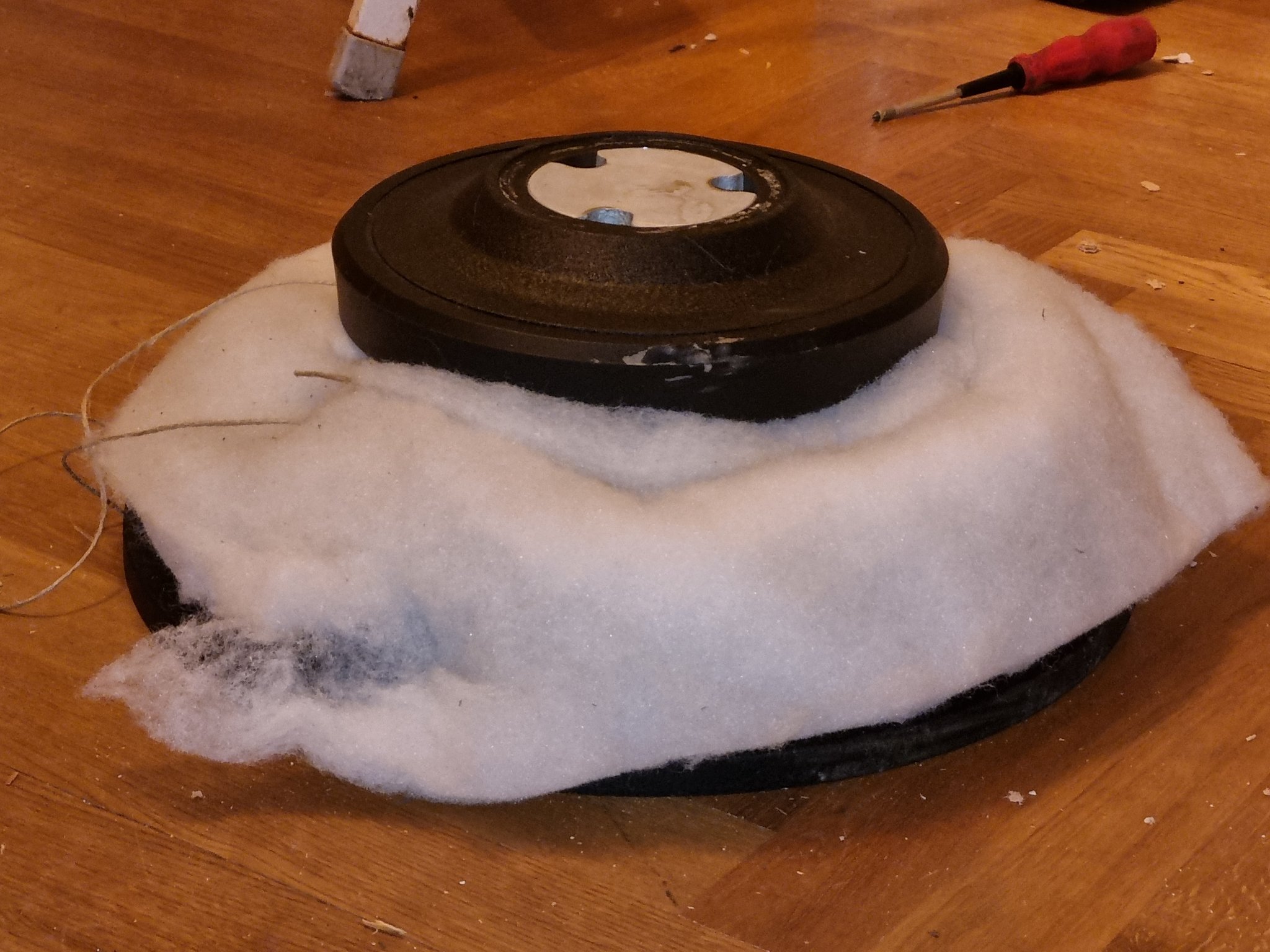

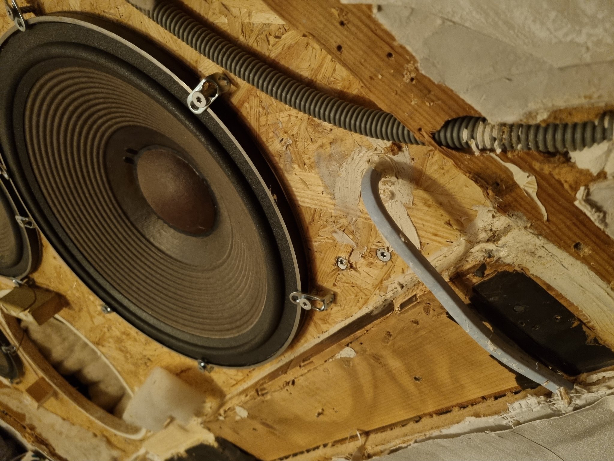

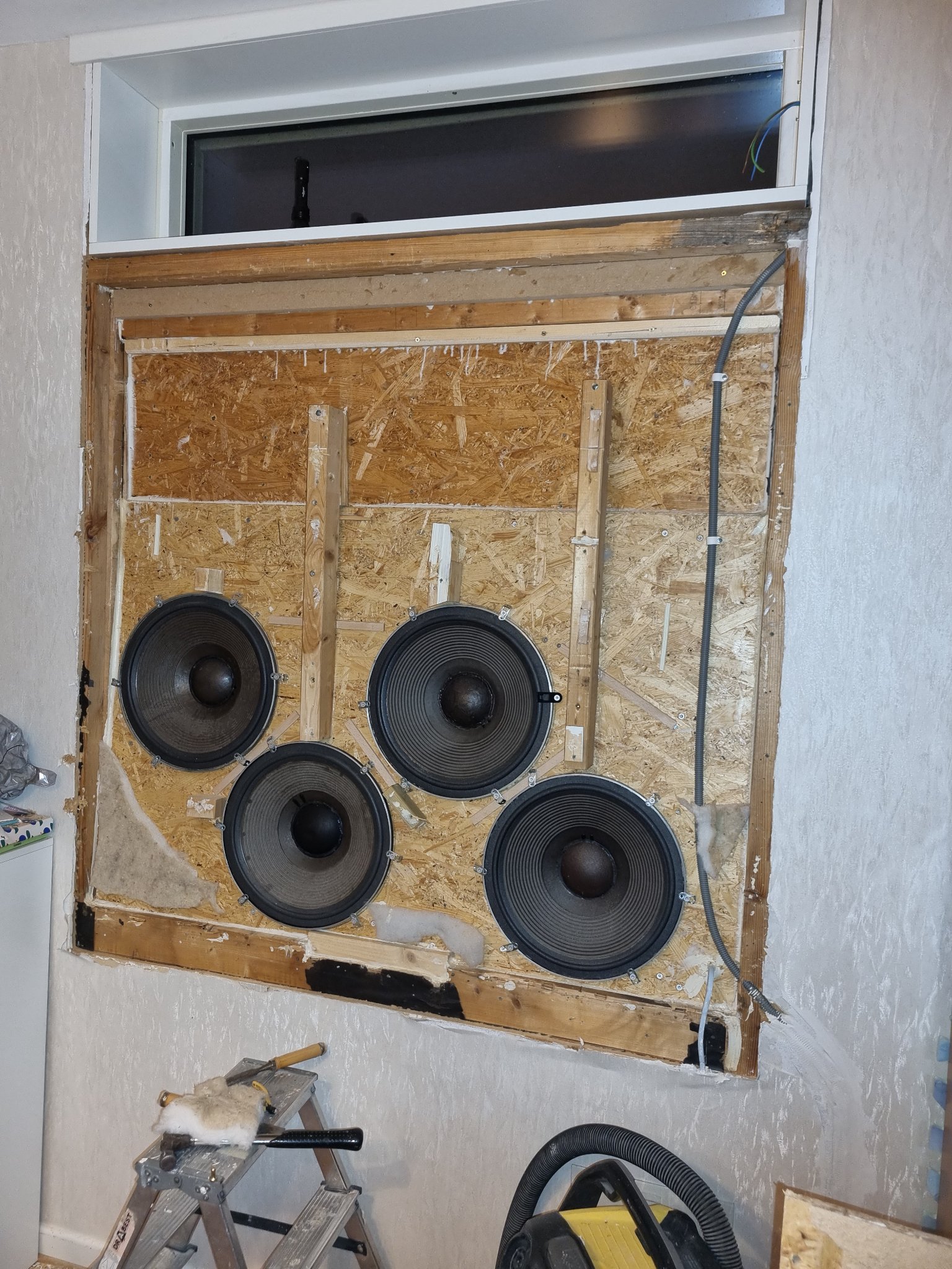

I use my garage as a SUB with 4x 2226H 15" with new foam surround from 2235 and a modified spider much looser giving a Fs below 20Hz. I use it in the range of 15-37 Hz. I cover the drivers with a wall and a ventilation grid just below the window.
Looks nice and it is "approved" by top management, after the threat that othervse there will be a 2x1m2 boxes in the corners. from 37Hz to 100Hz i use 3x15" elements in dipole configuration on each channel with ESL63.

Art, I finally got them all sealed. I definitely don't think I have the power to get them to 107db at 10 hz yet.With sixteen sealed 15" woofers, you could EQ flat to 10 Hz, and produce ~107dB SPL (discounting any room gain) while still being under the JBL 2226 driver's Xmax of 7.62mm, assuming enough power.
The sealed cabinets should be capable of ~120dB at 20Hz, some would consider that "crazy volume" 😉
Others would consider that level to be more than adequate for THX certification...
Art
I would think that the biggest improvement you will see with this arrangement isn't lower distortion or more "slam," but by radiating the sound in the lower, mid and upper parts of the room, you will be reducing bass nodes. You could see even better results by placing the woofer boxes in different positions in the room. Regardless, it sure looks impressive!
