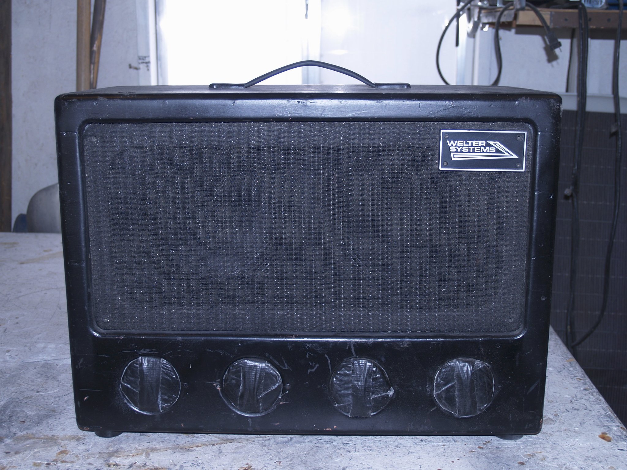

Gorilla tape (comes in white, 2" or 3") looks better than the duct tape used on this guitar cabinet:
You could then easily pull one or both plugs for different tunings- I changed frequently from sealed for guitar, two open for Theramin, or one for bass.
That said, unless you're planning a 1970s disco party, you'll probably leave the cabinets sealed 🙂

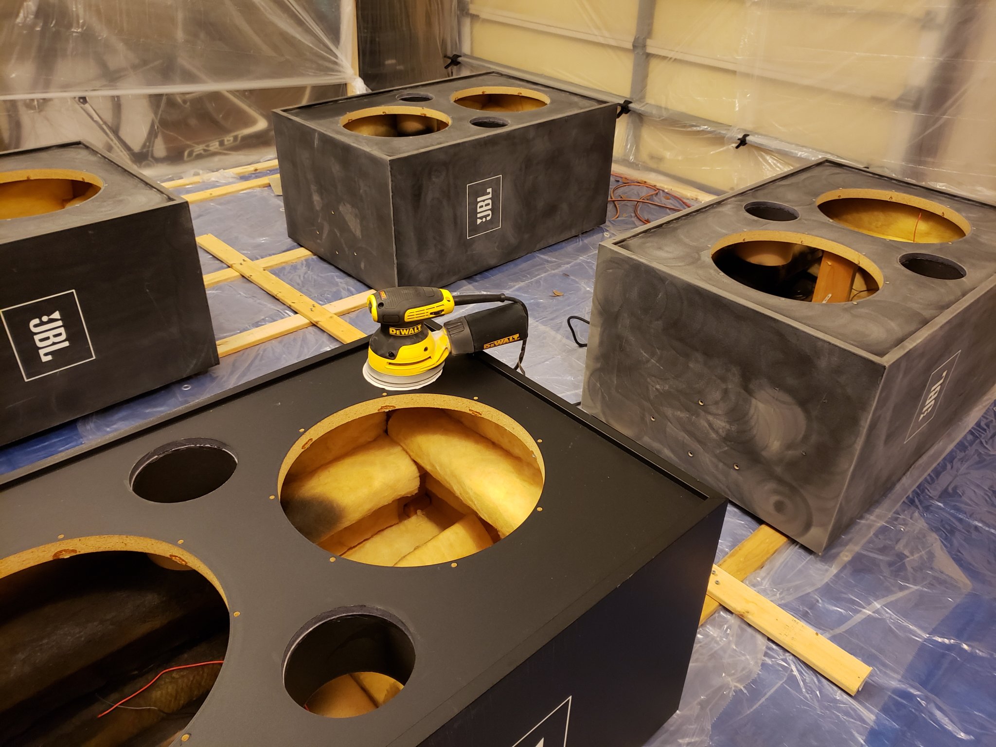

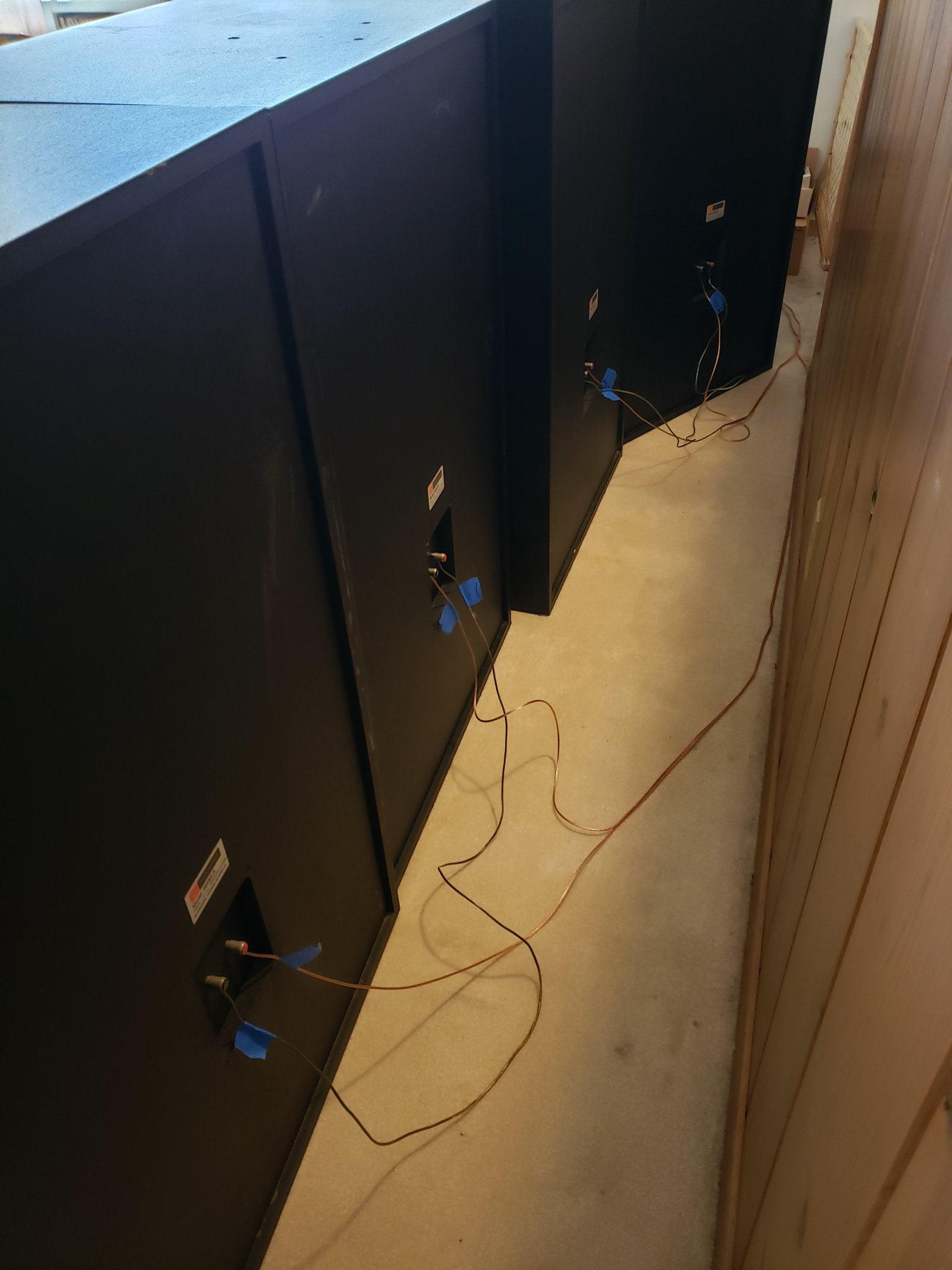

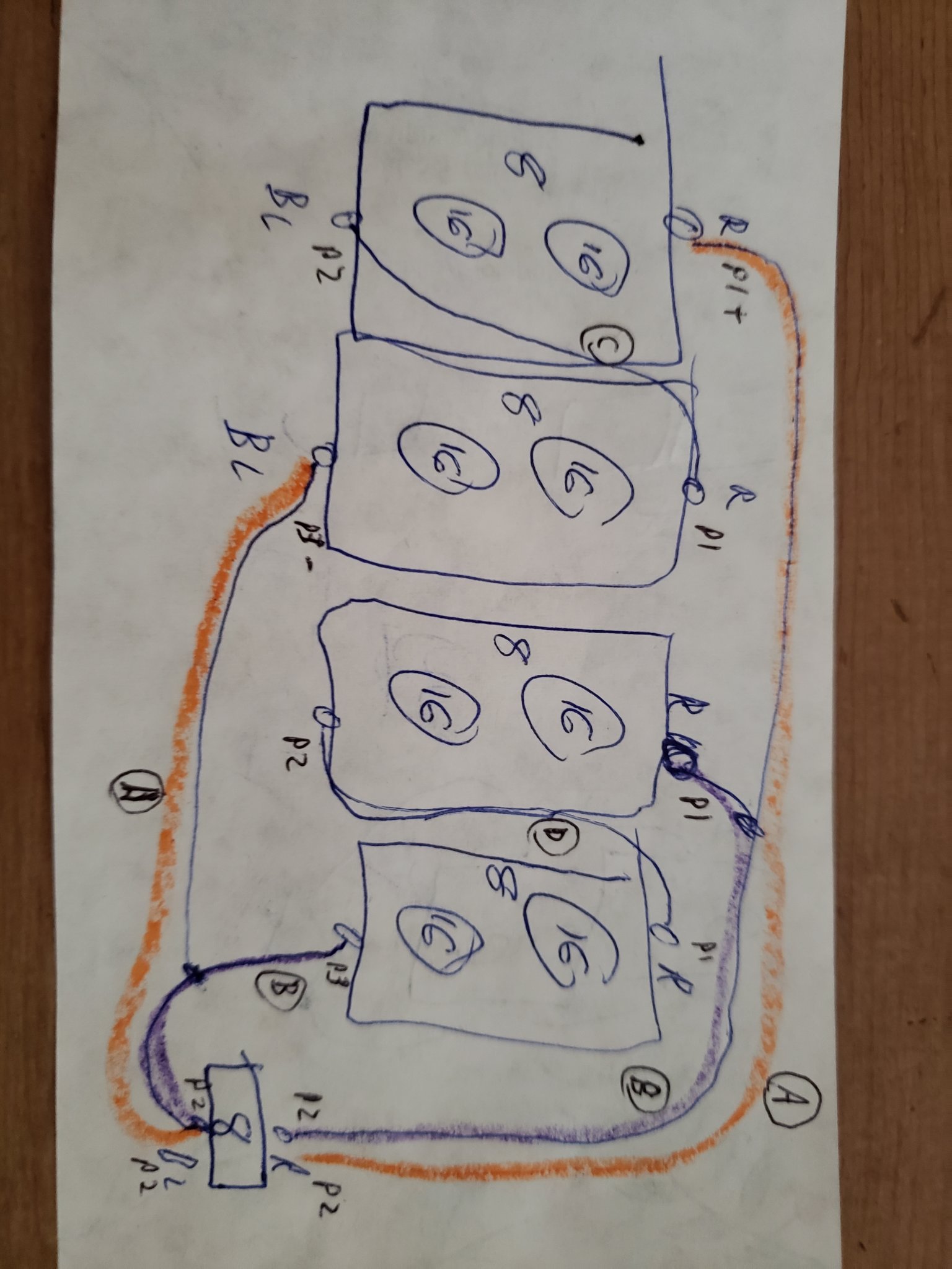

I have some drivers in this setup that are significantly quieter than the others and am trying to figure out why.
I'm trying to figure out if I wired this wrong or if a some drivers are dead.
It's supposed to be series parallel to 8 ohms and I'm getting 4.6 ohms..
I measures 8 separate drivers that came from the speakers I'm still prepping to paint. Those are measuring 10 ohms instead of 16.
Attached is my wiring diagram.
I measured the back of each cabinet terminal's: 4.6ohm, 3.4 ohm (quieter), 4.7 ohm, and 4.8 ohm.
To be clear, inside each cabinet is also parallel wiring between the two drivers. I'm not sure if I can do parallel wiring in each cabinet and then series parallel between the cabinets.
The DCR (dc resistance) of the nominally 16 ohm JBL 2226J is 10 ohms, so they are reading exactly correct.It's supposed to be series parallel to 8 ohms and I'm getting 4.6 ohms..
The series parallel DC resistance should be 5 ohms, you have ~.4 ohms wire resistance in the measurement.
I'd suggest thicker wire if you want the very best damping factor, but not a big deal in the grand scheme.
The 3.4 ohm (quieter) cabinet may have one or both drivers with partially shorted coils.
Probably hear them dragging if you push on the cone, or run a sine wave sweep.

If I have a variety of impedances between drivers, should I pair a higher impedance with a lower impedance driver to keep balance between one side of the "array" and the other or try and pair as close as I can in the cabinet?
A 0.1 ohm difference in the DCR of drivers is well within the usual manufacturing tolerance, don't worry about matching them.In the quiet cabinet one measured 9.4 ohm and the other 4.8 ohm. I'm guessing that one is bad.
Also, check if your ohm meter actually reads "0" ohms when you short it's leads, or touch them to a terminal screw..
An "8 ohm" 2226H has a 5 ohm DCR (could possibly be a wrong recone kit or replacement), but should be louder, not quieter than the "16 ohm" 10ohm DCR 2226J driver, so the 4.8 ohm driver is probably "bad".
Take a listen to it.
If it is bad, you could put a cover plate over its hole, the single good driver will still get the same power as the rest.
