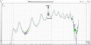

I made some refinements to my anti-xylophone. I have a stiffer frame and added some constrained layer damping to it to keep the resonances in the frame from affecting the measurements. I also started using a smaller exciter, with only a 13 mm voice coil. I was thinking to call it my Silophone (as in SILent). Which name do you guys prefer?
Meanwhile I got some samples of Poron foam, too. Test results below are with the new frame and compare two grades of Poron with my two 3M mounting tapes and with EPDM foam.
In the image below, all are compared. I ordered them from worst to best from top to bottom.
The Porons are two versions of Poron "Shockseal" foam, which are touted for impact protection and which the Poron rep thought would have particularly good damping too. The two grades are 4790-79 and 4790-92. The 79 is quite a bit firmer than the 92.
As it turns out, both are pretty good, while the 92 seems best, and in fact is just a bit better than my EPDM foam, perhaps. The Poron 79 might actually be the best at low frequencies by a small margin, but the 92 is clearly better than the 79 above 700 Hz. The firmer Poron 79 also creates more constraint at the ends, which pushes all the natural frequencies a bit higher than the rest.
The second chart compares the two best, EPDM and Poron 92. The differences are small but Poron 92 damps a little better in the 1 kHz range. Interestingly, the EPDM seems particularly good at 2 kHz, but I'm not sure exactly what's happening there so I'm a bit suspicious of that.
