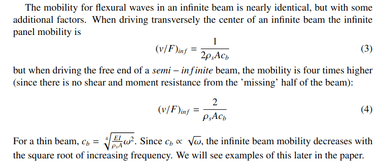

Christian,The paper also explain the propagation in a beam which seems different the one of a plate. To see more in detail but if so, the "anti-xylophon" might be no reflected the panel behavior?
I don't recall seeing that in the paper. What part of the paper are you referring to? My undestanding is that the propogation in a beam and plate are quite similar.

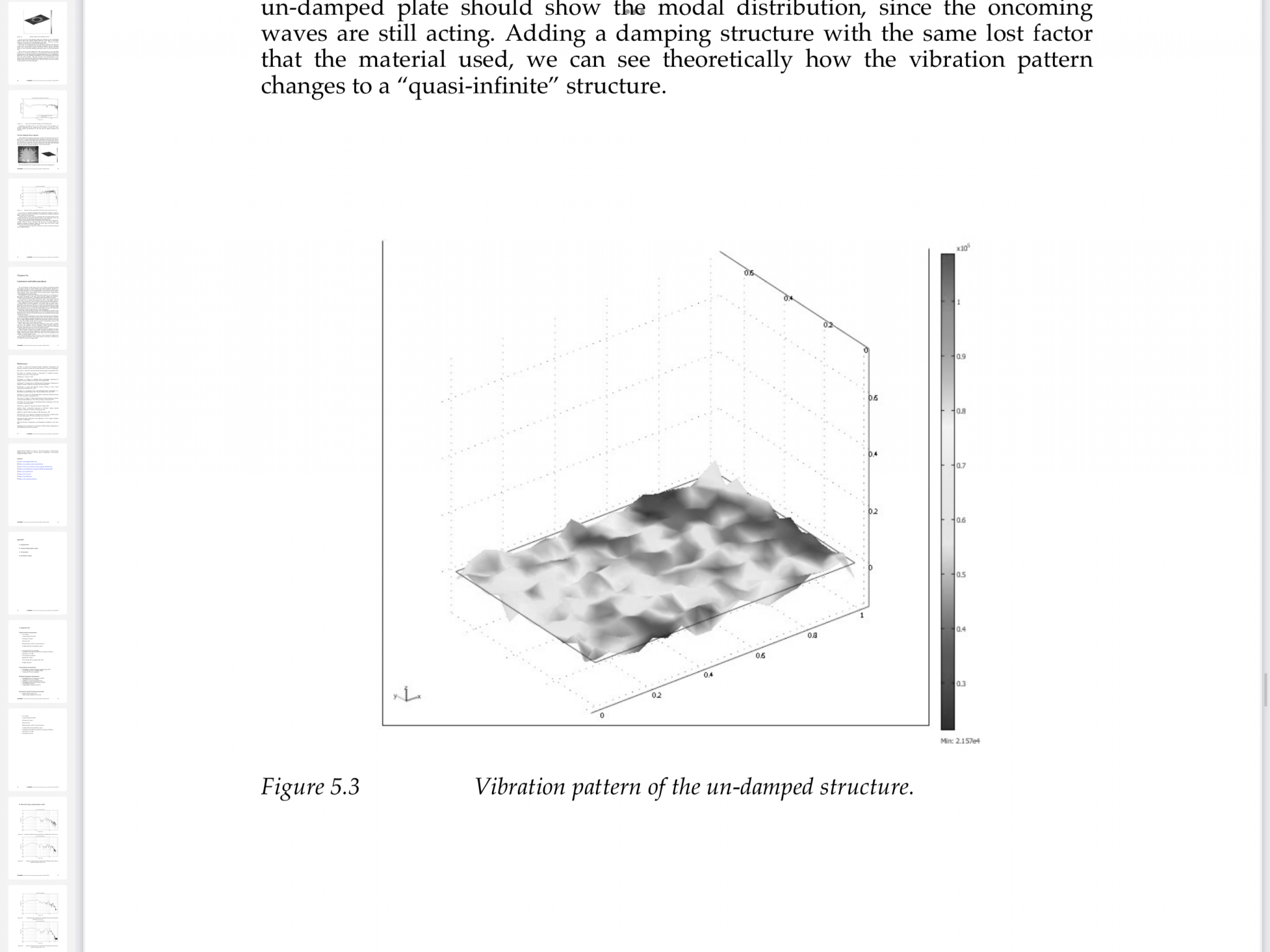

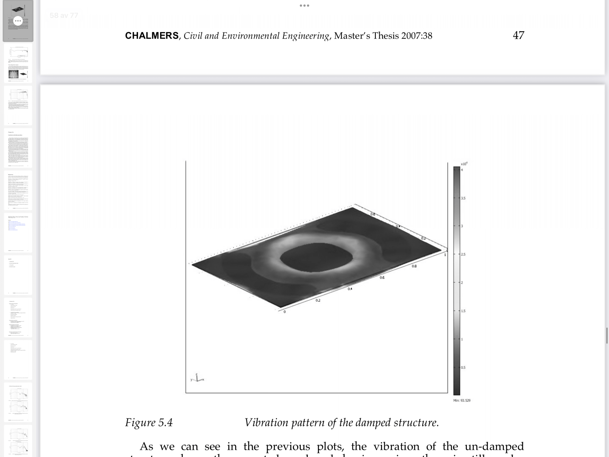

I do not know if you have seen this paper. It includes a section on 5.3 Simulating an Infinite Plate - Damping page 46. The conclusion is more or less that, if it’s no reflection then it’s not really a DML. Maybe the optimum is with some reflection?
The paper can be found at https://publications.lib.chalmers.se/records/fulltext/61709.pdf

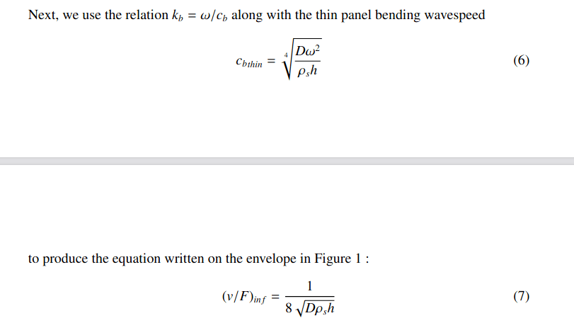

Eric, in M Hambric's paper https://www.hambricacoustics.com/In19_inf_panel.pdfChristian,
Eric
I am not sure of the consequences. Below an extract near equation 3
For beam and plate, cb is proportional to sqrt(w). See after eq 4 and eq 6.
But for a beam, v/F being the mobility (inverse of the mechanical impedance), if you substitute cb in eq 3, the mobility is proportional to 1/sqrt(w) where for a plate, the mobility is not frequency dependant (eq 7)
