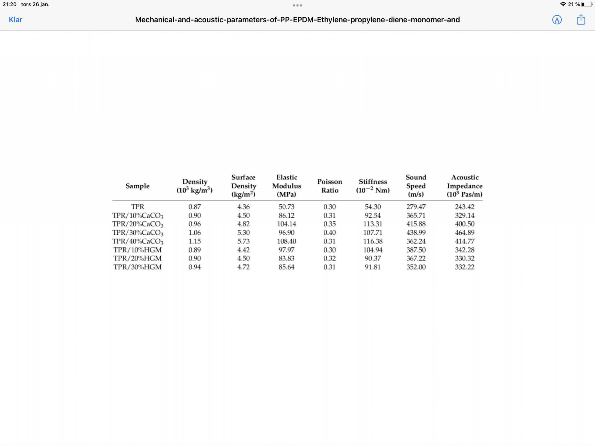

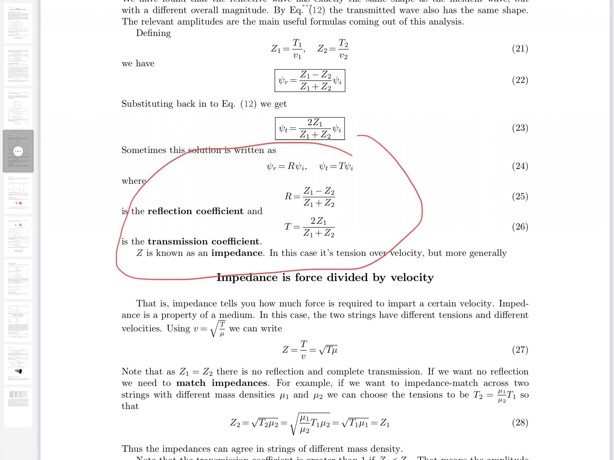

Some sketching…maybe to simplified…
Based on:
Assuming:
Carbon fibre density 1.5 x10^3 kg/m^3
Carbon fibre speed of sound 340 m/s, I’m using the bending wave speed att the coincidence frequency, not the longitudinal speed.
This gives an impedance of 1.5x 340=510 Pas/m
From the first table EPDM impedance = 243 Pas/m
From the last picture reflection coefficient = (Z1-Z2)/(z1+Z2) => (510-243)/(510+243)=0.35 i.e. 35% of the wave i reflected back in to membrane.
Questions:
Is it correct to use the bending wave speed? It varies with frequency thus the impedance will vary. B&w use an avarage cone impedance.
Is epdm able to convert the wave energy in to heat?
The density of epdm is critical. I have used a number of different epdm material from rather soft foam to more rubber like with different densities.
I should re-check them.
Thomas

It is correct to use the bending wave speed in the calculation of the acoustic impedance. The bending wave speed is a measure of the speed at which a bending wave travels through the material, and it can be used to determine the material's acoustic impedance.
Bending wave speed can vary with frequency, and therefore the impedance calculated will also vary with frequency. This is known as frequency dependent impedance.
One can calculate the mechanical impedance by knowing the acoustic impedance (or the other way around) of a material.
It is important to note that the correlation between the two types of impedance is not always straightforward, as the relation between mechanical properties and the density of the material can be complex and non-linear, especially in composite materials.

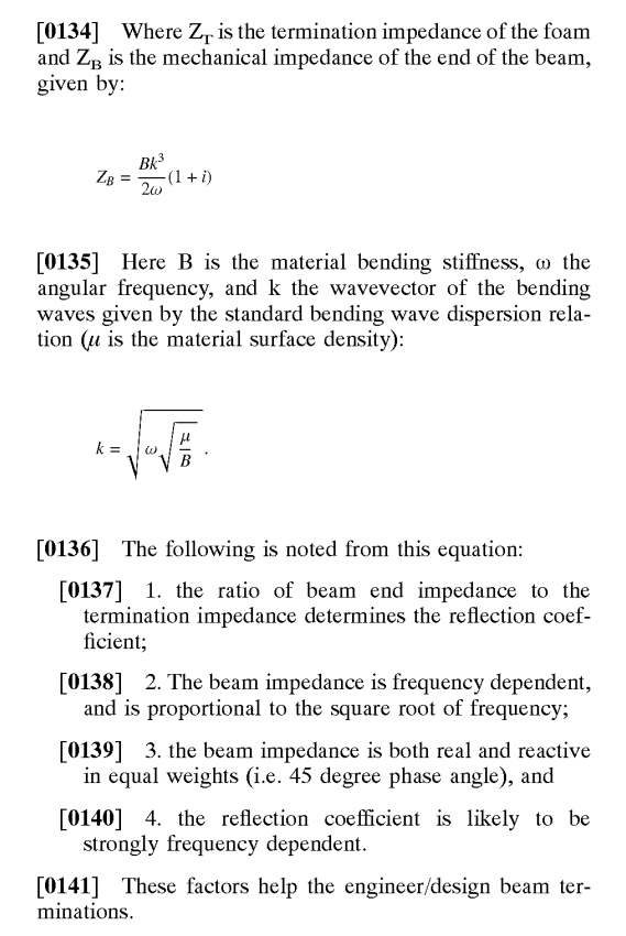

Christian,
I've been reading that patent (not finished yet) and came across this formula for the mechanical impedance of the "end of the beam" which I did not recall. Note, in this case it is a beam not a panel, but that should not matter much.
His expression is not the same as the infinite panel impedance we are familiar with.
Also, it's curious that he defines this parameter k as the "wavevector", when I think it is simply the bending wave speed.
Eric
Eric

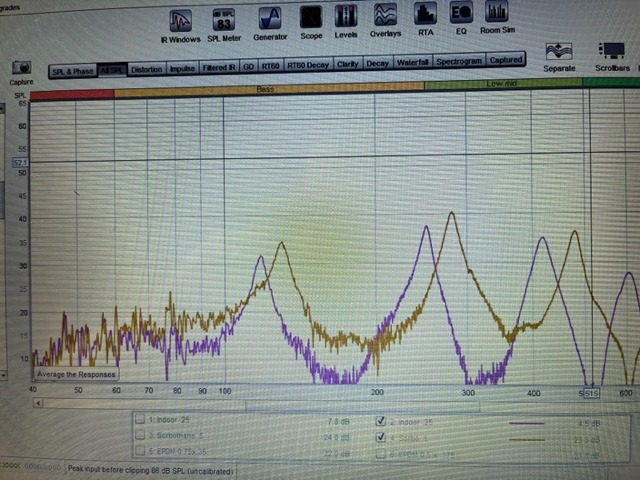

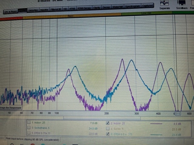

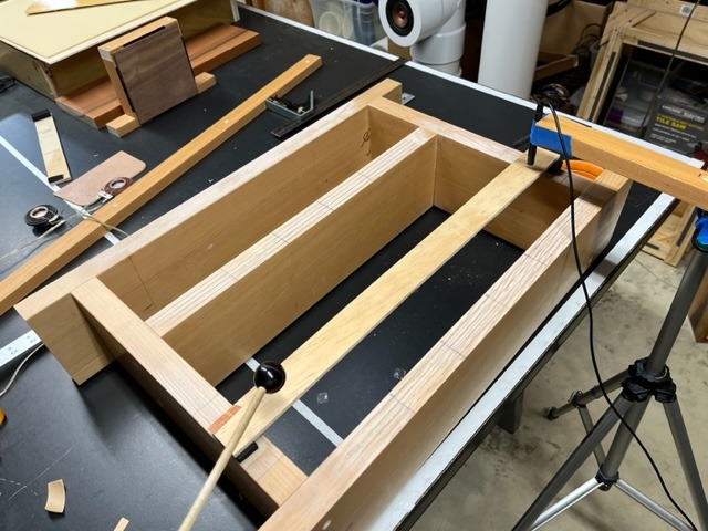

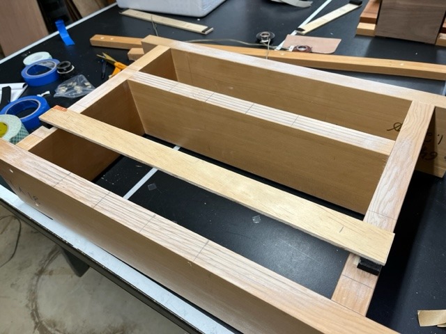

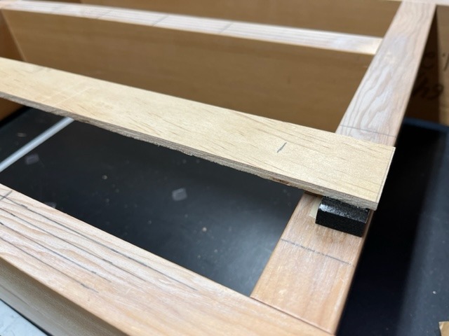

While we continue to work on the theory, meanwhile I have been trying to find a simple test to evaluate damping materials. Previously, I was rebuilding speakers over and over using the same panel and frame, but using different material (or different dimensions of the same material) between the panel and the frame. This method was extremely slow. Also, it used up a lot of damping material, as usually the foam, or tape etc was damaged when I removed it from the frame and panel. Also, it was difficult to avoid damaging the panel itself when removing it from the frame or removing the damping material from it.
Then it occurred to me to make a 1-D panel (i.e. beam) and test that instead. I'm still playing around with different arrangements but the basic idea is shown in the images below.
First I have a frame to which the damping material and "beam" sample are attached as shown in the first two images. The span of the beam is about 50 cm. Then, similar to my panel tap test, I place the mic close to the beam (say 2 mm) somewhere along it's length, and tap it using my mallet at another spot on the beam. Presently I'm tapping and mic-ing about 3 cm from the inside edge of the damping material. This excites several beam bending modes, especially the 2nd, 3rd and 4th about equally, it seems.
As in my other panel tap test, I monitor the mic using he RTA function in REW. The height and width of the resonance peaks should give an good indication of the effectiveness of the damping material. High narrow peaks are indicative of low damping, low wide peaks indicative of high damping.
In addition, the frequency at which the peaks occur, give an indication of the amount of constraint the damping material adds. The lower the frequencies the more closely the termination is like a simple support, while the higher the frequencies the closer the termination is to a clamped support.
The first results below compare 3M indoor foam (purple) to EPDM foam (blue). I have to admit I thought the difference would be more dramatic. But in any event the peaks are lower and wider for the EPDM than the 3M Indoor foam, apparently confirming that it is better damping and only slightly more constraining.
The second results below compares the Indoor foam (same as the first) with Sorbothane (orange line) shore 30, 3 mm thick x 12 mm wide. Interestingly, the Sorbothane, which is touted as high damping material, performs only slightly better (maybe!) than the Indoor foam, which I consider poor. Perhaps it was a poor choice of Sorbothane hardness or thickness, or perhaps this is not the intended configuration for using Sorbothane, but the result is not impressive.
I'm not settled on exactly this test methodology. That is, a different span or different tapping and mic-ing points might be somehow better. Also, these results are really only strictly applicable to a specific beam material, since a different beam will have a different impedance. But I think this general method offers a quick way to assess various end damping materials and dimensions with only a small amount of material. Now to find more materials to test.
Eric
