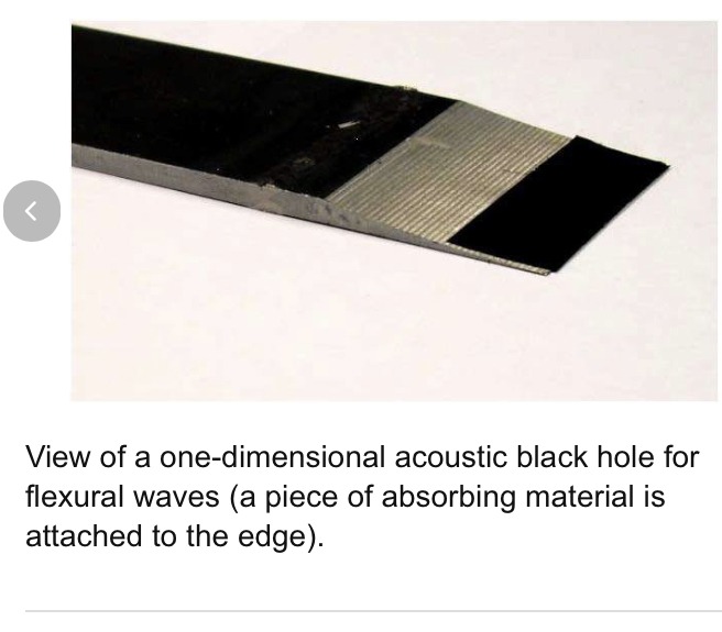

One night i guess i was high, and dreamt about using acoustic blackholes as boundary (make an exponential decrease of the mass in one direction or something like that). Then i ended up thinking if acoustic blackholes are just a marketing academic thing, or a curious sharp way to finish aluminium rods with some mechanical peculiarities. I dreamt about making odd boundary shapes with the help of a twisted hot wire. I mean daydream. I should create the daydreamaudio forum 😛 .

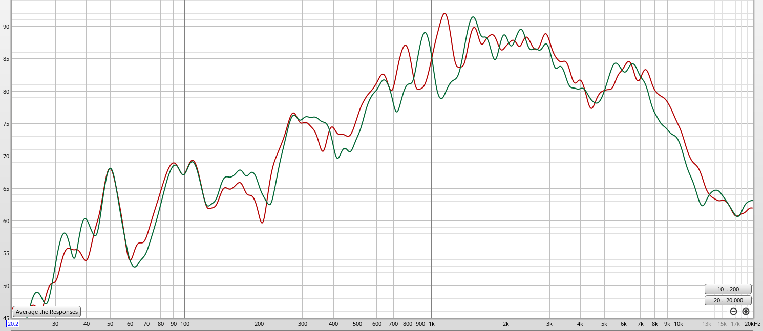

Just tested 2 pieces of EPS I have at hand (low grade EPS 13x17cm 7mm thick save from food packaging). red with straight edges, green with a 3cm bezel shape (cut with a knife so a straight cut). Both in free edge conditions (no suspension). Well... it is different. There is an effect around 1kHz, To be continued...
Similar to this, with the damping layer attached to the edge?
In the idea yes but in the quick and dirty mode (it tooks me more time to get REW working after my OS update than doing the test!)... The cut is straight (triangular cross section), I think similar to the picture, not 1/x^n shown in the ABH documents and with no damping layer. Proportion seems similar; Mine are 3cm of "ABH" area for 7mm thickness. I will try to find some sand paper in the week end. I would like also to make a test with an elliptical plate.
If you have experiences, papers on this topic, it would be helpful.
Wooow ! it really seems to be doing something 🙂 . Seems to be shifting the response a couple of hertz down and extending range a little, but certainly is doing something. Thanks for sharing!
My assumption is a mode shift in the 1kHz area. The change in HF might be simply the difference between the 2 samples. Exciter and mic position were kept but the exciter positions probably not the same on both samples.
