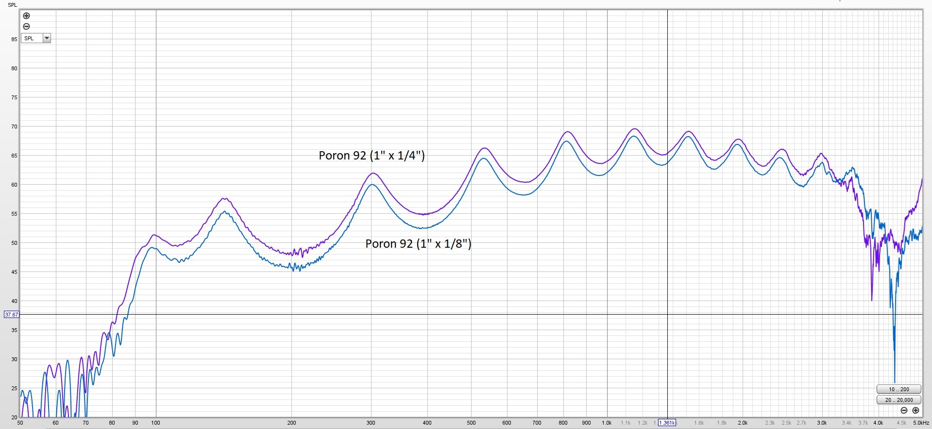

The width of the suspension is one parameter. Could you remind us the width in your tests?One tricky aspect is that the materials that seem to work best at the low end (e.g. butyl rubber, Poron 92) are stiffer materials, and tend to act more like clamped edges than simple supports.
Christian,
In my latest graph, I added the dimensions (width x thickness) to the graph. I'll try to continue do that in the future. I didn't specify it my my original plot. In any event, I am typically using something between 1/2" and 1" wide in the tests. The third dimension is always the width of my beam sample, which is 1.5"
The width of the suspension is indeed a significant parameter. I have tested several of the materials at different widths. As you might expect, widening the suspension usually increases the damping (as indicated by the sharpness of the resonance peaks), but increases the constraint (shifting the natural frequencies higher). I can share some examples later.
It might feel like a fairer comparison if all were compared at the same dimensions, but I only have whatever thickness is available easily, so that's already a variable I can't really control. Generally, I'm picking a width or widths that seems practical, while still not over-constraining the edges. For example, using my the 3M Extreme tape at a full inch wide would shift the frequencies much higher than using any of the foams at 1" wide, so I think it makes more sense to compare 1/2" tape to 1" foam, in such a case.

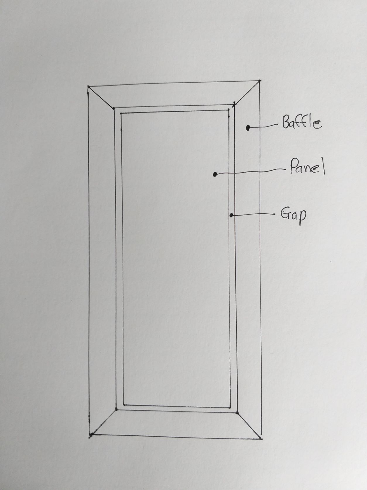

I had an idea to get the most out of damping materials.
To extract energy from the panel, a damping material layered under the panel has to be distorted, or squished if you will. The more it's distorted, the more energy can be extracted. But damping materials are firm, more or less, and dont really distort very much, particularly with a lightweight panel required for dml. So you end up changing the response of the panel, and extracting more energy at higher frequencies than you might want.
So the basic idea is just to allow the damping material a maximum degree of flex instead of layering it as part of a clamped or simple support.
There are several options, the simplest being to support the panel by joining it to the baffle with a strip of damping material across a gap, either as a membrane or as a rolled edge, instead of layering behind. Similarly if the damping material is thick and soft, support the panel with a layer between the panel edge and the baffle edge, again to maximise strain on the damping material.
See below. Damping material goes across gap as membrane or rolled edge, or fills the gap itself between the edges of the baffle and panel. In any case, the damping material is subject to greater stress (shear stress) than sandwiching it between baffle and panel, where it is subject to relatively less compression and tension stress.

Thanks for the sketch Paul. It's not necessarily clear to me that either geometry (sandwich, or surround style) would result in more deformation and damping, but I think either could certainly work. Generally I think the sandwich style is easier to execute in practice, but something like the image below is one way the "surround" approach could be easily implemented.See below. Damping material goes across gap as membrane or rolled edge, or fills the gap itself between the edges of the baffle and panel. In any case, the damping material is subject to greater stress (shear stress) than sandwiching it between baffle and panel, where it is subject to relatively less compression and tension stress.

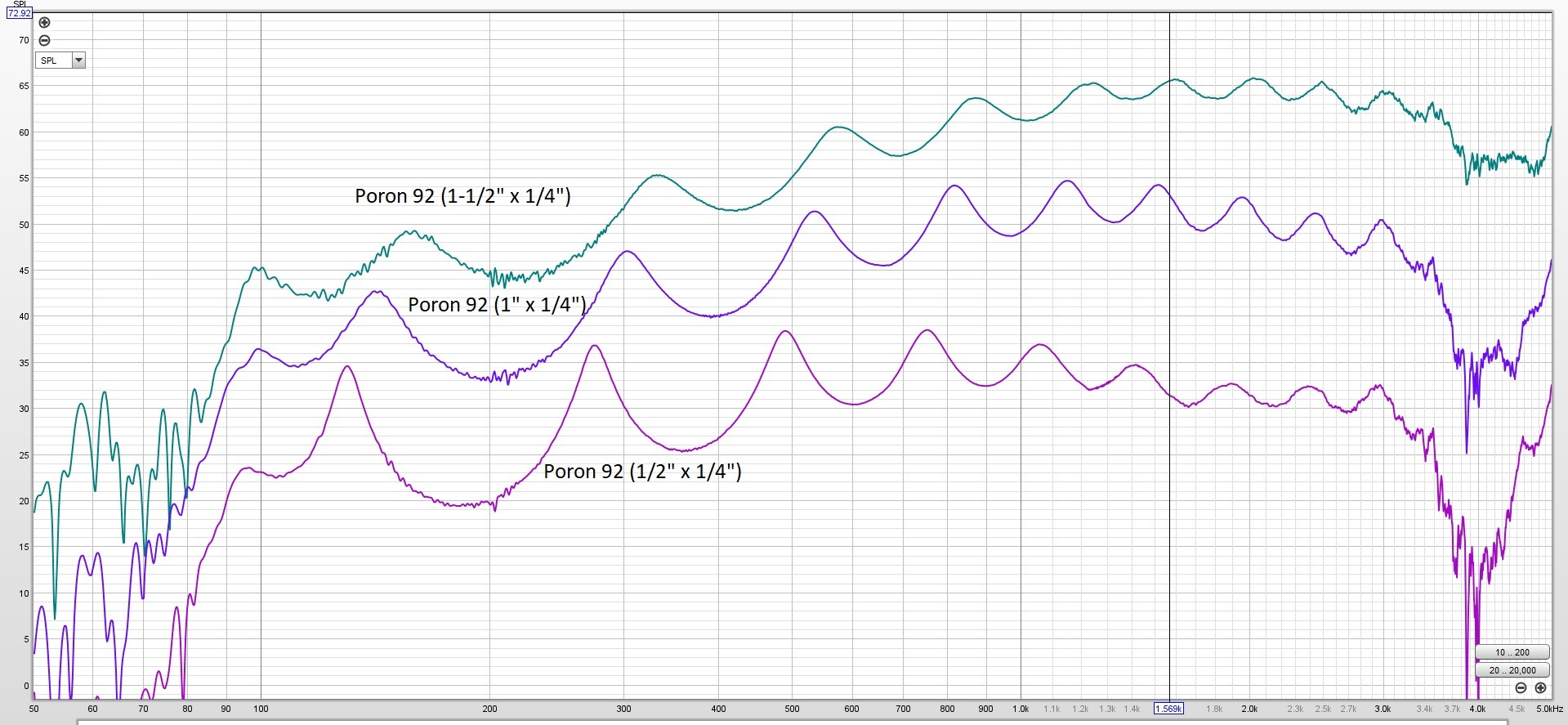

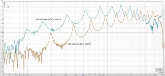

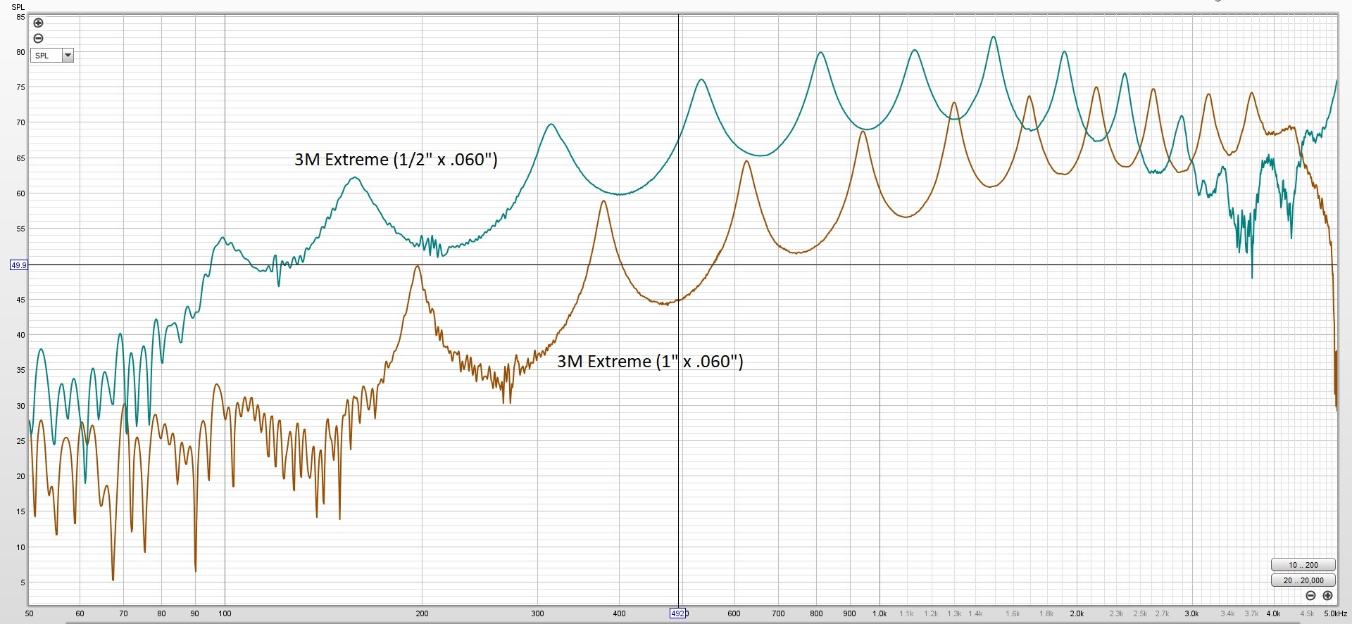

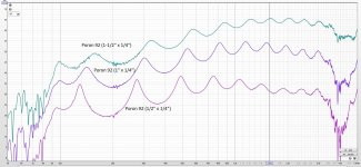

Concering the effect of the dimensions of the edge damping material, here are some examples.
For most of the materials I have been testing, making them wider increases the damping (flattens/widens the peaks) but pushes the natural frequencies higher. The example below is typical. In the chart, the first dimension is the width, second is thickness. Note, in these charts, ignore the first peak (at 100 Hz). It's not a natural frequency of the test beam. The exciter basically only works above 100 Hz,
But one exception is the 3M Extreme mounting tape. Perhaps it's different because it is not a foam (or is very lightly foamed). For it, making it wider still pushes the natural frequencies up, but the damping gets worse (sharper peaks).
Interestingly, thickness has virtually no effect, at least in this comparison:
Eric
Eric

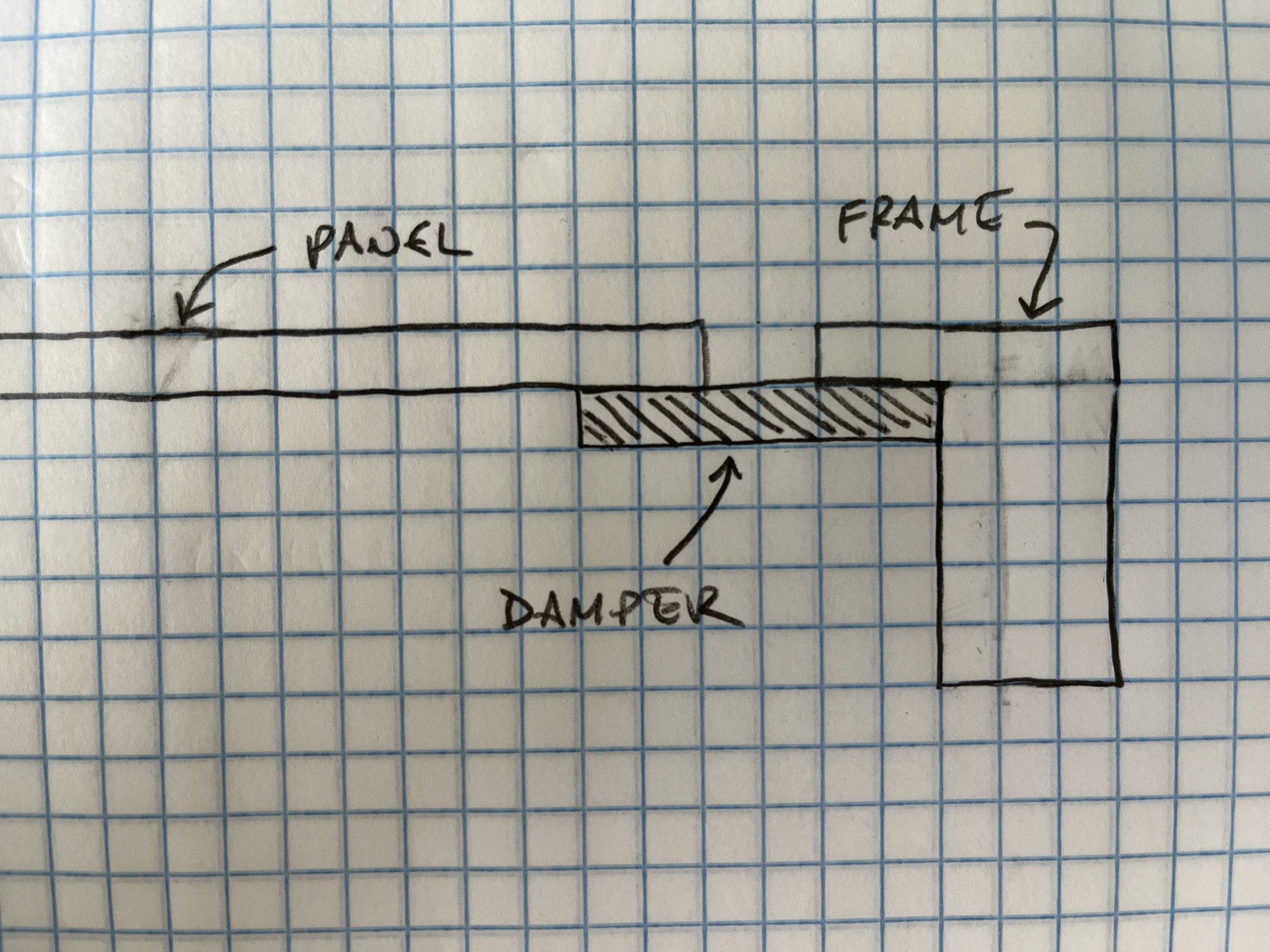

I probably just need to explain more clearly.I'm not sure what you mean exactly
My understanding of your current test procedure is to rest the ends of your wooden lath on top of the damping material to be tested.
My thought was simply that, for a material with a slow recovery time, the material may compress and not recover in time to follow the vibrating lath in the next half-cycle. Therefore my thought was that the performance might be improved by gluing the damping material to the lath and to the test bench. This would ensure that all parts of the damping material are in intimate contact with the lath and support, and remain so throughout the test.
It also occurred to me that once you go to the trouble of gluing, you may as well make another kind of test with a free end of the lath with and without damping. This is what I meant by 'glued, not sandwiched'
Paul
Paul,
My fault. I wasn't clear. In all the cases I've measured, the damping material was attached (i.e. "glued") by adhesive to both the frame and the test beam. Some of my materials have adhesive on both sides from the start, like the 3M mounting tapes and the butyl rubber glazing tape. Others have adhesive on one side (EPDM and others), and others on neither side (like the Poron foams). But in any case, I applied a double side tape to any any surface that didn't already have adhesive on it, to ensure that the damping material was firmly adhered to the rig on one side and the beam on the other.
I don't know what would happen if either side wasn't attached. Probably it would bounce itself right off the rig!

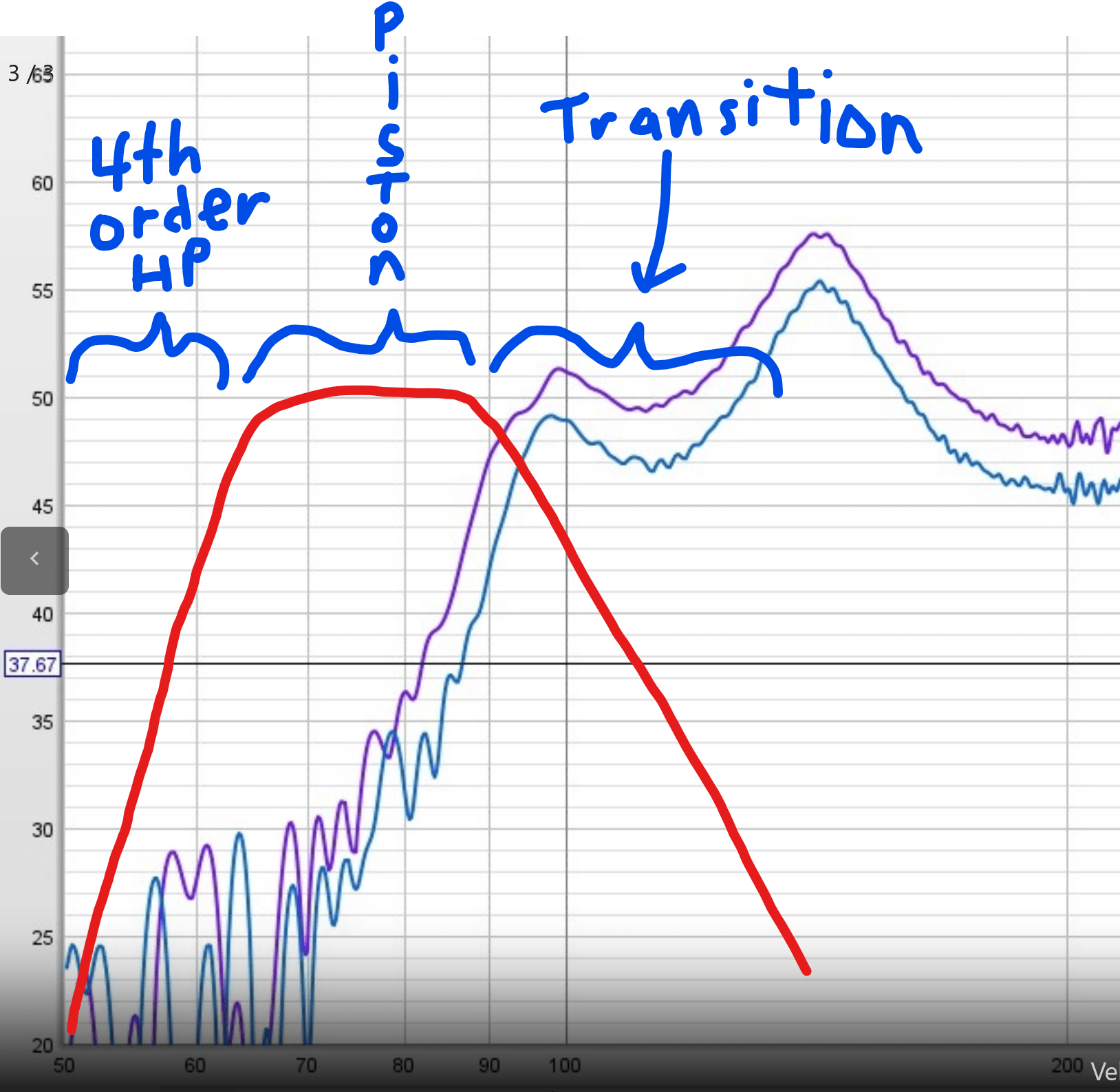

You know, the rigid body motion I describe above for the 'surround' approach could be advantageous; it could be used to augment the low end response if it were broad (low Q) and tuned just right. It would essentially be pistionic motion and act like an open baffle subwoofer (albeit without the baffle). Frequencies below the pistionic region may need to be HP filtered to stop overexcursion. Above the pistionic motion frequency the response may naturally roll off as it transitions to DML response.
Like this... Borrowing from @Veleric 's plot...

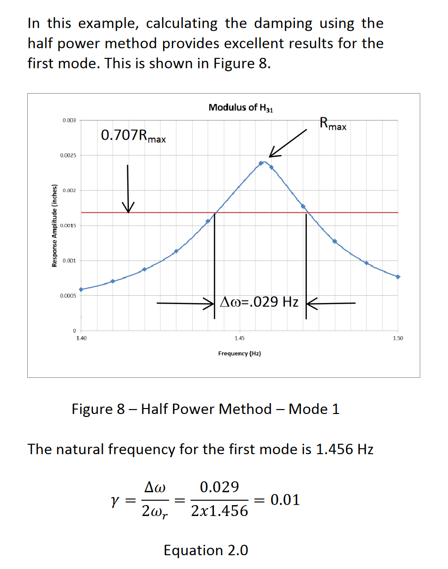

Here is the method for calculating the damping factor using the half-power method. Note it assumes that there is not significant overlap from adjacent modes which can alter the results. More details in the attached paper.
The other way to do it is to plot the transfer function directly from the response (if the software is capable) and then read Q straight from the plot, and calculate the damping factor from Q (easy).
