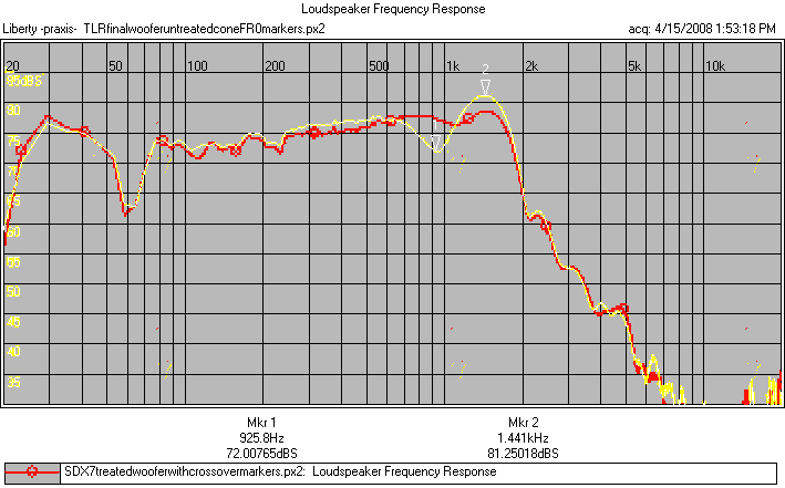

It gets hard but remains flexible. That flexibility is important. Adding more coats does stiffen things up, and i have, with some woofers, used multiple coats and some with decreasing radius to stiffen the inside of the cone more than the outside making for more controlled dispersion and roll-off up top (but less extension). The woofers in question were being crossed low.
This is an example:
7” SDX7 driver has an (unusual) woven cone on a sealed substrate. The loose fibres can vibrate. The yellow is stock, the red is 3 coats of thiined modpodge in decreasing amounts that tie all the fibres together. one can see a significant flattening of the top end and making the roll-off much better giving an effective extra octave of usable extension at the top.
