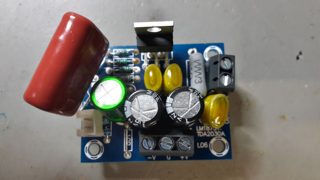

Hi
BOM as requested
source this threads: Yet another LM1875 amp - review request
LM1875 - Best Components and values
i decided to use this: (some parts are for a psu)
338-1108-ND MC12FA101J-F CAP MICA 100PF 5% 100V
1210 490-7751-1-ND GRM0335C1H101GA01D CAP CER 100PF 50V C0G/NP0 0201
338-2634-ND CD15FD101FO3F CAP MICA 100PF 1% 500V RADIAL
PPC3D2.2KCT-ND PAC300002201FAC000 RES 2.2K OHM 3W 1% AXIAL
493-3467-ND QYX1H104JTP CAP FILM 0.1UF 5% 50VDC RADIAL
BC1019CT-ND K331J15C0GF5TL2 CAP CER 330PF 50V C0G/NP0 RADIAL
P14629-ND ECQ-E1106JF CAP FILM 10UF 5% 100VDC RADIAL
493-3471-ND QYX1H224JTP CAP FILM 0.22UF 5% 50VDC RADIAL
S22KCACT-ND RNMF14FTC22K0 RES 22K OHM 1/4W 1% AXIAL
S1KCACT-ND RNMF14FTC1K00 RES 1K OHM 1/4W 1% AXIAL
BC4522CT-ND MBE04140C1008FC100 RES 1 OHM 1% 1W
AXIAL WW3FT1R00CT-ND WW3FT1R00 RES 1 OHM 3W 1% AXIAL

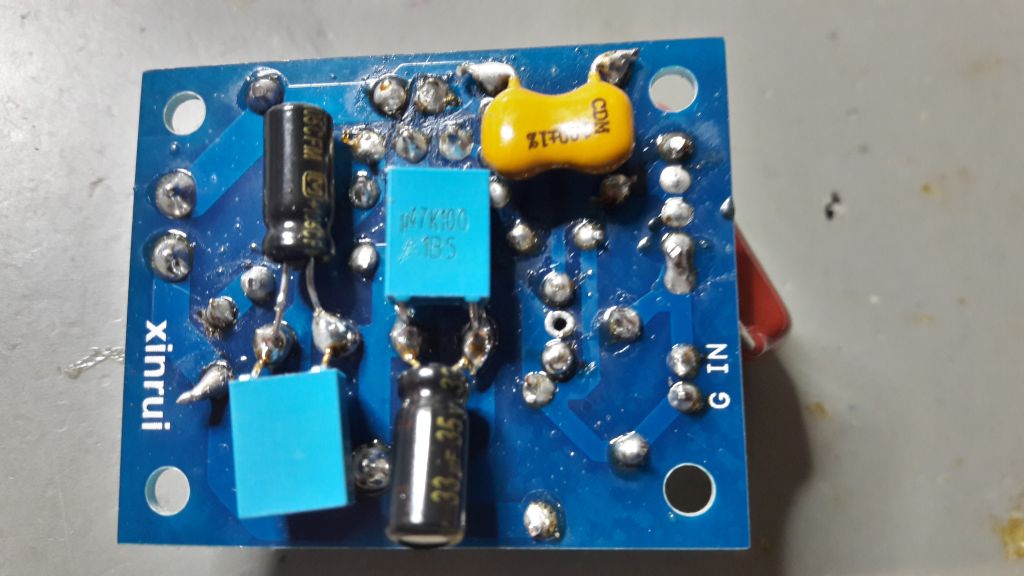

see pics
the decoupling cap i use:
470 µf/35V ZLH nichicon + 33µF panasonic + 0,47µ MKT TDK in parallel at the board - the input cap 10µF foil panasonic is really huge
R2 is shorted, 100pF - yellow cap under pcb is in parallel to the 22k Fb resistor,
other terminals, LM1875 by TI shop
"burn in" is running since 1 day ...Sound check at the weekend
chris

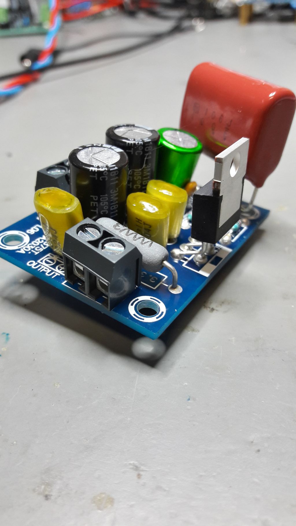

best parts amp:
i am impatient...
sound check 4 times 3 titles for comparison..
First SQ check is really very very good ! its sound very easy, clear, detailed, dark,.....all adjective which i had with my comparisons of the 2 amps ! - its not a sound what you can "imagine" its here - now - and very smooth.
actually i "just" use the very small cap bank - (4x2200µ + 4x1000µF)
i have to mod my psu bank and go ahead...
chris
