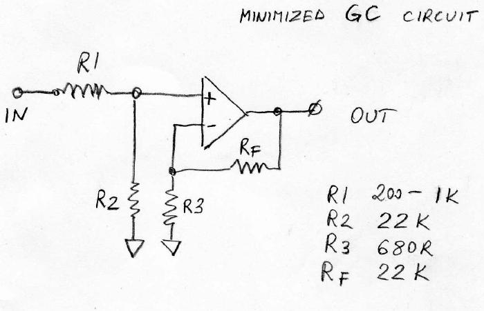

Has anyone built a LM1875 as a minimized Gainclone with only 4 resistors (2 on input and 2 on feedback) like Peter Daniel's LM3875 or Chipamp.com. I have one of PD/Chipamp here and got me thinking as it works well.

I mean getting rid of everything except the input and feedback resistors like this.

Chris, to stabilize your recovered LM1875 that tends to have self-oscillation at the top, you could try the trick from your posting #316, 2nd sketch, number (c). A resistor between the two inputs of the LM1875 may increase the loop stability. Start with 1K and work your way downwards.

As I recall my LM1875 days, I tried the 4 resistor DC coupled version with two probably "fake" LM1875 and it worked. In principle you can leave out R2 going from the non-inverting input and to ground IF you do NOT have a DC-decoupling capacitor at the input.
The problem with the DC-coupled LM1875 is that you have the input offset of the LM1875 times the LM1875 gain at the LM1875 output. I used them with an OP-AMP in a composite amplifier coupling with feedback from the LM1875 output such that it was the OP-AMP input offset I ended up with at the LM1875 output.
