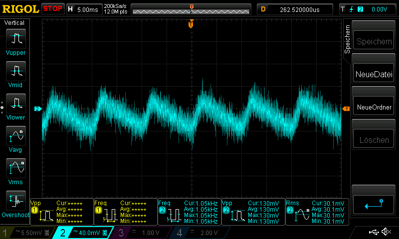

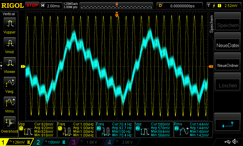

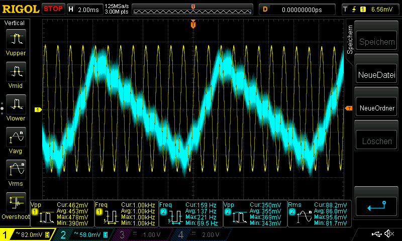

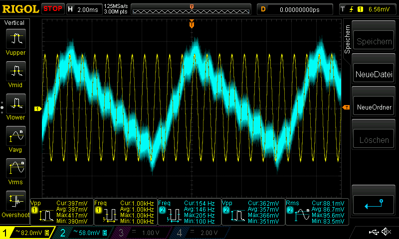

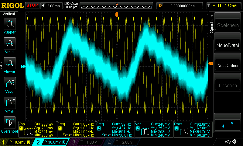

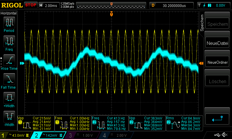

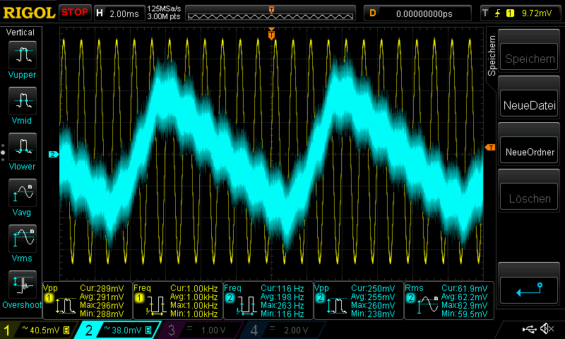

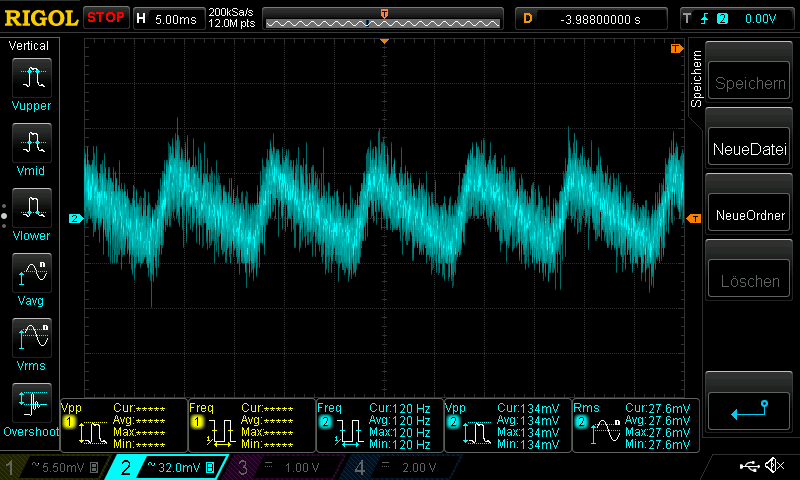

amp2_ripple idle/ load 8R
Hi
the amp 2
amp2 has the recovered lm1875 and the 4,7µF wima as input cap+ a 22µF ues green nichicon feedback cap. 1000µF/50 supply caps per rail at the pcb + bigger psu cap bank about 15000µF per rail measured.
pic 1 +2 are the idle ripple at V-, V+ at the cap bank board without load
pic 3+4 100mmVrms at 8R/0,7W ripple at V-, V+ at the cap bank board
pic 5+6 200mmVrms at 8R/2,6W ripple at V-, V+ at the cap bank board
pic 7+8 400mmVrms at 8R/10,7W ripple at V-, V+ at the cap bank board
chris
BTW: if you see at the input scope - yellow sometimes different values at the same measurements - i found that my probe is defective :-(

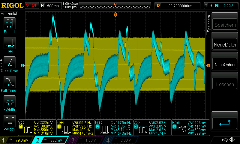

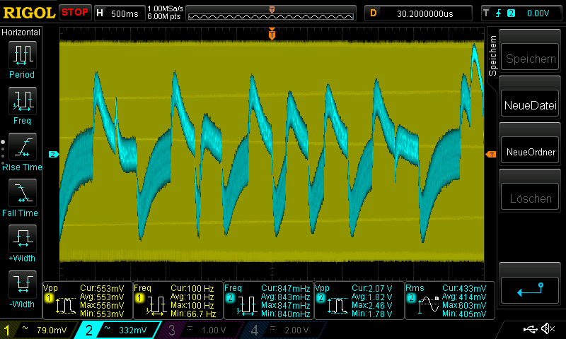

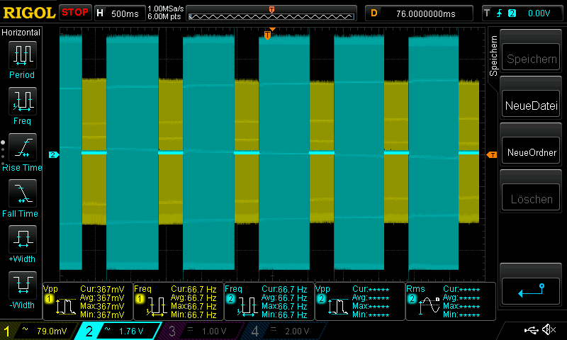

amp ripple at 4R
Hi
the same amp with 4R- this recovered chip shows again its ocp!
pic 1 100mmVrms at 4R/1,34W ripple at V- at the cap bank board
pic 2+3 200mmVrms at 4R/5,1W ripple at V-, V+ at the cap bank board- strange jumping
here is the output at 200mVrms input- every second switch off
at 4,52V rms-13Vpp - it is just 1,13A into 4R so it should not go into ocp!!
neertheless i will try to mod the recovered chipt as FF wrote in the previous post :
A genuine chip I find is a good idea. My suggestion serves for you (and us) to learn more about the tricks that are available when we end up in trouble, and that may only be with a "fake" chip.
chris

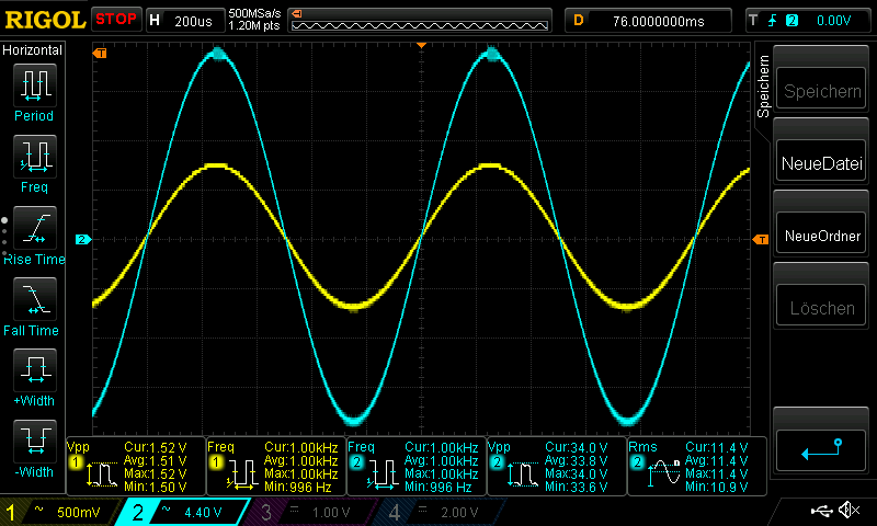

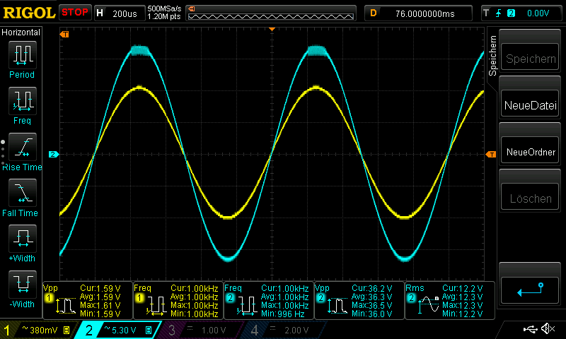

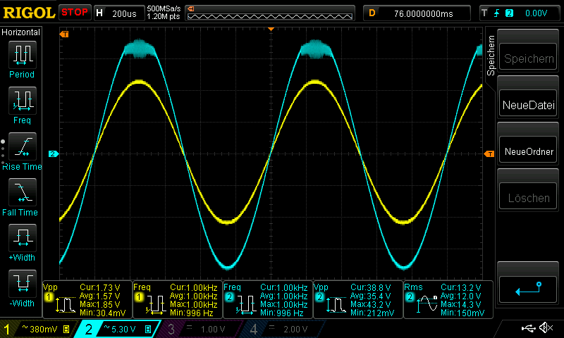

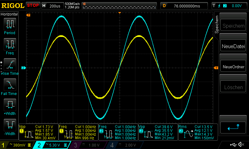

...recovered chip healed...
Hi
thanks to FF !

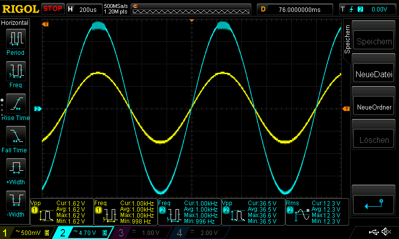

at post 320 i see at the recovered chip this ringing at the top of the positive sine wave. in post i get the hint by FF (post 334) to use a resistor between pin 1 + 2 and start with 1k.
finally i got:
with 1k (994,3R) i got a DC offset Voltage of -83,5mV - that is to much ---> i use 2k7 (2687R) and get 34,3mV DC offset and no ringing at 500mV
should i try to get less DC offset?
pic 1 is with 400mVrms input and no ringing at 8R - its about 10,2Watt each channel
pic 2 is with 500mVrms input and no ringing at 8R - its about 15,7WAtt
with 600mVrms in i get ringing at the top but not really as much as in post 320
chris

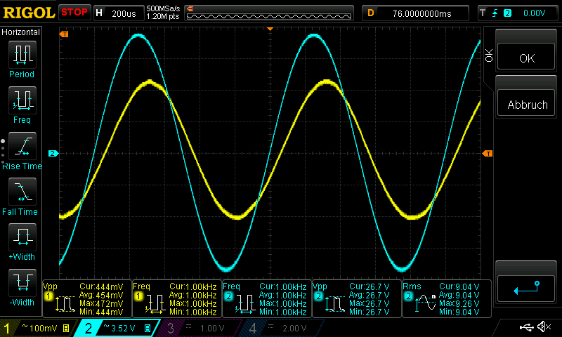

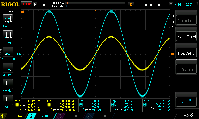

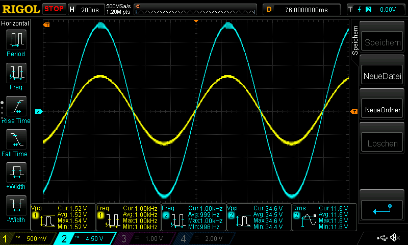

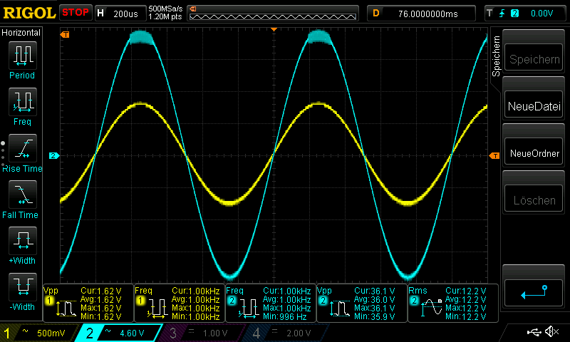

Hi
the ringing starts at 500mVrms input (15,7W at 8R)
pic 1 with 2k7 resistor at the R channel (DC offset 34mV)
pic 2 original at the L channel (Dc offset -1,5mV)
- more power get worse at both versions..not really a difference
520mVrms input - 16,8Watt at 8R
pic 3 with 2k7 resistor at the R channel (DC offset 34mV)
pic 4 original at the L channel (Dc offset -1,5mV)
chris

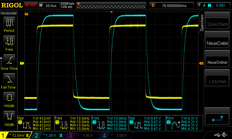

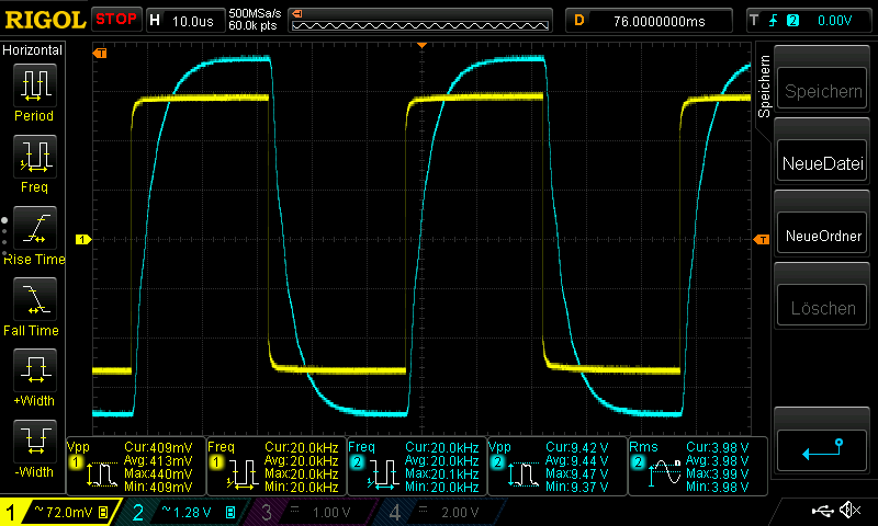

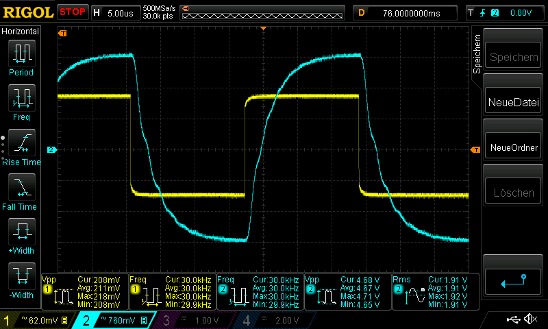

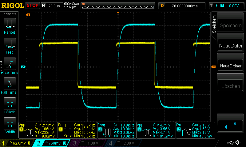

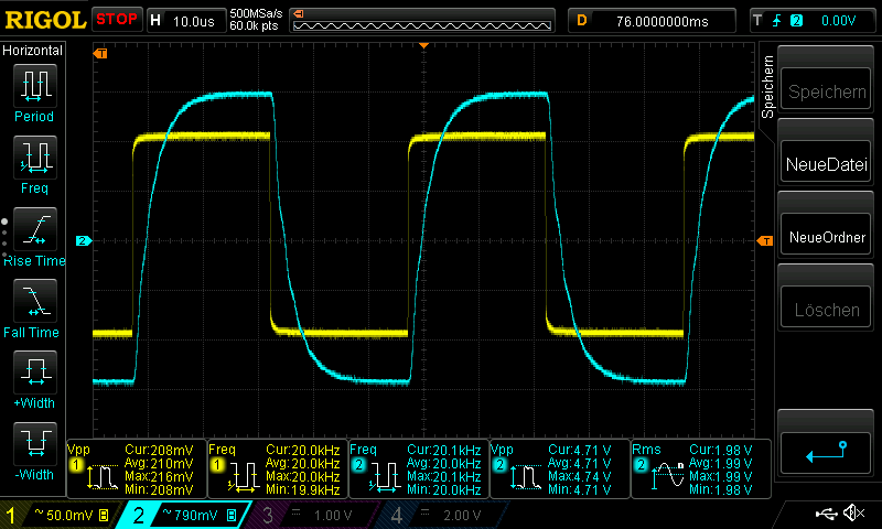

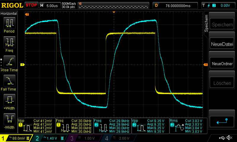

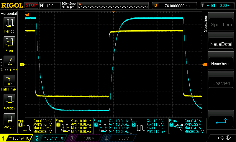

square wave stability...
Good Evening
i did at my recovered chips the modifications with the 2k7 (Rchannel)or 5k (L channel)at pin 1-2. for this configuration i look at the square wave stability with 8R load and a 440nF mkt cap at the spekaers terminal.
the 100pF is in parallel with the feedback 22k resistor. at this chip i got the ocp at 400mVrms input (as always) into 8R. (about 10W) -- both channels are identical
i checked it.
pics
100mVrms in 10k, 20k, 30k
200mVrms in 10k, 20k, 30k
400mVrms in 10k, 20k, 30k - ocp hick in - i set the scope to single
so everything fine.
chris
but look at the next post
Good Evening
i checked it.
pics
so everything fine.
chris
square 400mVrms 30khz in 8R with 440nF L channel _5k pin 12_ocp.png47.5 KB · Views: 49
square 400mVrms 20khz in 8R with 440nF L channel _5k pin 12_ocp.png50 KB · Views: 43
square 400mVrms 10khz in 8R with 440nF R channel _2k7 pin 12_ocp.png45.9 KB · Views: 44
square 200mVrms 30khz in 8R with 440nF L channel _5k pin 12.png47.4 KB · Views: 47
square 200mVrms 20khz in 8R with 440nF R channel _2k7 pin 12.png51.2 KB · Views: 44
square 200mVrms 10khz in 8R with 440nF R channel _2k7 pin 12.png51.2 KB · Views: 44
square 100mVrms 30khz in 8R with 440nF L channel _5k pin 12.png46.9 KB · Views: 43
square 100mVrms 20khz in 8R with 440nF R channel _2k7 pin 12.png50.2 KB · Views: 42
square 100mVrms 10khz in 8R with 440nF L channel _5k pin 12.png49.3 KB · Views: 182

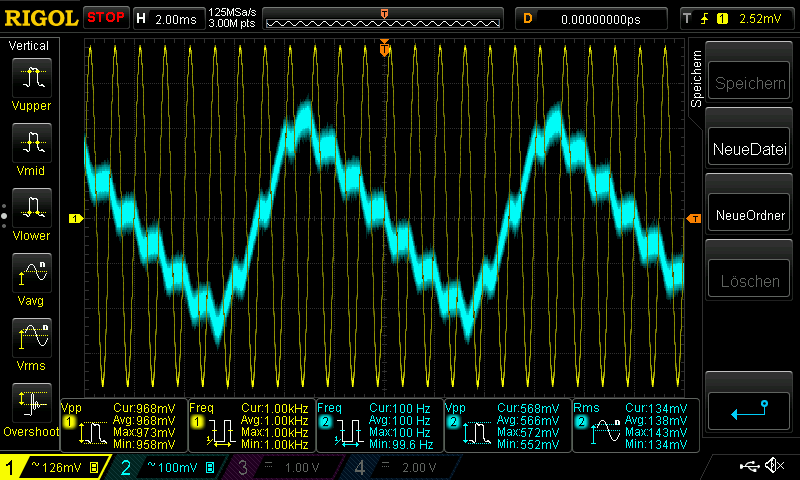

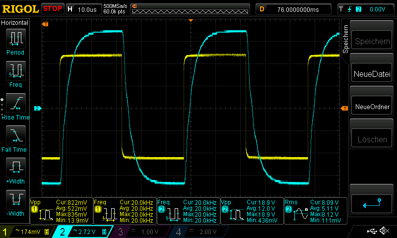

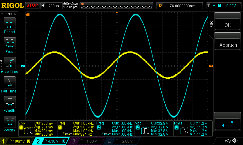

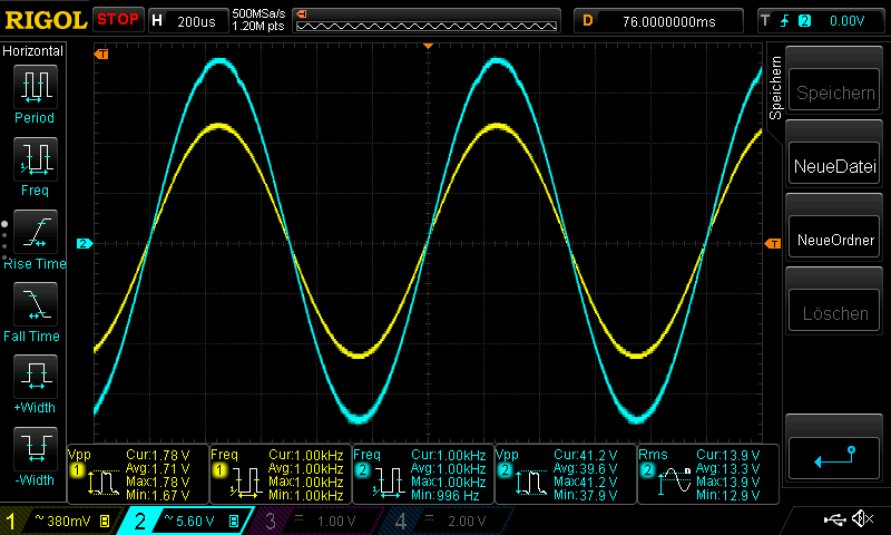

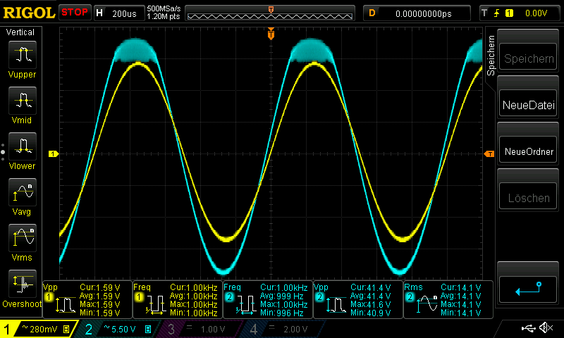

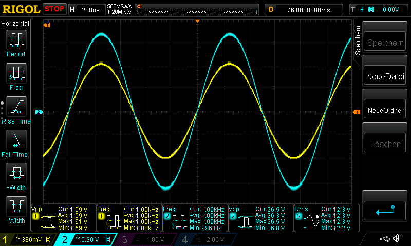

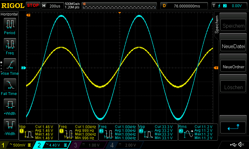

What i do not expect is that if i switch from square to sine wave i normally get a destroyed ringing at the top of the upper sine wave above 400-500mVrms - this is why i get the hint to use the reeistor between pin 1 -2 (2k7 or 5k)
look at post #347 or #320
now with 440nF at the output it gone.
examples:
pic 1 shows 550mVrms with 440nF at the output
pic 2 the same power without the 440nF at the output
pic 3 shows 600mVrms with 440nF at the output
pic 4 the same power without the 440nF at the output
pic 5at my input 620mVrms
??? why does the 440nF healed here???
chris

550mVrms sine wave with 440nF at the L-Channel 5k pin12.png49.6 KB · Views: 51
550mVrms sine wave without 440nF at the L-Channel 5k pin12.png50 KB · Views: 46
600mVrms sine wave with 440nF at the R-Channel 2k7 pin12.png50.7 KB · Views: 47
600mVrms sine wave without 440nF at the R-Channel 2k7 pin12.png51.3 KB · Views: 53
620mVrms sine wave with 440nF at the L-Channel 5k pin12_24Watt.png51.5 KB · Views: 51
