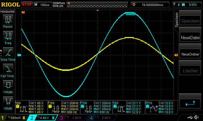

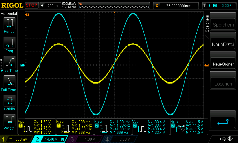

Hi
i have to refer to post 380 and the comment by FF at 381 with the oscillation at higher output power and the possible avoiding to do´s.
i am sorry i do not post my measurements :
pic 1 is the output power at 8R with 500mVrms input with the small cap bank and new components. post 173
https://www.diyaudio.com/forums/chip-amps/341675-ebay-mono-lm1875-kit-18.html#post5932363
pic 2 is the "burn in" amp/ and new cap bank version 2 with the more input and no oscillation - for me its clear that a bigger cap bank is better.
post 385
https://www.diyaudio.com/forums/chip-amps/341675-ebay-mono-lm1875-kit-39.html#post6002877
i swear i did not change anything at the amp boards🙂
the cap bank version 2 consist of:
8x 3900µF/35 chemicon europe caps
2x 47µ/50V Rubicon YKM
2x10µ/50V Nichicon audio blue
6x1µF/50V Rubicon YXF
4x MPC74 o,1 R resitors
output power is 10,8Vrms into 8R = 14,58Watt
output power is 11,5 Vrms into 8R = 16,5 Watt
