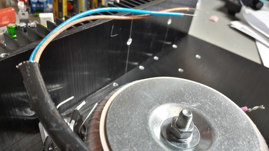

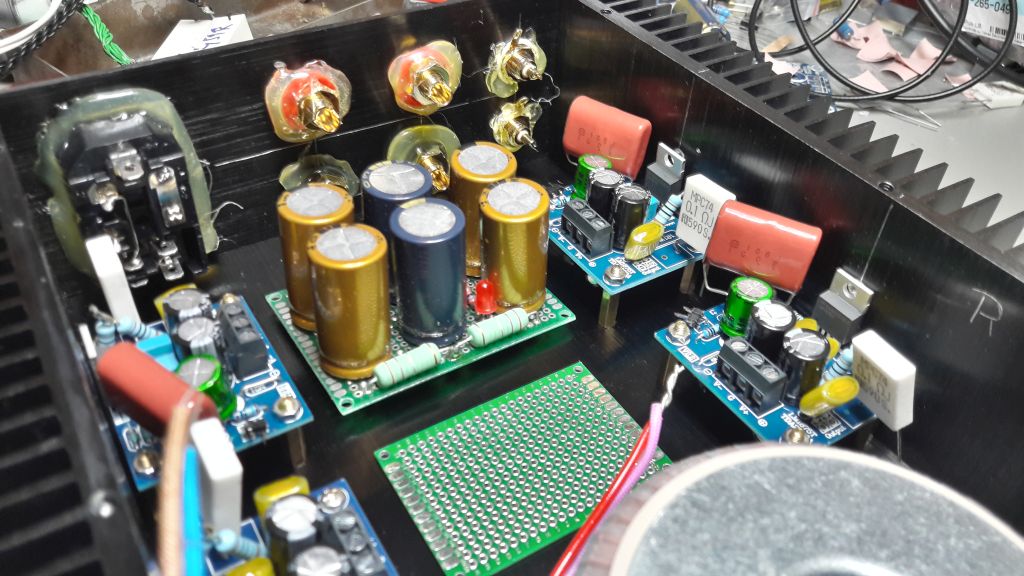

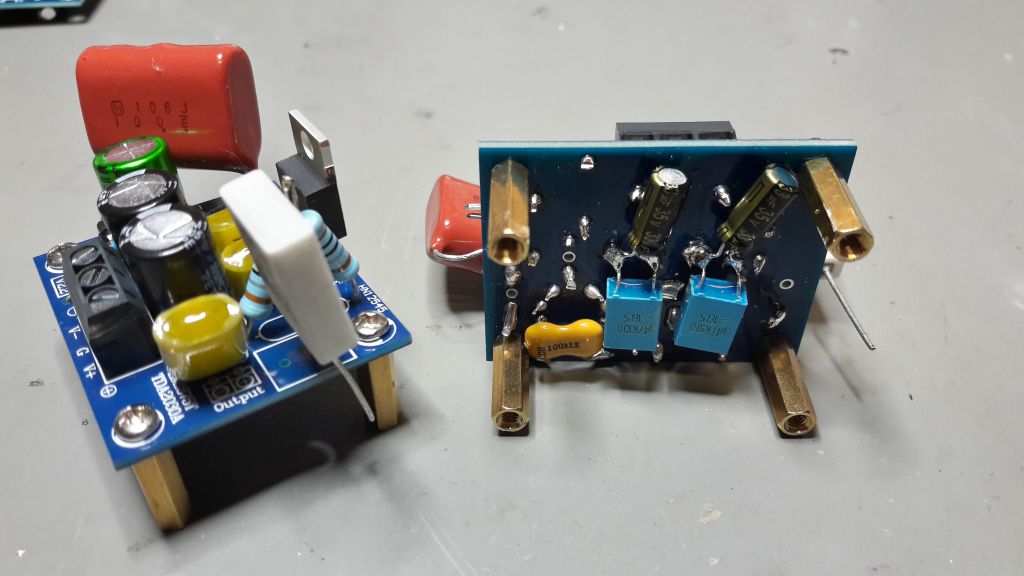

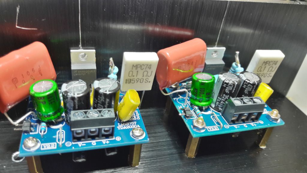

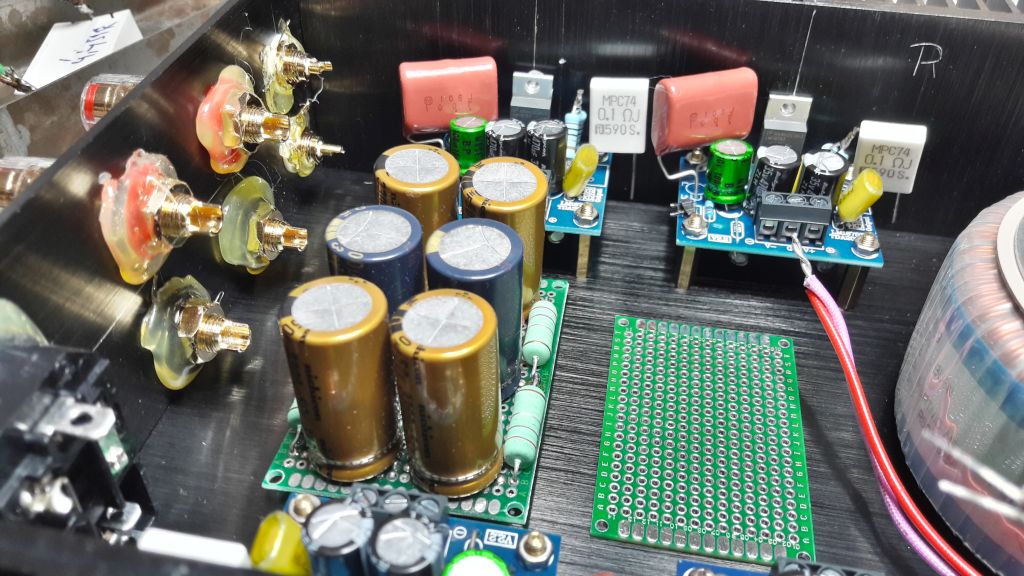

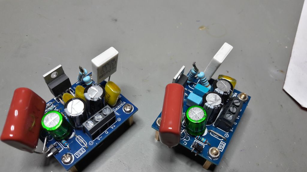

...start to build a parallel LM1875 each channel..
Hi
i started in the "old year" 😛 with the parallel chip amp. i want to have a better 4ohm current capability and take the challenge to build the amp boards with my planned housing..🙂
here some fresh pictures. the cap bank will not be installed and the naked pcb is for my fuse and terminal +V, GND, -V. i wish i have more room for that parallel amp 😀😉
chris
Hi
chris
Getting tight in there but it fits. Power supply in a separate enclosure also can work which is what I used. Made it easier for me to try different amp modules but a 1 box is a better final solution to go in a system.

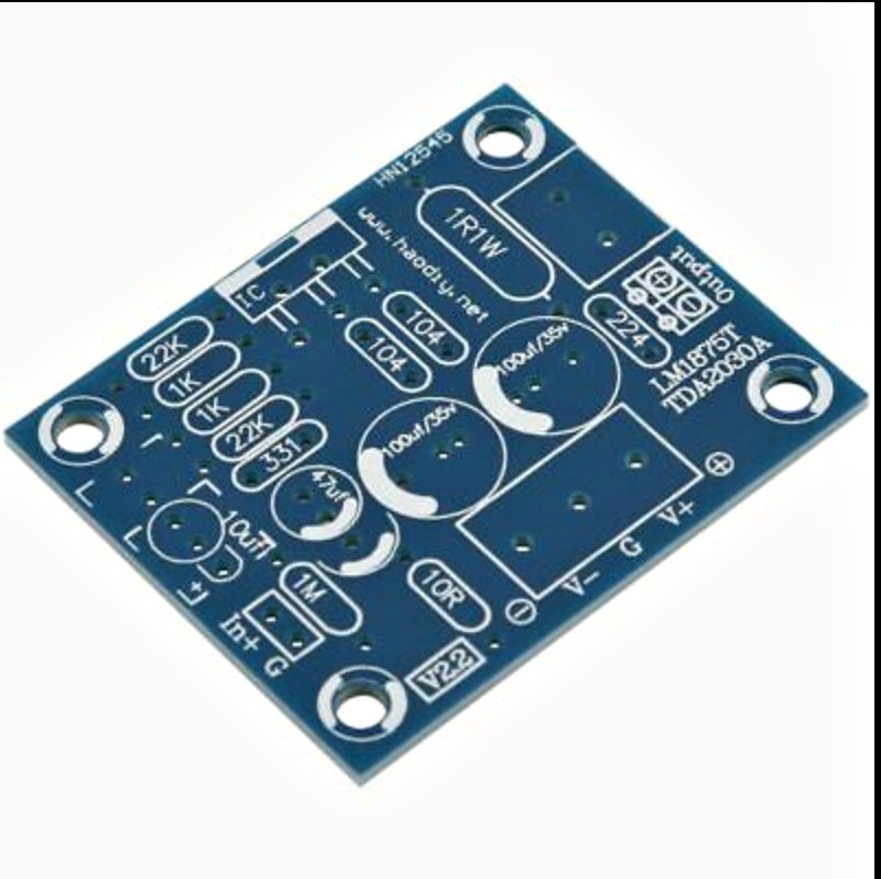

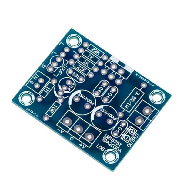

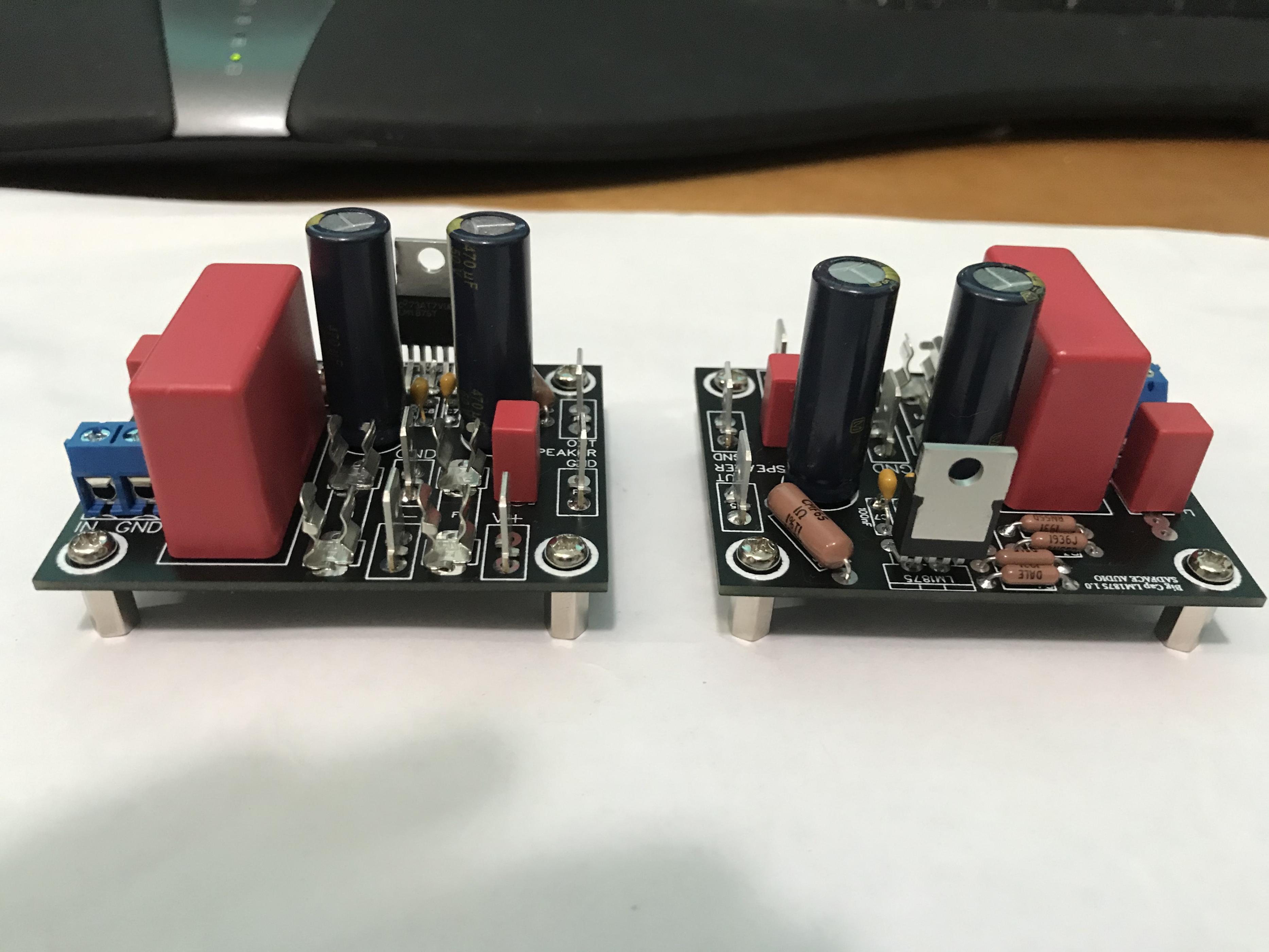

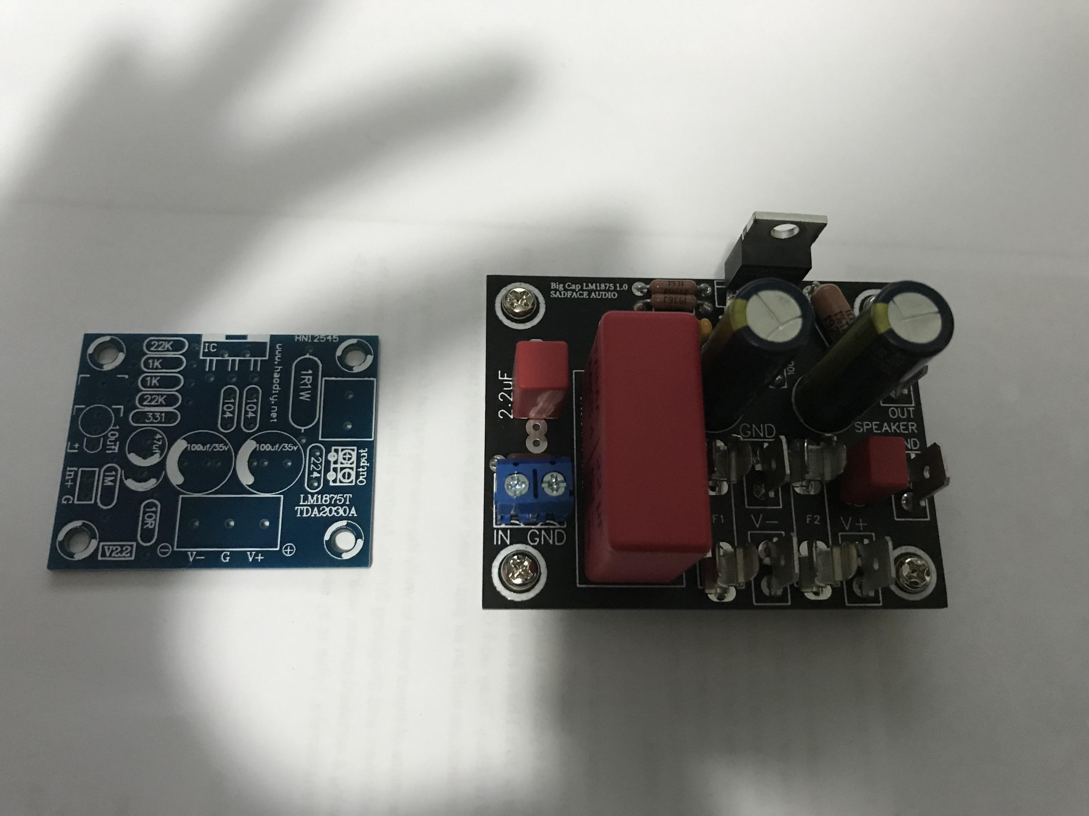

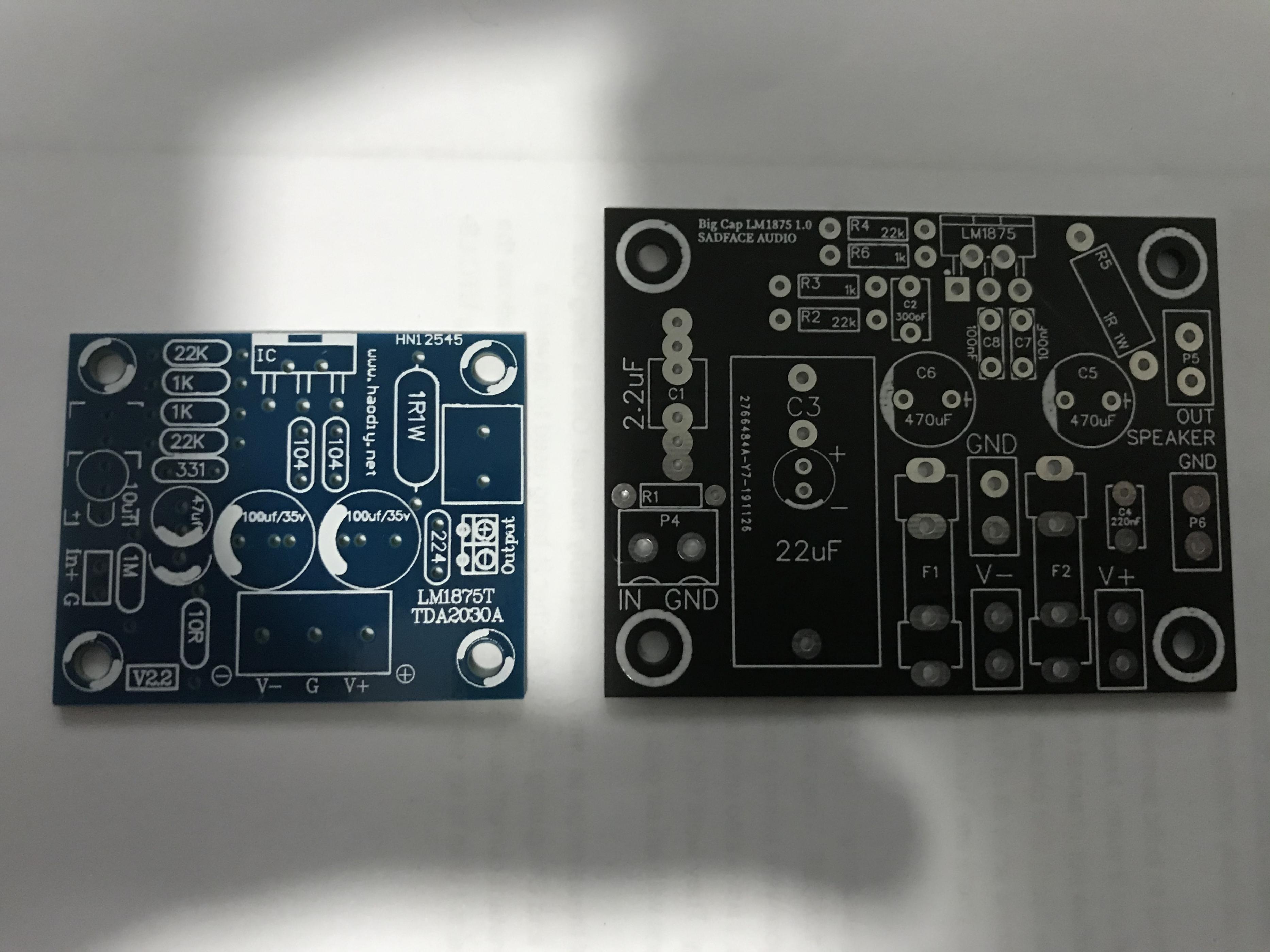

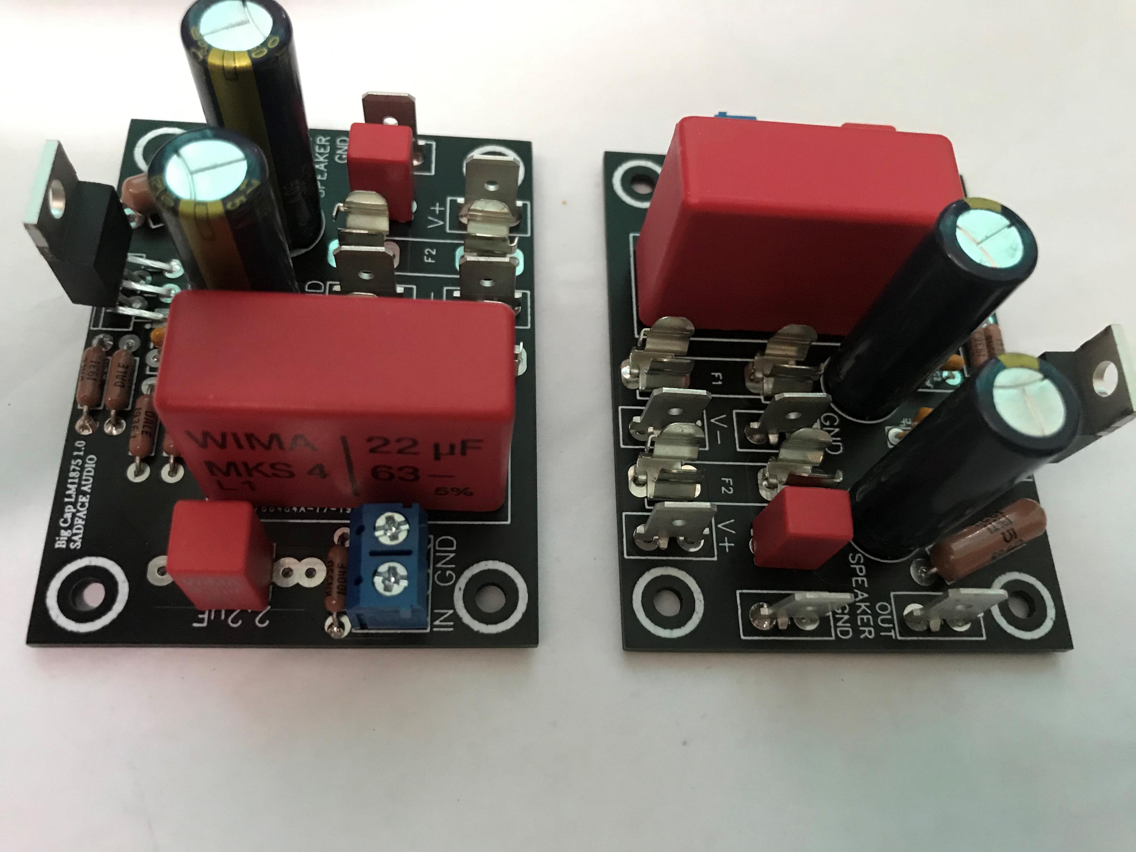

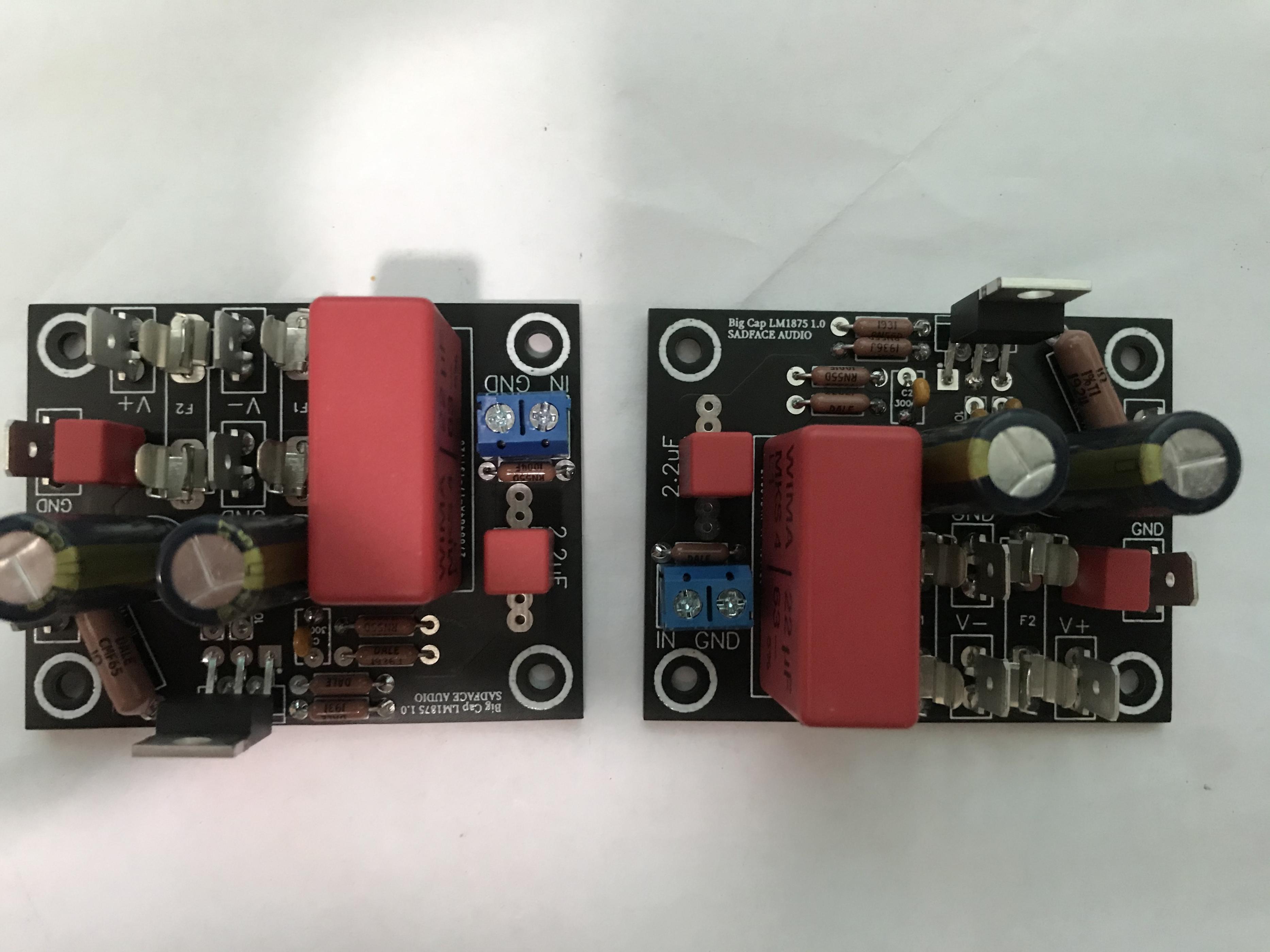

2- Which kit to buy?
In the meantime i ordered several kits from different sources.
It looks like there are two kind of kits, lets call them "Set A" and "Set B"
At first sight they look identical.
But there are important differences!
In general SET "B" is preferred:
The PCB is superior (important!).
The PCB layout is identical, but the soldering "islands" are bigger. Also the board-holes are side-plated and on the top-side of the pcb there is another "soldering island", resulting in easier soldering and better contacts
Look at the annexed pictures comparing the boards.
Set "A" PCB
Set "B" PCB
Next the "LM1875" of set "B" could be a real chip (not tested yet), all my experiments sofar were on set "A".
There are no side notches (typically found for TDA20xx series)
Also characteristic of set "B" is, that a TO-220 silicone insulation set is included/supplied.
My suggestion is to go for set "B", look at Ebay etc and you will easily see the differences: particularly watch for the top layer of the PCB (soldering islands)
and the silicon insulator.

Hi Fred
Very good example of "do it cheap". thanks for that.
about the PCB: yes i can agree the PCB are delivered in SET A and SET B i bought a lot of kits from the same seller but I get different pcb - SET B is with through hole connection and is better for soldering. be arew both pcb are not good for changing components more the 1 time 🙁 - the solder dots getting loose!
finally this kit give everybody new DIY a fine result for Sound and a lot of fun to start and mod it🙂

The LM1875 Bigcap
Hi guys,
I figured I'd leave this here in case anybody is interested.
I've designed an LM1875 PCB. I call it the Bigcap.
It turned out halfway between the old schoolies amp and the datasheet implementation.
-I removed the 10R ground lift resistor. It doesn't feature on the datasheet and my understanding is that this is generally unnecessary.
-I added fuse rails back onto the board that were taken off the Ebay pcb when they ripped off the schoolies PCB design.
-I've changed the screw terminals for power connections and outputs to spade connections.
- Space has been allocated around the 22uF feedback cap to allow large sized film caps (up to 27mm pitch) instead of an electrolytic can.
- Space has been allocated between the power supply decoupling caps to allow a screw driver to access the IC.
My board beside the ebay board
Populated big cap pcb beside the ebay board.
Attached are the gerber files if anybody feels like a JLCpcb order.
Given that the minimum order is 5 and these are typically used in pairs, I do have 1 spare board I could send for testing if somebody with test equipment is interested.
I could also provide something like a mouser BOM as thats where most of my parts have come from.

Turns out a Mouser only BOM won't be possible.
Mouser doesn't stock the 1R resistor in a CMF65 or RN65, I got them from Element 14.
Mouser also doesn't have the best options for spade terminals or fuse rails, I purchased these from Element 14 also.
With name brand/quality parts throughout: total parts bill came to about $25 NZ per board (roughly $15 USD or Euro).
Wima film caps
Panasonic 10000hour electro caps
Vishay Monocap ceramics
Vishay/Dale RN/CMF resistors.
I do find it a bit amusing that the 22uF film cap is more expensive than a genuine LM1875 ($8.19to $4.69)

Thanks for sharing as it's nice to see another build and a different approach. Never seen a film cap for the 22uF bipolar as most of the builds I've seen use a Nichicon ES.
Any reason for using a film cap in this location?
Spades and fuse holders are also found at Altronics.
Thanks for sharing your PCB Sadface!
about the 22µ Feedback cap - wow its huge 😛...i am not really sure what is the different in sound between a 22µF Nichicon ES or your "monster". as you can read some experts wrote about 100µF or more for this cap.
chris
chris
Hi guys.
I read it enough times on these forums that the feedback cap is the most important part in the circuit for sound quality.
My logic is that a film cap is generally better than an electrolytic. So that’s what I did.
I did notice that some recommend up to 100uf however my plan here was to work off the data sheet. It would surely be possible to find a larger value film cap with 27mm lead spacing.
Space was probably the biggest factor. I think my point was proven by the photos a page or 2 back of an eBay board with larger components stuffed into it.
Looks good Sadface! I dont think I ever seen a film capacitor for the feedback capacitor , but good job. I would replace that wima mks2 2.2uf with an panasonic 2.2 uf polypropylene (ECW-FD2W225K4 Panasonic Electronic Components | Capacitors | DigiKey) , it looks like you have a little bit of space there. Have fun!
