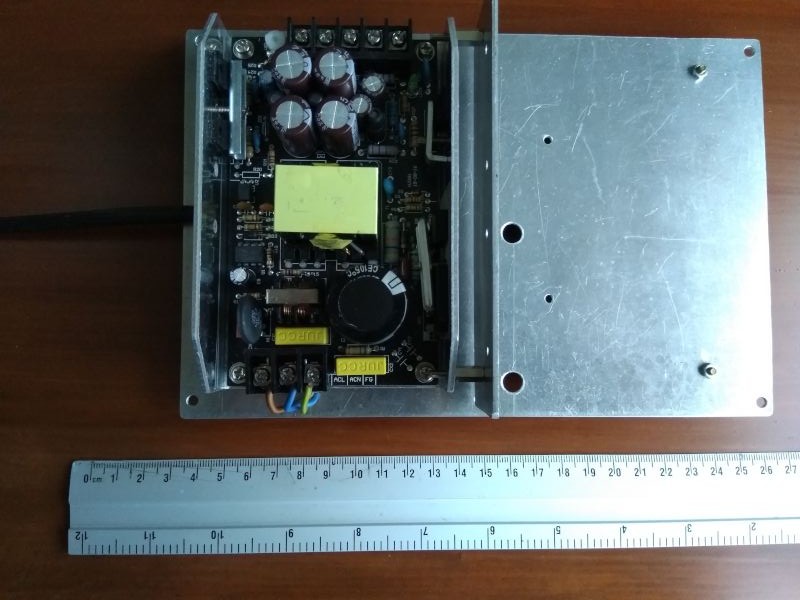

- Further advantages of the Power Supply (300W): its low cost, small size and weight (see attached images)
- The output voltage is stabilised and adjustable between about 21 and 29V. (Badly needed because of the "fake chips" reality)

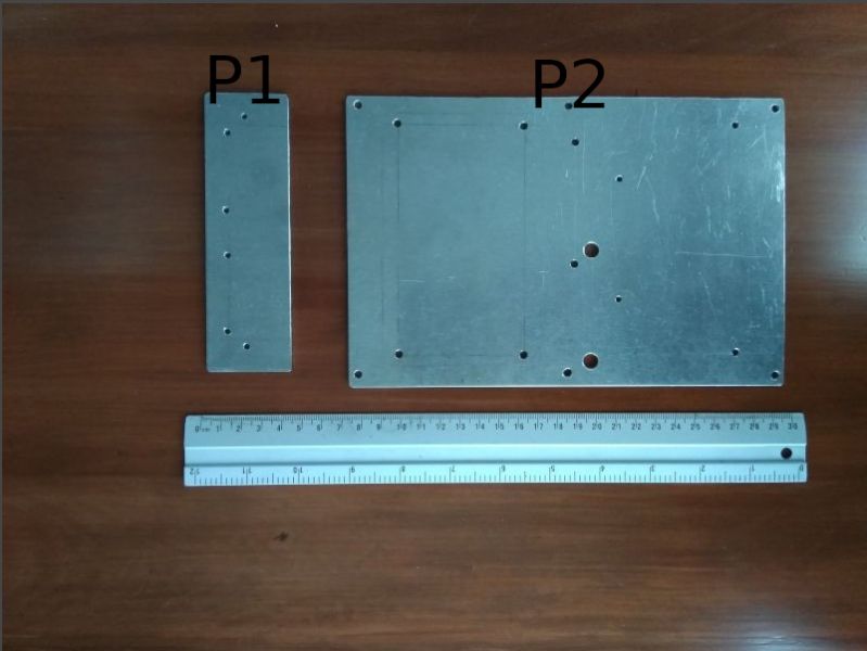

I selected a 15 Eur black alu case (see post 445 for further info). Size approx 22x14.4x5 cm. As you will see later the case could even be much smaller for a standard stereo version.
The original "base plate" of this case was kept unused for the time being. It will be used later in the "final" setup.
Instead i made a temp. 2 mm replacement Alu base plate P2 and a smaller Alu piece P1

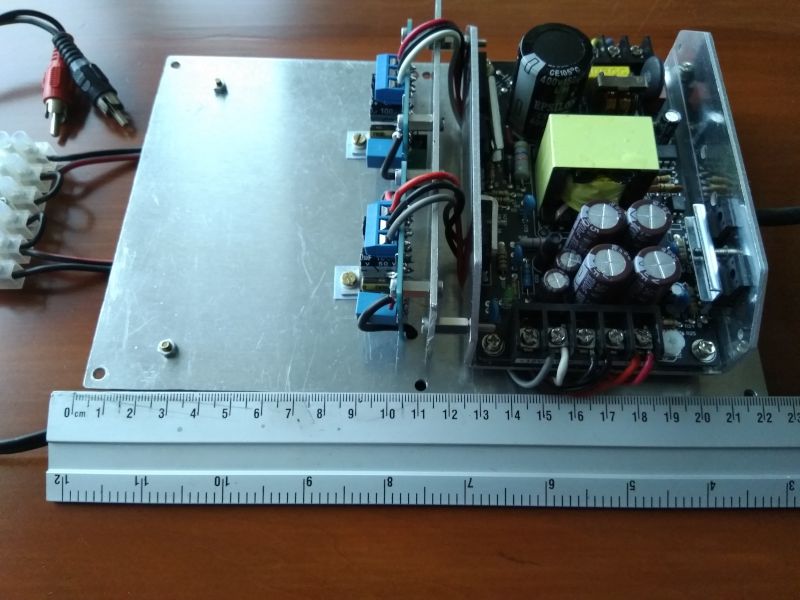

Fig 2
The SMTP was mounted on 6 mm spacers (to enable 220 V and +/- 25 V cabling beneath the SMTP unit. The P1 plate is mounted vertically with 8 mm spacers on the (standard built-in) 3 mm fixing-bolts of the SMTP.

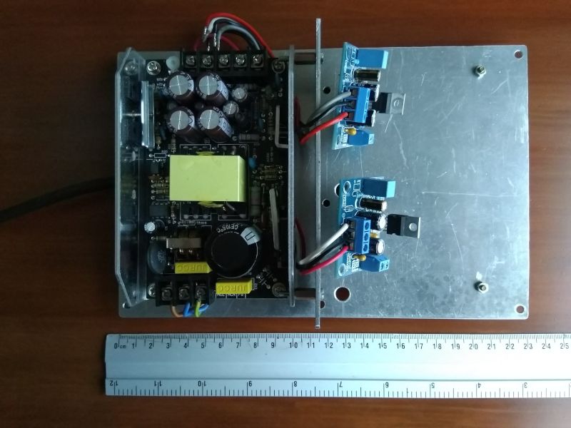

Fig 3
Here you can see the cable routing and pcb preparation (220V to the left)
Please note that the amplifiers boards can be mounted very close to the power supply.
Remember there is no- or very little magnetic interference compared to traditional transformers.

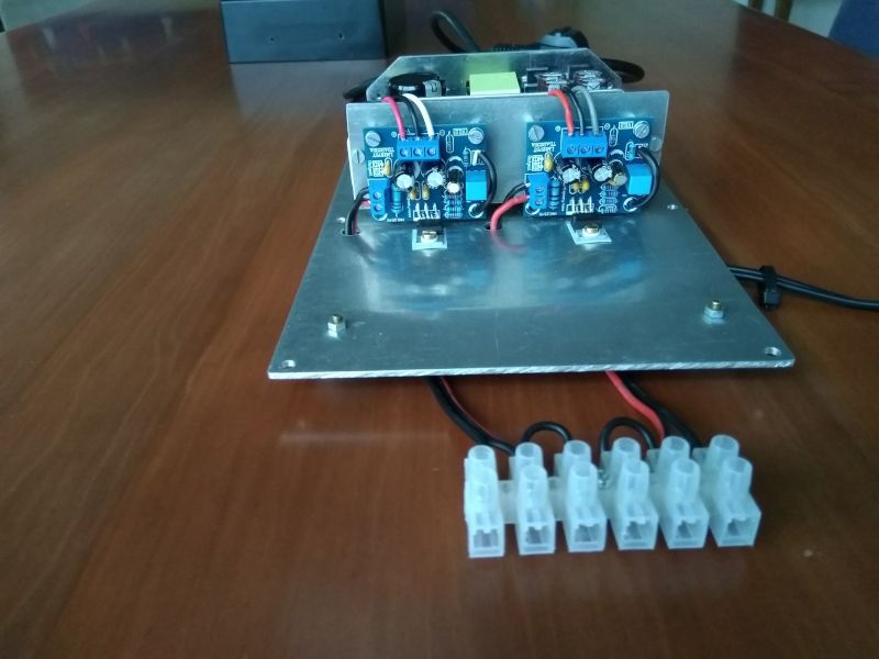

Fig 4
Next image shows the "wired" amplifier
Note its compactness. Wiring is between the Alu plate P1 and Alu SMPS case and beneath the power supply unit.
All wiring is so to say in "screened corridors" of Alu walls.
Also note, that as mentioned above no special - or heavy heat sinks were required.
I tested the present setup thoroughly under normal use (several hours loud to moderate sound levels) and temps are stabilising at under 35 degrees C.
Sine-wave testing the amps during a limited time at full load, just under clipping (about 14.5 V RMS at 8 ohms and 25 W of output) is no problem.
Of course the aluminium base plate is then quickly heating up, so don't do this for extended periods (or use a temp. fan). During such testing preferably use one amplifier at a time at full load.
Don't forget to check the output voltage offset before connecting your speakers.

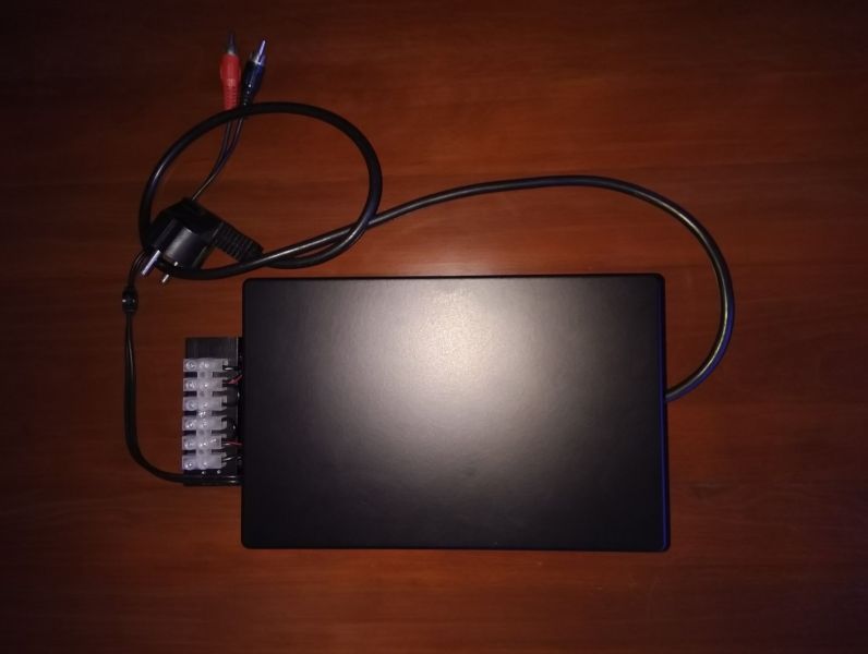

Fig 6
The closed black box.
The box directly connects to my Teufel streaming device (supports FLAC). It is placed somewhere out of sight and music selection - volume etc is remotely controlled by an app on phone or tablet . Music library is on NAS.

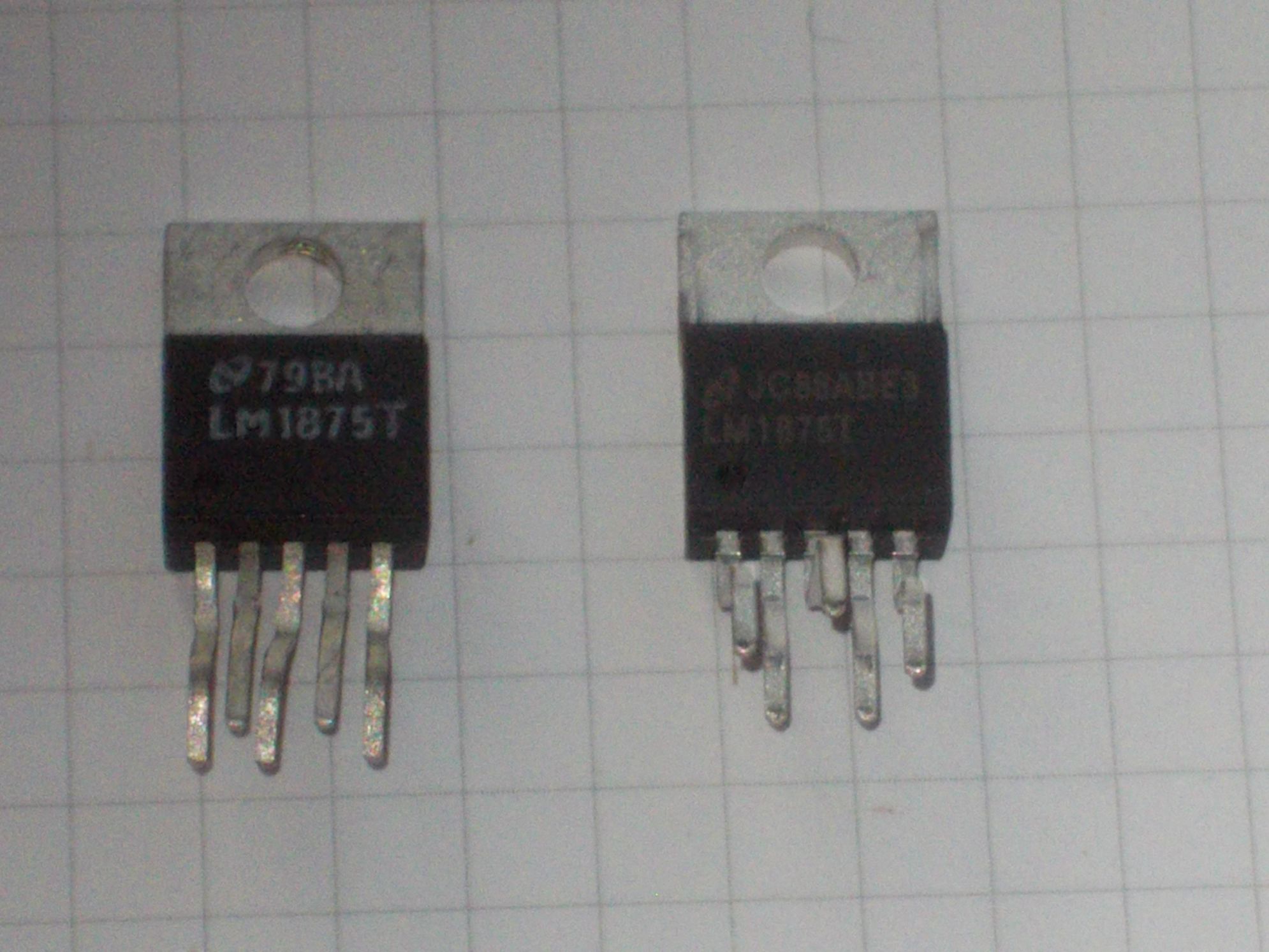

For the future, here's another comparison Ebay vs Digikey picture.
Ebay chip on the left, most likely fake but un-tested.
Digikey chip on the right.
Edit: for some reason the pic got rotated, I'm sorry. Fake chip on the bottom if you're looking at it sideways haha

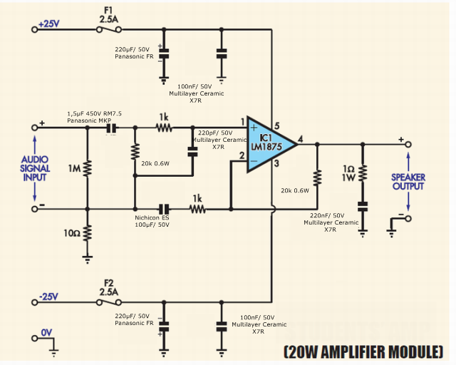

I am looking to build this amp. Is there a concise listing of all the parts needed? I found a detailed list on pot #442 and was wondering if there was more. Specifically I am interested in the maximum voltage for the transformer. I see 18V often but was wondering if it was acceptable to go higher. TIA.
Hi theaddies
the maximum Voltage +/- of this chip amp is according to the datasheet +/-30V.
A transformer with 18 -0- 18VAC give you after rectifier and cap bank about 26,8V DC at each rail in idle mode and thats the maximum voltage that most people use for 8 ohm loads(speakers impedance). if you need more power you can look at the Lm1875 parallel composite amp thread or you choose another chip - more current/power with lm1875 is not so easy...
Please look again the complete thread to choose your components by rabbitz or other builder. rabbitz is an experianced amp builder and he stated that if you need more power its better to choose a stronger chip. but believe me the lm1875/and TDA2050 are really powerful for home use about 20W - 30W at 8ohms speaker.😉
the board what you get by ebay/aliexpress/amazon are not bad in general.

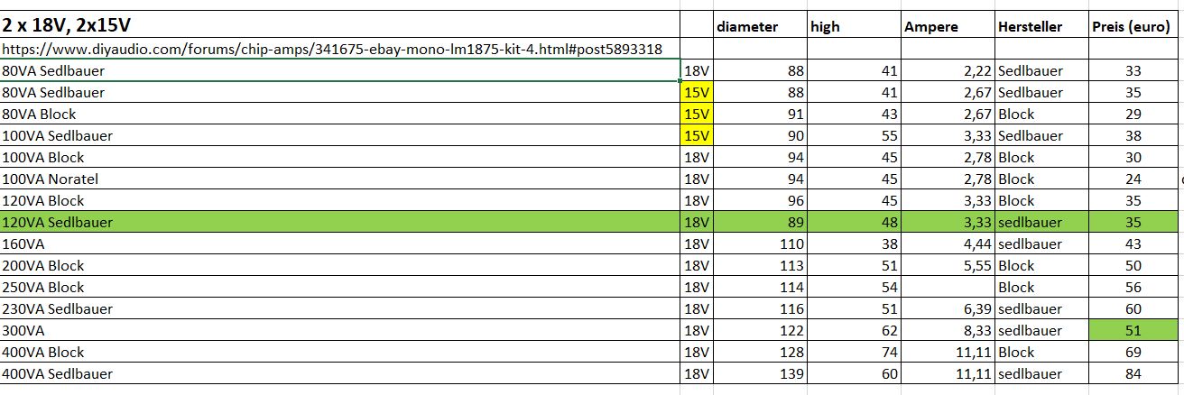

Hi
50VA each channel should be ok. i planned a power supply for my mock up and future amps with a 120VA/18VAC for both channels and its really enough and it was cheap...about 35euro new. if you want to build an amp think about your enclosure and therefore about the components inside.😉here is an idea about some dimensions of some transformers...i looked at conrad and other shops in my countryonce again...take your time and read and note some points for your ideas....the complete thread...
chris
