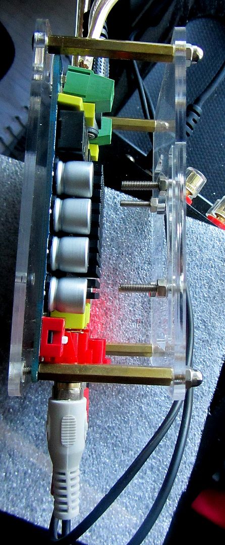

My basic Sanwu board came a couple of days ago in record time (~7 days). I spent an excessive amount of time making up a test harness. It would have been faster putting it in a case, but I can reuse the hookups with other boards.
I'll need to do some side-by side testing with other amps. It sounds good, maybe a little brighter than I'm used to, and the bass seems to have more kick, but both impressions may just be the result of listening at louder-than usual levels.
The old $5, 32v 2.5A HP printer power brick I picked up has been great. It may not be able to deliver enough power to use all of the amp's clean-power range, but it's got enough to be too-loud for my desktop setup.
Yep gonna try it without the fan. I just need a small drill bit. Which I think I have. Man that was fast mine took 2 weeks! Glad the 2.5 amp worked out. You gonna build a box?

I don't know what I'm going to do with the board yet. I kind of like the aesthetics of these Sanwu boards. I have two of the orange TPA3116 modules that I'm experimenting with for a 2.1 setup and I plan to have them both exposed somehow.
I forgot to mention a few things about the Sanwu TDA7498 board.
It is quite small, roughly, if not exactly, the size of the red/orange Sanwu TPA3116 boards -- the size of a playing card.
Powered with 32v using the default gain setting, the inductors are about 64c, and the heatsink is about 55c, with or without an input signal. With 24v, those numbers drop to 46c and 41c.
With no signal and the input connected through a 20k linear pot with a 2.5k resistor on the wiper (a-la ESP "better volume control" it's hard to detect if its powered on or off. Noise is very low with power applied. When switching the power on there is only a very faint click through the speakers.

I stuck some heatsinks on the inductors of my Sanwu TDA7498, apparently I need bigger ones. The inductors are still ~62C and are definitely warming up the electrolytic caps to 50C -- they are 105C-rated caps, but I'd rather have more headroom.

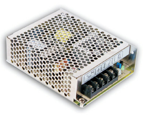

Switching DC is a detrimental approach as switches will burn in. This is a known fact (common knowledge even), it is just that this news from some decades ago has not arrived yet in china. It possibly has something to do with the fact that many devices are intended to be used with a leftover separate power brick that lacks a switch as 230V 10 A rated switches are simply too expensive on cheap gear. Same counts for those imbecile round 5.5 mm DC connectors with various pin sizes that spark when connected. This while screw connectors are way more safe and durable and they avoid sparks and plugging in devices when powered on. One should switch AC no matter how many devices in this world are configured with errors. In the "world of cheap" this power brick/round DC connector combo has become some kind of a standard that works for a while and boards are thus somewhat interchangeable as the intention is that we buy at least 100 boards in our lifetime User (un?)friendliness, just give it a name. It is not the approach people who go by solid engineering would choose.
Yes, switching DC works, why wouldn't it ? Yes it works for some time too. Nevertheless the switch will burn in and will be higher in resistance than it should be after switching many cycles (or not so many depending on the situation).
Best would be to encase cheap boards on a aluminium sheet, or subchassis, mounted with isolated standoffs on the metal chassis and to use an "open" PSU (connected to PE just like the case) with a 230V 10A rated switch at the primary side (mains) really switching a device off when you want it to be switched off. When new boards arrive one only needs to cut a new aluminium sheet and drill the appropriate mounting holes for the new boards... This works perfectly. Many boards offer a muting feature only putting the device in standby just to avoid costs of a good real mechanical 230V 10A rated switch... You know, that part that will not be available anymore within a few years.
Or you drill the appropriate mounting holes for the new boards in the existing subchassis/aluminium sheet ... and be done with it. Working this way will ensure your case will be without too much unnecessary marks, dents, scratches and excess holes.
Excuse me for the slightly cynical tone. I attached a picture what I mean with "open" PSU. Please note that the case and the PSU should be connected to PE but the subchassis and all connectors (except for the PE connection of the mains connector !!) should be floating. No ground loops this way and your device will be safe of everyone that uses it. As usual I mention that UK electro fundamentalists also want to connect any metal part to PE but I don't do that as I don't like ground loops and hum. In general I keep audio GND and PE separated but with the power amp I "lift" the audio GND to PE (all other devices will be connected to audio GND by their RCA plugs GND).
I also attached a picture of a certain 230V 10A switch. My experience is that I build devices and after some time I can not obtain the type of switch that I used last time anymore. Now I stick with one reliable type and buy a few of them while they are still available. This way a new DAC or any other device will have the same look and feel as for instance the preamp.

Yes!
Hi Jean-Paul,
Yes, I use those same type of power supplies. In fact, the 24vdc one I'm using now is an open cage, Meanwell type clone.
And, I just got some round switches like the one you show. I used those in the past, but got mildly frustrated that none of my Forstner drill bits quite worked and I had to sand or rasp the nearest sized hole to make the switch fit. (I work exclusively with wooden enclosures I build myself; not metal ones.) So, I haven't been using the round ones the past several years.
But recently, I bought a 20mm Forster from China on eBay which is surprisingly good. It cuts very cleanly. The fit is perfect. And it was ridiculously inexpensive as well. So, I can now get back to those round switches and eschew the mini toggle types that seem a lot more fussy and prone to failure.
Thanks for the guidance. Appreciated greatly!
