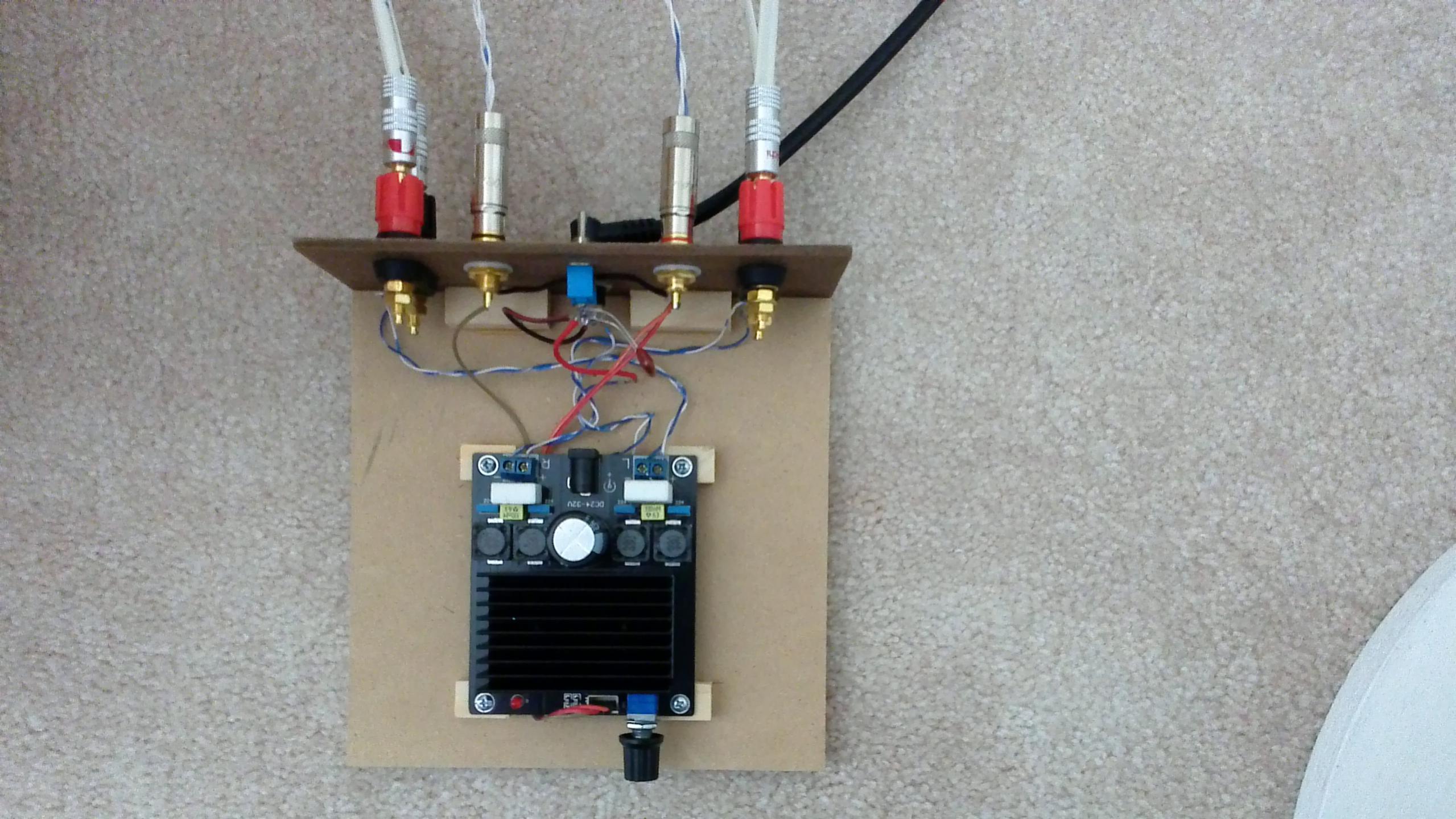

I decided to order one of the basic, blue Sanwu TDA7498 boards after finding a used 32v power brick used for $5.
Unfortunately the brick is only 80W, so I won't be able to use the boards full power, or even the full <1%THD power, but then I'm not sure my ears or speakers could take even that.
While used 32v supplies seem quite scarce, I noticed a number 36v 110W supplies made by Delta Electronics for use with a Kodak printer.
The Sanwu board I bought exposes the chips gain control via some jumper pins. Does anyone know if there would be issues extending these with some dupont jumpers so I could change settings using a panel-mounted switch, or are those inputs on the chip sensitive?

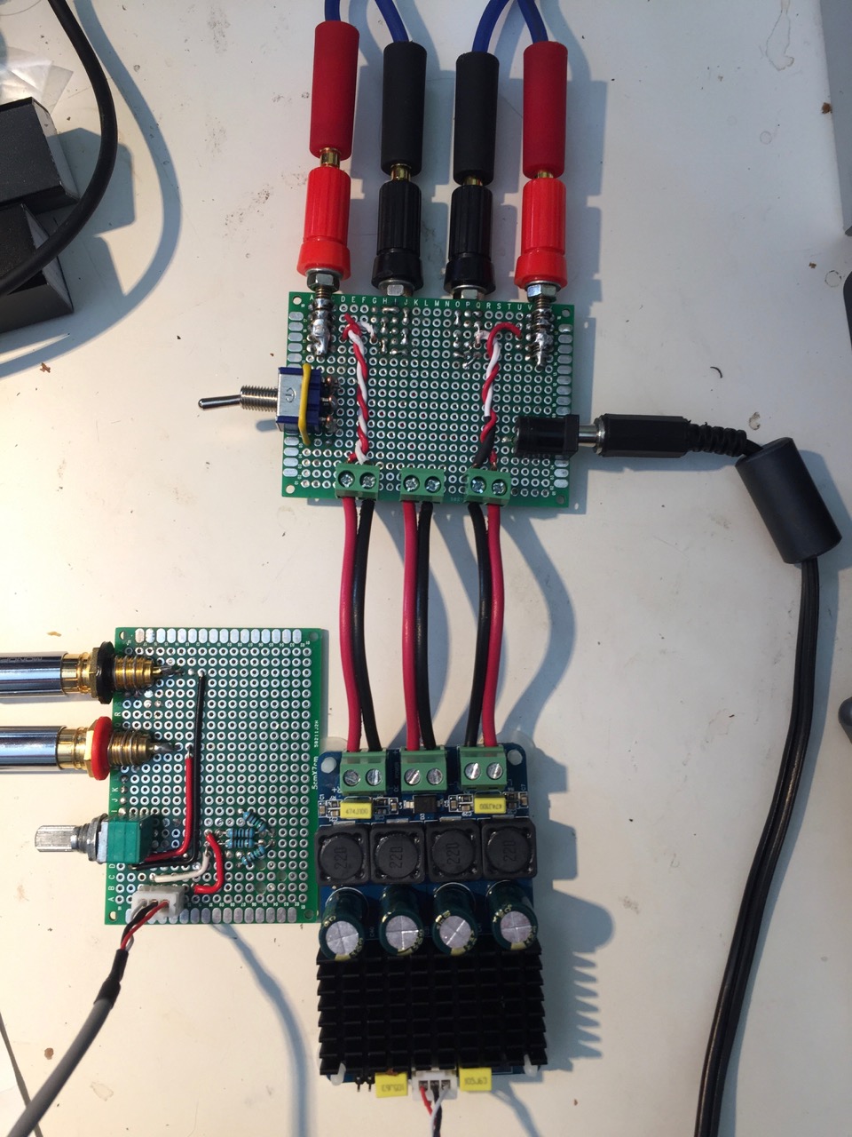

Still having trouble with switch, page 10, post #100
Strange!
Refer to my problem with switches not turning "off" on page 10 at post #100. Not only will the switch not turn the amp off, but the strange thing about it is the switch will not "click" at all when this occurs.
The problem is intermittent.
I have used/installed 3 different brands of switches.
I even tried another tda7498 board. Same brand of board however.
The switch will function fine for maybe several weeks, then will not click "off". Then, if I physically take apart the switch, then put it back together will be fine again.
The only thing I can link this strange problem to is the brick type power supply I've been using. It is a 32vdc, 3.3 amp supply I got with my Winsome Mouse amp. The brand is Cincon Electronics, model no. TR100A300 21E12.
It has one of those little blobs or what I think is a coil on the output side of the supply (heading towards the DC jack of the amp).
So, I'm currently trying another supply. One of my Meanwell clone type 24vdc cage type power supplies.
Who knows if that supply will eliminate this problem? I could go two or three weeks then this won't turn off thing could happen again.
I'm really puzzled on this.
Anyone have any thoughts?

Maybe the switch is not appropriate. What is the amperage of that switch?
You need a switch of at least 6 amps.
As I mentioned, I've tried several different brands of mini toggle switches. To elaborate, maybe five different switches have done this altogether. The first one I tossed, the second I took apart, and then it measured fine for continuity/non-continuity as it should so I put it back into the amp. After awhile, it failed to click off. I tried two other brands after that. Same results. Every one I take apart, then put back together seems fine. No signs of burning, etc.
I forgot to mention all switches used are rated at 6 amps.
Weird that this has never happened with anything else but these 7498's. I somehow today doubted that it's the board(s) so I thought I'd try another power supply for awhile and see what happens.

Switch is melting down due to turn on sparks, effectively soldering it. It latches in ON state. Taking it apart will break the soldered area hence making it work again.

My basic Sanwu board came a couple of days ago in record time (~7 days). I spent an excessive amount of time making up a test harness. It would have been faster putting it in a case, but I can reuse the hookups with other boards.
I'll need to do some side-by side testing with other amps. It sounds good, maybe a little brighter than I'm used to, and the bass seems to have more kick, but both impressions may just be the result of listening at louder-than usual levels.
The old $5, 32v 2.5A HP printer power brick I picked up has been great. It may not be able to deliver enough power to use all of the amp's clean-power range, but it's got enough to be too-loud for my desktop setup.
Fan probably isn't necessary, which is good, because it wouldn't do to well with the amp's supply voltage.

I see. A temporary solder almost. Interesting. But, what should I do about this? Does anyone have a solution? Or just opinions on what is happening?
Incidentally, it was suggested to me to wire the switch through the positive rather than the negative line. I tried this. Same result - with that 30VDC power supply I previously mentioned with the "blob" on the line.
What are those things on the power lines of these types of supplies anyway? Coils? Capacitors? Ferrite rings?
I have since reverted to the 24VDC Meanwell clone cage type power supply. I've not experienced a problem with switches when using that supply.

This have to do with two things (I guess): good capacitors (can take and deliver huge bursts of current) and bad quality switch (the metal they are made of).
These arcs, inside the switch, have very high temperatures...
Well, it seems odd that three different brands of switches have done this. And those ones have never failed on any of my other amps.
The only one thing I can observe that is a common thing is that 30vdc power supply.
