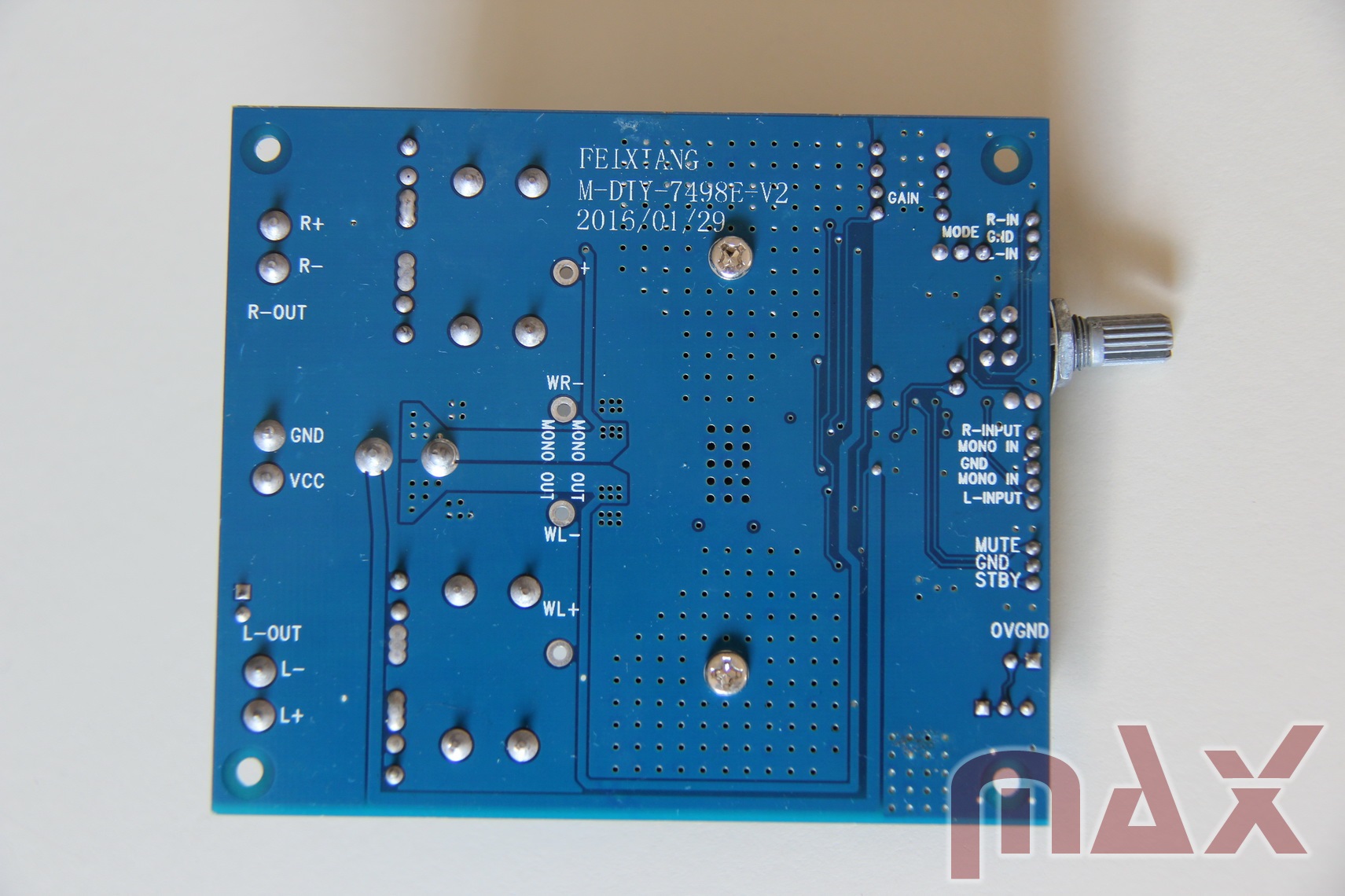

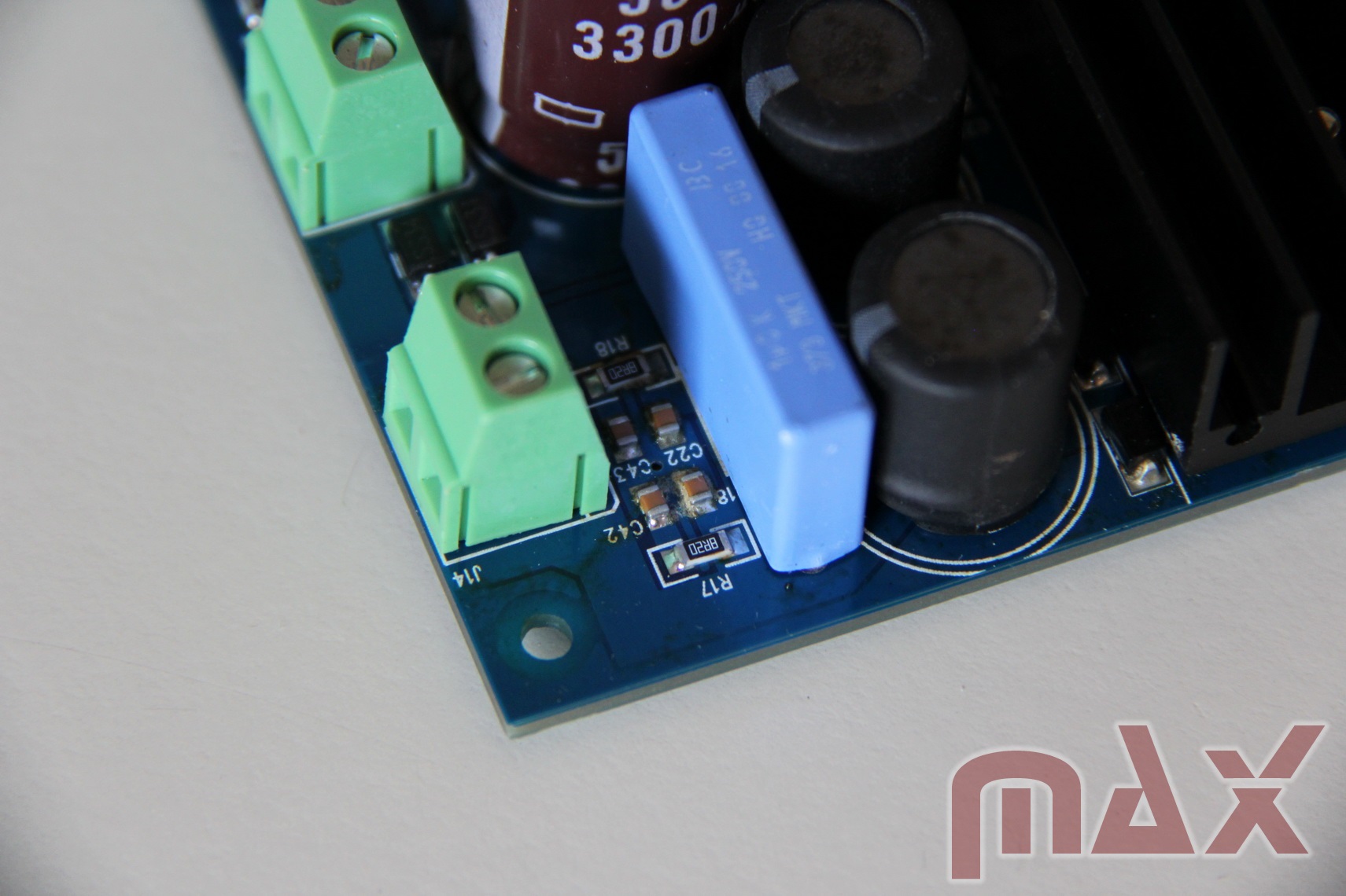

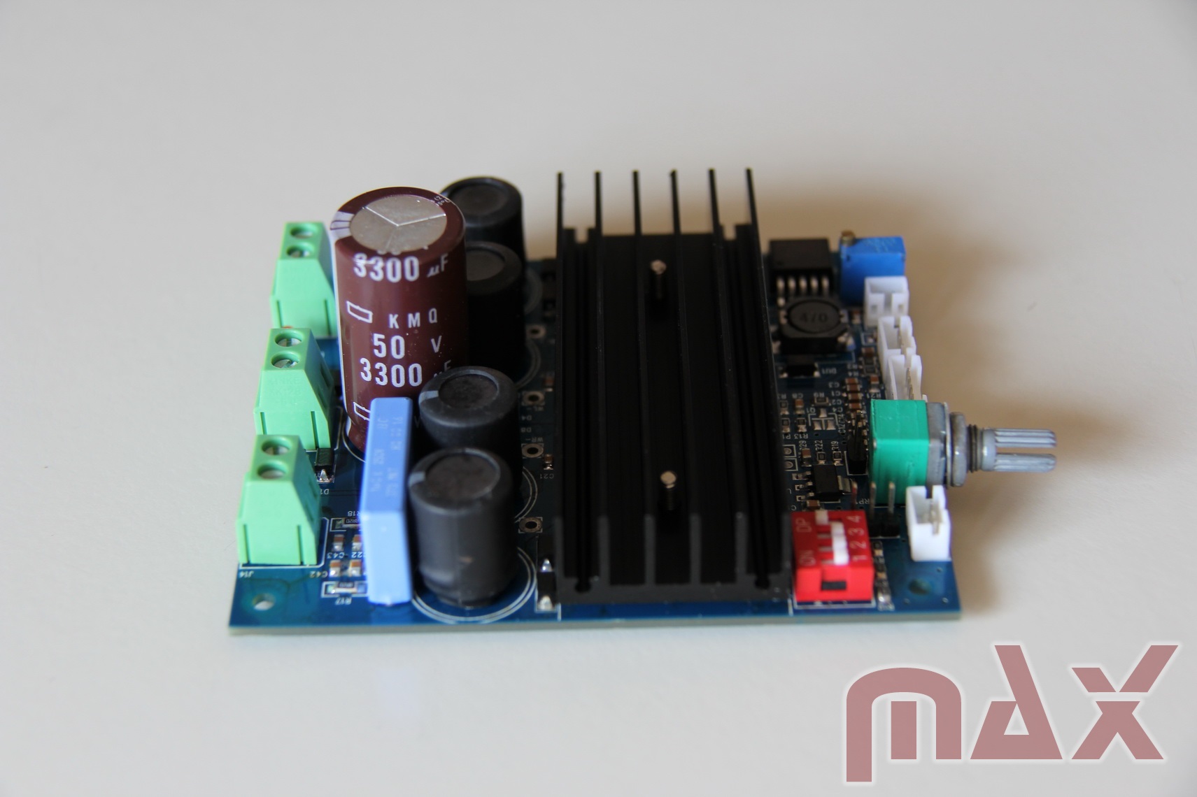

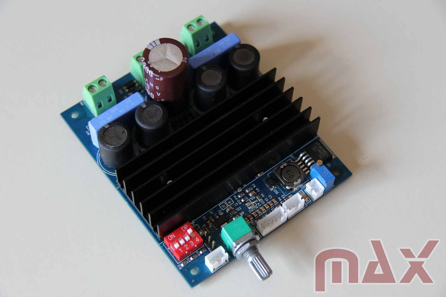

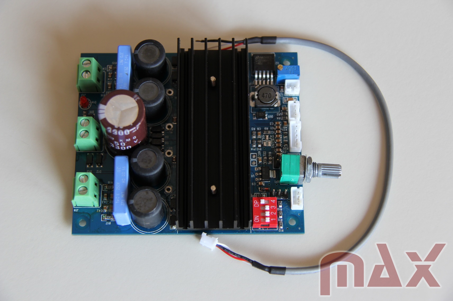

I'm attaching a few pictures of the Feixiang TDA7498E board that can be found on eBay and AliExpress.
Output section of the board follows manufacturer recommendations. All the necessary components are present, output RC snubber, catch diodes, hybrid LC filter and second EMI snubber. Only thing that they skimped on is the main bulk capacitor and used a single capacitor for both channels, instead of two like on manufacturer's evaluation module. However, the quality and genuineness of certain components is questionable. Output inductors are not precisely wound: one of the inductors on each channel measure 22uH, while the other one on each channel measure 26uH (manufacturer's evaluation module uses 15uH inductors). With the values of used components, output filter is tuned for 4 ohm load. Alignment of through-hole components is surprisingly good, the volume pot is the only major component that has been soldered crookedly. In a few places the soldering flux has not been cleaned completely from the board. Main AC coupling capacitors are ceramic. There's also an auxiliary buck regulator that can be used to power up an external fan or something similar.
I have been testing the board using a laboratory power supply and 6 ohm test speakers. There is no power up or power down thump. The heatsink does get warm, but not too much and you can safely touch it with fingers. As far as sound quality is concerned, when compared to a class AB amplifier that has been hooked to the same speakers previously, upper end of the audio spectrum sounds a little bit harsh to my ears, which may be related to the fact that output filter is not tuned to the impedance of the test speakers.
All in all, if someone is looking for more power, this TDA7498E board is among the cheapest offerings that are currently available.
