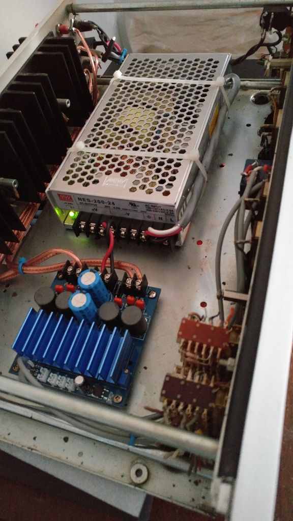

The voltage of SMPS are 28vdc.
The case is an old Radford amp. I have not finished listening to this amp. But the sound is pretty good, no noise, no ploc to on / off. I will return with a review of the sound compare to the Gremlin ( Sure AA-AB32313 2x400 -STA516BE).
Nice built. That board has really good sound for the money. I m running it at 31V.
It might need a small fan if you you are going to run it full volume for alot of time.
