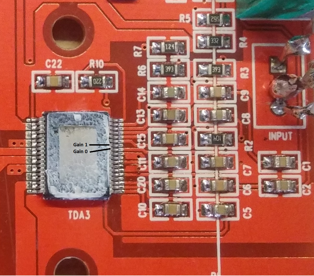

I want to reduce the gain to the lowest setting. How do I do this?
Pin Gain0 seems to be connected to 1,5V, Gain1 seems to be unconnected. (see attachment).
Do both need to be unconnected? Or do I need to short Gain1 with Gain0?

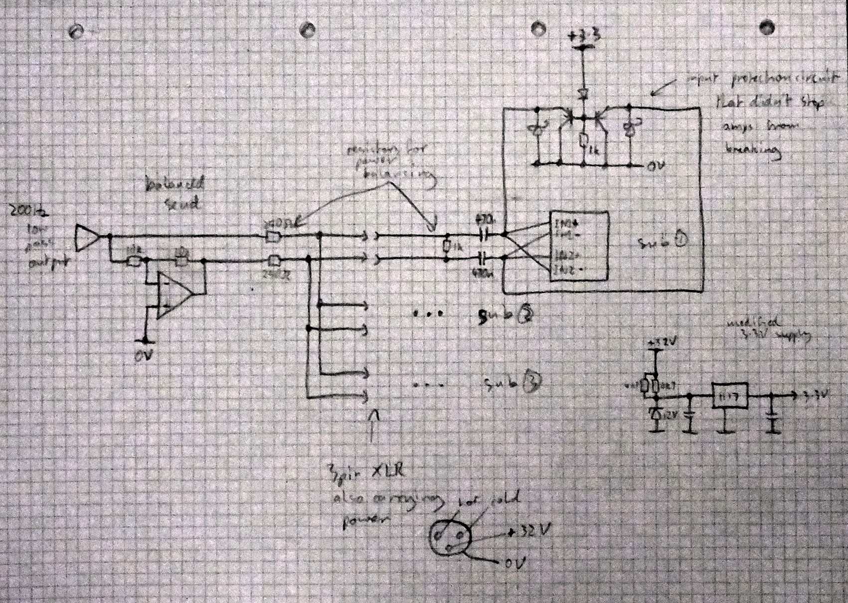

I am hoping there may be some experience among the forum members relating to a problem I'm experiencing with some TDA7498 amps I acquired for a small party-system project. They sound great and work well. The problem is that when I turn the system off and back on, frequently one of the amps no longer works. The amps that are failing are always the attached subs. The system has a 3-way active x-over in the top unit which has the tweeter and mid driver in it along with the amp for them, and puts out a balanced signal to the subs. There is 250Ω on each output line and a 1k resistor between hot and cold at each amp - this means that whether 1, 2 or 3 subs are attached the balance of the 3-way system stays pretty much the same.
Each sub amp has 2 8Ω drivers attached to it's 2 outputs. There is an XLR connector from the top unit carrying both balanced signal and power to each sub amp, 3 subs per side. After the first 3 amps died I put measures to keep the input pins of the chip between -0.3V and +3.3V, but this has not stopped amps from dying. Amps die whether I'm switching the entire system or plugging individual subs into already powered top units.
I'm wondering, can anyone think of anything else that can kill these chips during power ramp-up/down other than wild input signals?
The boards are the basic cheap black one with the 5W resistor on the output with a few mods:
The PSU is a 1500W DC-DC boost set at 32V, running from the 24V solar batteries that run my house. I'm considering putting an additional 22000uF cap in each top unit to carry the beat, and I intend to push the voltage up to 39V once the amps stop dying.

a rough connection diagram is attached, to try to make things clear.
since asking my original question I looked again at my XLR's and decided that the shield connection was not good enough - just a side pressure contact made with a bendy metal fiinger - so I've added a small screw to ensure the 0V connection isn't the highest resistance of the 4.
I'm also now (working on the inrush assumption) making a dv/dt controlled power-up with a p-channel MOSFET (IRF4905) on the +ve rail. The one remaining sub amp has survived 20 power-ups now with this attached, though now it mysteriously goes quiet after about 10 minutes - a condition which resets only if the power is cycled again. Any thoughts on this one? I think it needs to latch on when it reaches the +ve rail so the main capacitor can recharge at full speed while in use. I'll add power-ramp muting to it too, since there is sometimes noise which sounds like oscillation in the amp while the FET is controlling the power-up.

Is this drawing suggesting the use of the same XLR for power and signal? That would need more than just the clamps: series resistors for limiting current through the clamps.
series resistors where? before or after the DC blocking capacitors? why? surely the current into the clamps is limited by the relative dv/dt of the signal wires to 0V and the capacitance of the blocking capacitors... oh wait, now that I calculate it the 100mA hold-down from the BC556's is maxed out by just 0.2V/µs... so to limit a 39V instantaneous jump to 100mA needs just 390Ω, I guess I can fit that in there without loosing signal 🙂
I put the power and signal on the same connector because I've had problems with noise from running separate 0V connections for power and signal in the past, and it seemed like a neat solution to use the shield of the signal cable for the 0V power as well. +V is then a separate wire bound to the outside of the signal cable.
the dv/dt limited power-up has stopped the massive voltage step issue, and makes pluging in quiet and spark-free but now I have another problem, that this amp cuts out after a few minutes (not volume related). it might be thermal since it takes less time to cut out if it's already done it once and I'm starting to suspect the LM1117-3.3 regulator ... perhaps I should start again with a new amp board and see if the problem is still there...
Since input impedance of this IC is about 60kohm, a higher value of protection resistor will not degrade audio and will result in less current across clamping elements, like 1k for ~40mA peak.

Thankyou, Eva, you've given me exactly the nudge I needed! 😉
My brain was stuck because I couldn't understand why the clamps hadn't worked and so thought that some other fail point must be responsible.
Actually the inputs are 30kΩ because they're paralleled. I've used 510Ω inline with each capacitor and everything seems to be fine now, though now that I think about it, as long as I do the same to every amp I can put whatever resistance I like in there and just boost it at the x-over input (which has variable gain already) if needed (which probably not, since the level will go up by 30% already when I remove the 2.2Ω resistors).
I've been repeatedly cycling the power both hot-plugging and whole system and it all still works. Now I just need to wait for the IRF4905's I ordered to arrive - even if they aren't needed any more for the amps safety I like that the dv/dt controlled startup means no clicks/pops/sparks or oxidised contacts in the system.
If I'd known 4-pin XLR's existed when I ordered the parts I would have probably ordered them 🙂 (although the supplier I ordered most things from doesn't have them, so maybe not)

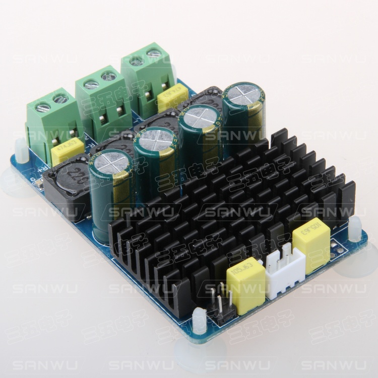

I see on post #256 that a raspberry pi acrylic case can be made to hold the Sanwu TDA7498. But there is a case that is being made for the Nobsound TDA7498, which I have attached a pic for, but I cannot find this case as a separate purchase. Anyone have luck finding it?
Also, if you are up for getting a genuine Sanwu board, they are available very competitively directly from them at www.sanwulasers.org. The basic TDA7498 with no volume knob is $11 shipped at the moment with the RCA and volume knob version coming in at $12.

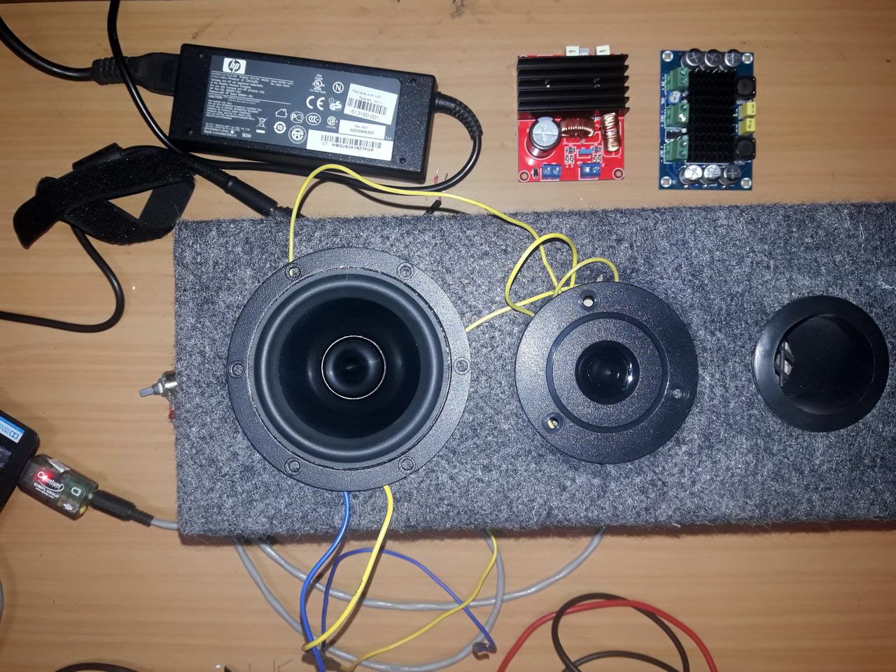

I compared Mono TDA7498MV to TPA3116D2 & I found the former (TDA7498MV) to be better in clarity albeit slightly higher noise.
Tested with 19v HP laptop adapter & Dayton RS100 with bullet tweeters.
Left red board TDA7498MV - Right blue board mono TPA3116D2

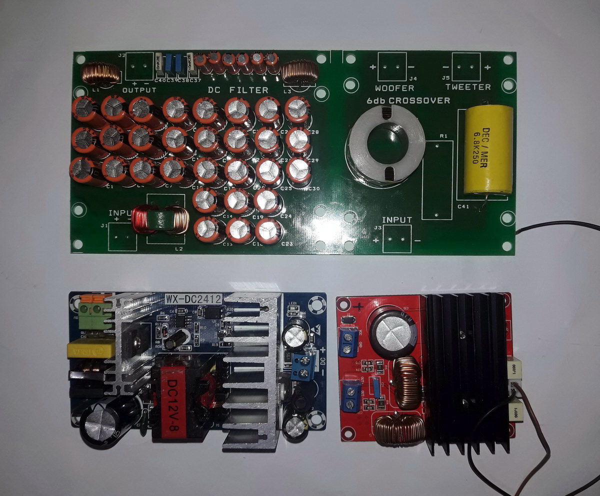

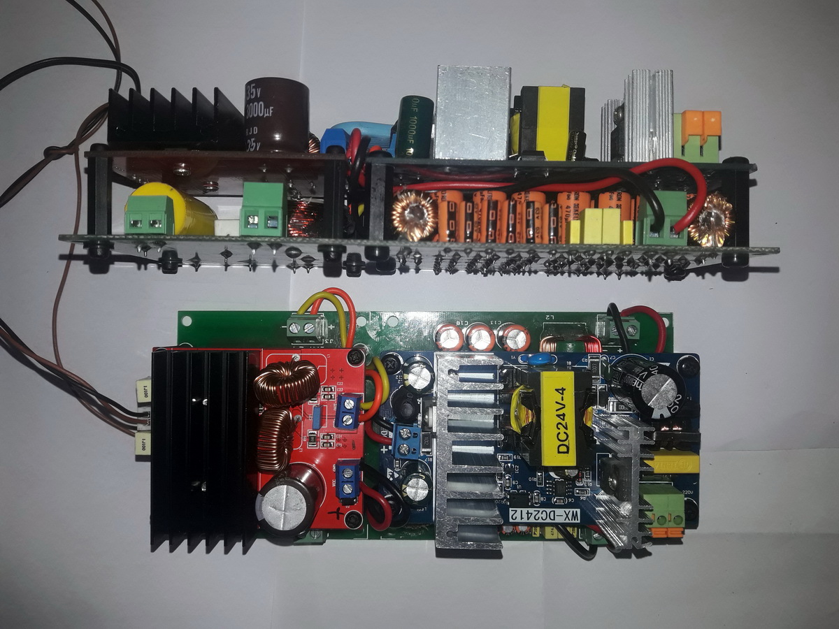

Hence decided to make a monoblock with TDA7498MV with SMPS, DC Filter circuit & 6db crossover.
First picture is the motherboard to which the TDA7298MV & SMPS pre-made boards are mounted. Second is the finished monoblock with plastic spacers (to prevent any shorts).
Tried with both 12v & 24v SMPS. Found 24v to be better in vocal \ treble clarity.
Also better at high volumes at reducing speaker 'pop' \ distortion sound. Speakers used were Dayton ND91-4 & ND20FB-4
