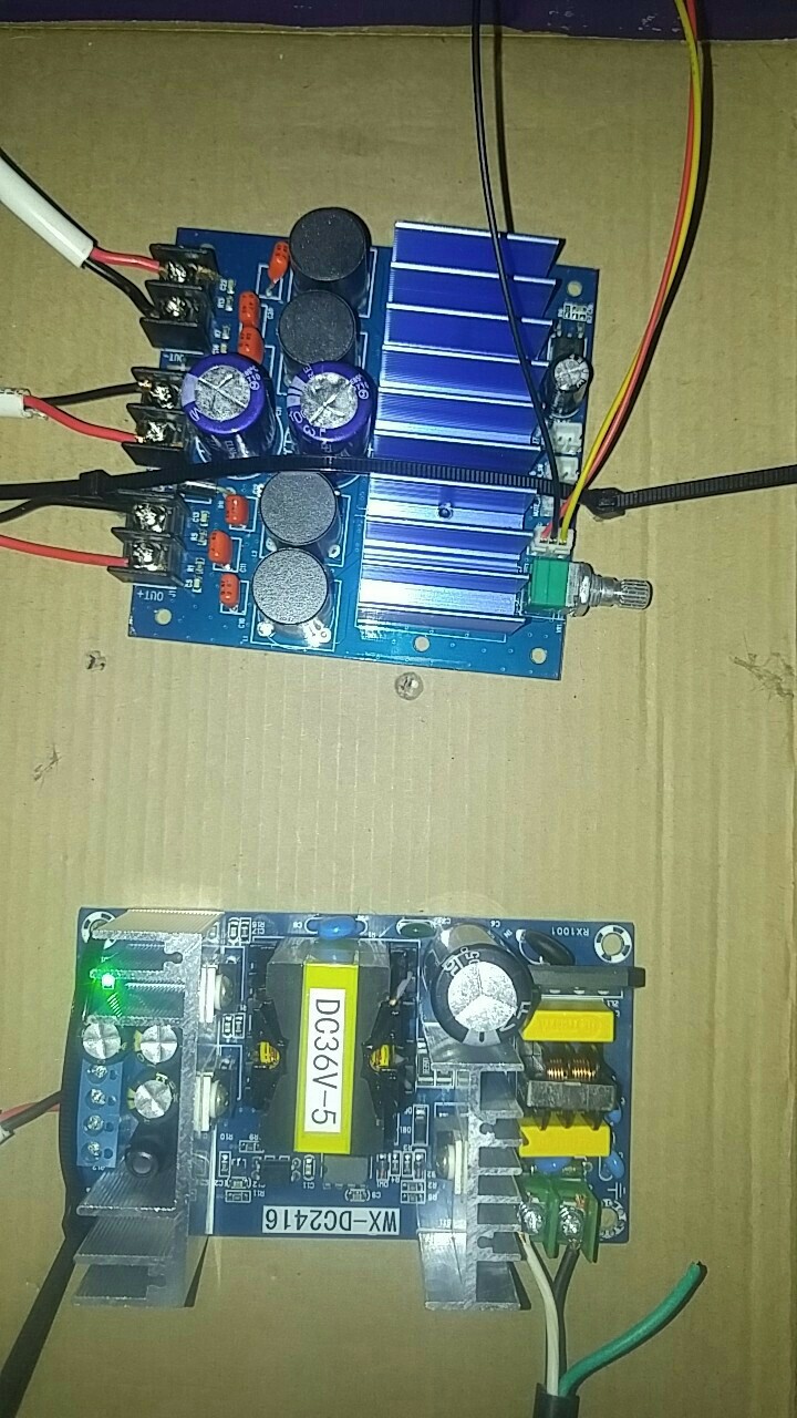

hey guys, i just ordered this board:

Any reason these will not work together? anything I should consider when connecting the 2? dont want to fry either board 😉 I figured the power supply i bought was very similar to what you would see inside one of the big brick adapters so it should work just fine.

Well, why didn't you ask before buying it? It's fine as long as your load stays above 6 Ohm. You can't use the full power of the amp because the power supply is on the limit before the amp is at the max.
A 30 or 24V power supply would have been the better choice but it's fine with 8 Ohm speakers.
I will be using 8 Ohm speakers, and it was an impulse buy in the moment hahaha
What would have been the best option for voltage an amperage then with 8 ohm speakers?
That power supply will be OK.

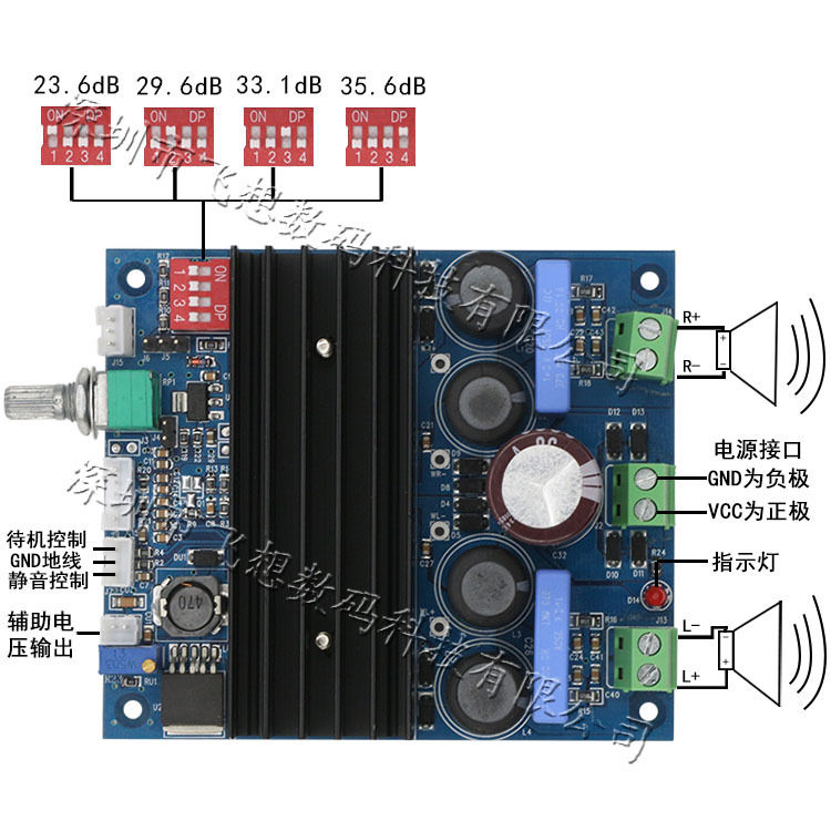

connections TDA7498e board
Hi all and Yatsushiro, I am new and the past weeks I read all your messages and learned a lot about this boards and the rest. Thanks for that interesting stuff! I am very happy with my RPI 2 with Mamboberry dac and want to connect it to an class D amplifier. I bought your favourite tda7498e and got it yesterday.
Can you help me with the connections? My Chinese is not very best
The only I understand is the speaker and power connection. thanks in advance!!

This image of the underside of the board will help:
Assuming you will be running in stereo, then use the 3 pin connector next to the volume pot for your L & R signal inputs and ground, using the plug and cable supplied.

Got all the parts in and put them together
Simply zip tied to a piece of cardboard for prototyping 😛
Next purchase will be a wooden amp enclosure, all the required connectors and safety bits as wel
Sounds awesome on my Acoustic Research dual 8 inch speakers though 🙂
