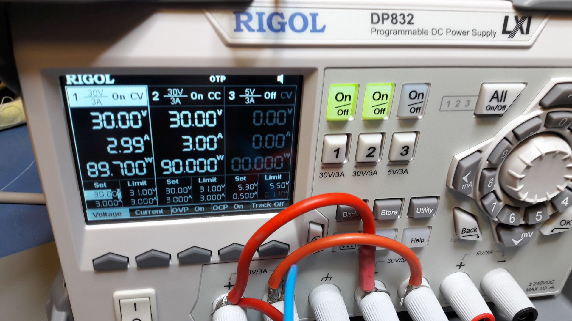

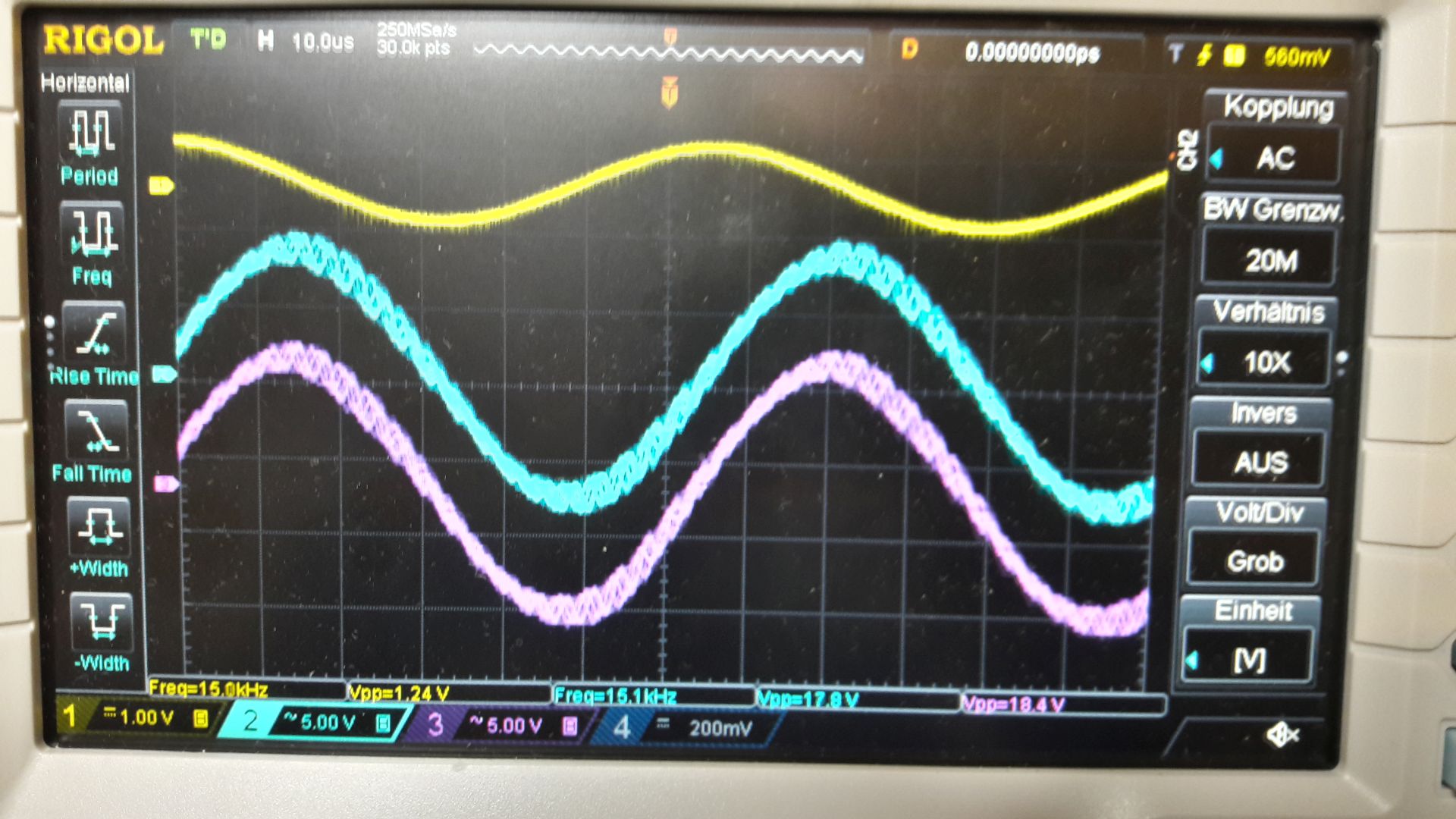

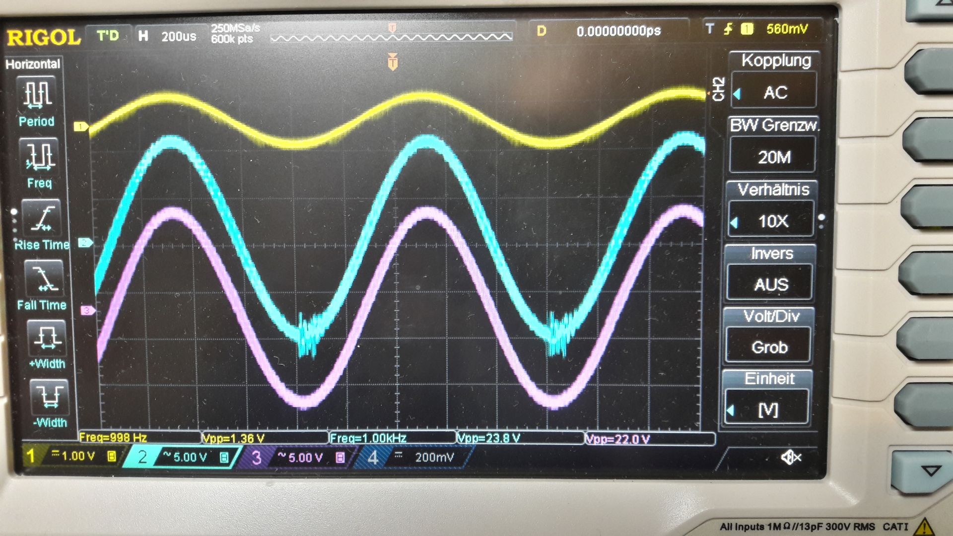

new measurements with 2x4700µF 35V...

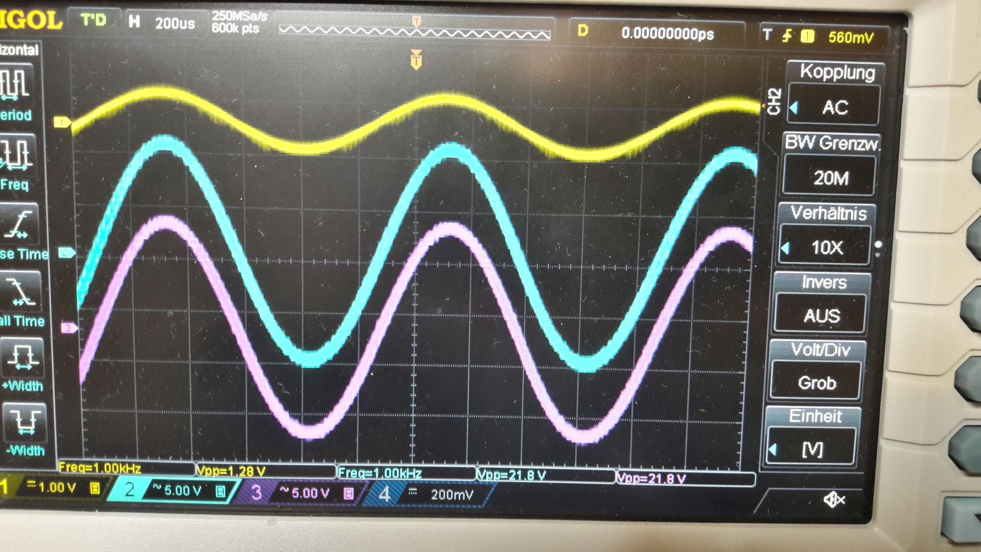

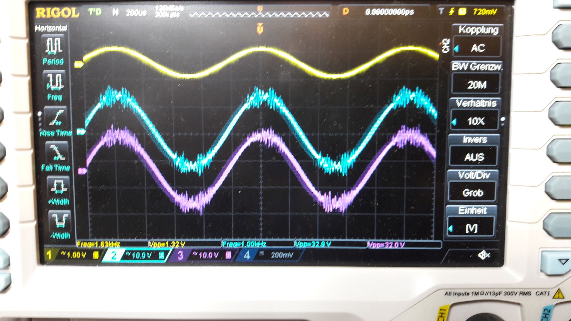

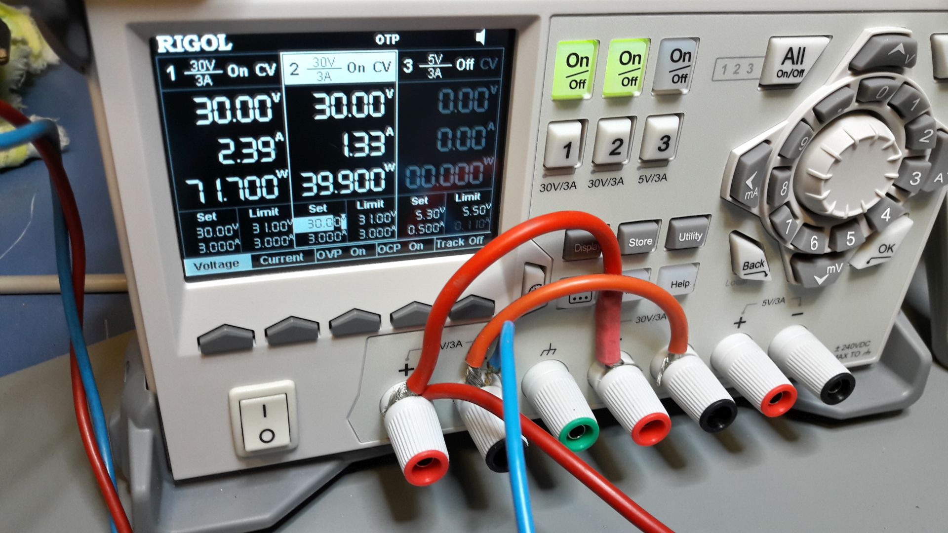

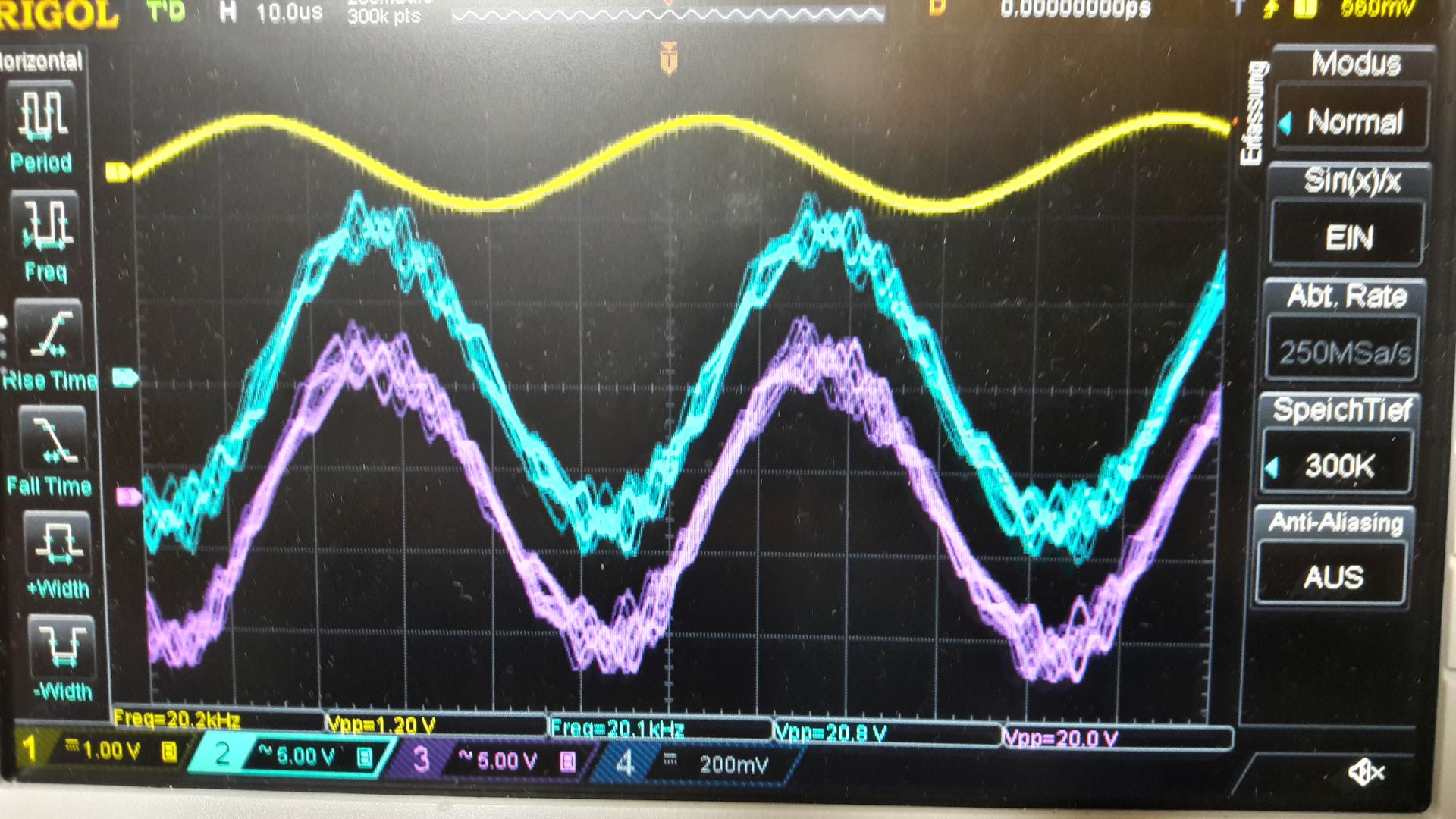

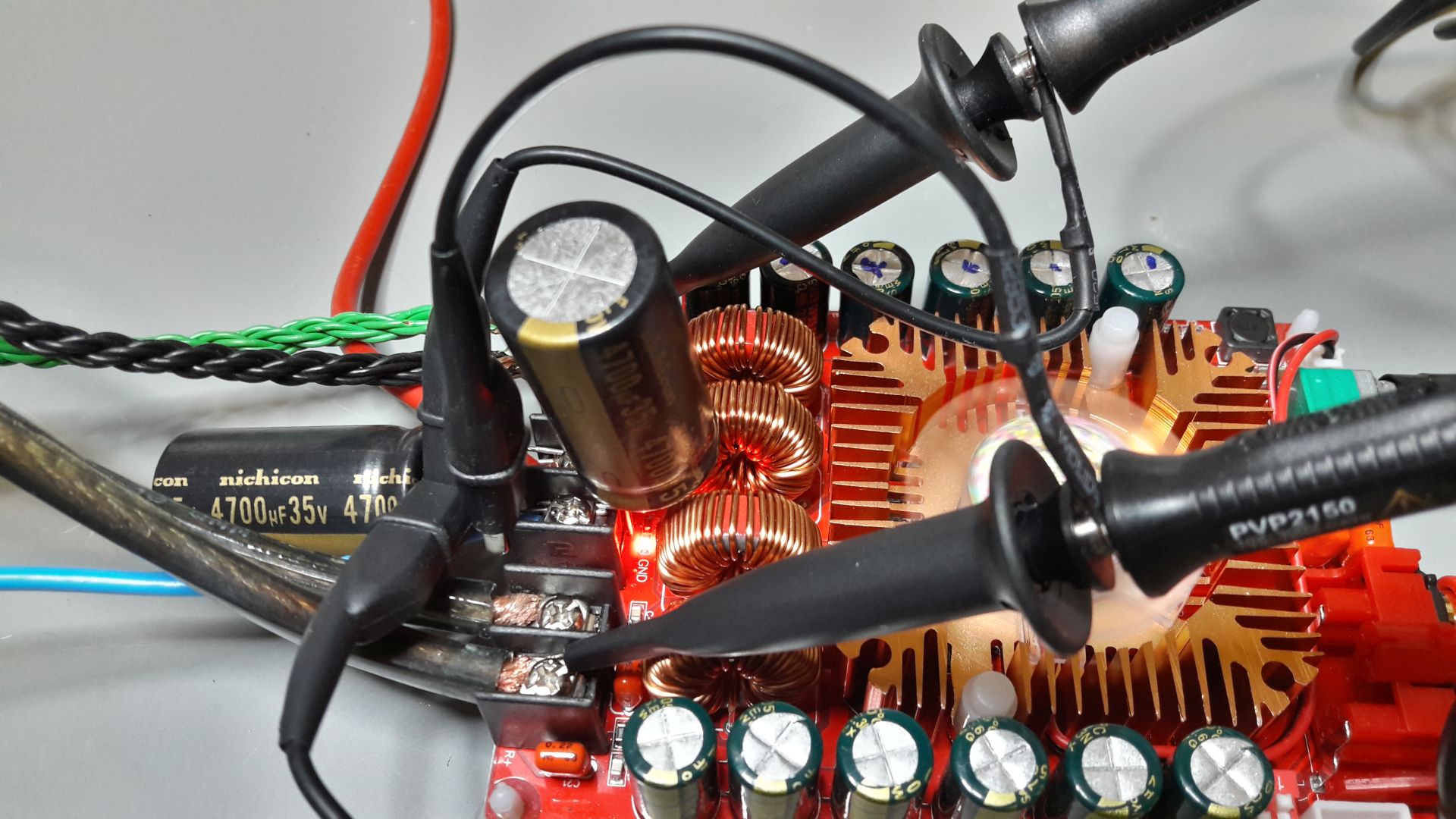

hi again..i did today a short measurement with 2 cpas directly at the board vcc gnd terminal = Nichicon 2x 4700µF 35V
yellow is input
light blue LChannel
pink Rchannel
if i made the same measurement setup i got appr. 5 Watt more power.but before clipping its still about 111 watt consumption at 21.8 or 22V max power on the output channel
kr
chris
yellow is input
light blue LChannel
pink Rchannel

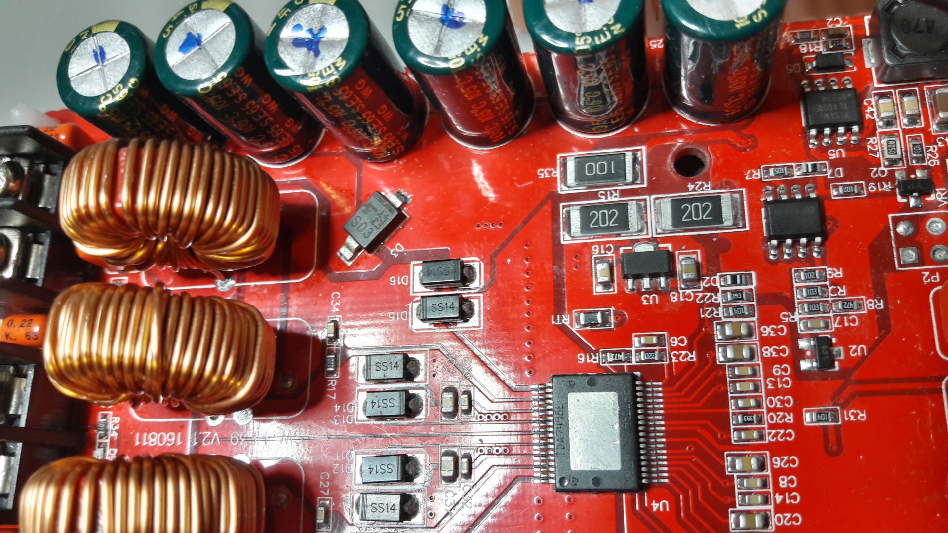

some pics of the too thin thermal fluid on this board. After cleaning its works fine.
That isn't too thin thermal paste, it was just way too much! With the ammount of thermal paste around the chip you can easily do four of them.

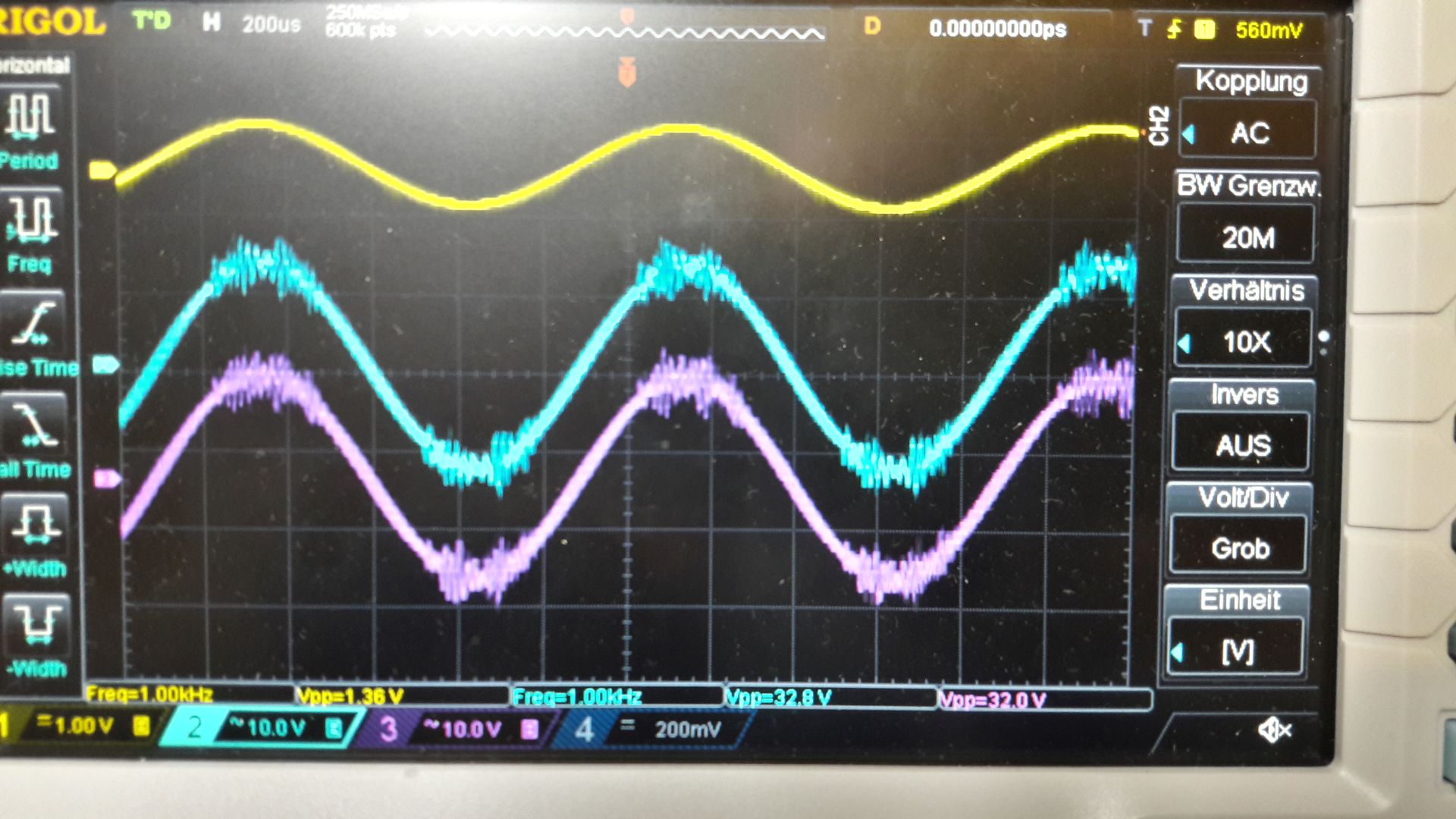

...so last thest for today...
i did the same measurements with 3x4700µF 35V caps at the terminals of the board.
now its is easily to move the volume knob to the max power level of my psu.
the 3xcaps are really helpful for my big fat psu !!!
quod erat demonstrandum😀
--> so always big fat caps for the board --> 3x4700µ = 14100µF
bye
chris

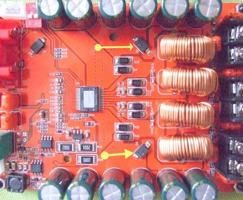

Did you mean these two diodes?...Lastly, consider short-circuiting the protection diode (polarity protection) found in between the output filter chokes. Then your external decoupling has got more effect.

Yep, they are the two protection diodes. If you measure with an Ohm-meter they should be connected in parallel from the + power terminal and to the positive terminals of the decoupling capacitors (one diode for each side).
You may replace these two protection diodes with short circuits and obtain better use of external decoupling, but, evidently you loose the protection. So, if you bypass the two diodes always make sure that your power is connected correctly before turning ON the power supply.
Happy new YEAR !😀
what are the other diodes doing???
all othere diodes (littele smaler -SS14-) are according to the datasheet to protect the outputs L+ /- and Output R +/ - ...... to GND and VCC?
