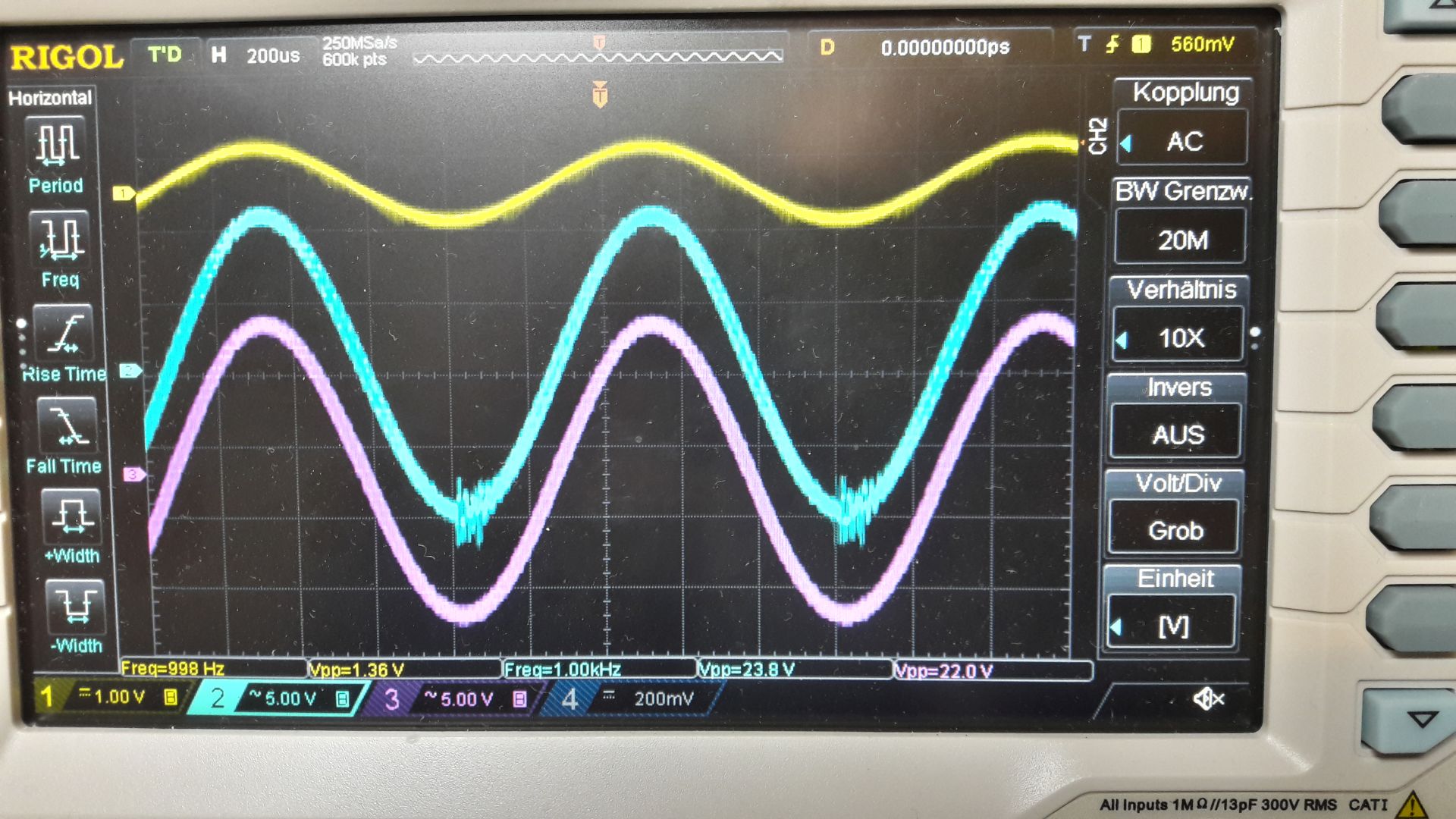

A made small mods for my red sanwu 7498e board as learnt in the prevoius pages.
I shorted the diodes in #430 and resolder all points because i see some bad soldering.
I have positive and negative effects:
1 positive is that the noise you can hear from the board above 4kHz -15kHz getting less
2 the ringing at the max power without distortion, see at #422 and #425 is still the same. How can a solve this ringing/distortion topic?

if a made a measurement with my oszi i can see a distortion/ringing = the sinus gets a strange hiss. (its above 21.8 output voltage -- see at posts # 422 and 425)
this "hiss" gets bigger if i turn louder = so the singal get more distroid..

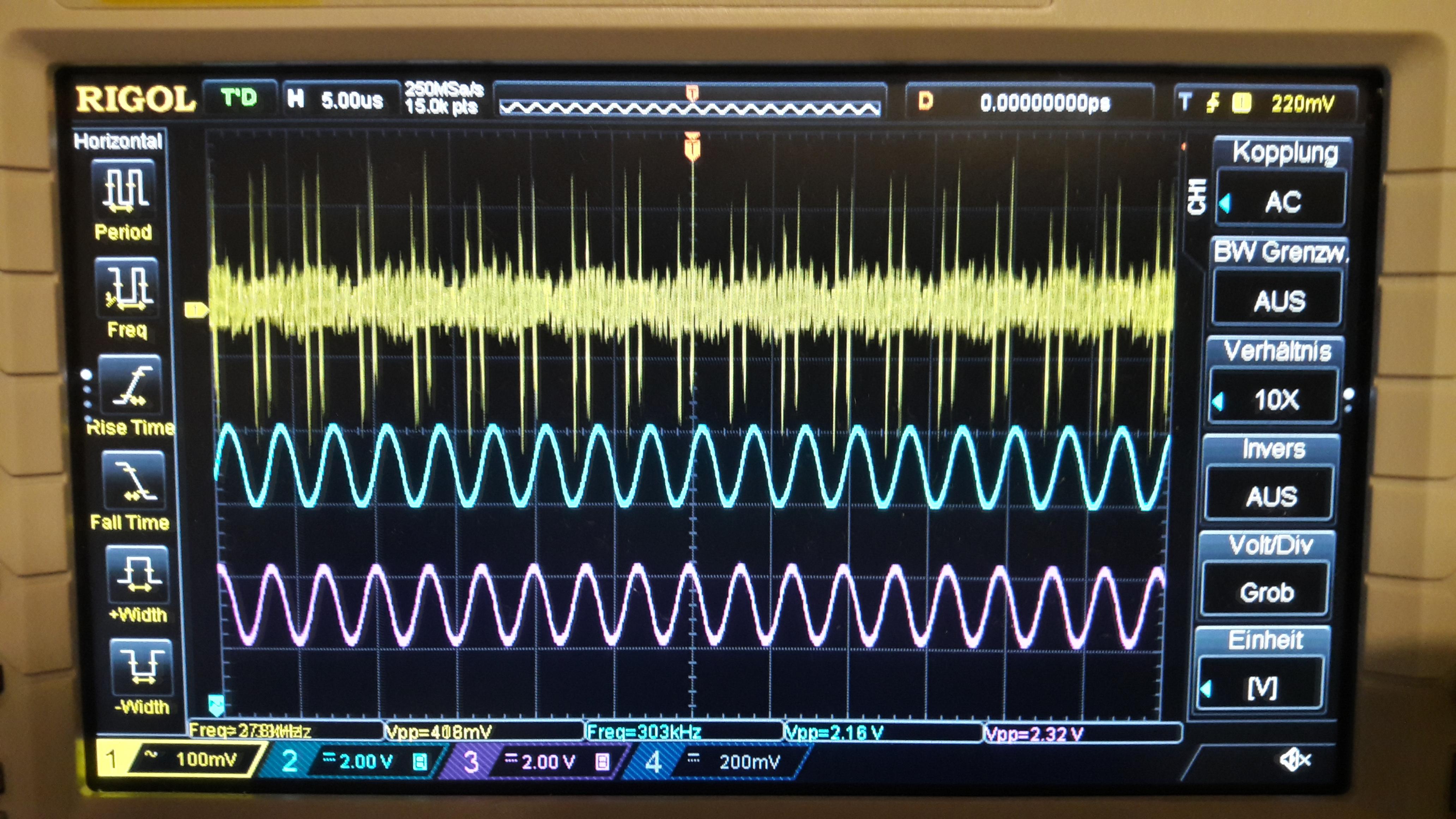

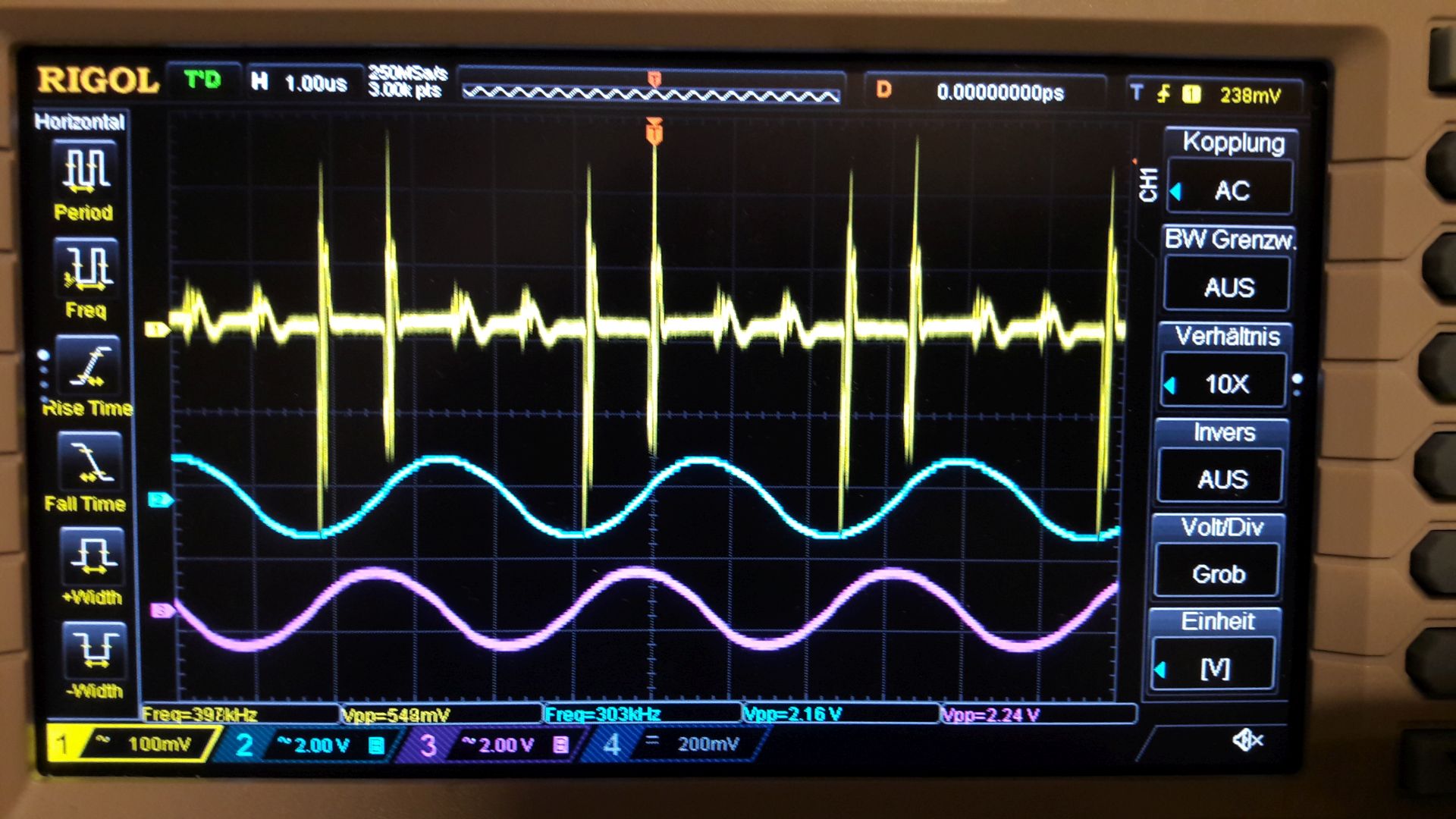

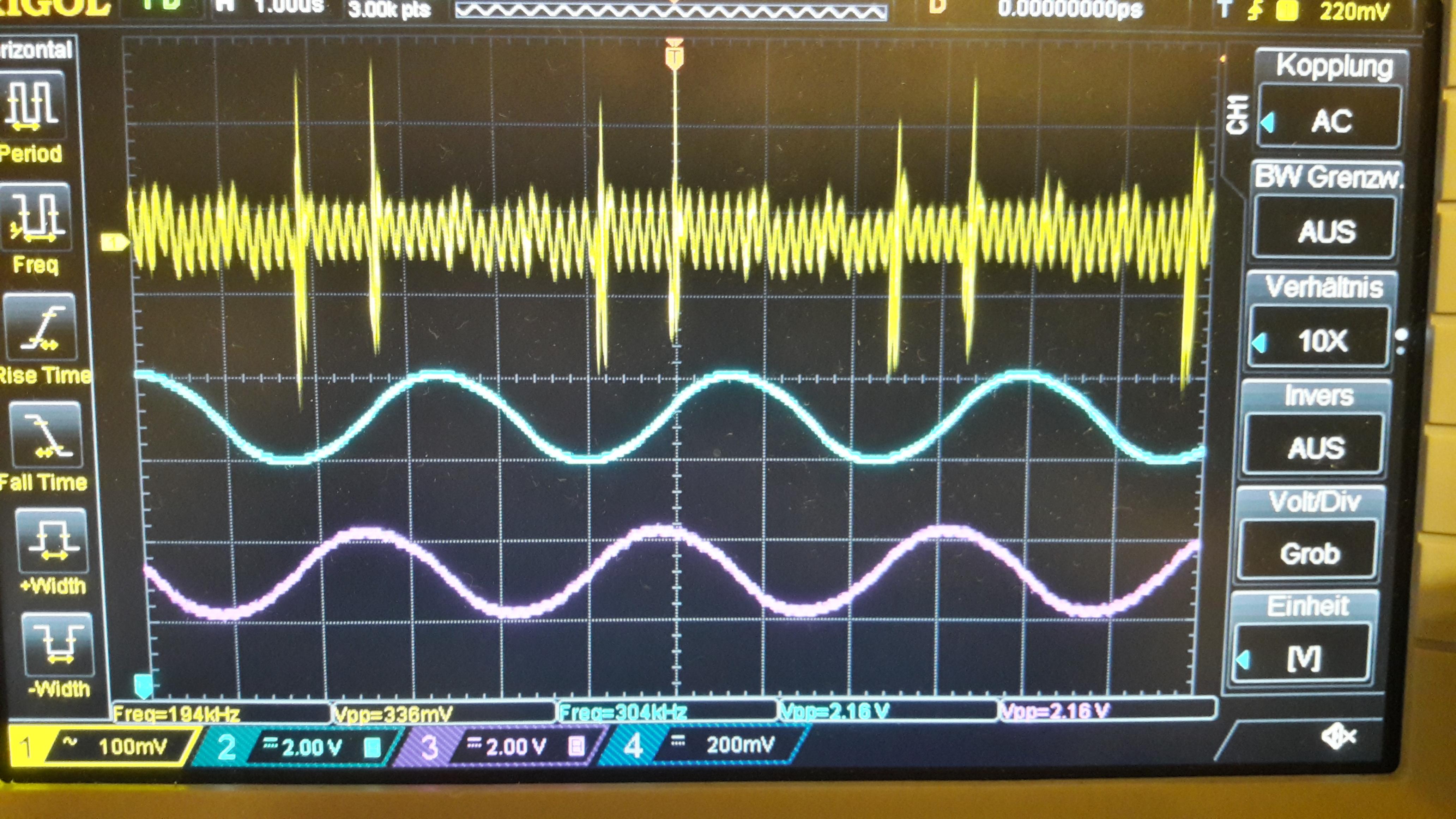

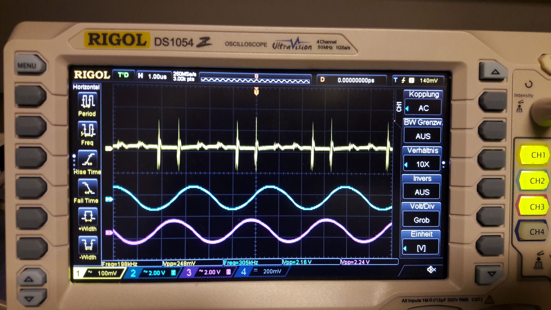

I did some measurments. no inputs singal just power up.
here you can see clearly the 300kHz working PWM of this module.
pics
1st one pic you can see the potentiometer - poti- in nearly mid position.
2nd you can see strange distorion if the poti is nearly at the end!
3rd and 4th i did the 2k2 resistors between the inputs (R to GND, L to GND)....so no changes

To start with the choke-noise: If you can touch the chokes and the noise disappears, it is very likely that you damp a mechanical resonance in the chokes. The way I know to solve such mechanical resonances is to embed the coils in resin (epoxy). In praxis for you, force a thick epoxy gel in-between the windings and the core with a brush. It will be a bit delicate with the little space on the board. Once the epoxy is cured it should not be possible to generate any sound from mechanical vibration.
You write that you can hear the 4KHz in the speakers if you turn the volume up. That confuses me a bit because then the noise is not only of mechanical origin but is in the electrical system as well. If you push the chokes with your fingers, such that you have no 4KHz choke noise, and then turn up the volume, do you then still have 4KHz in your speakers?
Your scope pictures (very nice oscilloscope):
Blue trace (303KHz / 2,16Vpp), where is that measured? Output signal with a dummy load connected?
Purple trace (303KHz / 2,24Vpp), where is that measured? Output signal other channel with a dummy load connected?
Light-yellow trace (250mVpp-550mVpp), where is that measured?
The blue trace is 90 degrees phase shifted compared to the purple trace.
If the 2.16Vpp relates to the 303KHz residual at an output, after the filter, it is possible. 24Vpp square-wave at 303KHz sent through a second order filter with a cut-off frequency of some 40KHz may leave 2.16Vpp, with some capacitance between the choke windings.

Sorry i do not explain my measuremnt enviroment...
Yes the yellow is the input. i do that on one of the L or R on the 3 pin connector. not on RCA.
the Blue and purple are the outputs on the speakers with 4.6 ohms 40 Watt loads (incl. fan) the connection is gnd to board gnd and the probe of both channels to the + of the speaker output.

Your yellow scope-trace does not look promising because you have 250-550mV (PP) noise on the line. Without an input signal and a low impedance at the inputs (2.2KOhm) there should theoretically only be a modest noise floor. The spikes we see must either origin from radiation from the rapid output switching, be caused by an inconvenient PCB layout or be generated inside the chip and conducted backward to the input(s). Let's leave that aside for a moment.
For the 90 degrees: It is at the modulation frequency of 303KHz. It hints that the chip designer decided to switch the output switches 90 degrees shifted such that the surge from switching is distributed in time and you achieve double the ripple frequency of the modulation frequency. This is a frequently used trick that lowers the ripple. So, initially no problem.
For the 2.16Vpp/303KHz remains at the output: A class D amplifier works like this that it generates square-wave signal with an average value equal to the instantaneous input signal. The amplitude is almost the supply voltage. The output low-pass filter recovers the average output up to above 20KHz. But, as any other filter, it is not ideal and leaves a small residual (remains) at the output terminals. In your case it seems to be 30V (supply voltage) reduced to 2.16Vpp.The filter is a second order LC-filter with a cut-off frequency of about 40KHz. So, 30Vpp/303KHz on a second order filter with a cut-off frequency of 40KHz sounds like it could result in 2.16Vpp/303KHz. The speakers will never react to such a signal anyway.

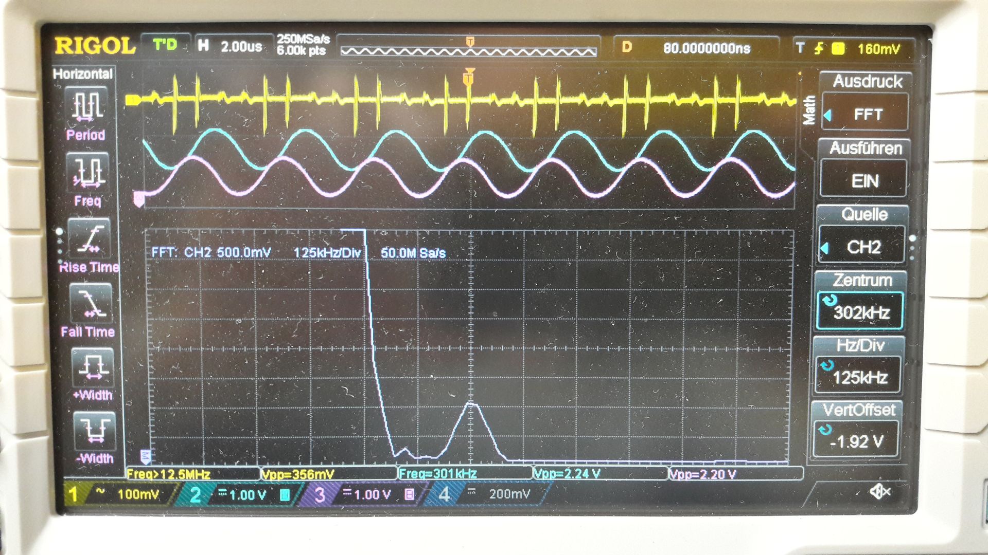

i did another test with FFT measurement, but i am not an expert...
yellow input but without signal no 2k2 resistor...., blue and purple are output channels. with 4.6 ohms load each channel.
30VDC power supply Rigol DP832...maybe the spikea are comming from this device...
you can see the centrum at 302khz, but i can see a peak at neraly 0HZ, whats that ???
once again thanks a lot !!!! merci
