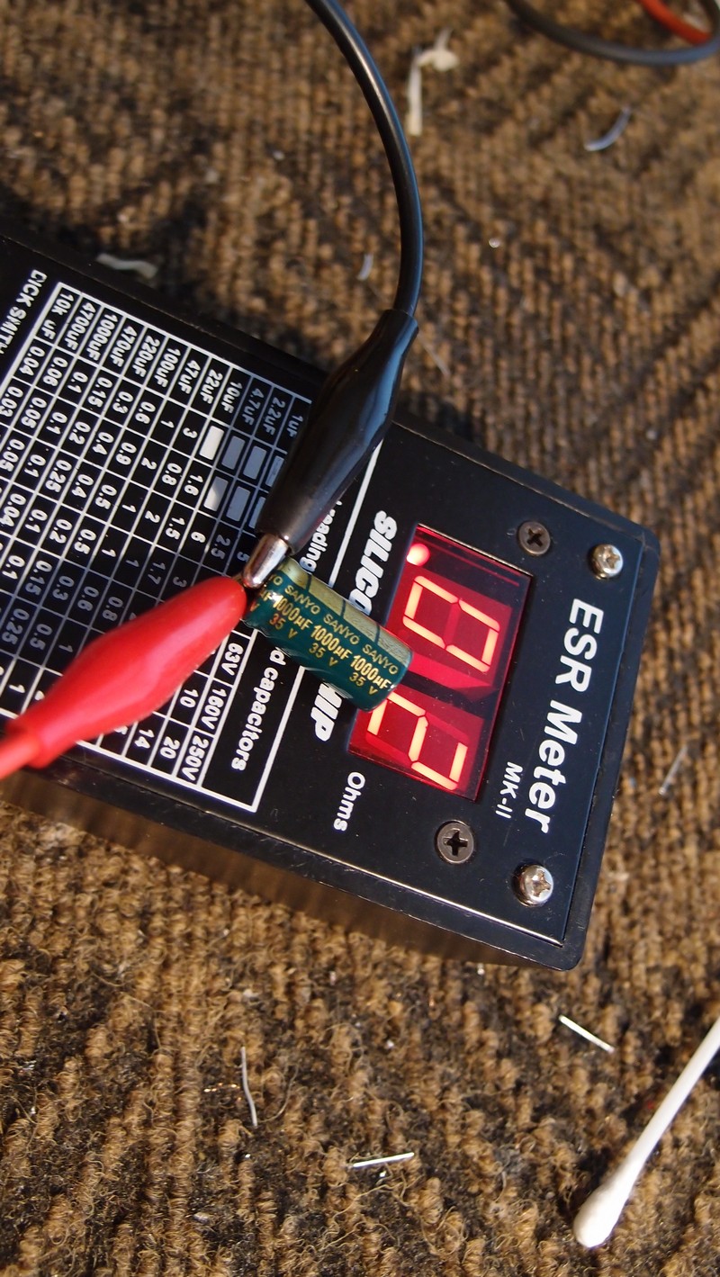

I have removed and measured these 1000uF/35V Sanyo WG caps and found them all to be .02-.03 mΩ, so they measure okay, but these are known counterfeit capacitors. The "bulging" was probably just a quality control issue on these caps, true bulging caps would reflect a poor ESR measurement and these did not. But I did replace them with ZLH capacitors, 470uF/35V anyway. This is the only mod I have done thus far.

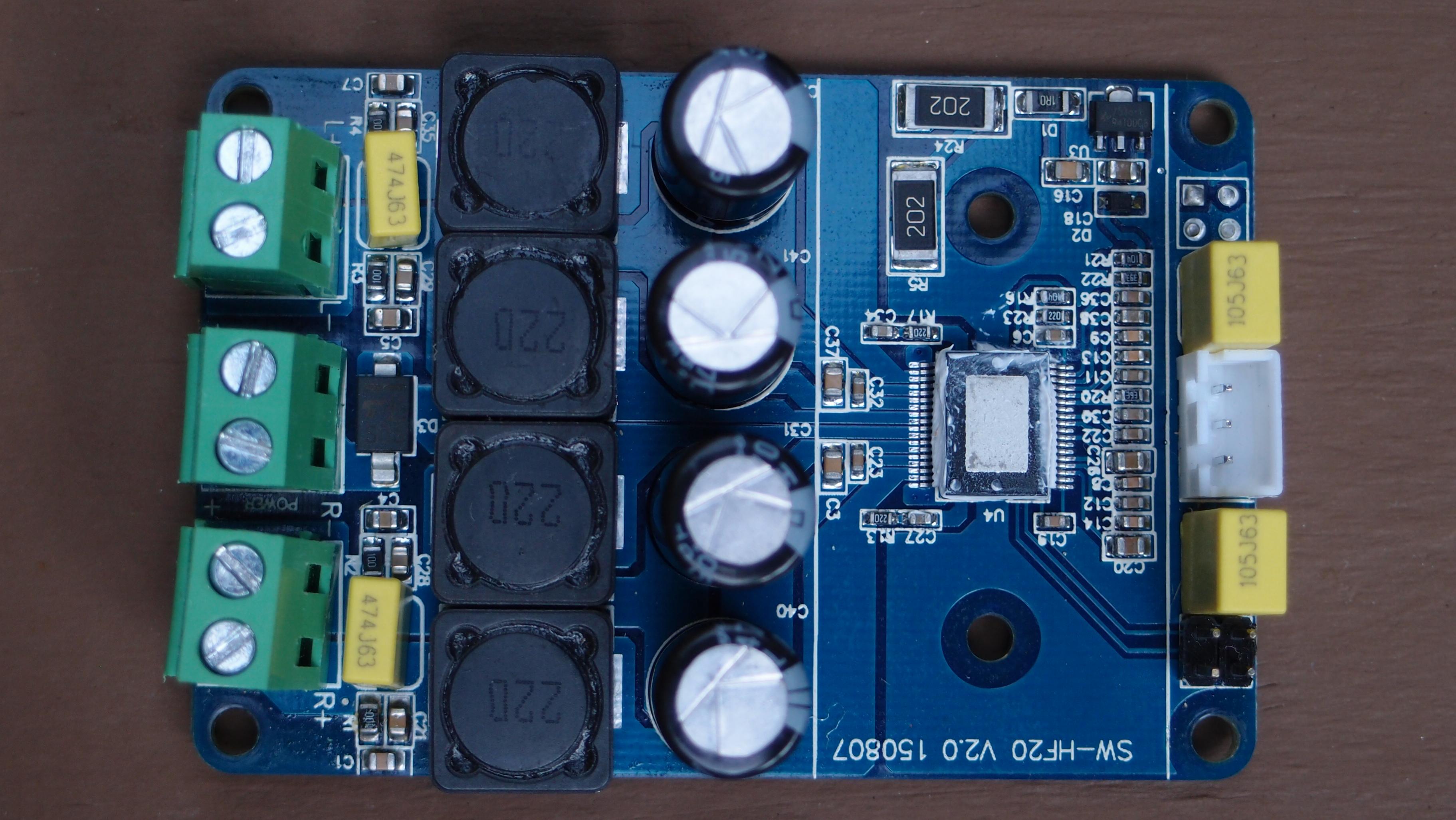

I have tried both 32V and 24V switching power supplies on this unit and, for now, I am believing his board to be just "OK." It is not among the best Class D I have heard, but it does exhibit good detail and plenty of bass. But I find the sound "busy" and "congested" and somehow not satisfying musically.
I plan on changing the input caps to 2.2uF MKT 1822. Also, note the output filter is different than the datasheet. The board has 22uH inductors with 470nF differential caps with 10Ω resistors, other caps value unknown. I may try to modify this to be closer to the datasheet, but working with these SMD devices is not something I'm looking forward to.
The board is generally quiet with no hiss or hum and I believe the gain (which is adjustable via jumpers) is at the default 26.

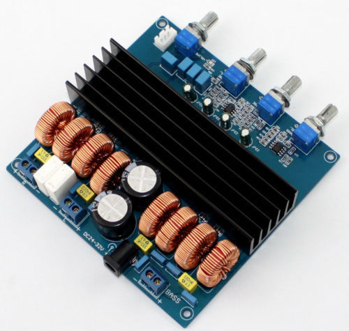

2.1 board
Anyone tried this board?
Input says max 32V and it seems to have those output resistors
New TDA7498 + TL072 Class D 2.1 Amplifier Board 200W+2X100W | eBay

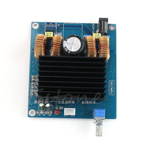

It shows alot of similarities to this Yuanjing mono board
New 150W Assembled Class D Amp Board TDA7498 Subwoofer Board Amplifier Module | eBay
The layout of the Yuanjing board (and clones) looks very similar to the TDA7498 datasheet, but the values of the differential capacitor (hard to see, looks like 330nF maybe?) don't match datasheet and the inductor values cannot be determined by inspection due to being toroid. Possibly the 22 ohm resistors are under the heat sink? Too many questions. The Sanwu blue board (SW-HF20) is actually quite good and can be obtained from sanwulasers.org, I am liking this board more and more. Output filter is very close to the datasheet and sounding very good with MKT1822 input caps and ZLH electrolytics. A good package for < $20 including mods.

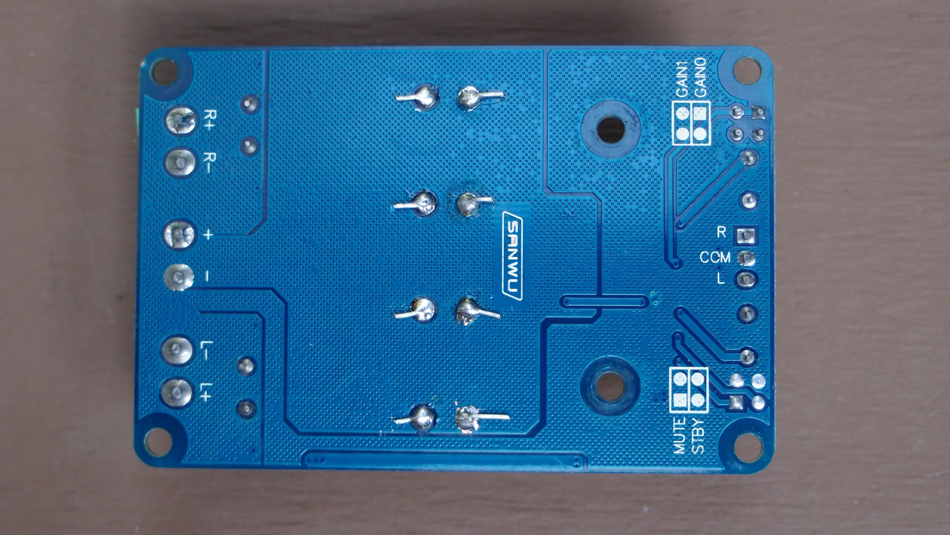

Has anyone tried switching these boards on and off using the "standby" pins as opposed to switching the actual DC input? The standby power consumption of the 7498 is pretty low, and the only thing I'm worried about is whether the speakers will pop if I don't utilize the "mute" pin as well. I plan to simply place a small switch across the standby pins, and keep the original DC barrel jack to connect to a laptop power supply.
The datasheet reports that one should pull up the standby pin and then pull up the mute pin to minimize popping on startup, then do the opposite on shutdown.

I have a switch to break the (+) in the DC in on the way to a 10K uF tank cap and I do not get any popping.
So my Sanwu board (deluxe version with the rca jacks) arrived today. Turns out they actually forgot to solder one of the capacitor legs onto the pcb; I had to do that myself. I'm running this on a 24V 3A supply.
Simply switching the standby pin (as I asked about in my previous post) to turn the amp on and off does work without popping.

Hi DreadPirate,
Can I ask why you would replace the 35V/1000uF capacitors with a smaller value of 35V/470uF? Generally i thought an upgrade entailed increasing the capacitance and not to decrease?
Malato
Hi DreadPirate,
Malato
The TDA7498 datasheet has a single 2200uF on the power rail, so 4x470uF (1880uF) for both channels is actually pretty close to the datasheet.

Typically, the Chinese boards put a lot more capacitance on the board at this location than is called for by the datasheet. I figure the chip manufacturer is in a better position to determine what is best for the chip.
I cannot say one way or another whether the caps I replaced are responsible for this board sounding so good now (I changed them right off the bat when I got the amp and also put MKT1822 2.2uF on the inputs), but on a YDA138, they made a drastic difference in sound quality, I would not underestimate the importance of having a good quality capacitor here, it can make a large improvement in sound.
I have been using this board (SW-HF20) now for a couple of months and am very pleased with the results. Detail and clarity are there, instruments and voices realistic. Good power to drive most small/medium sized moderate efficiency speakers at 24V supply at the default gain. I am running primarily on a set of Pioneer SP-BS22 with the Dennis Murphy mods (new Vifa tweeter and crossover). Mods to the board have been replacing the inputs caps to MKT 1822 2.2uF/63V (NOS from eBay vendor electronics-plus), the rail caps to Rubycon ZLH 470uF/35V (Digikey), and replacing the output caps with a 680nF value (mounted under board in pic) to better match the speaker impedance. The stock output filter is pretty much in line with the datasheet. Board was obtained from sanwulasers.org ($11 shipped). Very quiet, no buzz or hum at any volume. A very nice package overall, should make most happy.
