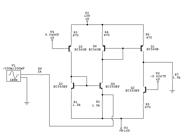

Let me throw out another “Easy-to-build I/V stage” I found online:
OK,
This must be it... my final I/V stage ... for now😉
The Vbias should be done acording to your favorite method (led, diodes, CCS, caps etc).
Some optimisation could be doen on the resistor values to increase ease of Voffset adjustment etc..
How about this one Jocko Homo? Agree that this could be worth those 4 PCM1702 I got?

Great! - tschrama
Best one so far 😉 😉 😉
of "Easy to build" and without exotic IC or expensive parts.
(Could be done more complicated 😀 😀 , with parts only the chosen few can find/afford 😀 😀 .
😀 😀 But who wants to see such designs? 😀 😀 )
/halojoy - knows what circuits he likes

tschrama said:OK,
Why don´t you try Jocko´s I-V stage ?
It sounds really good 😉
Nicke
What current.tschrama said:Thanks Halojoy,
What Iq do you suggest? 5mA, 10mA?
Thijs
Must depend on Peak input Current.
What is the peak out current of the DAC?
BC550/BC560 has low noise operation at 0.1-0.4 mA
and Good Bandwidth, speed at 2mA-5mA
0.4mA-2.0mA is a Good Compromisse, often used in Audio Amplifiers

The transistor will hold a temperture which is more
indepedent from surrounding temp.
It warms itself.
And the operation point is far from that unlinear
performance, in the "turn on" region.
So your suggestion 5-10 mA might be a good choice,
especiall as voltage only is 15V.
Will give about 75-150mW operation.

Pardon my stupidity... but how on earth can you bias those wierd values (i.e. -9.62V, 9.54V) with diodes/LEDs??? I would have a hard enough time doing it with 1% resistors... Please help 😕
Also - I'm confused about voltage bias using a CCS? Again pardon me - I'm a fresh out of school EE (although, I know that I'm of no such caliber to actually be called an engineer... 😱 )
I'd really like to build your last posted I/V stage in this thread - I've got all the BC BJTs sitting at home waiting for their new home...
I'd appreciate any explanations you can offer...

Well, I quite seriously doubt that he is biasing his base to exactly -9.6267V. Probably he just typed that in off a calculator or something. Looks to me like the best way to get a stable, quiet bias would be to use a LM329 reference from the rail. That would put Q2 at about -8.1V and Q5 at +8.1V. Adjust R5 and R3 to get the desired current for a given bias voltage.
You are right Tieftoener, such voltages can not be pratically be achieved with diodes and LEDs only.
I made my remark because some time ago there was a thread(s) as to how to accomplish very stable low noise voltage sourches. I've seen ellaborate configurations with CCS, shunt regs, lots of capacitance, diodes or LEDs (?) ... well ..etc...
If you use good power supply it can be as siple as a potmeter with a small cap across the middle pin and ground .. The approximation of Vbias can be calculated if you have choosen a Iq for the stages, this will determine the voltage drop across the resistors, keep in ind the base/emitter drop of about 650mV: well you figure that out offcourse. The circuit is sensitive for bias voltages so keep your scope and voltmeter at hand to check everything.

"Why don´t you try Jocko´s I-V stage ?"
Because they don't have the full schematic.
Anyway, the one that you all have is very close. Like the man said......try it.
The point of this was to show you how you can get really great sound without a lot of parts, and no feedback. And to get you guys thinking on how it works so that you can come up with the full version just like Nicke did.
Make sure that you have a very good PSU. This design has no feedback.....(because it is not needed, Elso.......), and the sound will suffer with a poor supply.
IOW, no three-terminal regulators.
