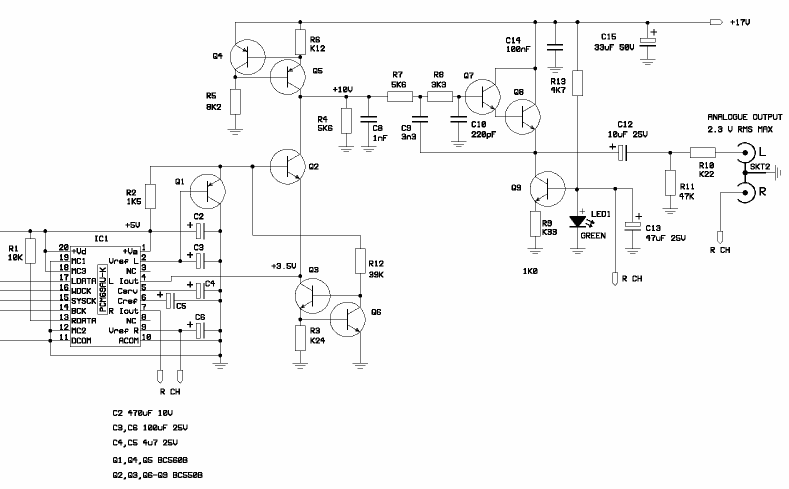

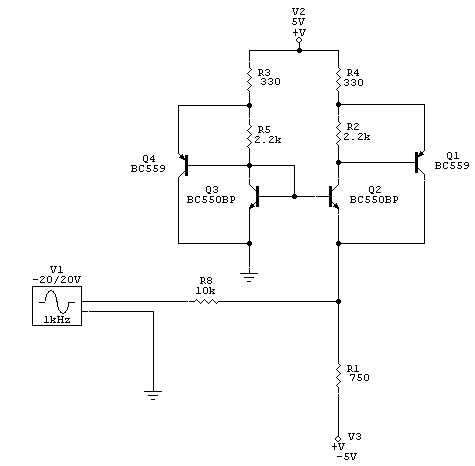

I think this could be a discrete easy-low-voltage IV-stage. The CFP does a great job lowering the input impedance and lowering the distortion. Needs to adjust the input Vdc .... it's just a circuit I had for a while now.... finaly a reason to post it.. 😉
What do you think Elso?
IS Jocko still around? It challences your circuit for low input R I think, but that might not be sooooo important........
Thijs

Actually good questions... it's a little less straigth forward than the more simple single BJT version ... Voltage out is between R4 and R2 ..needs a output coupling cap too ....

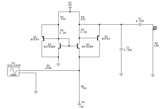

A final question- about filtering....
Thanks.. So if I just connect to the junction at R2-R4 and a.c. couple this with a suitable non polar capacitor I am in business?
A final question, then I must go...
I am using a non-oversampling setup and I wish to use a first order filter (at say 200kHz) to remove excess r.f. garbage from the signal chain and affecting my power amplifiers. Will your circuit accept a simple RC filter at the output or should it go elsewhere?
jean-paul said:X-pro, is that a MF schematic ?
No. This circuit was never in production AFAIK. (And I would never publish somebody else's circuit anyway - this one is my own design from 1994).

I've just posted a versions with output cap and HF roll-off cap. This would give you the disered -3dB at 200KHz (or about).
Do you really think your amplifier responds to 200KHz? If so, -9dB at 400KHz is not a large attenuation ... I think you could easely put a fc at 40KHz.
Thijs
Thijs
X-PRO,
Is there a specific reason to connect R12 to the base of Q2 ?
Couldn't R12&R6 be just one resistor between the current source and sink ?
You seem to use a LED constant current source, as well as 2-transistor constant current sources. Any reason why you didn't use LED ccs throughout ?
Now I don't quite remember why I did connect R12 there. Perhaps then it did make sense 🙂 . However with LED current source there is some reason: in the output follower quality of the current source is not that important, and it saves 2 transistors... .
x-pro
x-pro
tbla said:is this the output stage from the exposure cdplayer...?
As I've posted earlier, this design never went into production. And I never worked for Exposure 🙂 .
x-pro
Thanks Tschrama- perhaps 40kHz is better
Tschrama,
Thanks for the modified cicuit. Perhaps my 200kHz choice is a little inappropriate- How could I modify component values for a more sensible 40kHz cutoff?
I desire a suitable voltge output from this circuit (e.g. 3V peek to peek). Do I have to adjust any resistor values to get this from the current output of the AD1865?
Tschrama,
