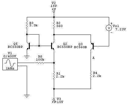

I built this thing......made a few changes........
The load resistors are 3 K, so that you actually get some gain out of it. The resistors for the current mirror were changed to 5 K so that the collector voltage was decent. Raised the rails to +/- 24 V.
With 1.2 mA (peak.....which is what a '1704 puts out) the distortion is.........drum roll, please........
- 40 dB.
Just one problem. That is when you measure it from the collector to ground. When measured between the collectors, it is -23 dB.
So there.
Jocko
Hi Jocko,
Sorry if I gave the impression that I didn't believe you. I just don't understand but I didn't mean I didn't believe it.
Thanks to your reply I finaly got it.. the resistor to ground levels the gain; the bias point is set by the CCS; the CCS lowers Iac?; CCS improve PSRR... thanks for your hints! 🙂
I allways understood that the way to reduce distortion in a simple BJT stage was to
1] decrease Vac (Cascodes do that)
2] decrease Iac (CCS do that)
3] Increase Iq
4] Increase Vce quesient
That why I still don't understand the high distortion in my circuit, maybe add a Cascode for the active devices.
I will go over you comments once more...
gr,
Thijs

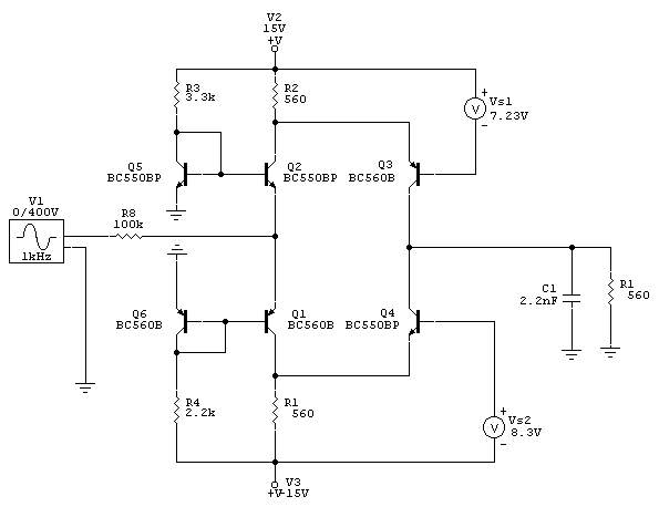

Hi Jocko and all others... I know this will sound absolutely un-reliable, but we know that allready.. so here goes:
The schematic is only changed in this way:
-changed 1000K input resistor (to simulate current driven output of TDA1541 DAC) to 1K
-changed voltage source to Vbias= +2Volt and Vac = 2Volt peak
I used CircuitMaker2000, 250 points per cycle, 1KHz, fourier up to 10th harmonic
Results:
output = 669.4mV RMS
input impedamce = 2.4 Ohm
Vdc at input = 1.6mV
Vac at input = 3.4mV RMS
Iq BJTs = 6,9mA
Iac BJTs = about 700uA each BJT
Distortion: 2nd = -98dB
3rd = -128dB, all others about -130dB
well..... hows that for a Spice simulation.. unbelieveble I guess....
Why is my simulator giving me this perfect results
:bawling:
gr,
Thijs
Hi again,
well just finished my folded-cascode versions.
I simulated both a simple single BJT with folded cascode and a double (like my earlier schematic) with folded cascode.
The nice thing is the circuit can be made DC coupled with low offset, allthough this requires carefull adjustment of the cascode voltage reference (the x-BOSOZ has the same problem, some other thread). The bad thing is that somehow distortion rises to -65dB but all harmonics decay down very nicely from that point on. The output voltage AC ('gain') is very easy to increase by just 1 resistor in the double BJT version, and ias doubled in my single BJT version..
If you want to see a schematic I'll post it for you.
goodnight,
Thijs

this is what I use now..
about the cascodes: I don't know whether I've done it correctly. I'm quite sure almost anybody can imrpove the circuits.
The cascode are so sensitive for the voltage references that it doesn't seem practicle to build and adjust. I wonder how Nelson Pass it does in his X1000/600 series.
The simulator doesn't show any benifit except for DC coupling and increased bandwidth. The distortion doesn't decrease anymore with the 'parrallel' version neither, while there was a 20dB decrease of doistortion with the cascode-less version when I desighned the ' parrallel' two BJT version...

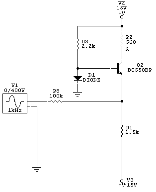

hmmmmmmmm
doesn't the SuSy patent circuit have a low impedance input node? hmmmmmm
