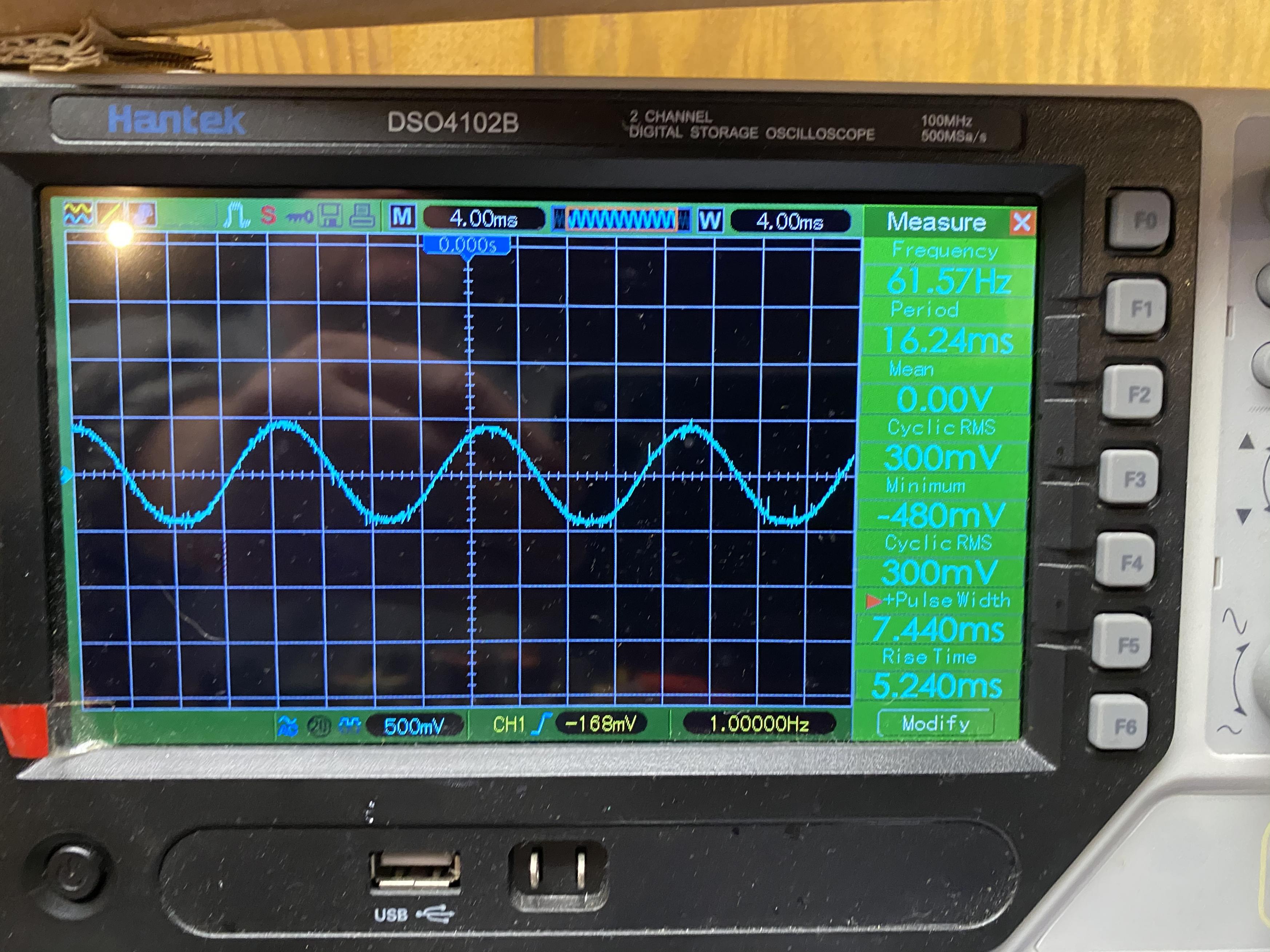

You could probably do it with high value resistors (above 10k) but not with anything much lower. A lot of amps with the 4080 have 470k ohm. I don't remember seeing anything less than that in any amps. I'm sure that the 4080 can drive at least 10k but it's more load than there needs to be for long term operation.
This is what I get on pin 7 of the 4080 with no audio signal.
