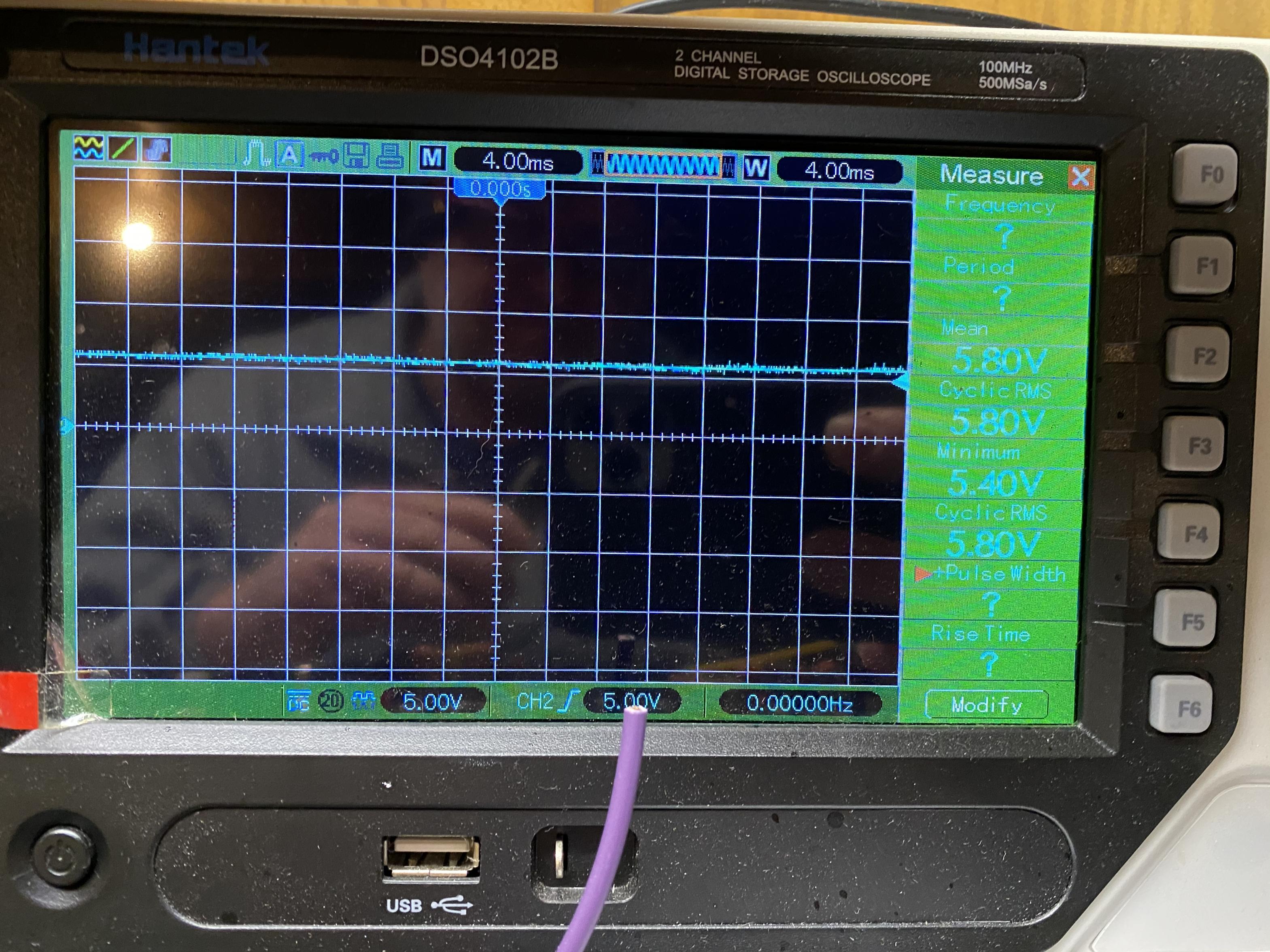

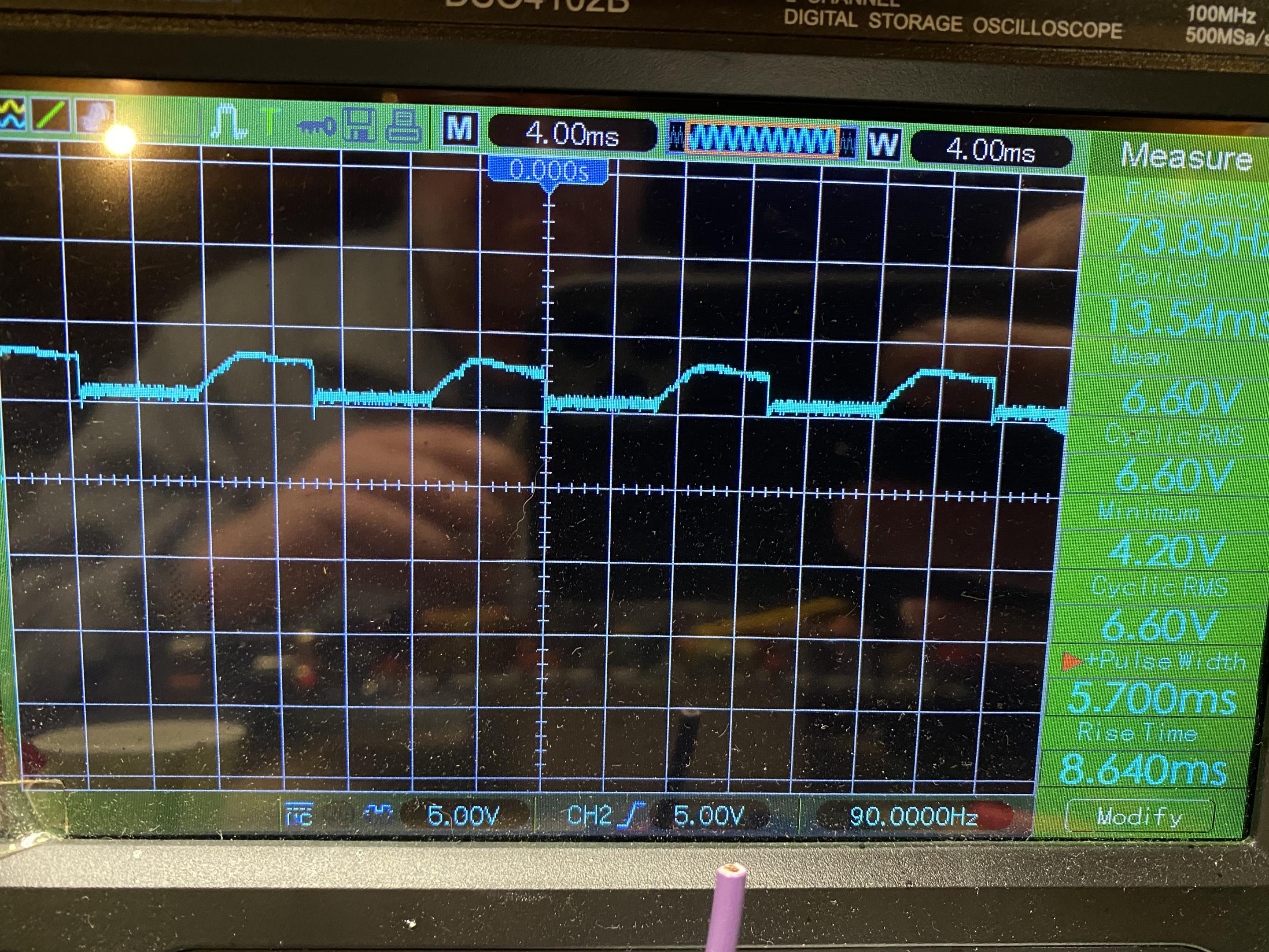

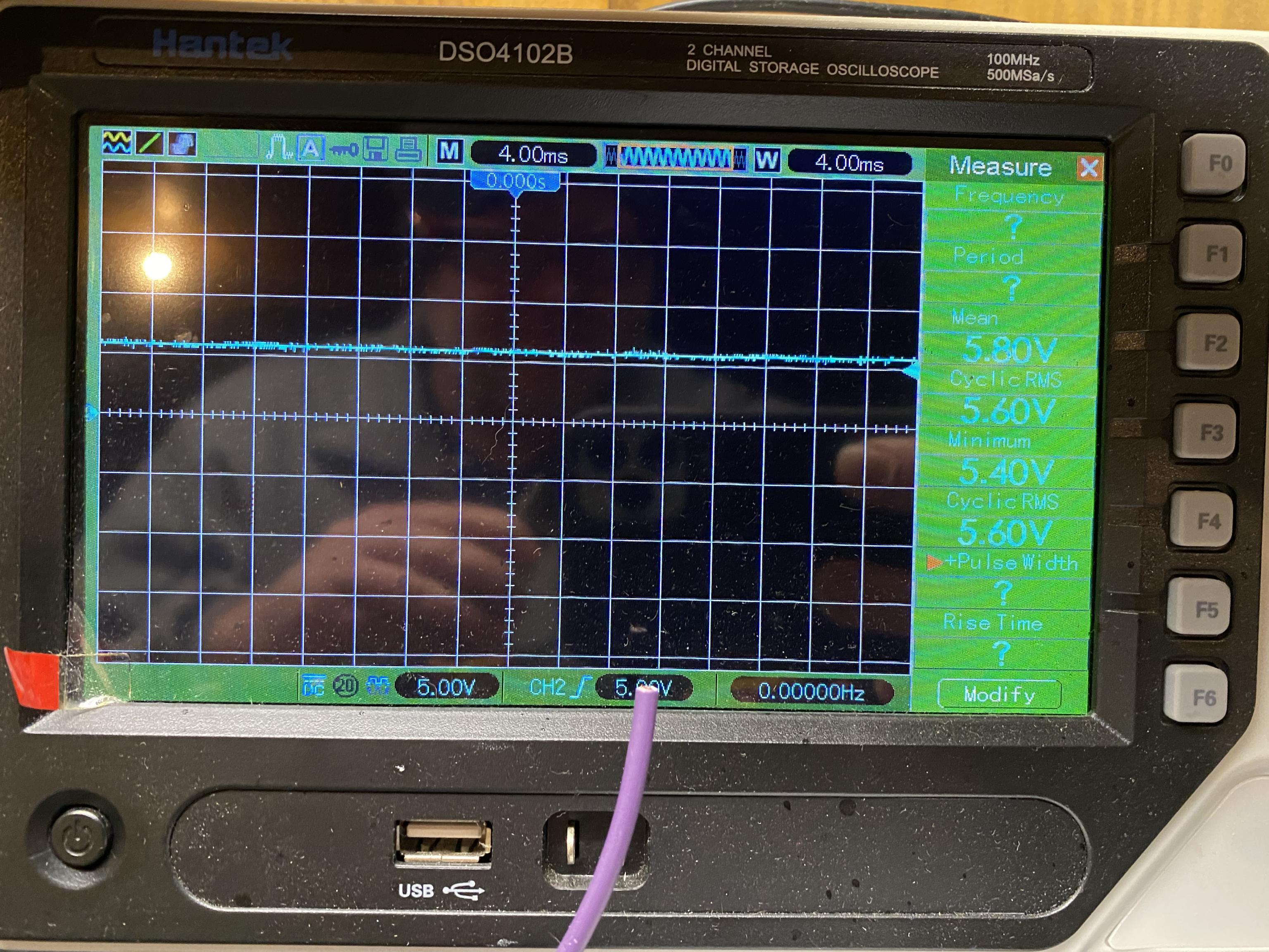

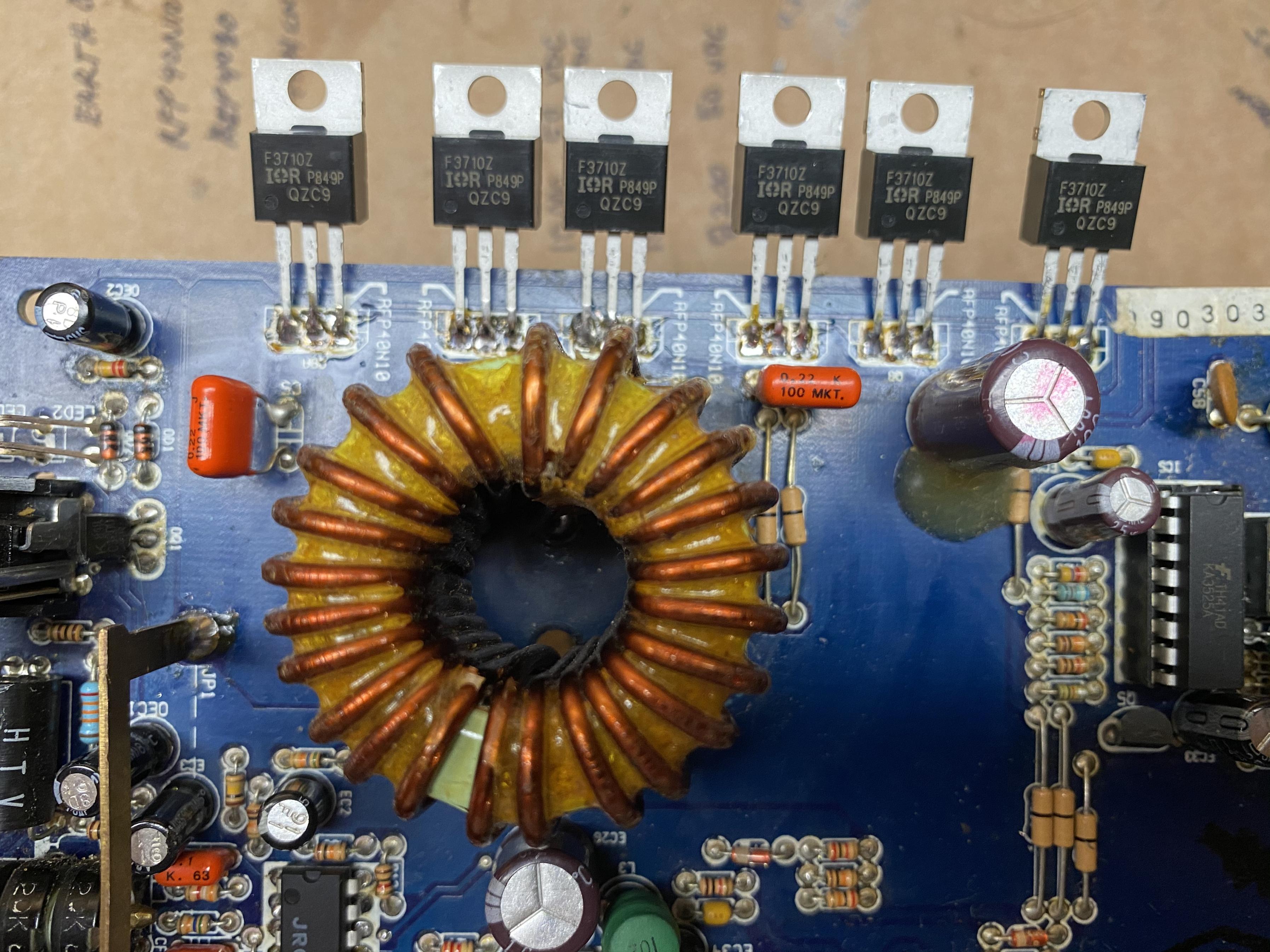

When shorting pins 8 and 9 I have no waveform on pin 10 or pin 8 or 9. I did try jumping pin 1r to pin 10 because I had audio signal there. That immediately producing a 60hz square wave. If I run a jumper wire from rca signal to pin 10 I get no waveform. With no signal and pin 8 and 9 shorted I have 6vdc on the speaker terminals
Audio from pin 14 was fed into pin 10. Pin 8 and 9 now have a square wave and and square wave on pin 7 of the 4080

Post the signal you now have on 5, 6 and 7 of the 4080.
Hey perry is it possible to power the amp with the 4080 removed. I can’t seem to find this signal problem on this amp. I also can’t seem to get the dc offset control to work either.
Will removing the hip4080 break the feedback loop? Still trying to isolate why signal going to the 4080 is distorted

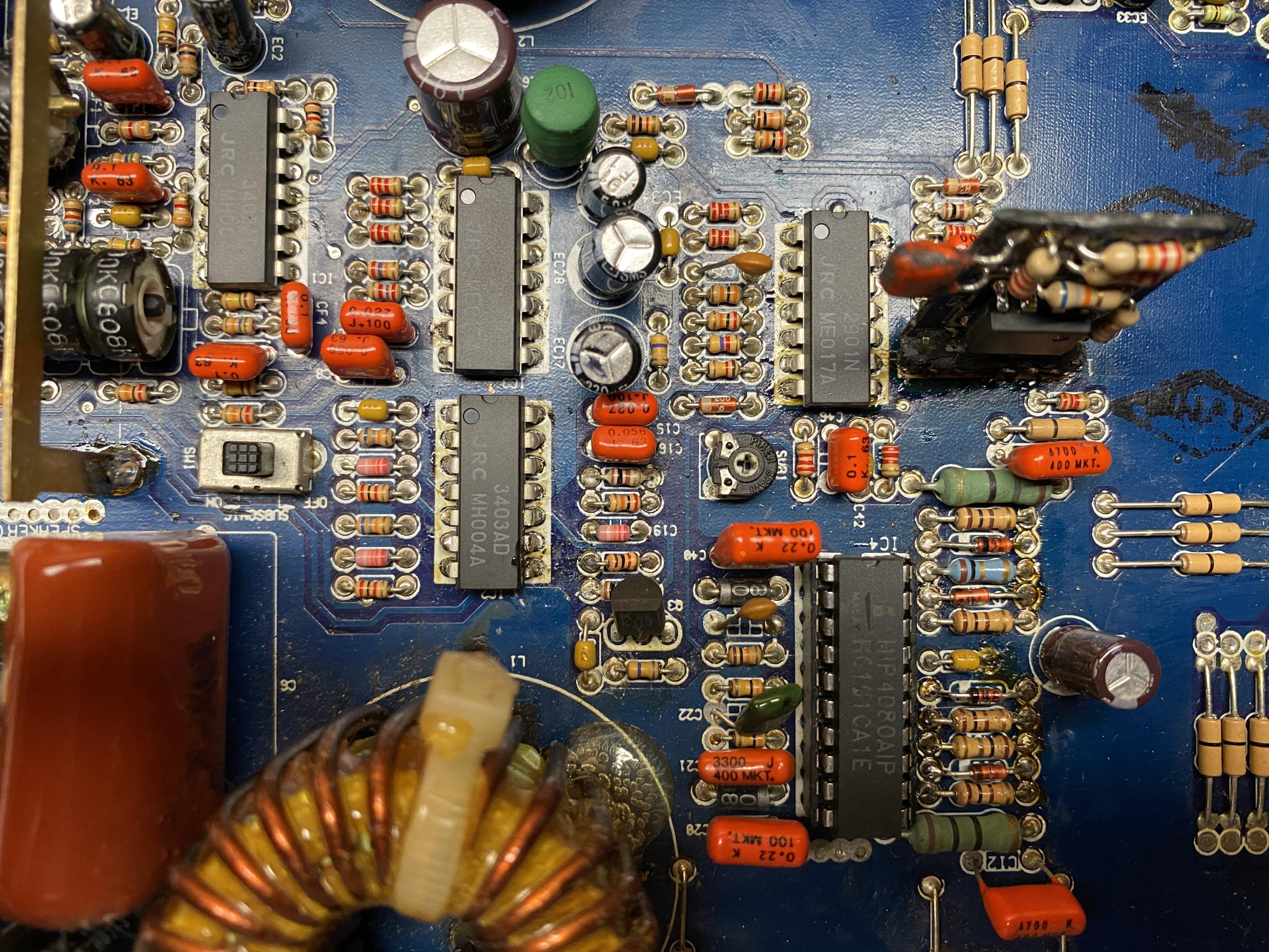

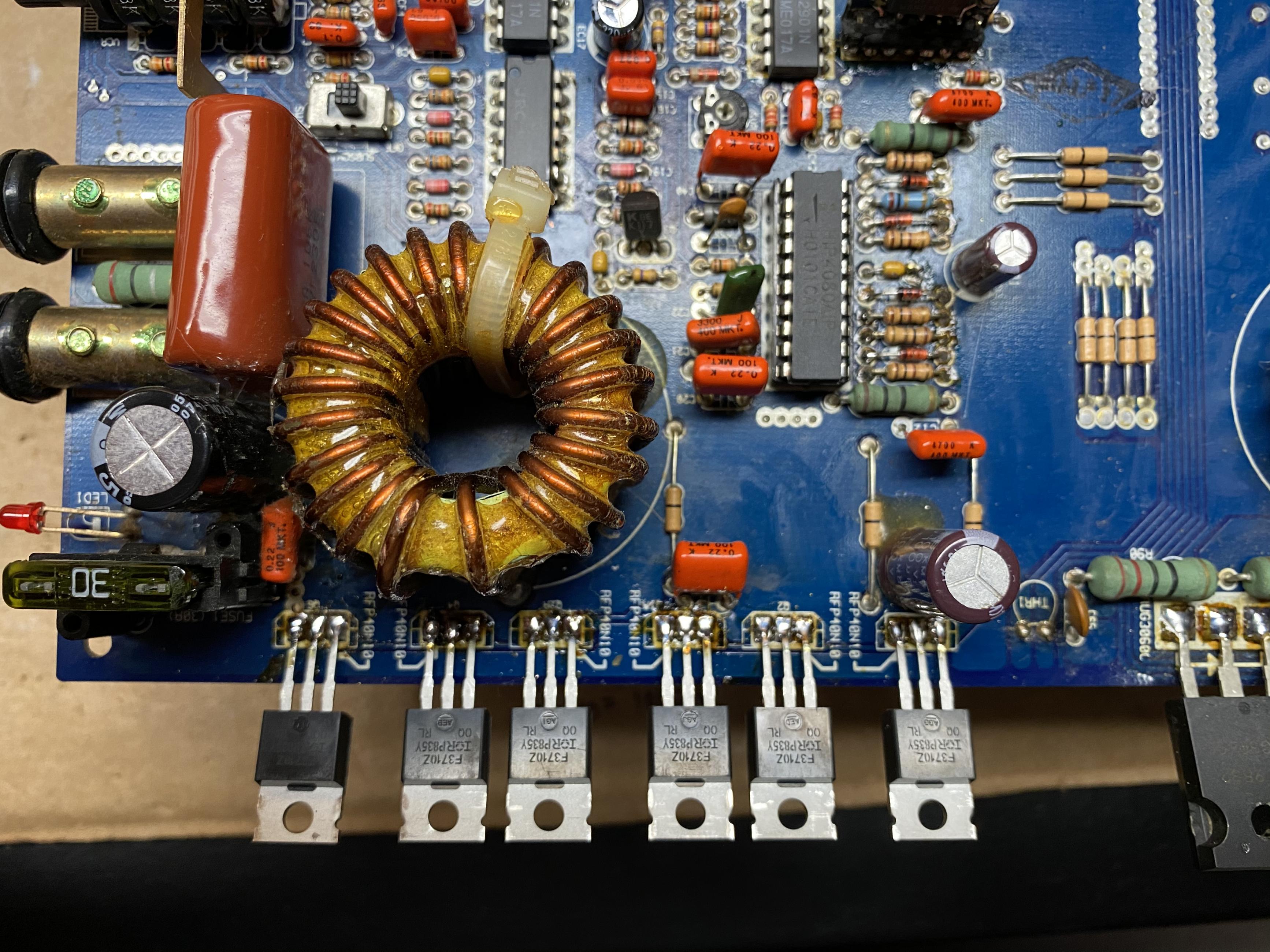

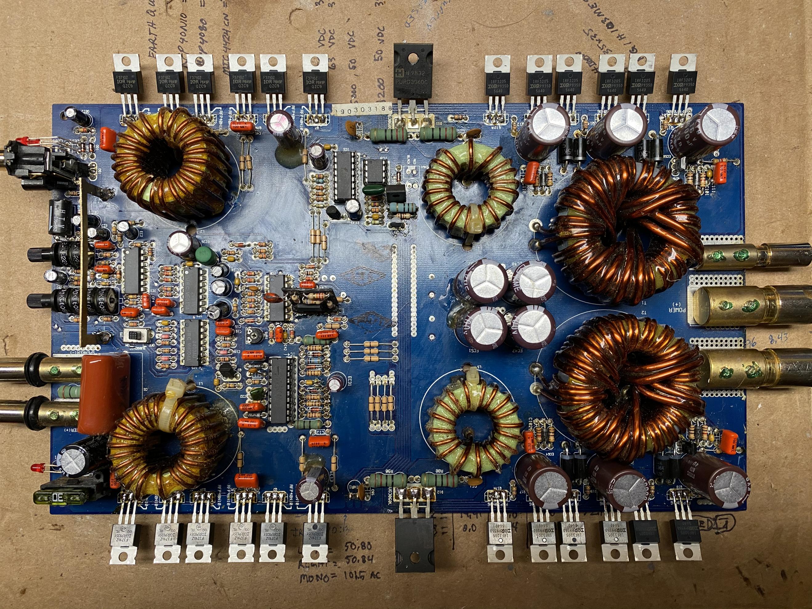

Hey perry,
Here are the pics of the board.
That one has no pulldown resistors. You have to add one per bank. Virtually anything between a wire jumper and a 100k will generally work. Solder the resistor between the gate and source legs of the output FETs. It doesn't matter which of the 3 in each bank you solder to. 4 resistors total.
When you power up, make sure that none of the FETs are getting hot and the current draw is nothing more than normal idle.
