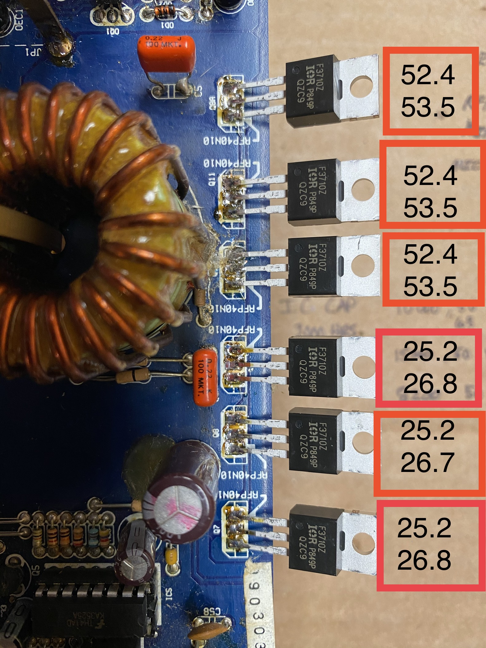

Hey perry just to confirm these voltages are correct. Voltages were taken with positive lead on the center leg of the IRF3710z. I be posted a pic with voltages. Please let me know if this is correct. Voltages taken with no load and no signal input.

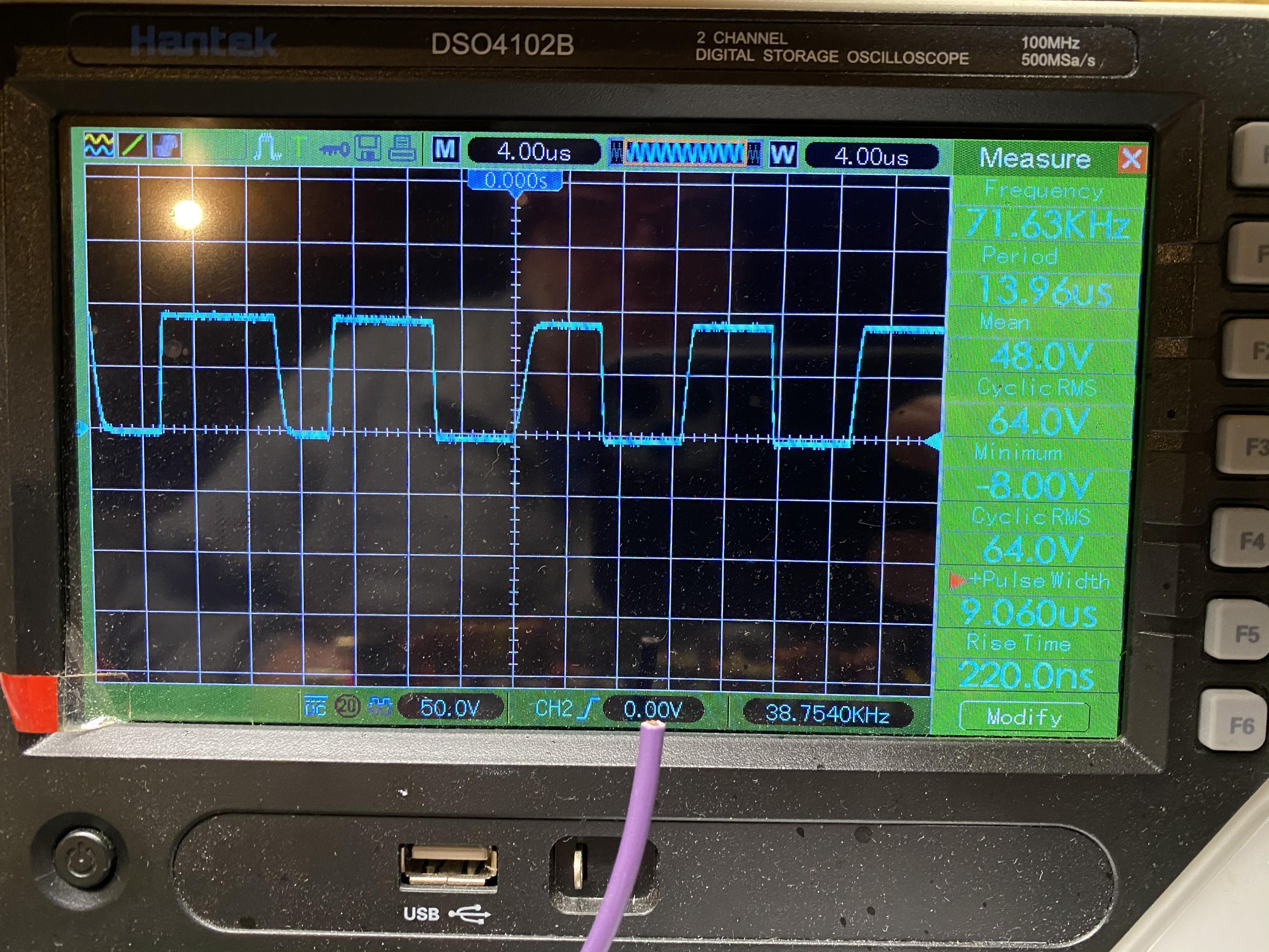

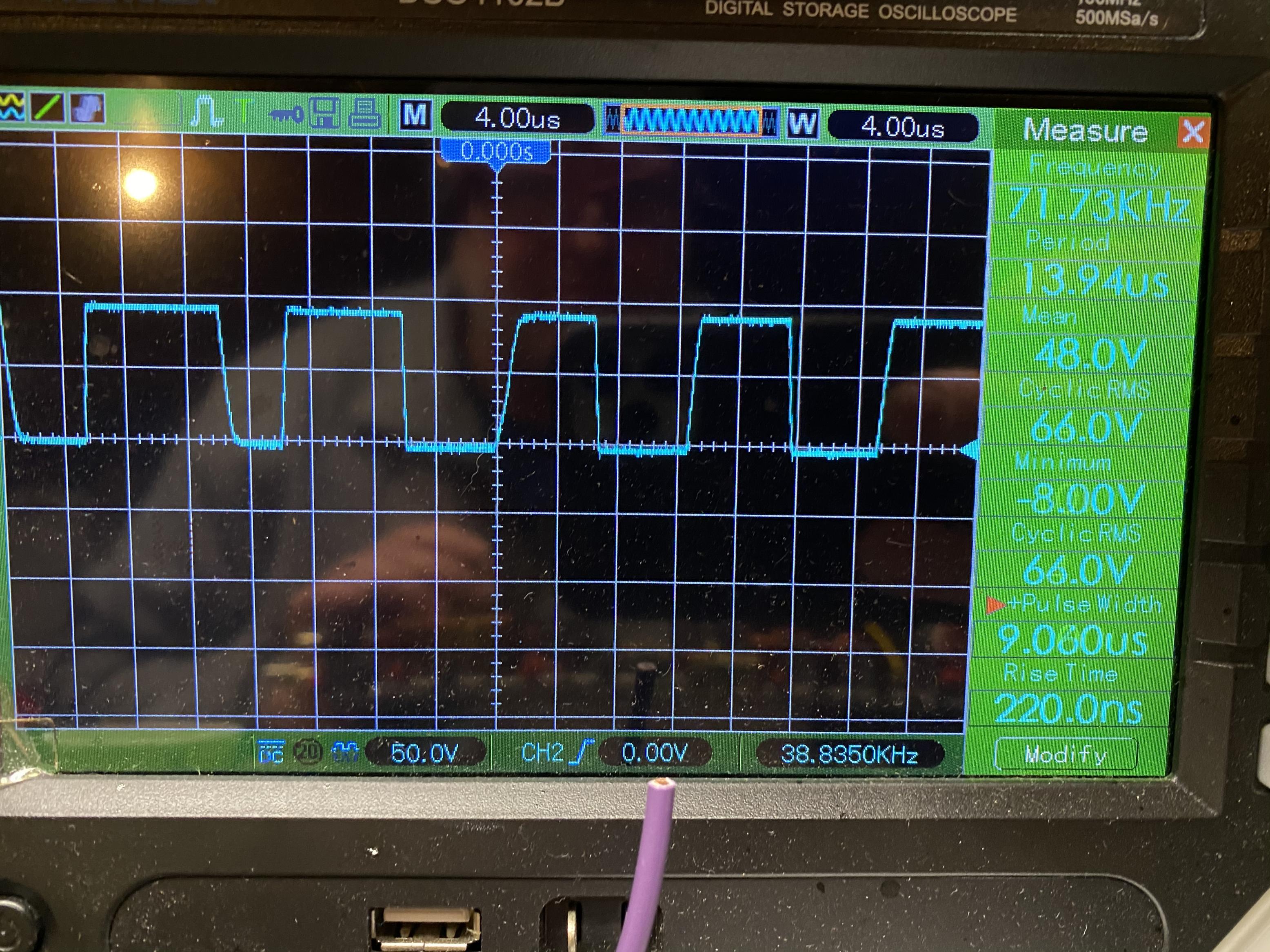

I've never tried to measure the voltage like that. The low side FETs have leg 3 grounded. The high-side FETs have the center leg on 80v. The 3rd leg of the high-side and the center leg of the low-side have a rail-rail oscillation (0-80v).
Are you seeing that 80v r-r oscillaton?
What's the status of the pins 8-10 that were previously mentioned?
